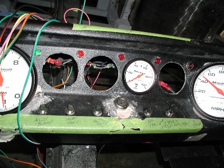

Bill I think you are doing a fantastic job on your build, and I continually use your pics as guides for some of my ideas. I still have a problem with the demo labels. I think the right side of your dash shold be continued on to the left side. I know it 's not period correct, but then neither is the right side either.
I am not knocking your choice, but rather a suggestion. I went with the lighted switches on my dash. That way I know what is on and what is off. It seems to be a neater arrrangement for me. Just a thought. I picked them up at O'Riely's auto parts. They come in red and green.
