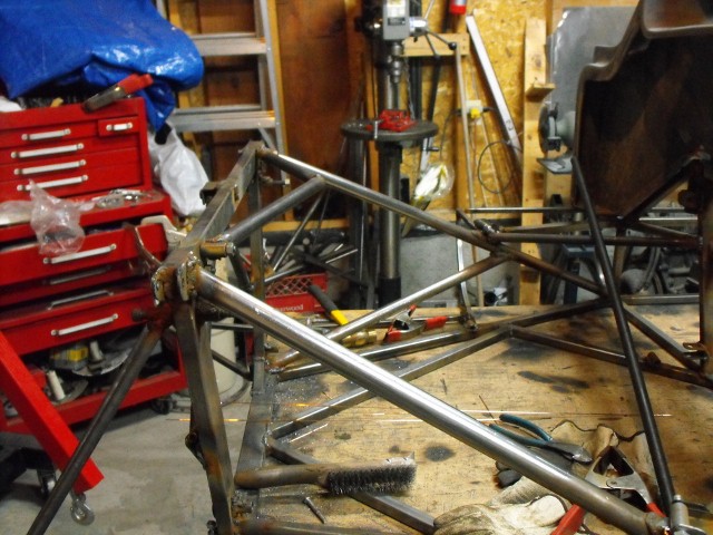

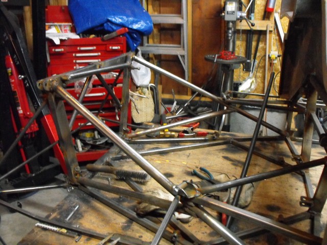

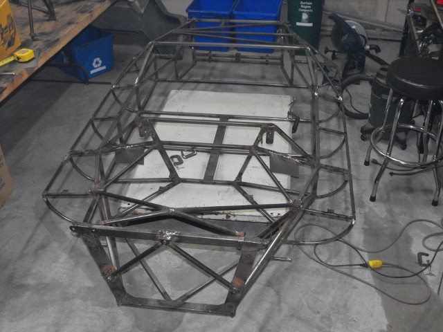

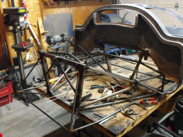

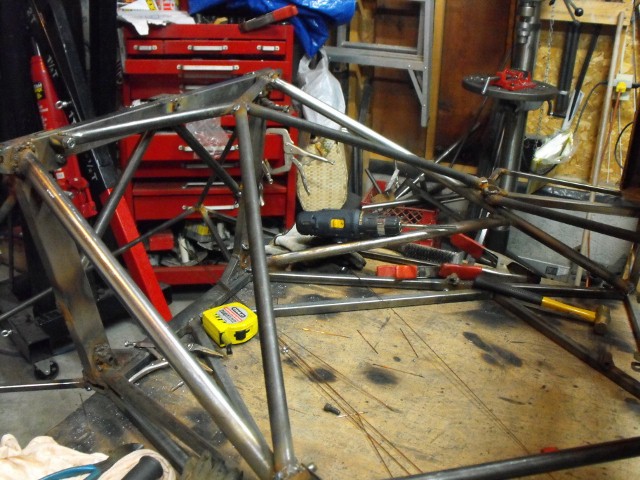

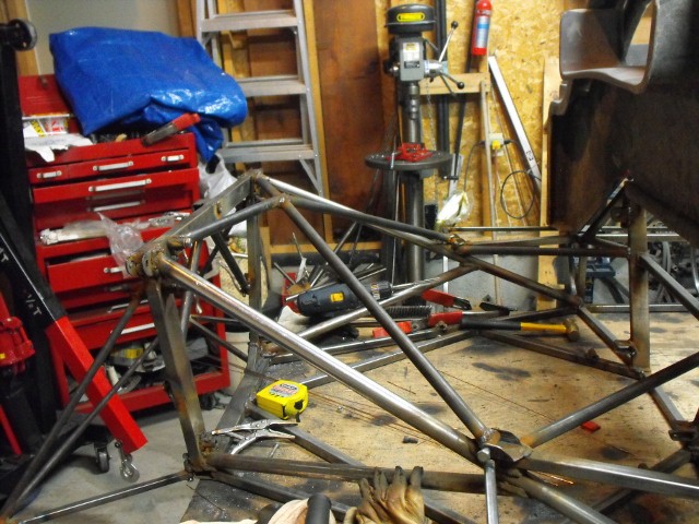

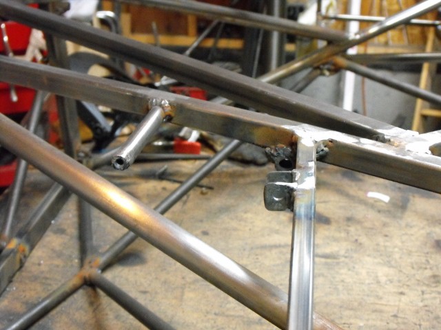

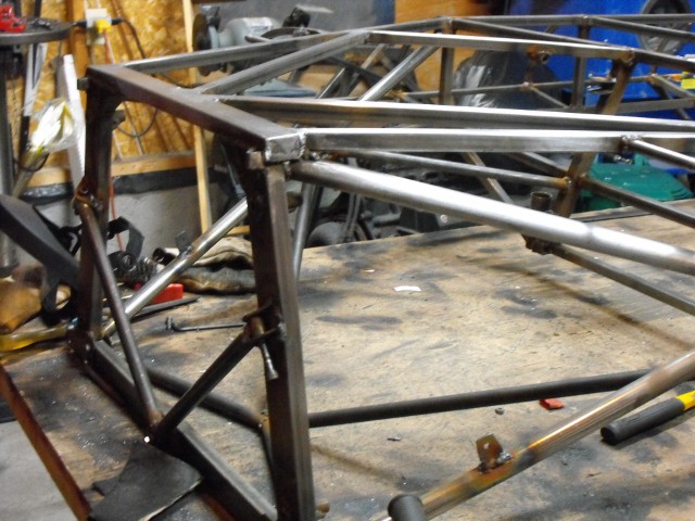

Had a bit of a nice day today and started on the last rear brace. If it's nice tomorrow I will finish it off.
Dave

Last brace finished. I have left is tabs and bushings. I'll start panning next week.

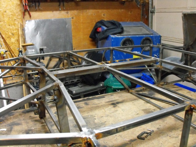

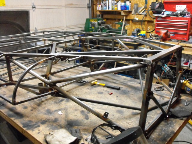

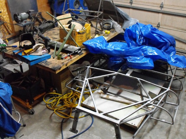

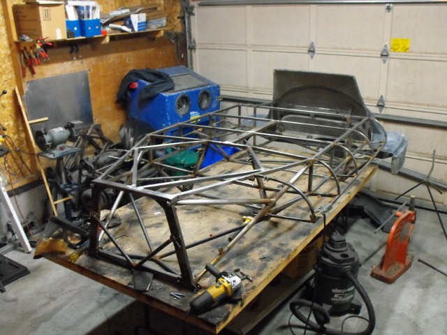

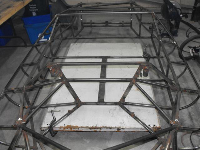

I had a good last few days and just about completed all the welding. I have front two brake tabs and two plates to mount on the rear firewall for fuel pump electrical etc. I have decided to pan the bottom in steel. WeldBond adhesive between the steel panels as a sealer and then spot weld after it sets. It will be super strong after that. Will have to start planning the next phase after that.

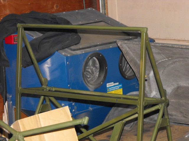

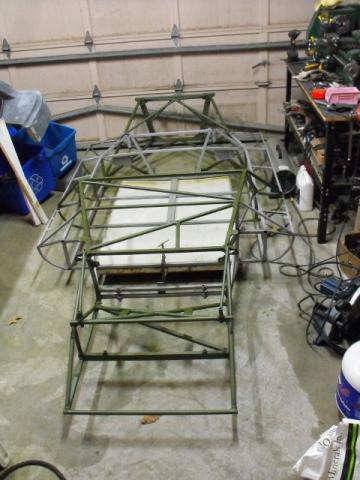

So much for media blasting. Started out sunny them started to rain. Using the Tempo aircraft primer. It's pretty forgiving stuff but as you can see you have to keep it shaken all the time. The last part ran a bit. It sets up in 30 min. I kept the paint warm in the house but it did cool down some. I will fix it up later.
Dave

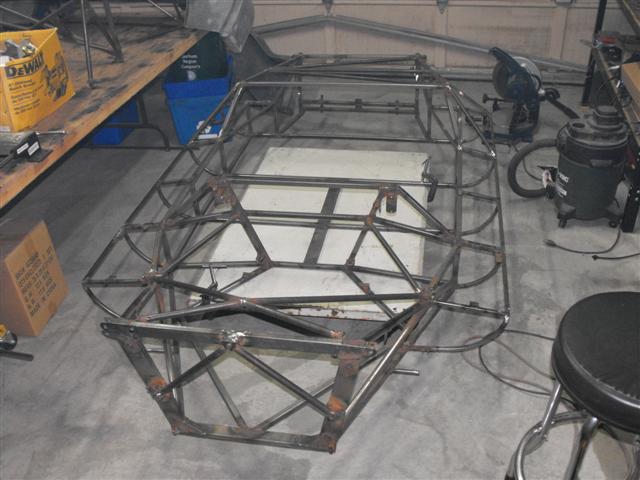

Gent's,

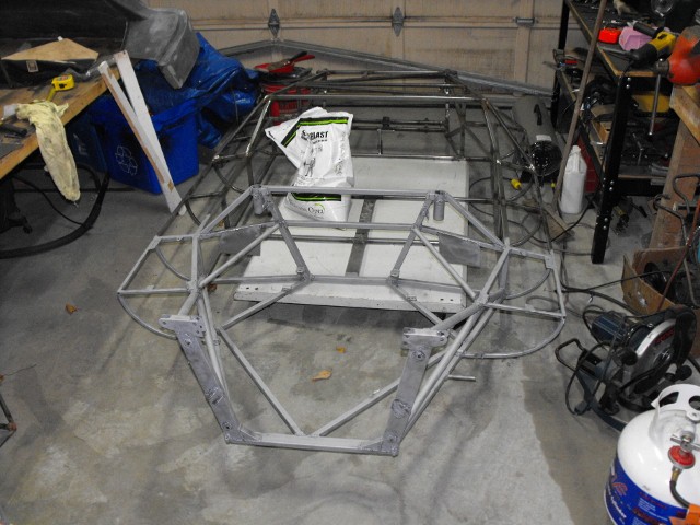

Did a bit more blasting today. I have a third of the chassis done. I have a few good days this weekend so I should get it done. I ordered my spot welder attachment from Eastwood. When it arrives I should be able to start the panning.

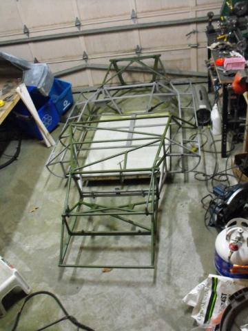

A few pic's now that I am waiting for my spot weld attachment. I been putting some zinc primer in the areas that I will not be welding in. Any overspray I will clean up with emery cloth before I weld. The total chassis weight is 120.8 lbs. That's including the rear sub frame not in the picture.

Gent's,

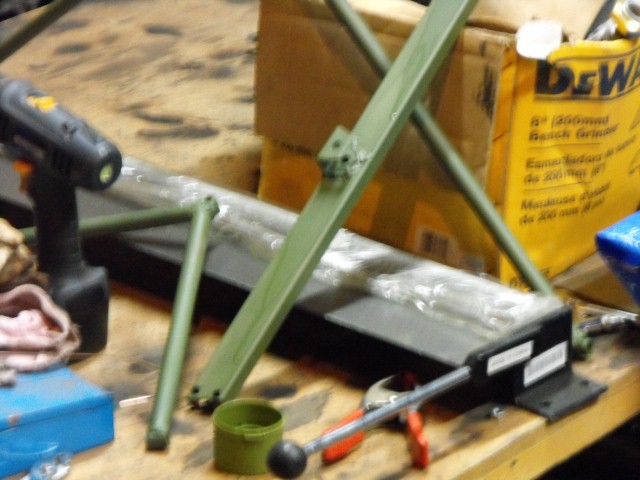

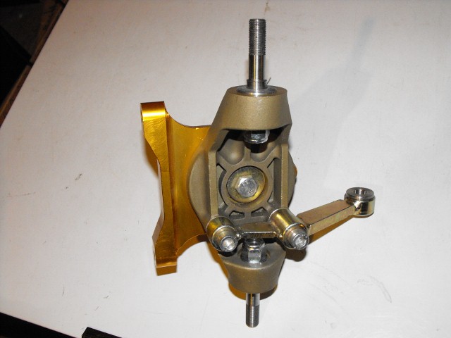

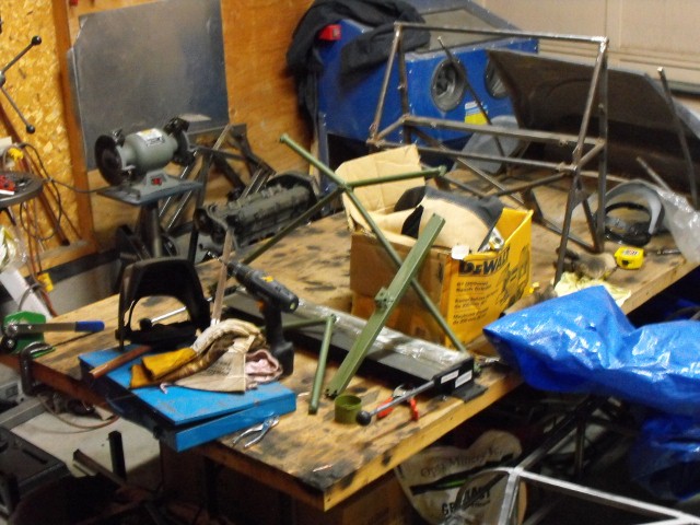

Spot welder attachment arrived today so should have the floor on tomorrow. I have some help for that. Did up some tapered bushings for the front uprights. One side done.
Dave
