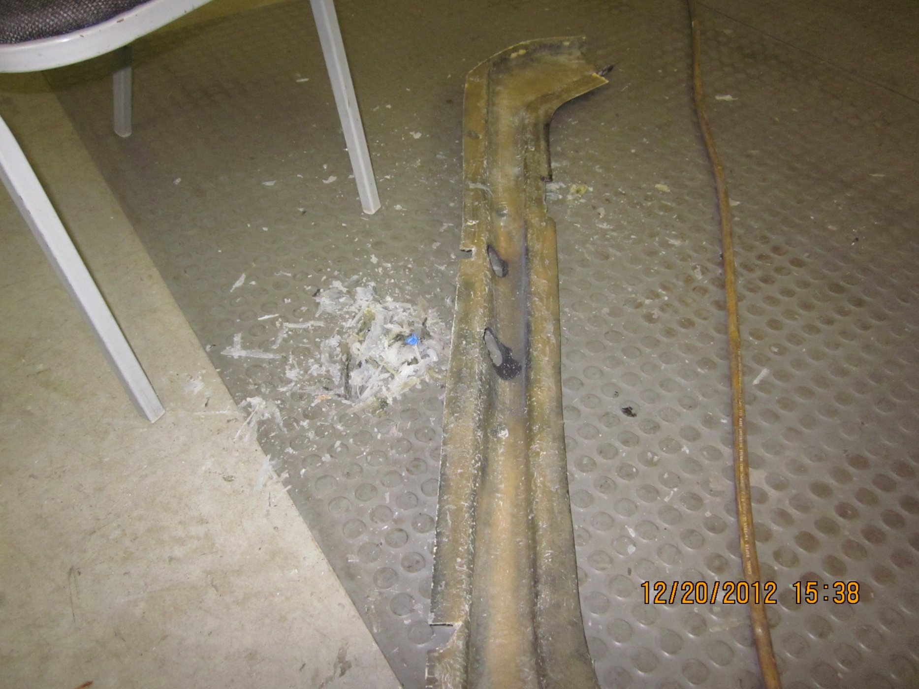

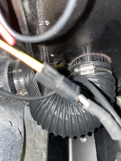

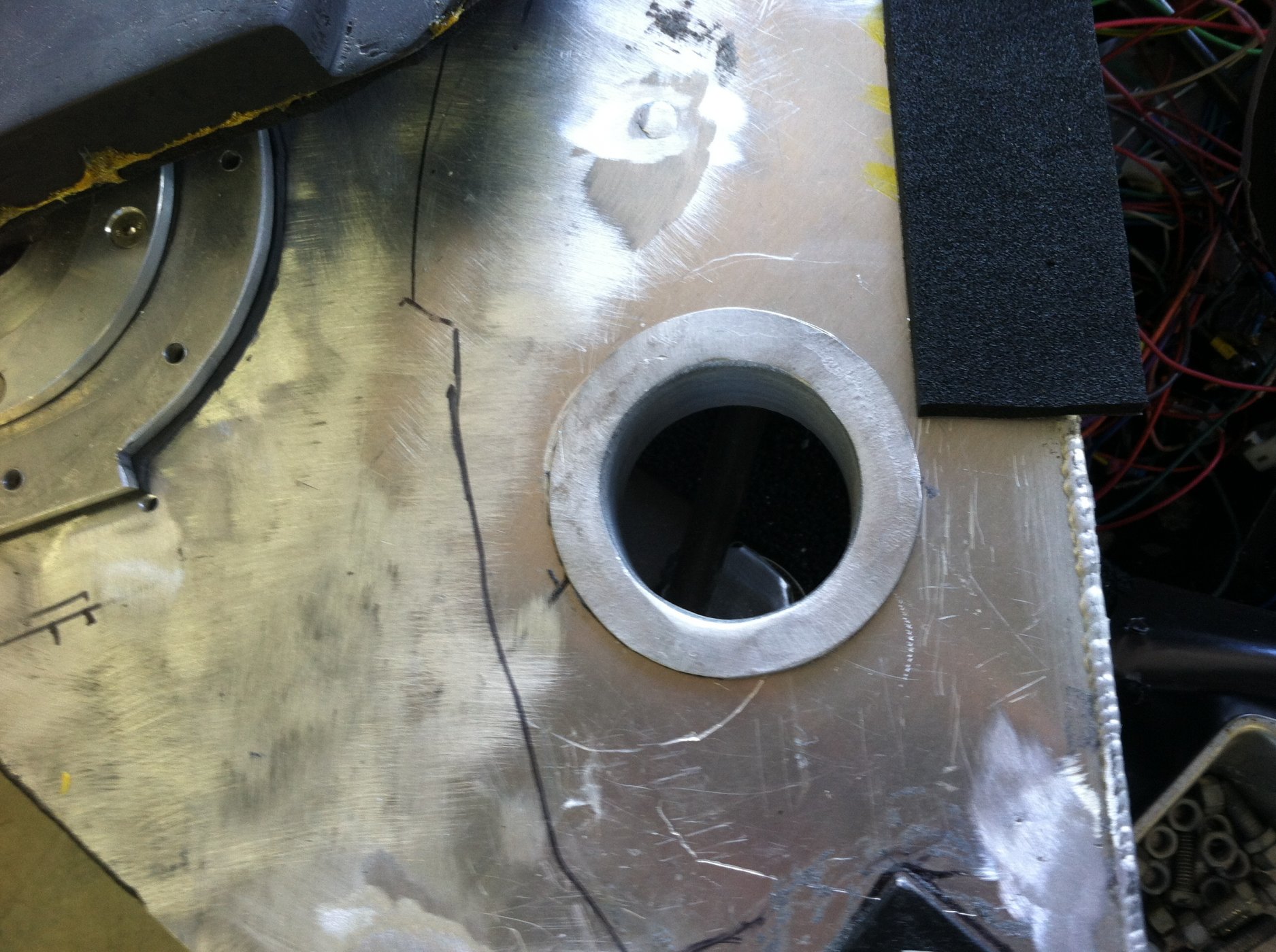

I took a piece of aluminum pipe and welded a homemade washer to it. RTV-ed it in place and attached my AC hose to the bottom. It has been a long time since I installed mine. But I think I remember a fiberglass duct under the dash. I had to cut some off the ends and re-glass them. I have pictures of the end of the duct but not a full picture.

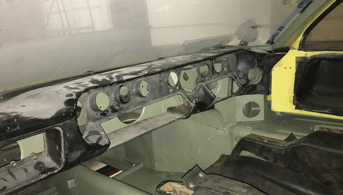

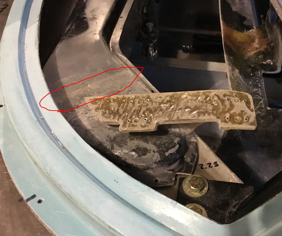

Don't know if you have a LHD or RHD car which makes the dash design a bit different but in my LHD the dash sat much lower. There is a dance that happens between the vent manifold, spider, dash, and doors. Make sure the spider position has been properly vetted before fully investing the dash. Also do you want the dash removable with a roll cage? The vent manifold (at least for LHD) needs to be cut in length. I sectioned mine on both ends in the areas below.
Here is a picture I took of P1067 being restored at Canepa. You can see for reference the original dash sits relatively low on the chassis.

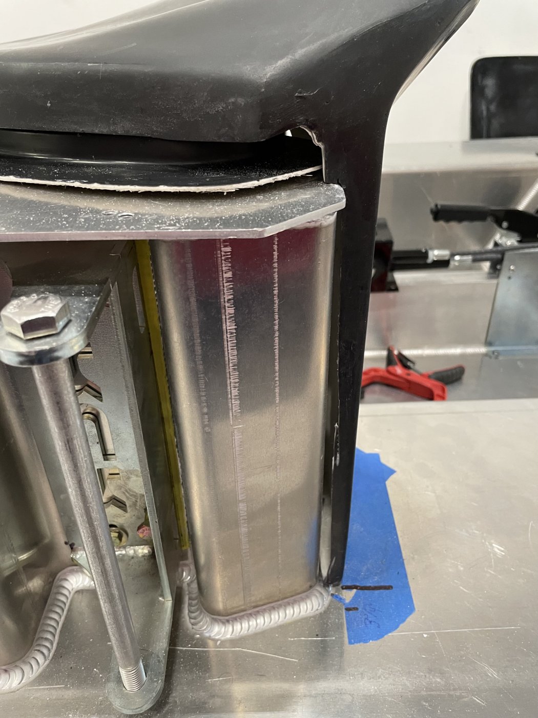

Not sure if these help. I did shorten the bottom of the dash leg where it meets the chassis. It measures 13 1/2".
