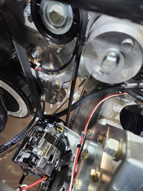

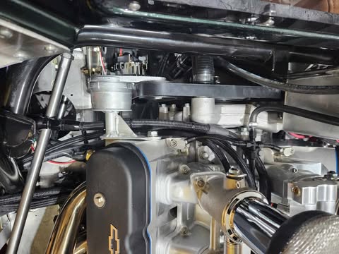

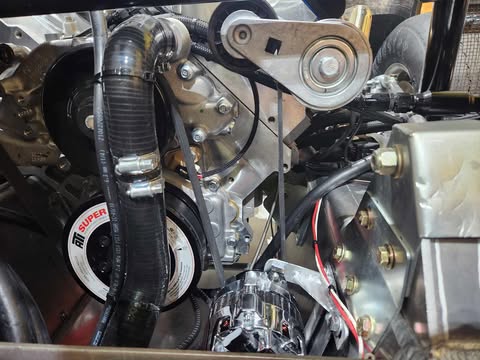

I ran into the same issues - the brackets that came with the Sanderson compressor would not work without cutting a recess in the chassis for clearance. I made up custom brackets for both the alternator and compressor. I also reverse mounted the alternator forward of the block where there is lots of space available. Compressor mount pictures are in my thread on page 7.

Thx Jim, How do you follow a thread here?

Thx Jim. Makes me more pissed by the moment. Everyone who buys an RCR has to figure out (design and build) brackets for the fuel tank and accessories. Great solution on your part. Your car looks awesome.
