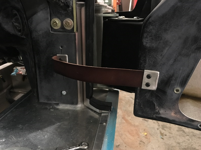

I am trying to figure out how to fit the dash. There is a lip around the front of the dash which is about 1/2” shy of the bottom of the demister recess. I have seen some builders cut a hole in the dash support panel, others have cut off the bottom of the demister (I went this route). However, I recently stopped by RCR and Fran told me the bottom of the recess should rest directly on the dash support so that it sets the dash height tightly under the lower windshield frame.
My question is, how are others supporting the rest of the dash? Blocks? If so, should the blocks raise the dash evenly or just support the front? If the dash is only raised in the front then it would be slanted down towards the driver which might be fine.
Also, my dash is somewhat warped so I am considering gluing the blocks to the underside of the dash and then drilling up through the dash support and pulling it down flat.
I don’t have a front roll bar, but I might add one later, so I plan to cut the ends off the dash and use a joint to connect therm back to the main dash.
