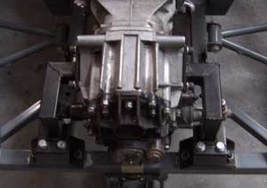

I have the ZF from a Pantera in the 40 I bought just like yours Frank.If I had build it myself I would turn transmission because you can mount your engine lower in the chassis.This is a change which is high on my modification list.So if you can ,change it now and, mount the transmission like it was ment to be in a 40.Good luck /ubbthreads/images/graemlins/beerchug.gif

This is the right way up

if you lowerthe engine should you modify the bellhouse?
because the way it is now if i putt the zf horizontel i've got only 4 cm between the bellhouse and the floor of the car
[ QUOTE ]
Mark,
When flipping a "pantera" ZF, the box is opened and the ring gear is moved to the other side.
[/ QUOTE ]
Thanks for clearing that up for me. My mind was going all swervy LOL
Ross Nicol
Frank Sorry mate I realize I should have replied to your earlier posted questions.You won't be able to use the Pantera bell housing.My bell housing you can see in the photo is an ERA sourced Item and it has the bottom shaved to be level with the ring gear.It bolts directly to the ZF-2 and allows use of a Standard Ford clutch and flywheel.The ZF can then be mated to a Windsor motor and to set the whole unit low in the chassis you will have to dry sump or get a shallow sump with wings.I can help you with dry sump detail if your still unclear what's required.
Regards Ross

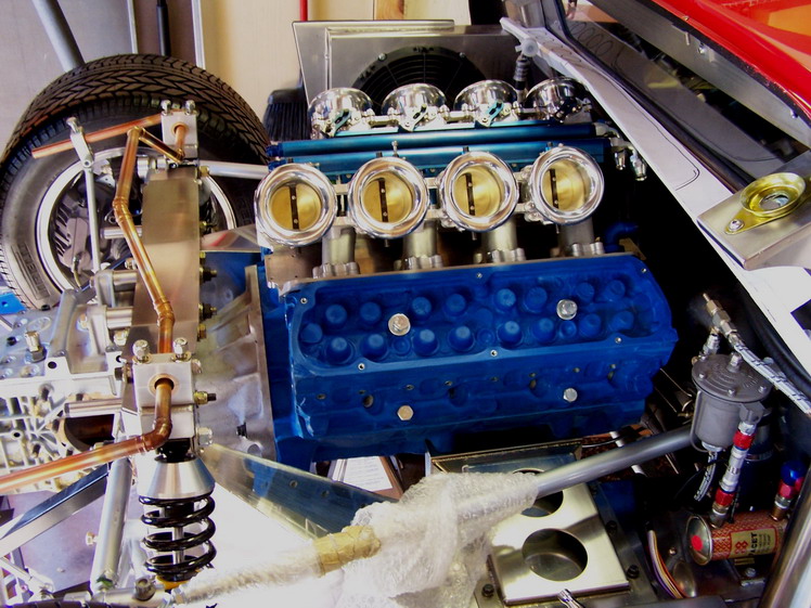

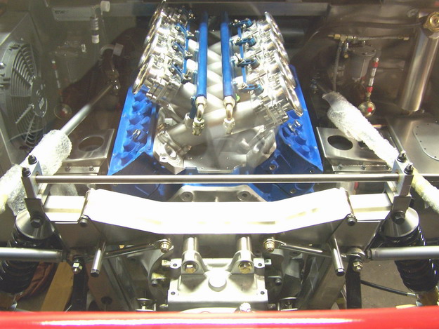

I purchased the manifold from Steven Morrison from S.D.&L.A.Morrison in Melbourne, Australia.
I meet Steven at the SEMA show last November. He made me a deal I couldn't refuse! I will try to attach a pic.

Hi Ken,
Your CAV is sure filling with nice details and looking spectacular.
I also have to say that the straight intakes runners on that manifold
look like a modern engineered system that really means business !
Bob
Hi Kenny
Is there a Kenny's car thread in this section?? If not, maybe there can be;) Your car looks amazing!
Cheers, Neil
