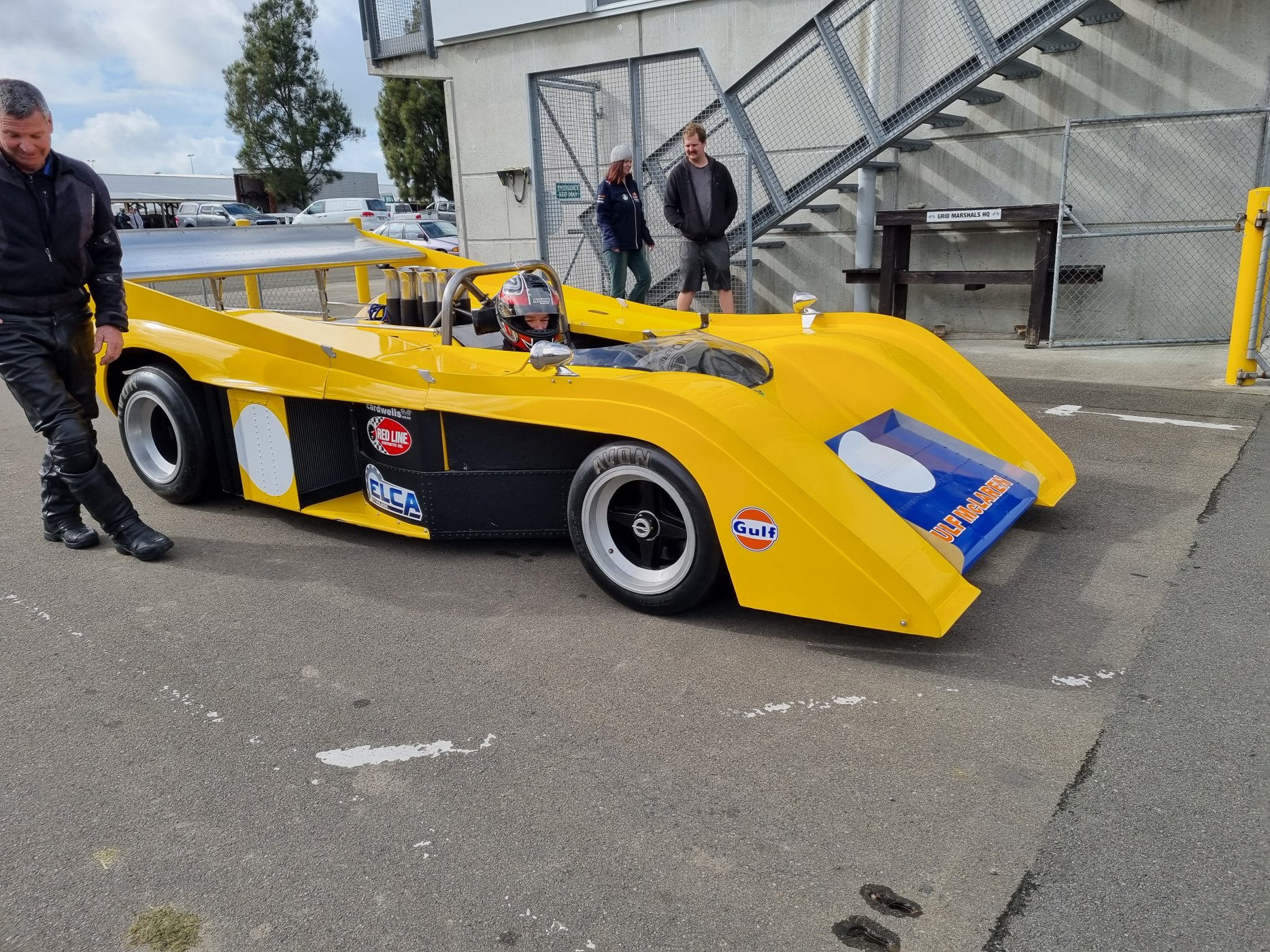

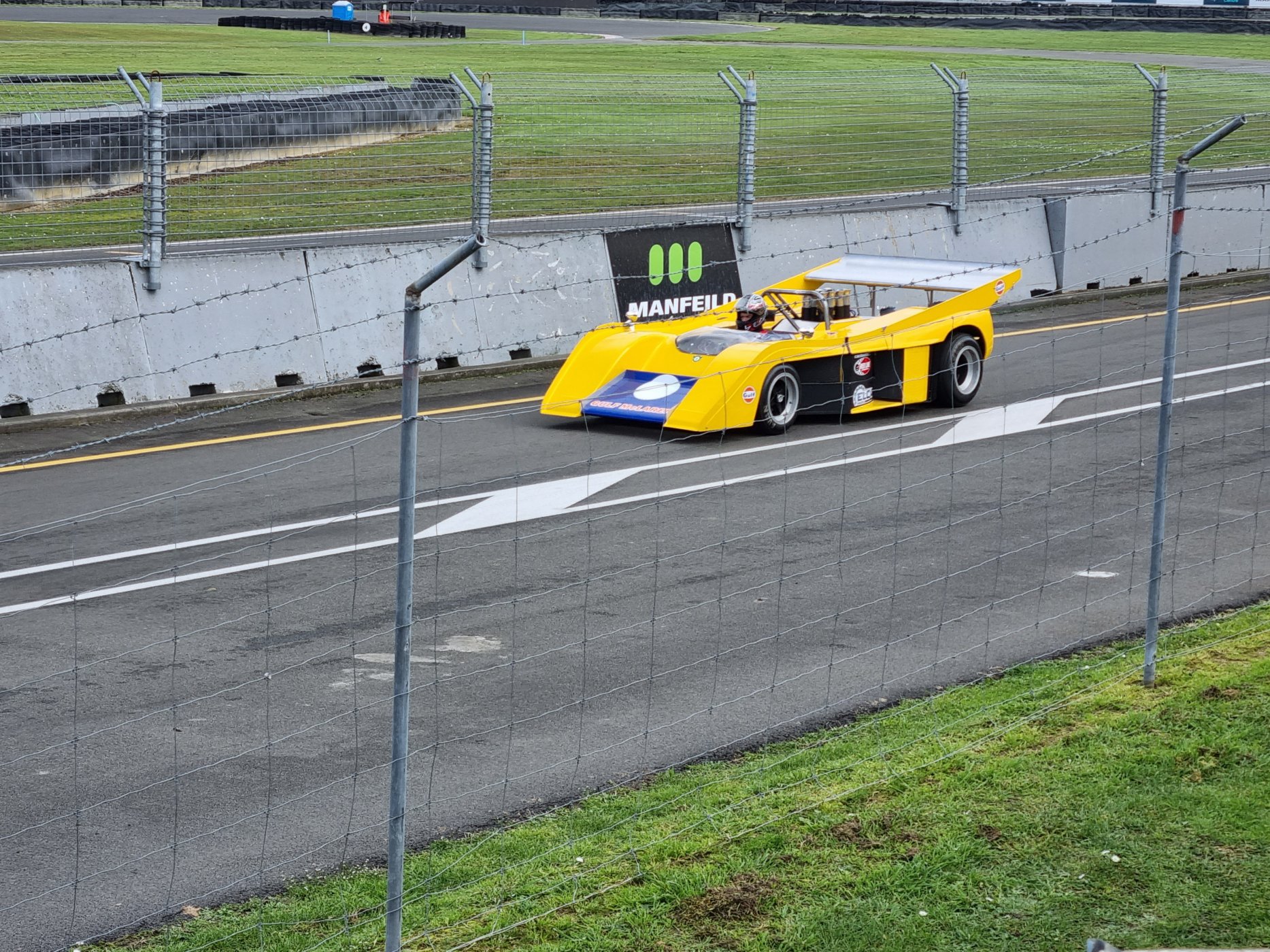

Well the day has come and gone for the M20s first track test day, It was very successful for the most part in general everything I had concerns about worked, it steered straight, stopped straight no shaking or funny vibrations felt really stable and went where I pointed it and as I went out on old cold slicks on a cold day it was gently gently and after a couple of laps I felt confident it was going well. As for the now infamous TransAxle it worked well didn't break and selected gears, it is a bit notchy and you have to be quite precise with the shifts but for a first time out I'm quite happy with it but it will need R&D. Now for the problems, After 2 laps it developed a miss fire that got worse through the lap so I decided to come in and that was when the real fire started ~!!!! it was quickly extinguished and turned out to be Hot Exhaust and Fibreglass don't go well together so some mods and heat proofing required, The miss fire was due to plug leads melting so need to look at some protection for them. All in all not a terrible first first run I will post some videos and photos very soon. Cheers Leon

Leon, waiting to go out (Packing the undies :)
and return road.
