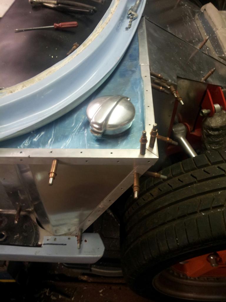

Thanks for that , sides did bulge a bit, had one pin hole in each tank, one at the end of a weld where i cleaned the tip and the other at a corner which seemed to have a bit of contamination, ground it out then re welded and seemed fine. fitted now so one step further on, still not had the courage to start engine for the first time but will need to bite the bullet soon, just need to get all my gauges working before i do it.
Tanks in situ. still got some tidying up to do though.

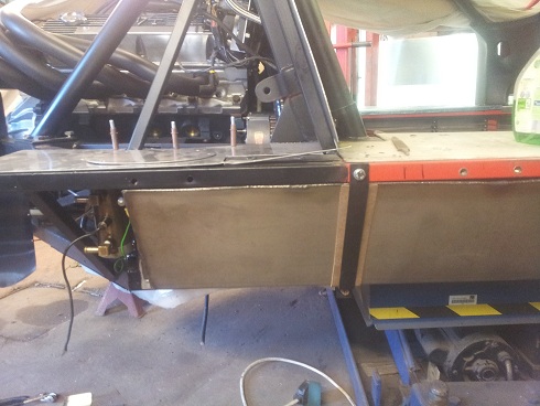

Well think this is possibly my 4th version , Think I will stick with this, rough fit at the moment and panels to clean up but think it will be ok. can remove the front panel to access the filler hose and this is also sealed from the interior so hopefully ok for the IVA

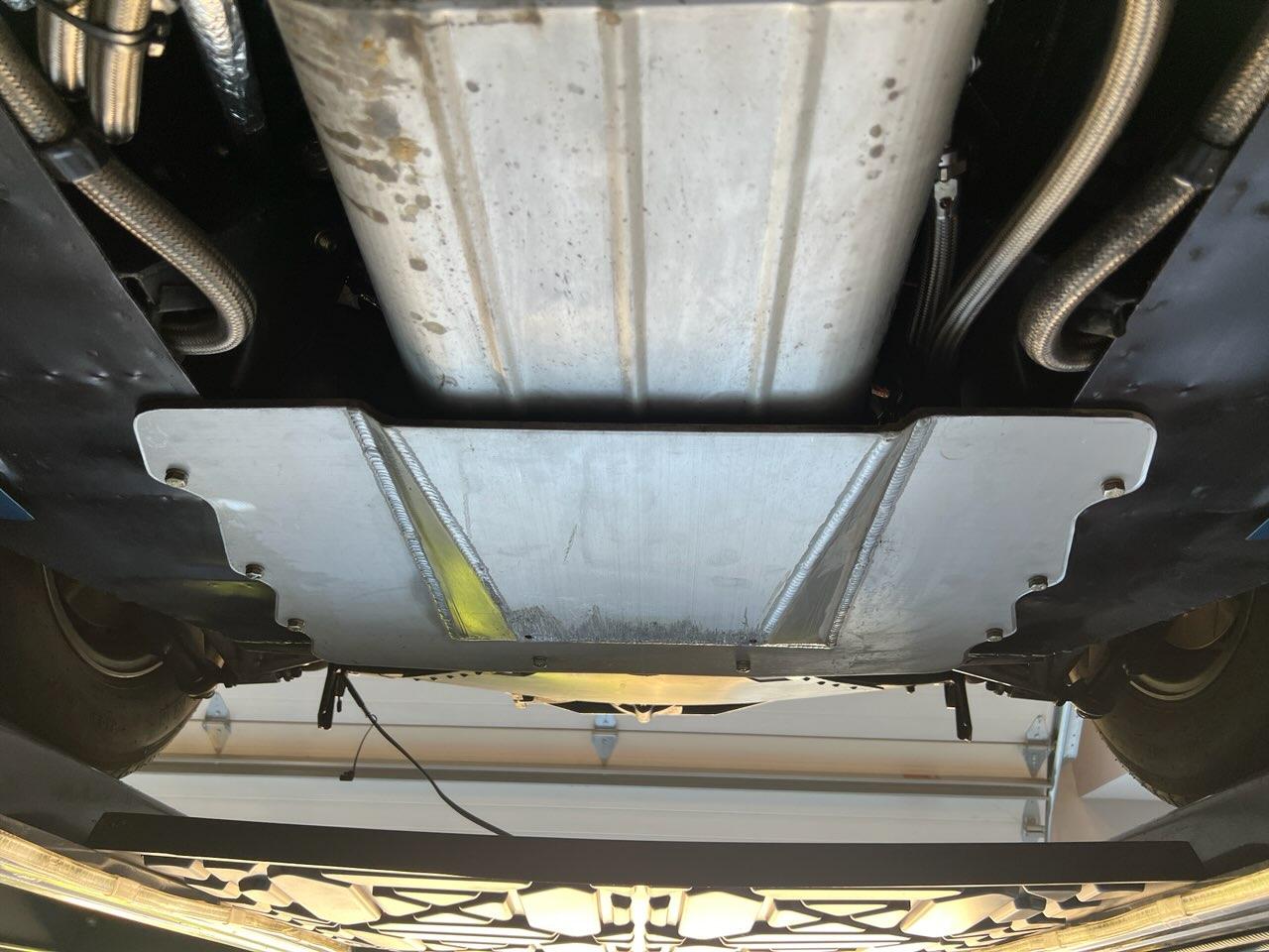

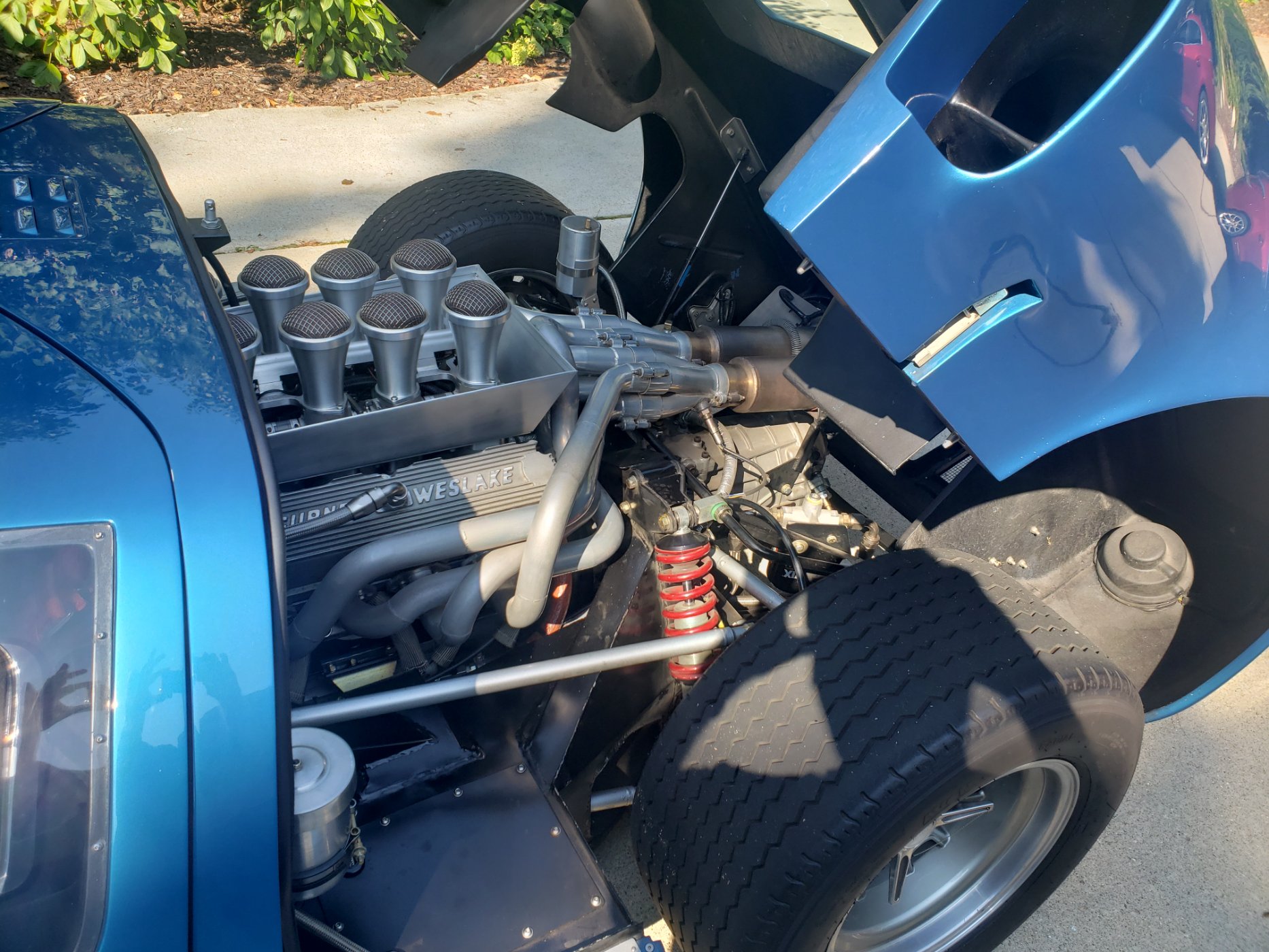

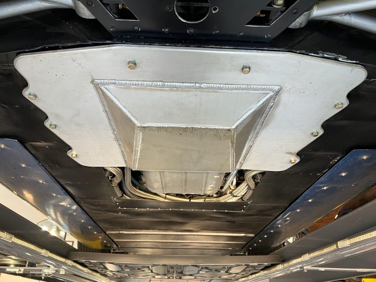

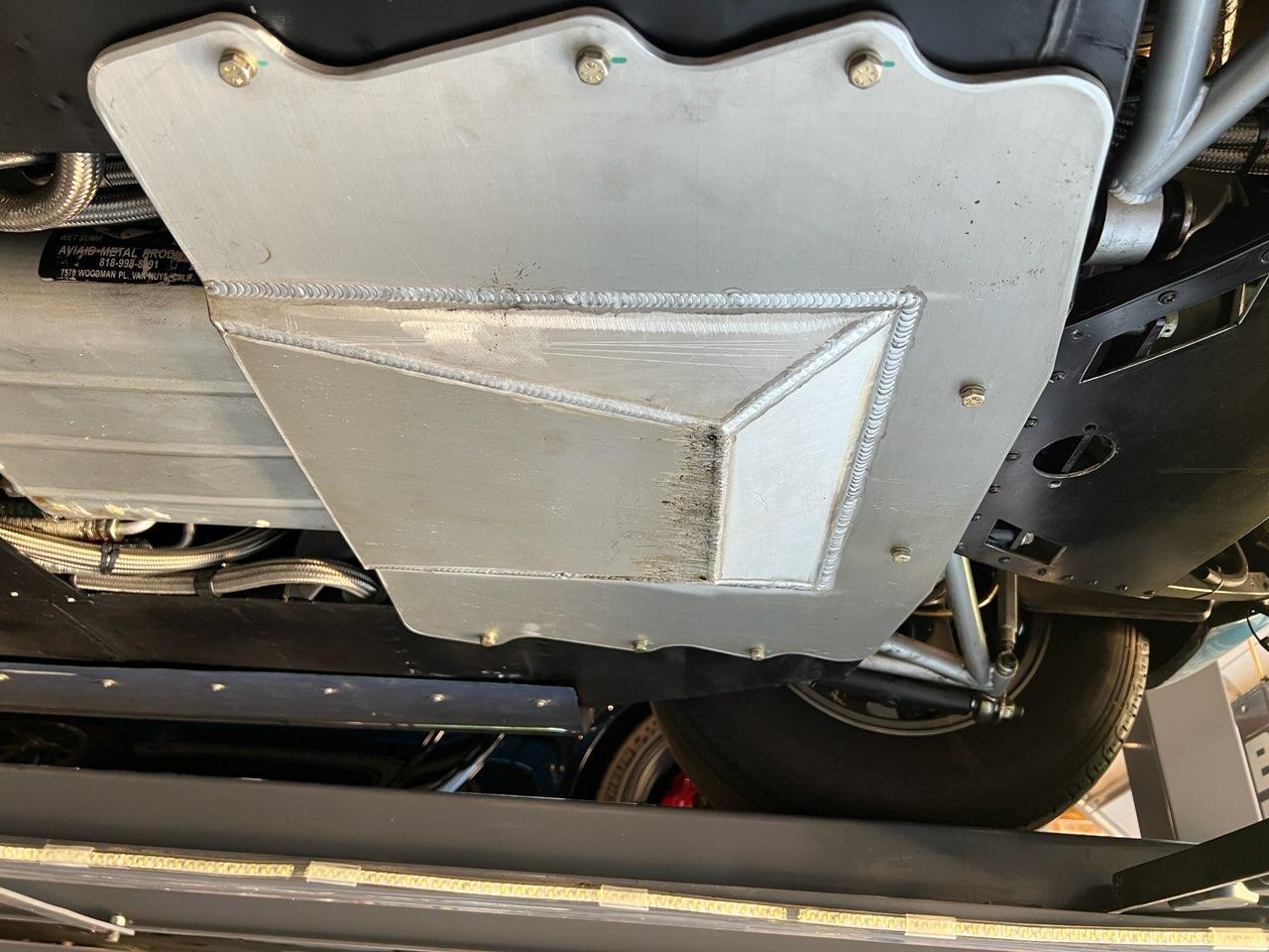

Day 1 . trying to work out where to mount the engine.? sump at the moment is sticking out under the car by about 35-40mm , are sumps available for the 302 that are not as deep to keep it within the chassis level? as if I move the engine up higher at the front the distributor will be touching the crossbrace on the bulkhead. Could move the full unit back a bit but will get tight around the drive shafts. Any ideas?
Hi Robin, don't know if this would be interesting to you, but here is a friend's SPF GT40 MKl with the same issue. Robert built this skid plate for his sump that is lower than the belly pan. If you look closely you can see some witness marks where this skid plate has already likely saved the engine sump. Hope this helps, Dave.
