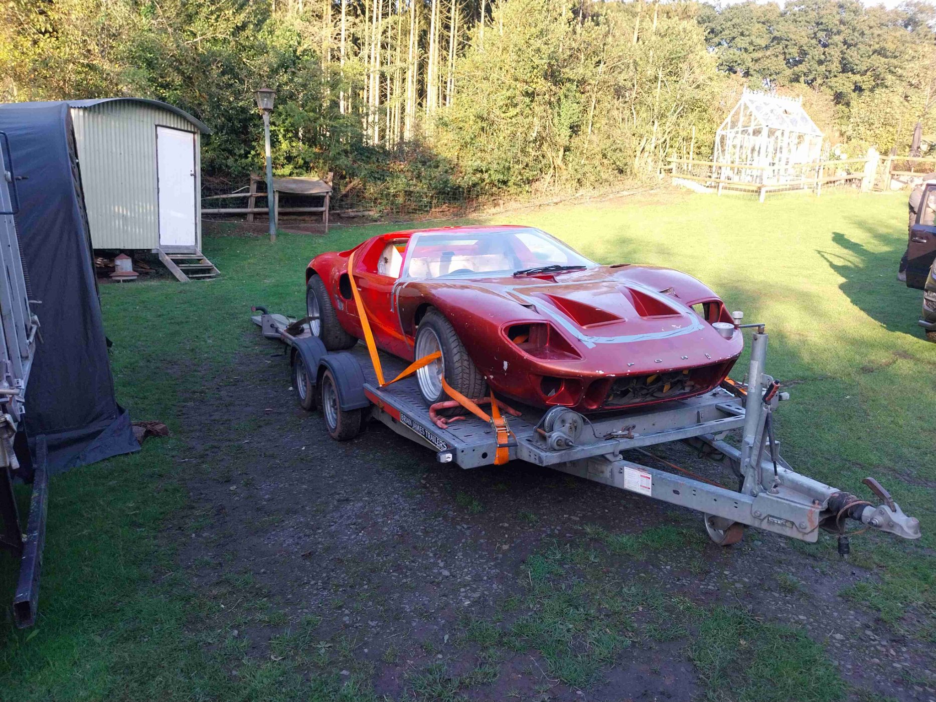

GT40 kva type C was collected from England from the previous owners who had bought it many years before in a partially built state but never had the time to get it sorted. Previous owner and his wife were lovely people very open, honest and helpful. Second photo shows the sellers international harvester lifting the half built V8 into the back of the amarok.
GT40 was trailered from near Kidderminster to Liverpool for the ferry to Belfast the to Co. Tyrone.

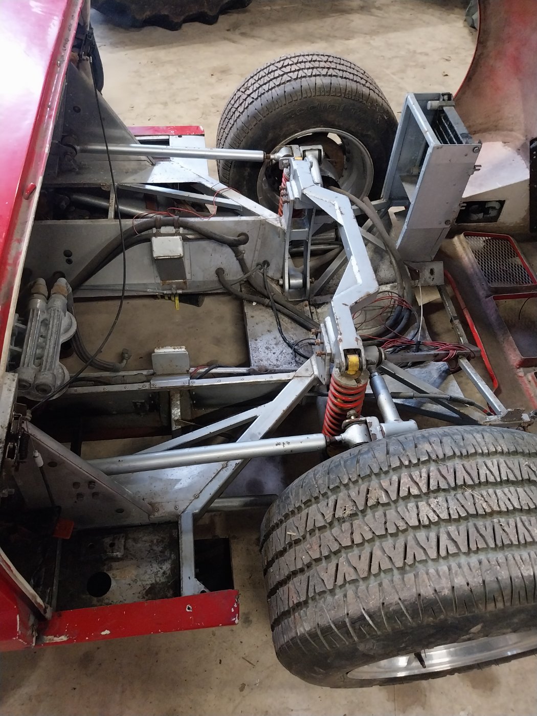

4. Frame is solid with a little scale but no rot

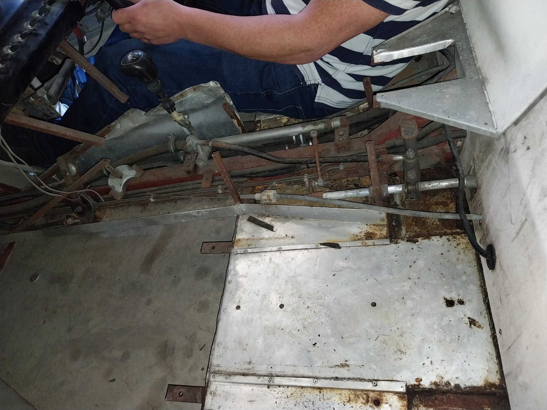

10. No seats, or ''frontal floorpan'', no front shocks or springs

5. Get plans for floorpan and get fabricated

There are no plans that I know of for KVA but I have some pics and info. If you have a need for more space then consider a dropped floor pan and a Gurney bubble. If you are short of legroom a change of pedal box might be in order.

The C type KVA used Ford Granada Mk2 front uprights, hubs and brakes. The uprights are strong and are OK for most purposes. The geometry is not ideal but in practice is OK. If not vented they can be easily upgraded to vented Ford or there are aftermarket 4 pot upgrades available. Changing the uprights will involve new wishbones, brakes and possible wheels which will be expensive or very expensive. Remember also that front of the C type tapers in and the wishbones have unequal sides.
The rear suspension is by two long trailing arms, a top link and a reversed bottom wishbone which sets the toe in. The upright is fabricated steel with Ford Granada Mk3 hubs and brakes which have integral handbrake mechanism inside the piston. Most of these Ford parts are available from Burton Power or Ebay etc.
