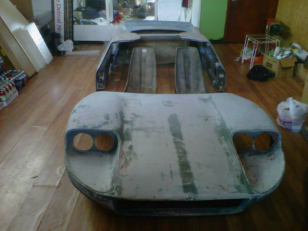

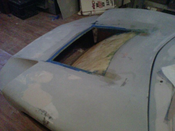

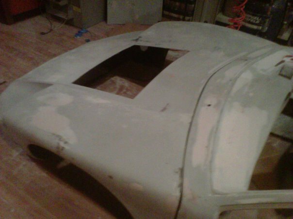

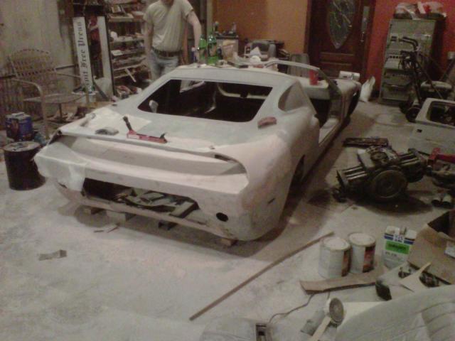

Ive had this body for about 6 months now and really havent done much to it until this new year. Im getting really exicted seeing that its starting to come together now. the body was in the worst condition you could get it, I just fabricated the hood vent and put that in, I cut the rear end spoiler off and am installing a wing that about 7inch off the rear, the rear fenders will be molded into the wing. I will have glass tops in the roof and have the doors open in a 90degree kind of way. Instead of using a transaxle I am putting in a short block 302 with a short shaft c4 trans or a muncie depending on how much room i have to work with and the rear will have a quick change axle so I can run taller gears for the street and short for the track. Hopefully I can fit a short drive shaft along with everything. I ordered a rear frame kit from summit racing along with the four link suspension with should arrive in a few weeks.The front end will have either be mustang or corvette depending on what I can get my hands on. I will have the car painted flat black. I am trying to make the car look like a ford gt but then again I am adding a bit of a twist. What does everyone think? Any opinions and help with the mechanical part would be great!

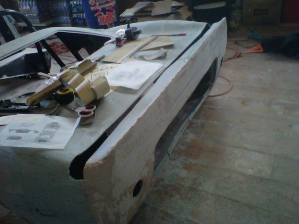

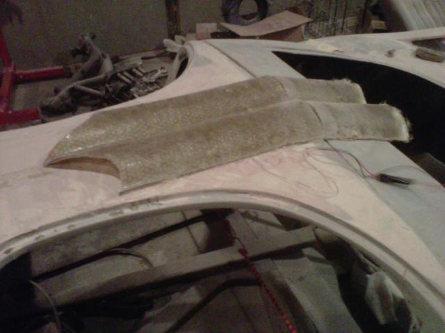

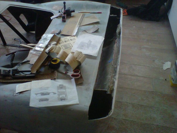

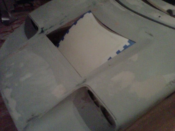

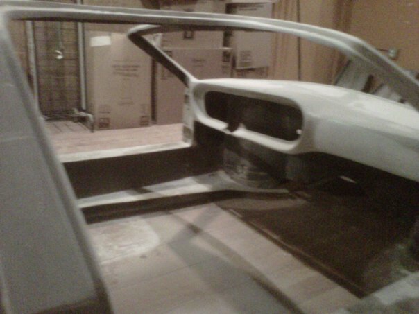

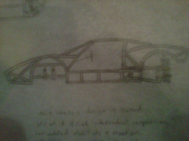

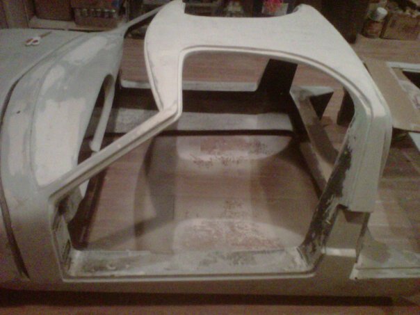

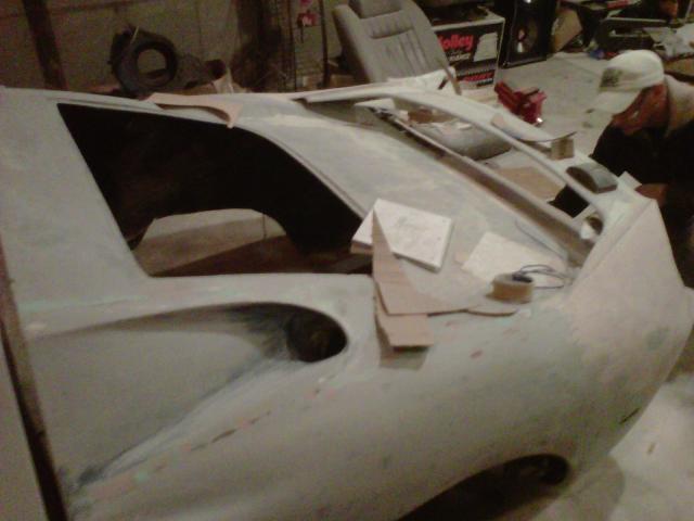

Here are some pictures as of 2 weeks ago, A lot more has been done so I will get those on here by sunday. Ill also take pictures of the frame rail, new wing being put in and the custom hindges...I know it doesnt look the greatest but I live for challanges

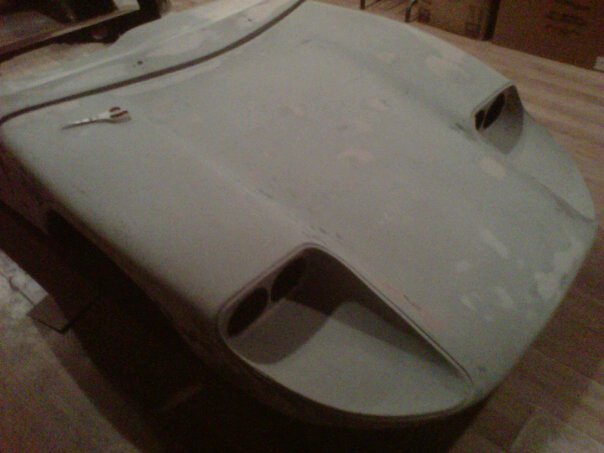

Here is some pictures of whats going on right now with the car. If you dont like what I did then bother posting something because a kit car is meant to be added with the owners touch!.. I think it looks great.
