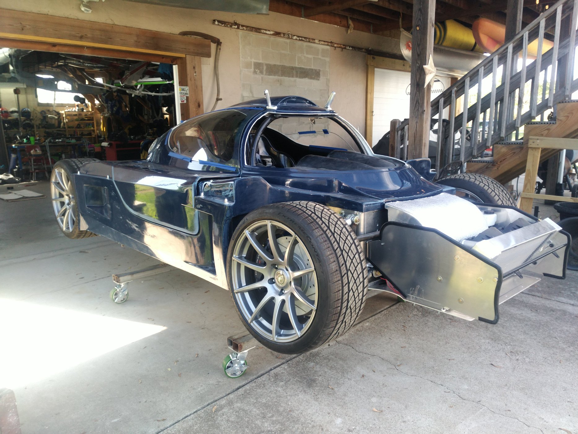

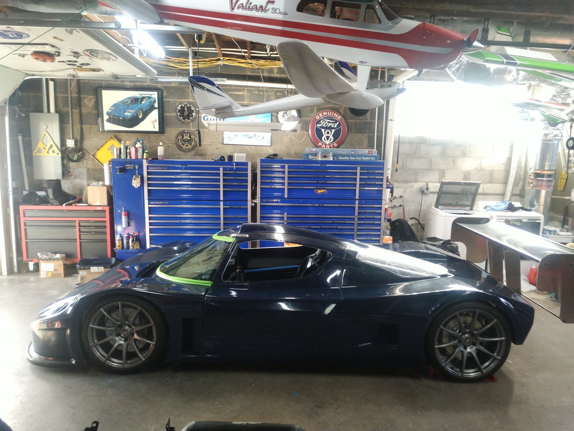

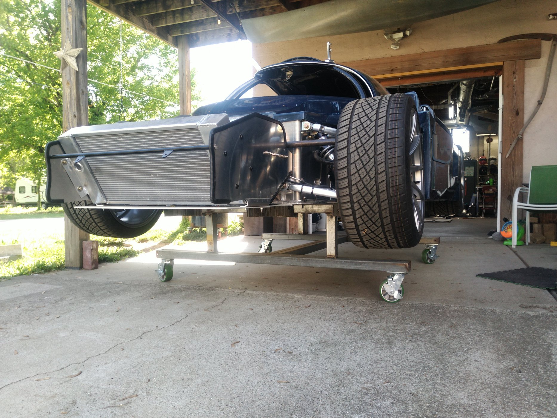

Well as previously stated. this is My build. I've had the car since July 2024 and have done a few things, some fiber glass work and trying to force a Gen 3 Coyote NA
into a space I hope provides Miles of mile wide smiles... I'm not going to be doing too much cutting edge stuff or blowing minds with this build as I'm going to keep it simple and most likely gonna be asking technical questions and troubleshooting scenario's. the main use of this machine will be a Track weapon that can pose as a street legal ride too.

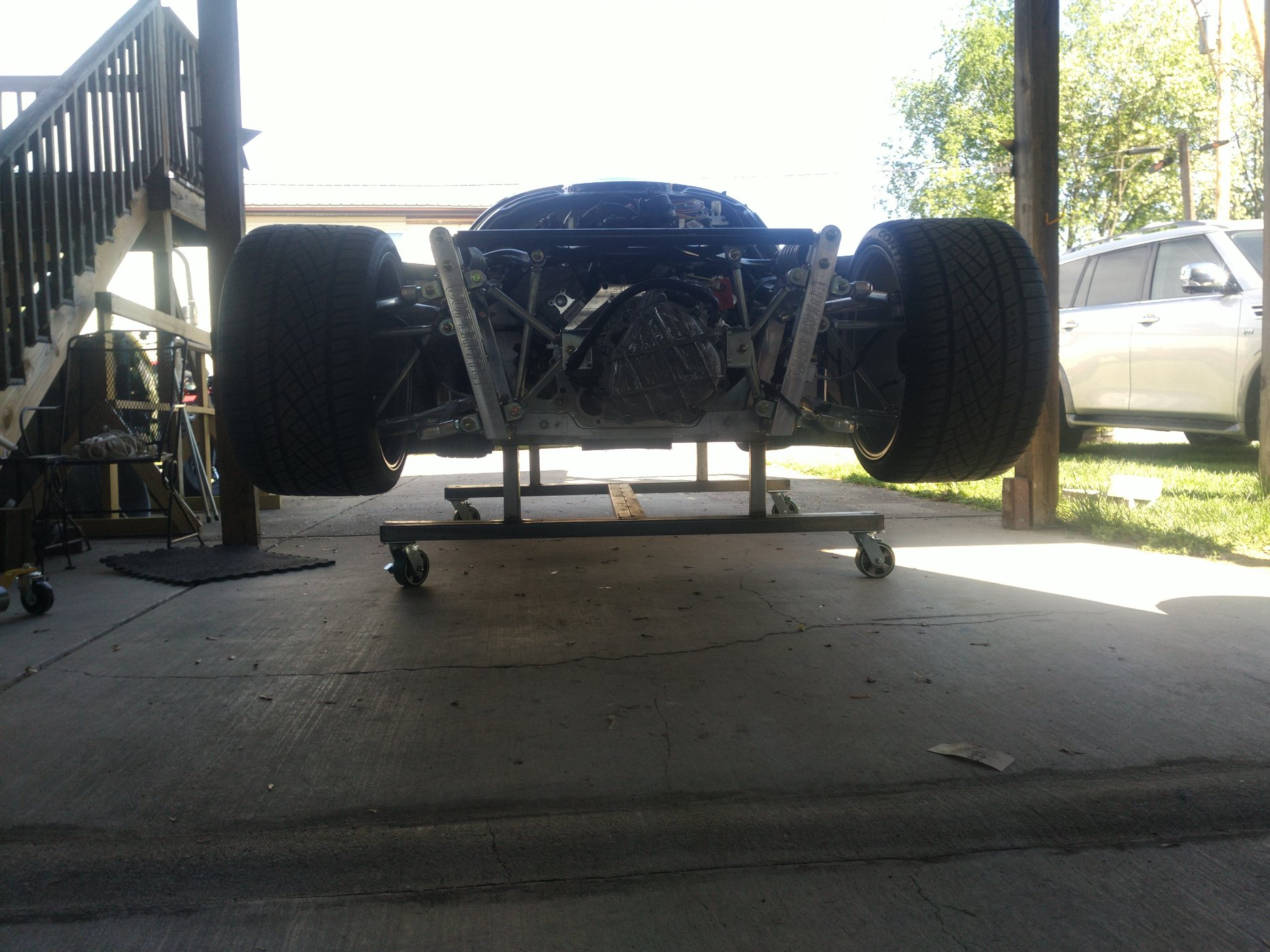

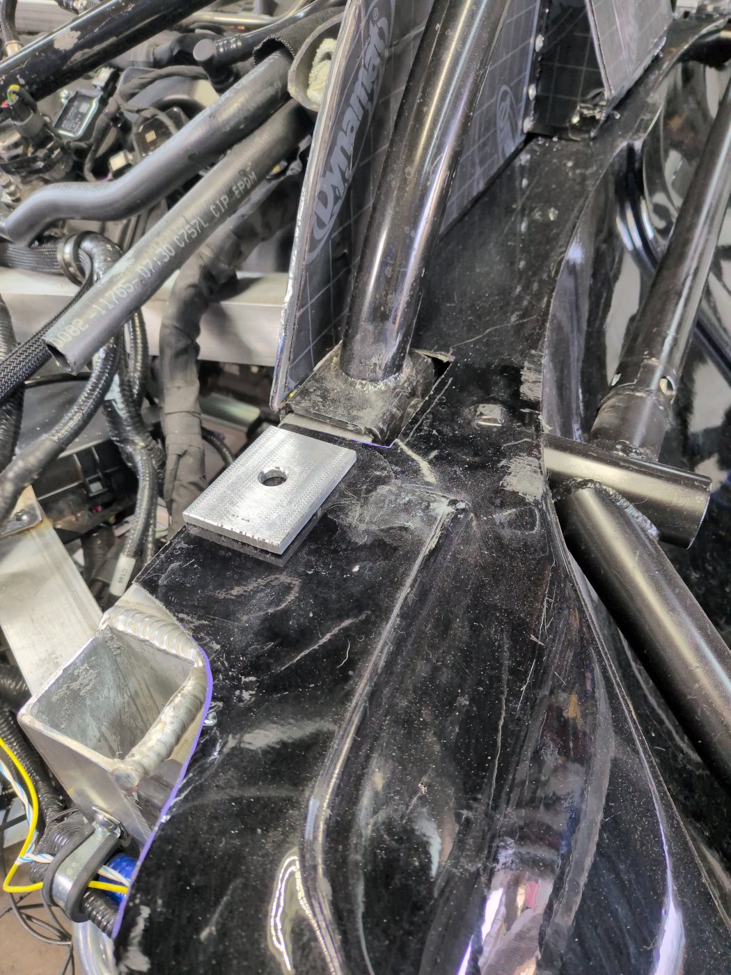

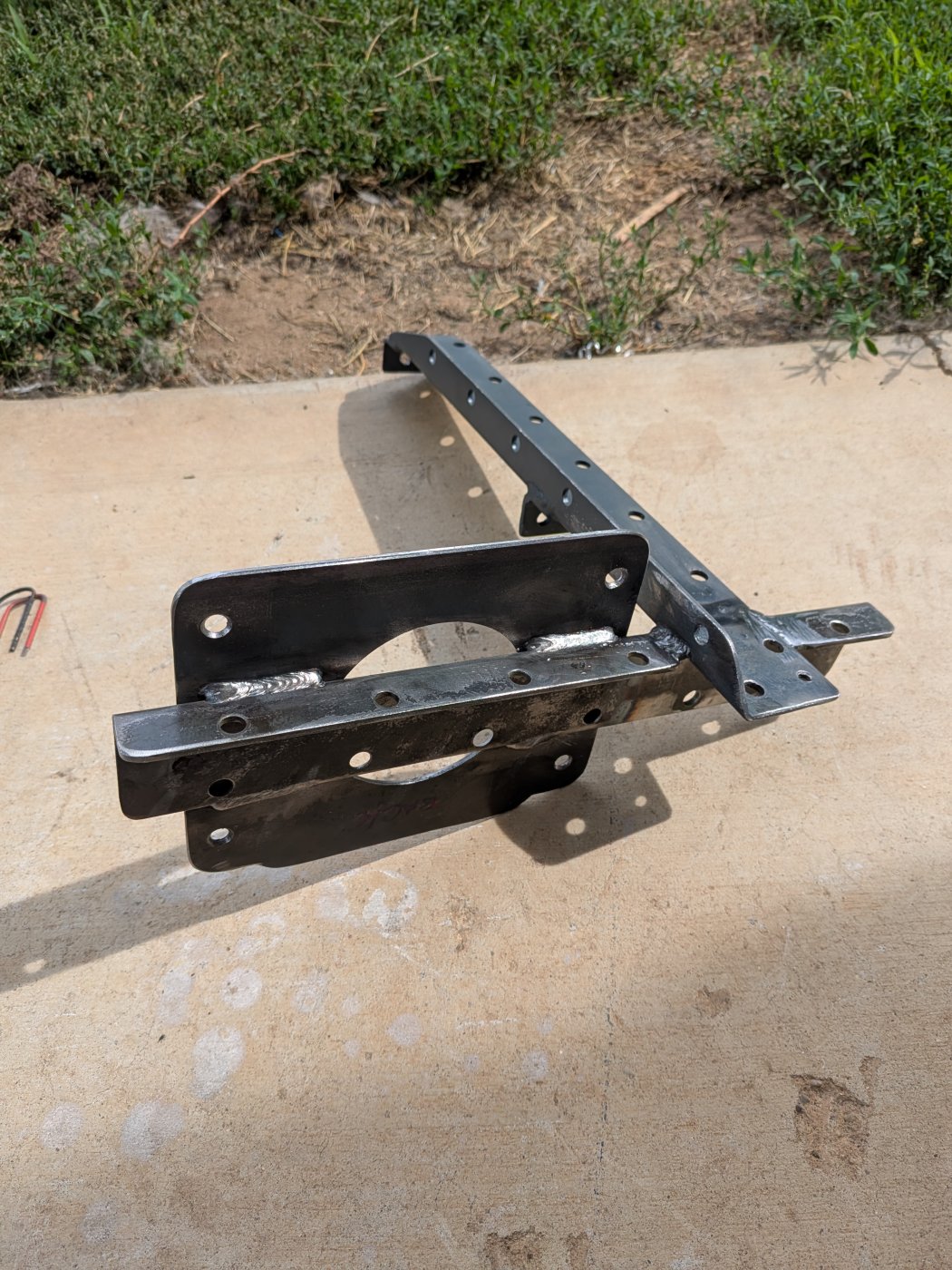

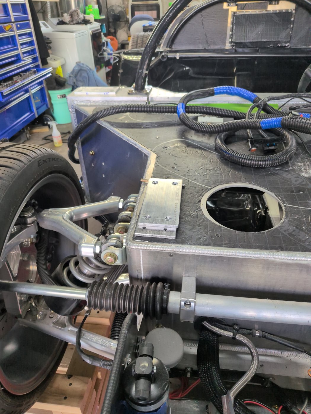

Joel Bailey

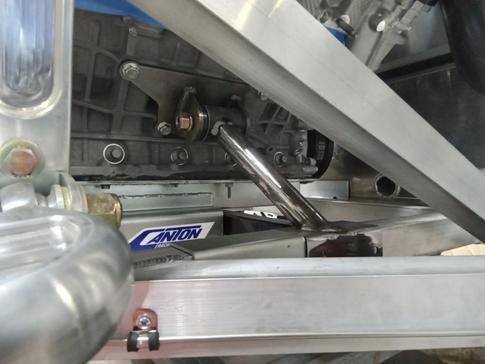

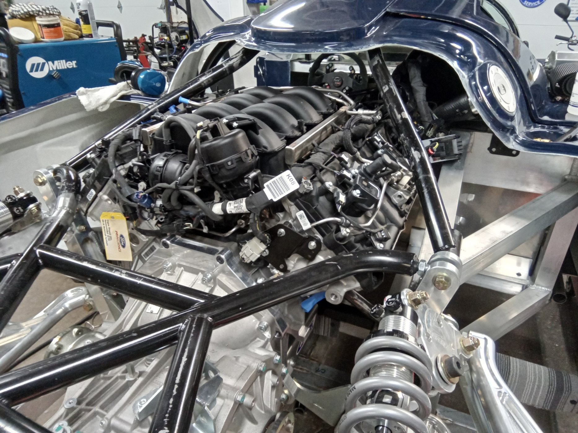

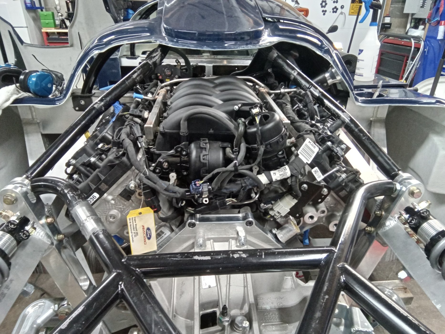

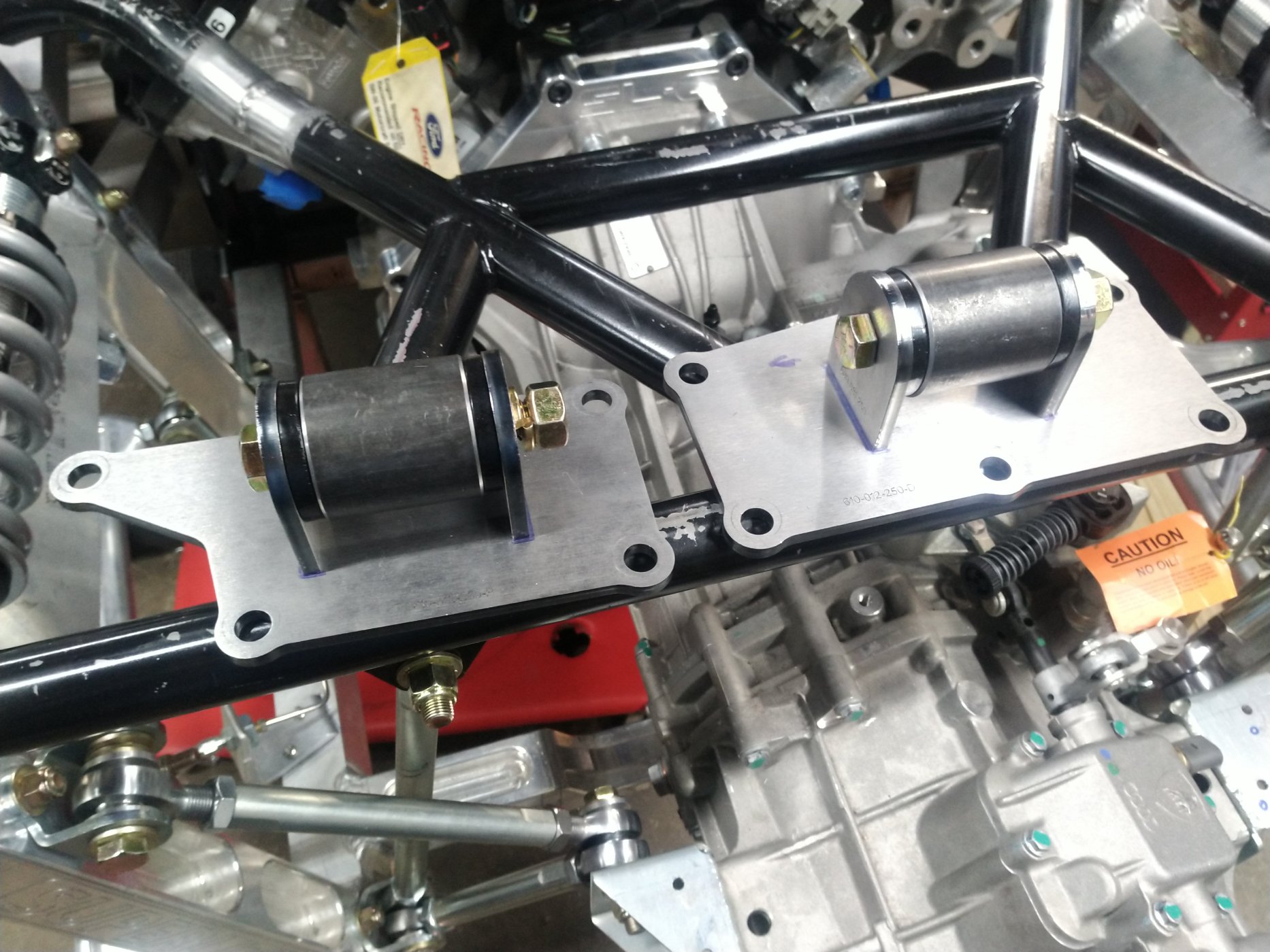

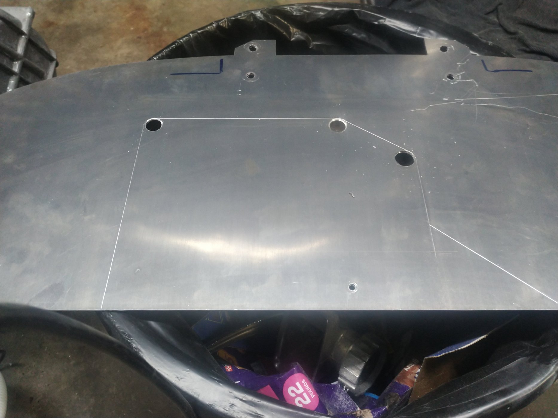

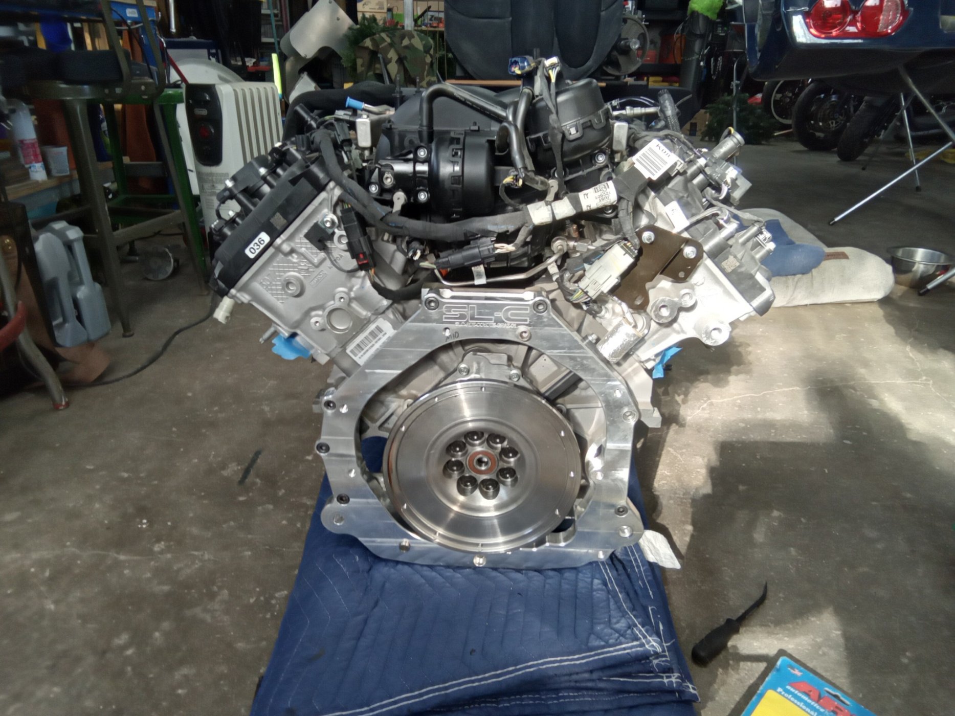

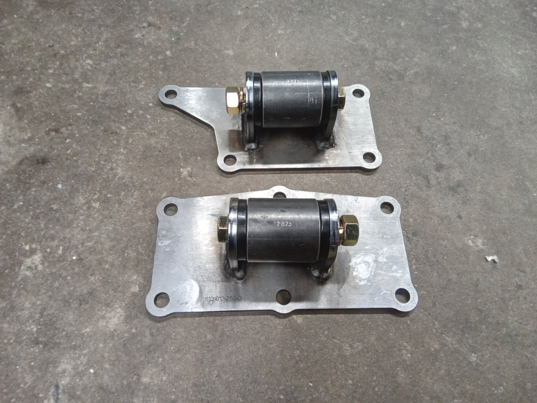

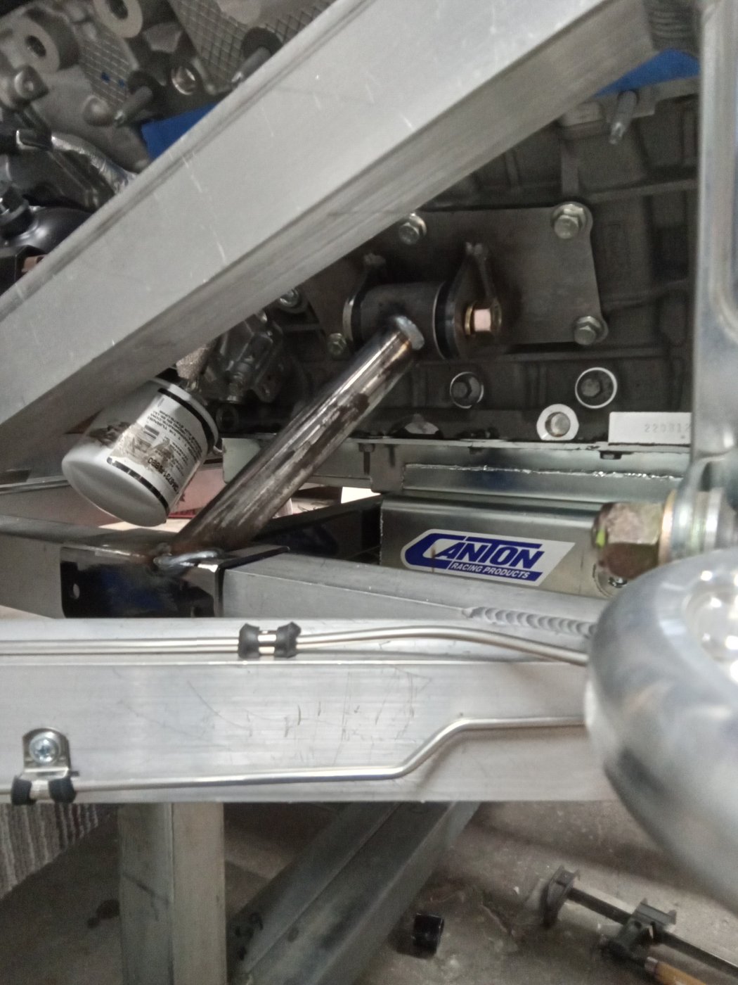

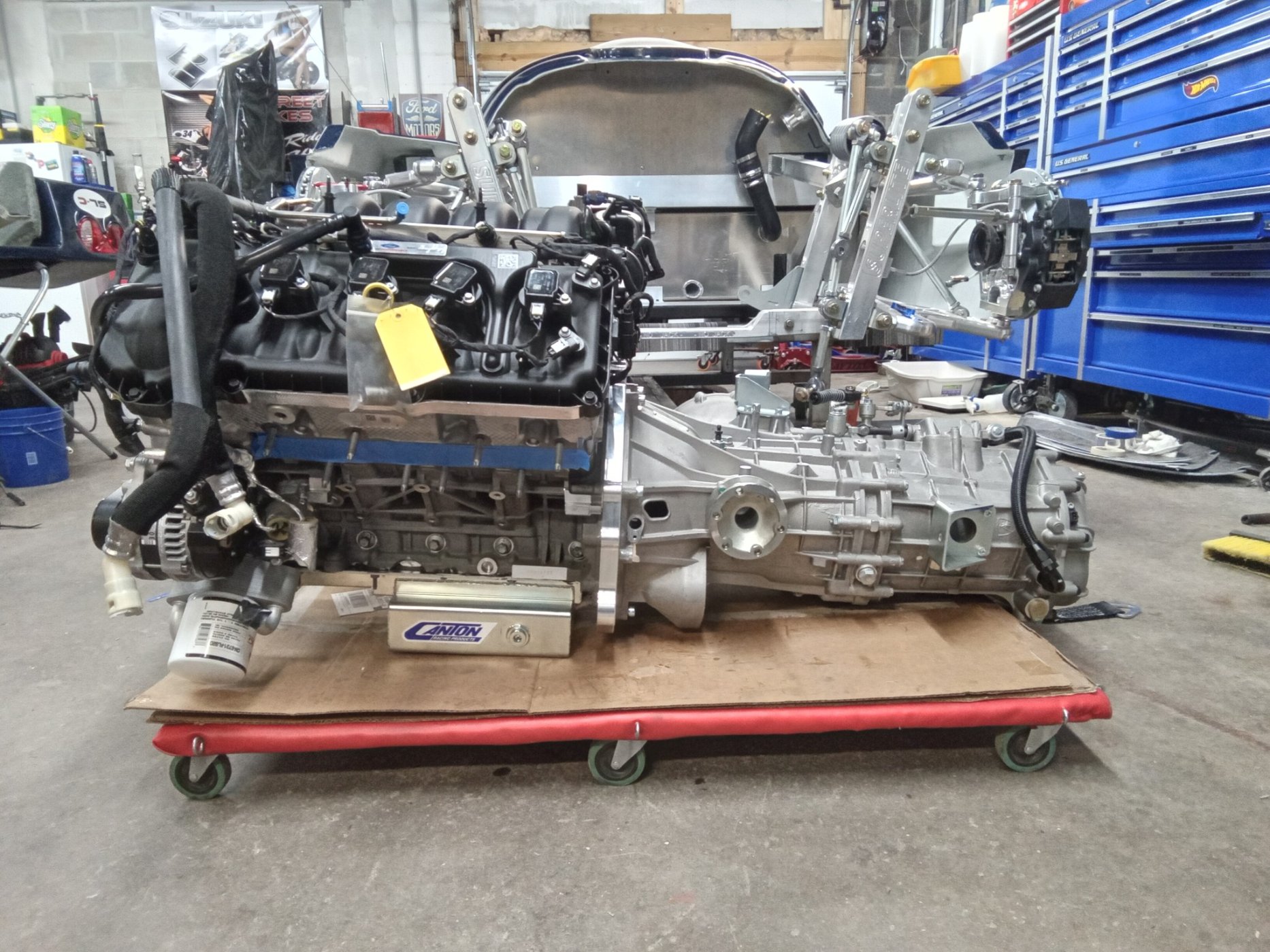

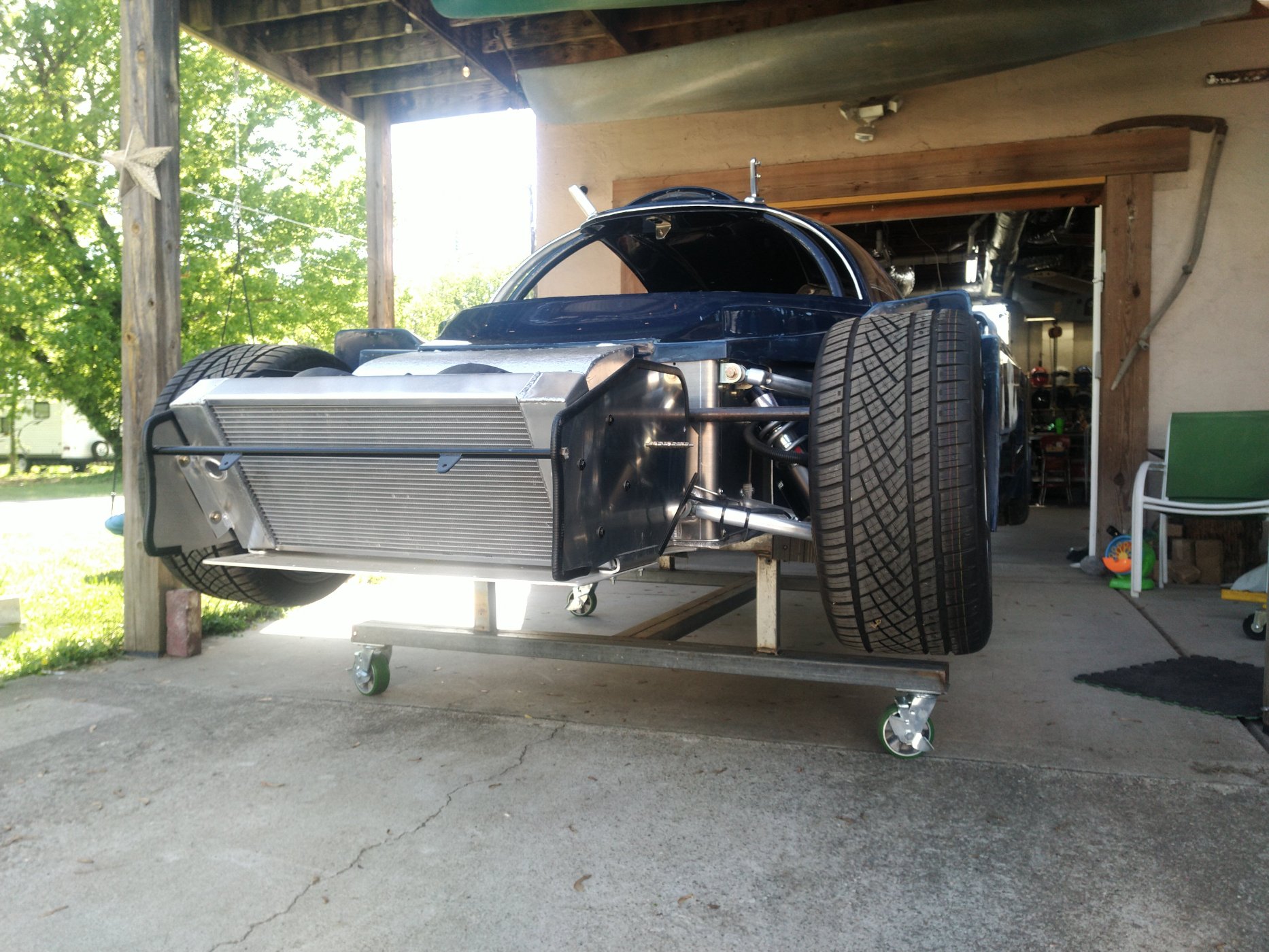

fitting the coyote. The front primary motor mount are tacked in waiting for a full weld when the clutch kit makes it in..

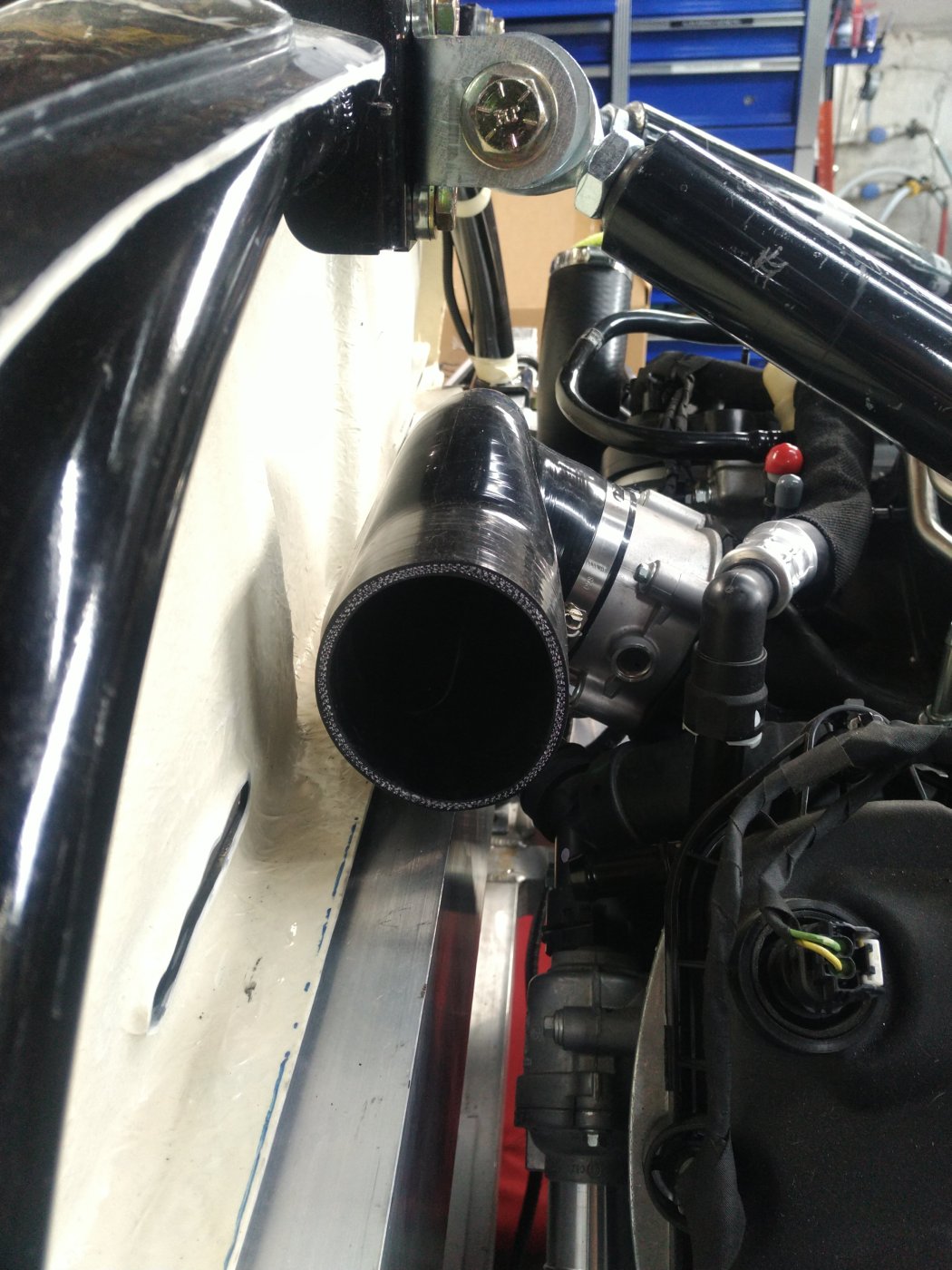

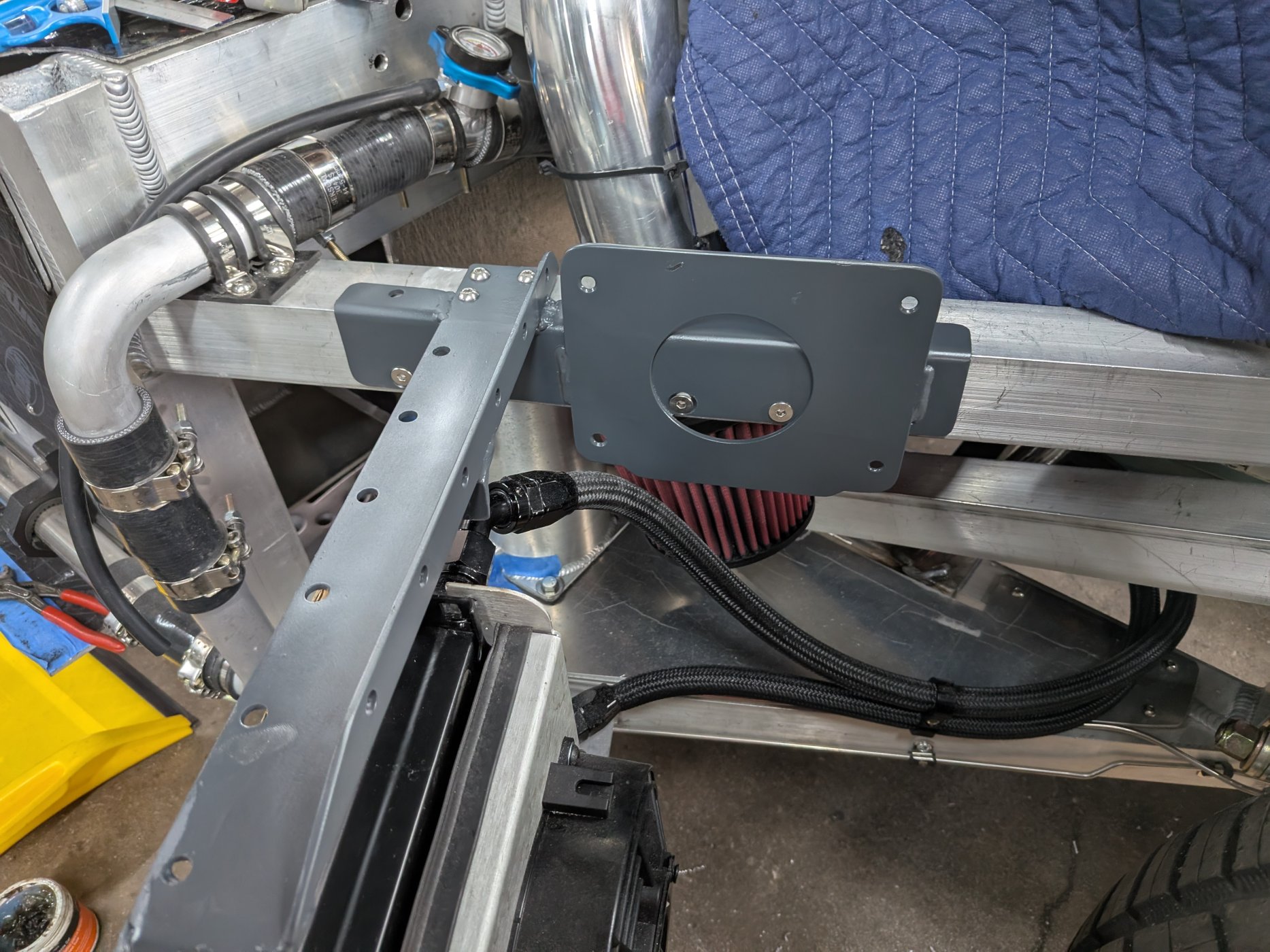

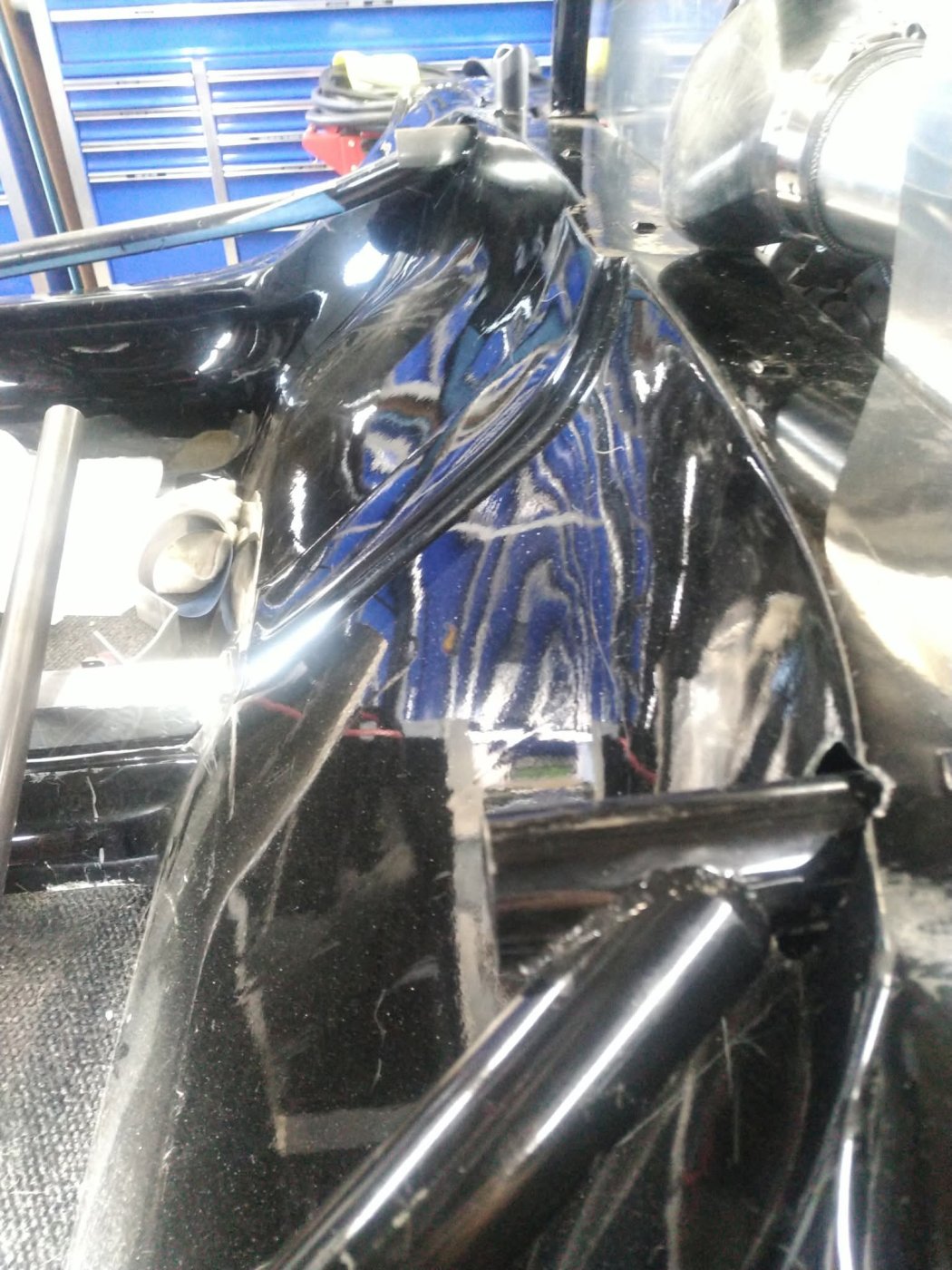

Joel Bailey

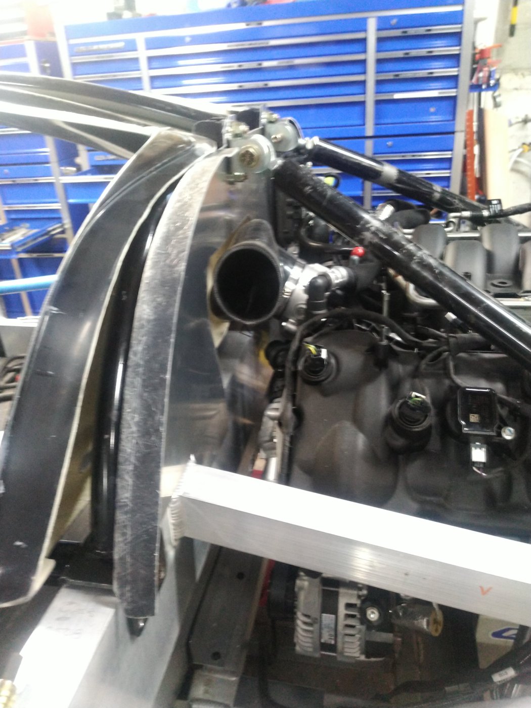

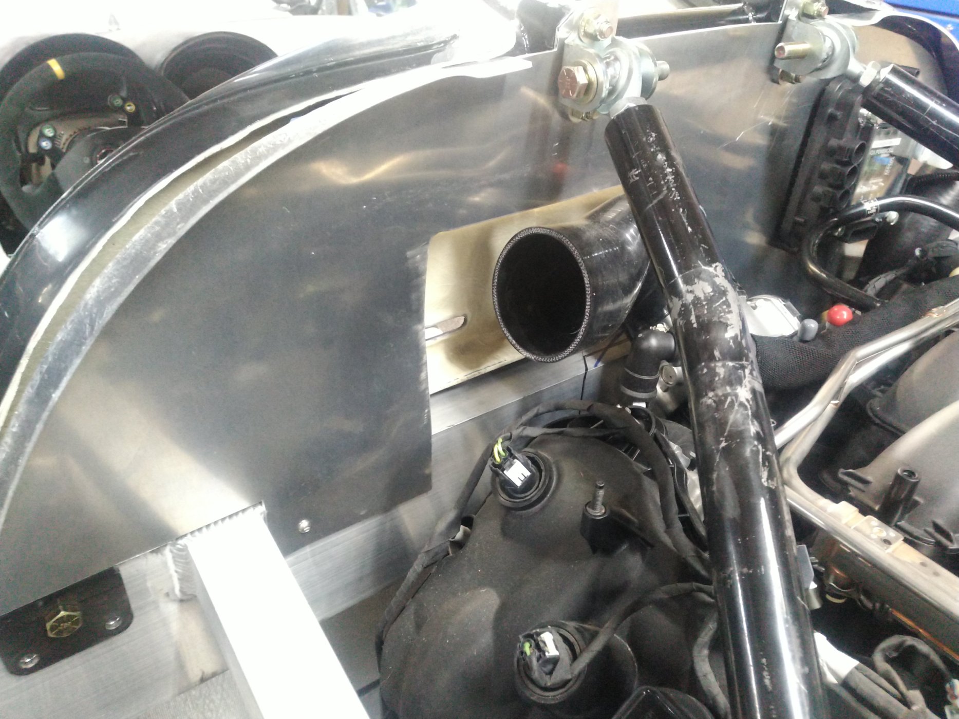

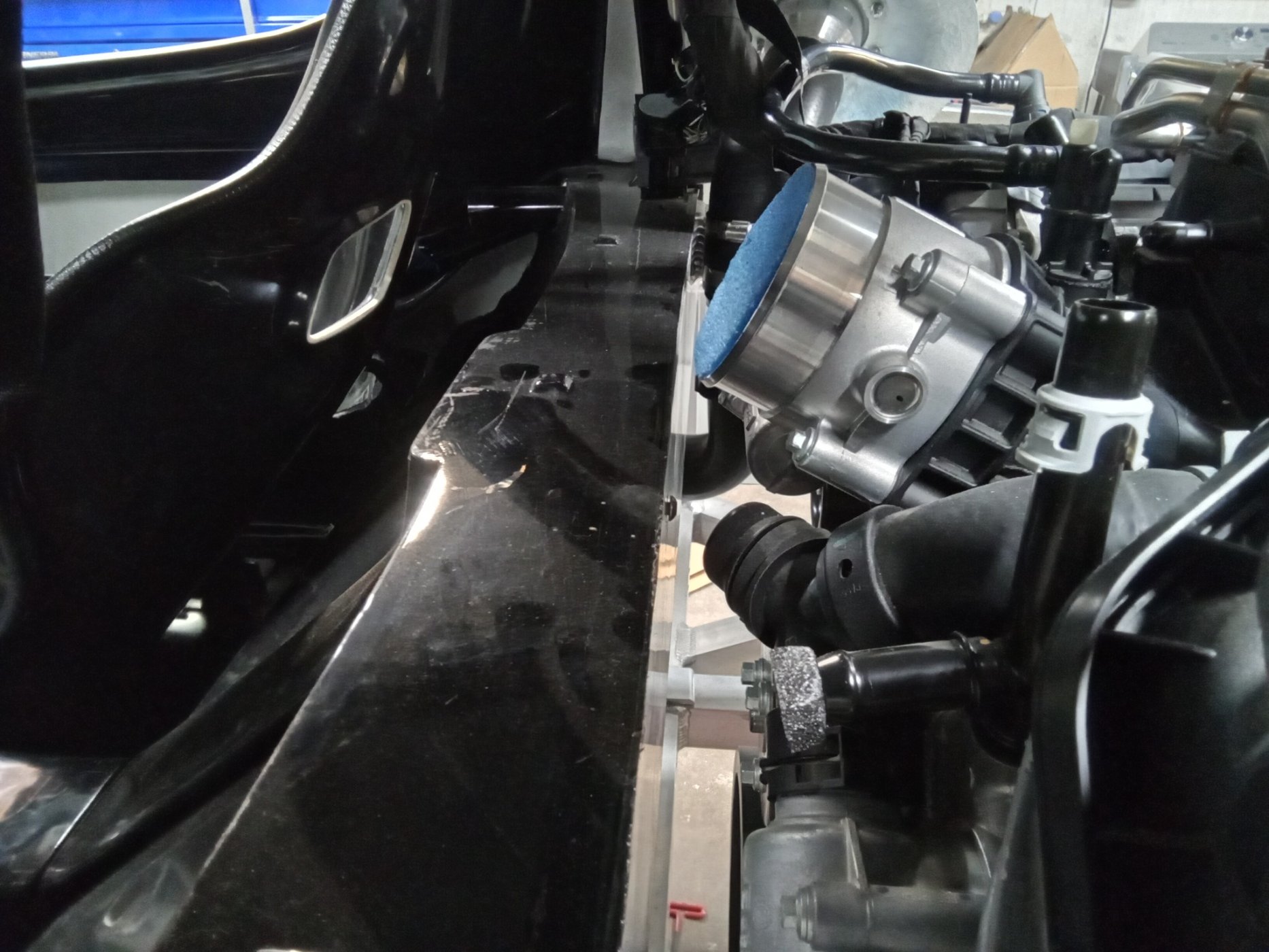

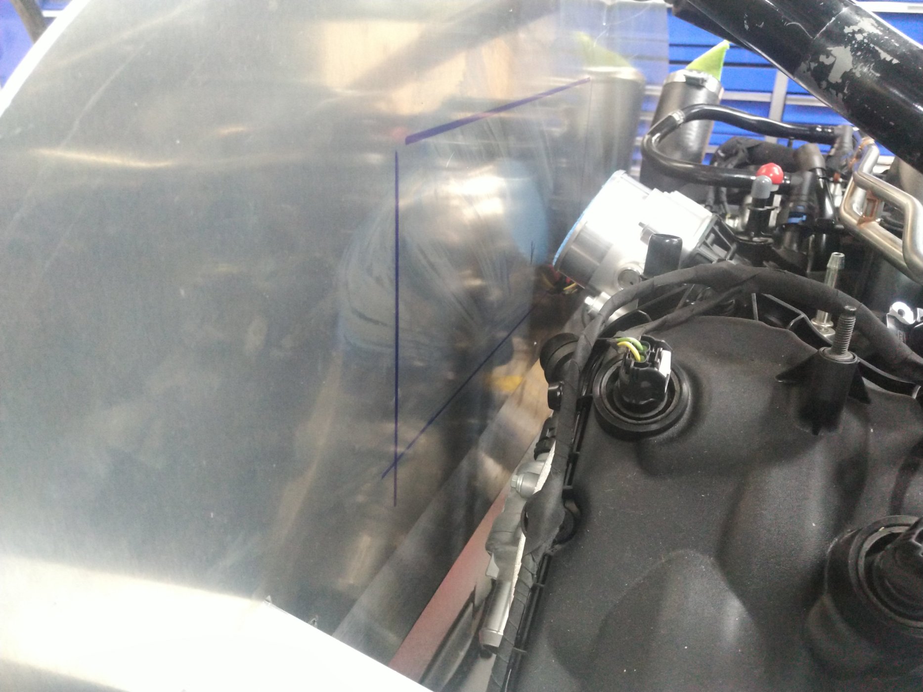

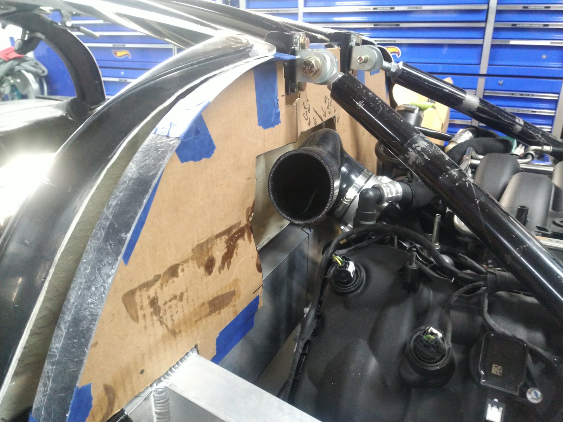

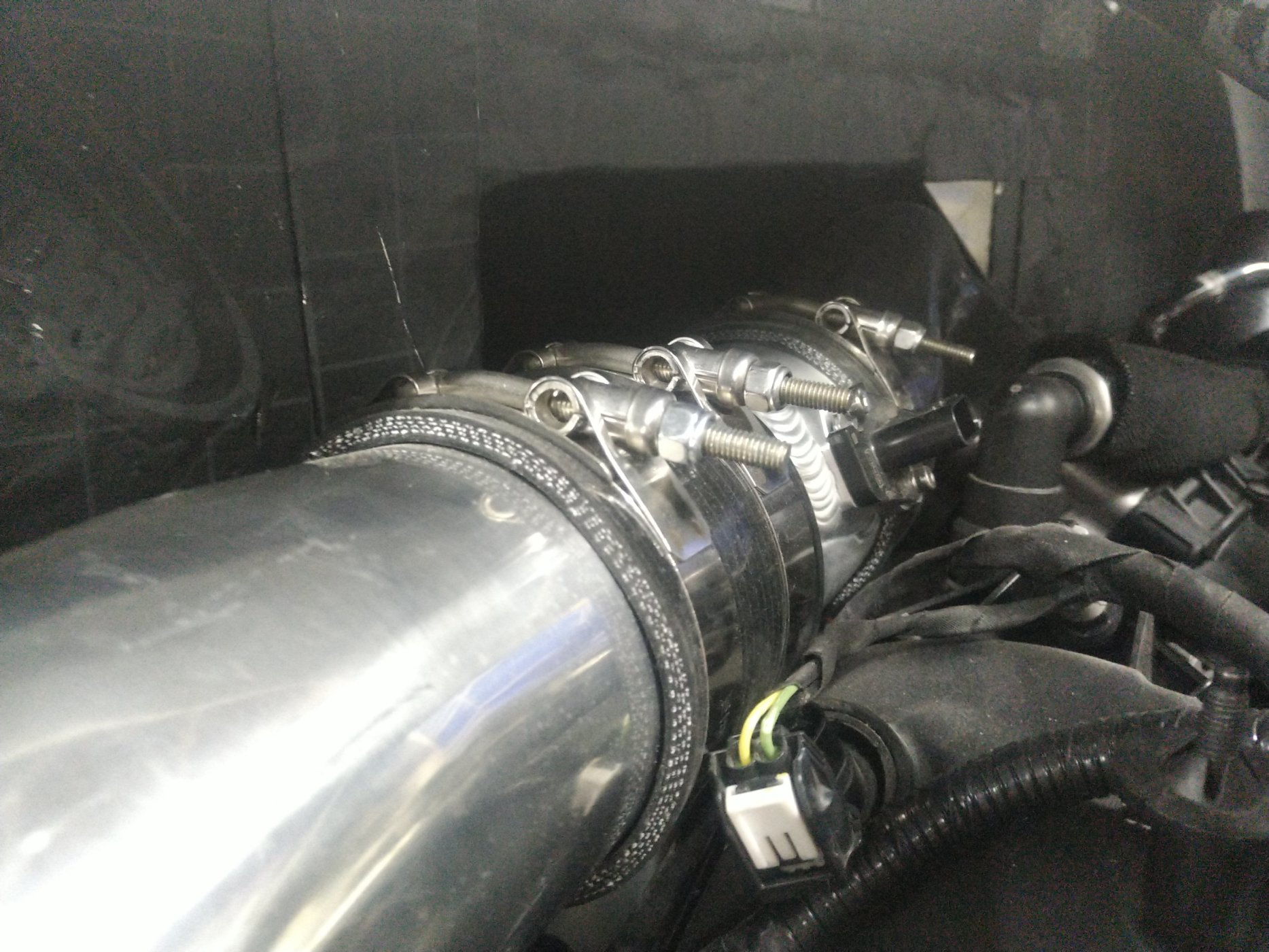

Hopefully solved this issue. Other parts of the intake are making their way in.. but I think I found the clearance I need. And still need to resolve the water outlet issue later when the motor and transaxle come back out..

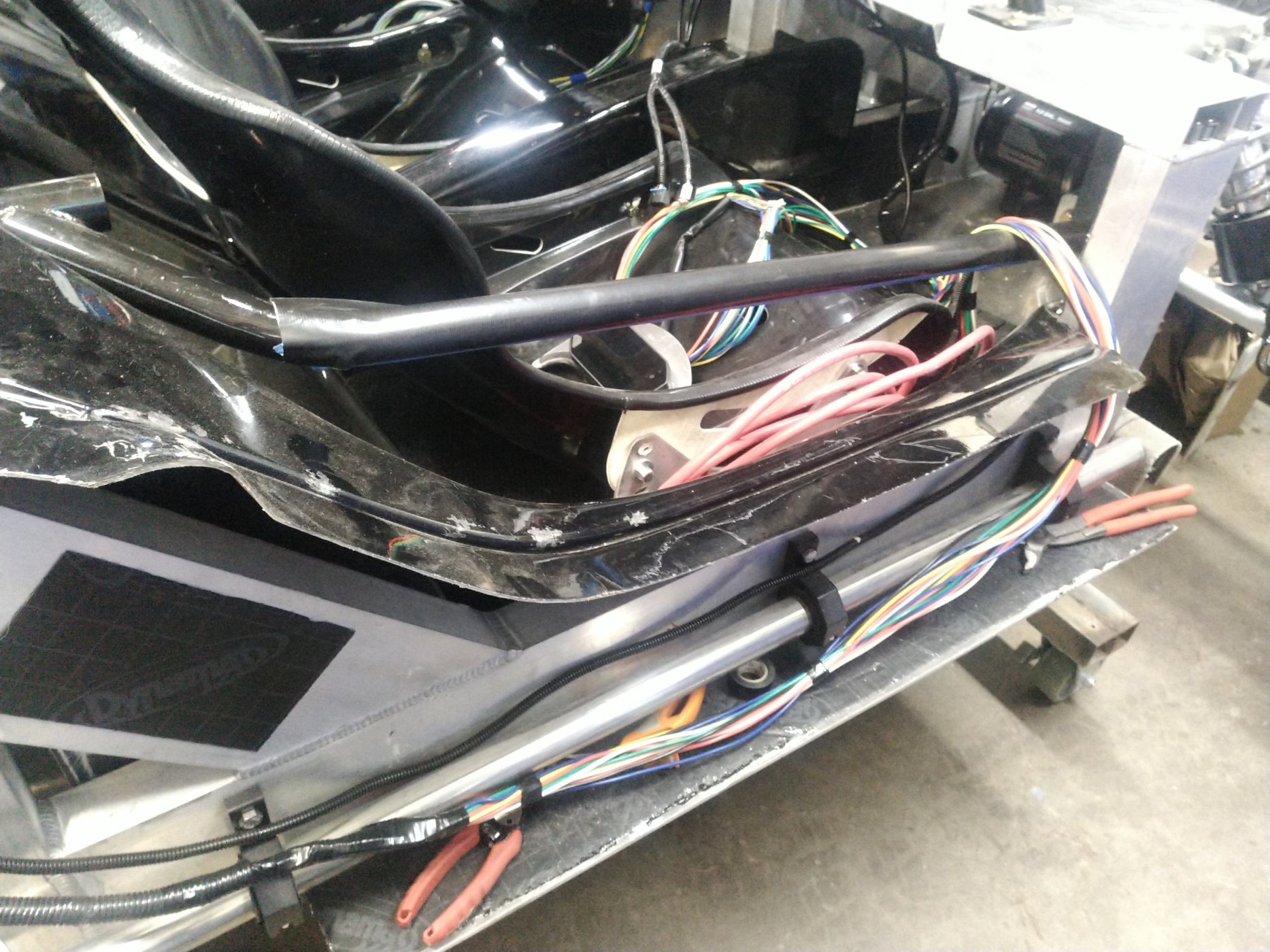

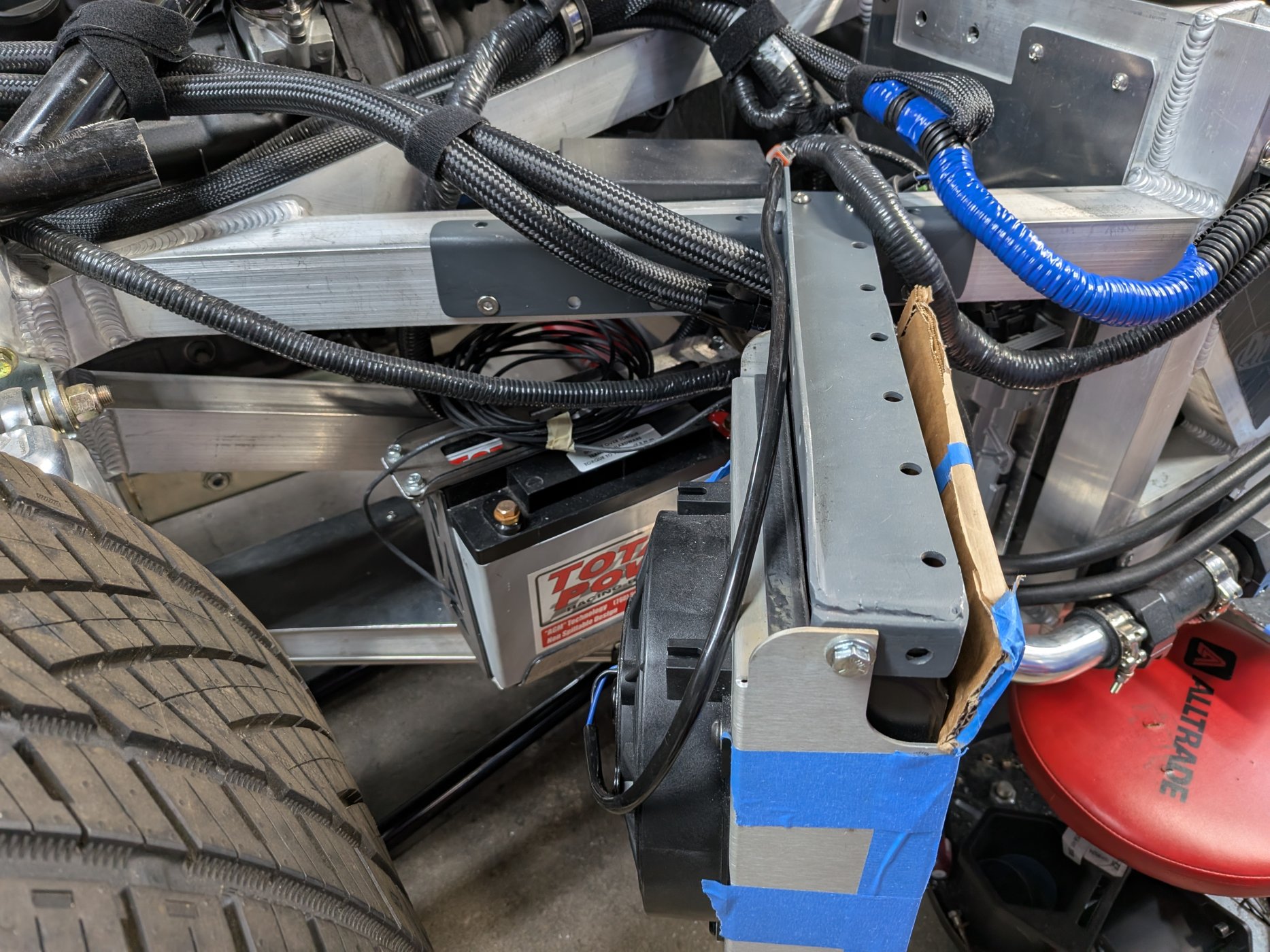

Joel Bailey

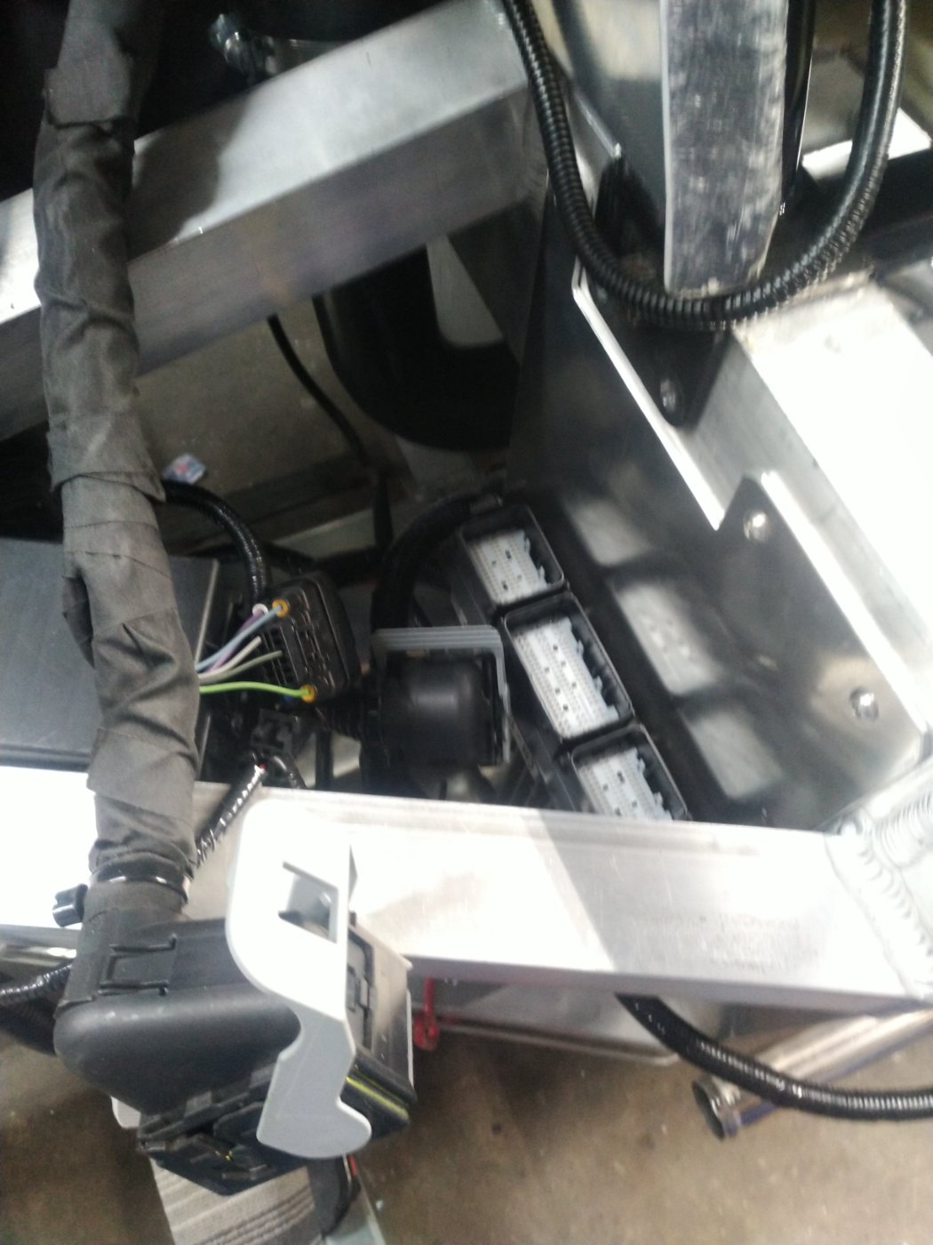

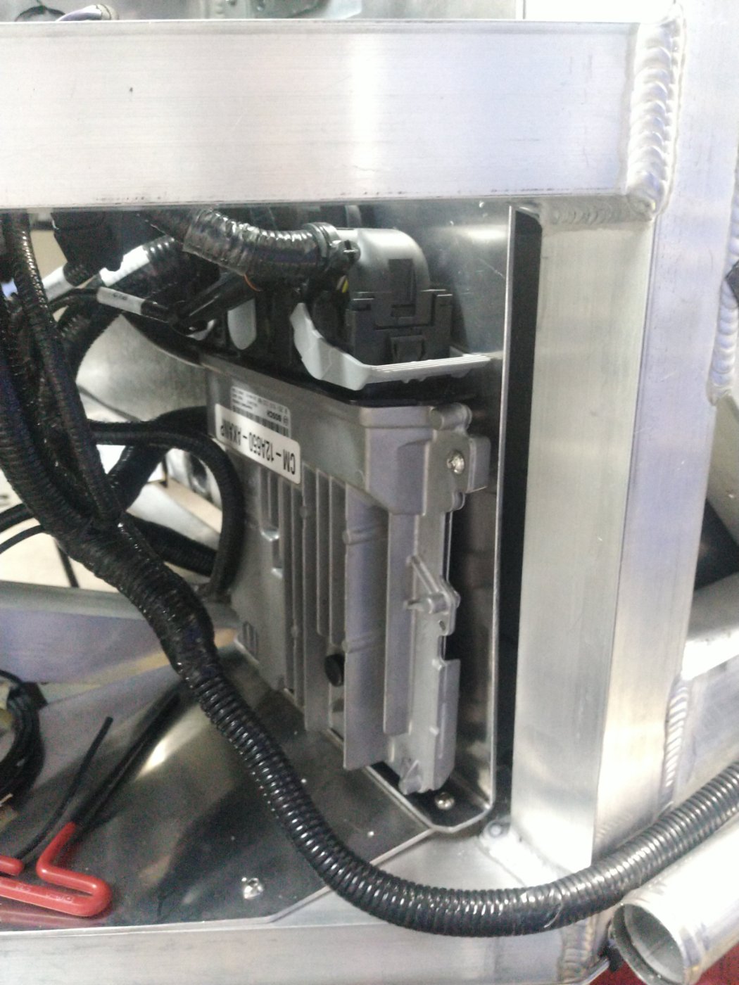

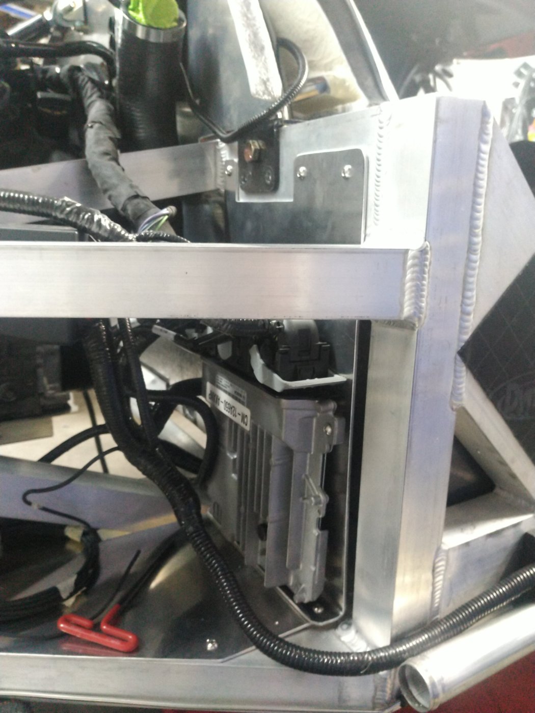

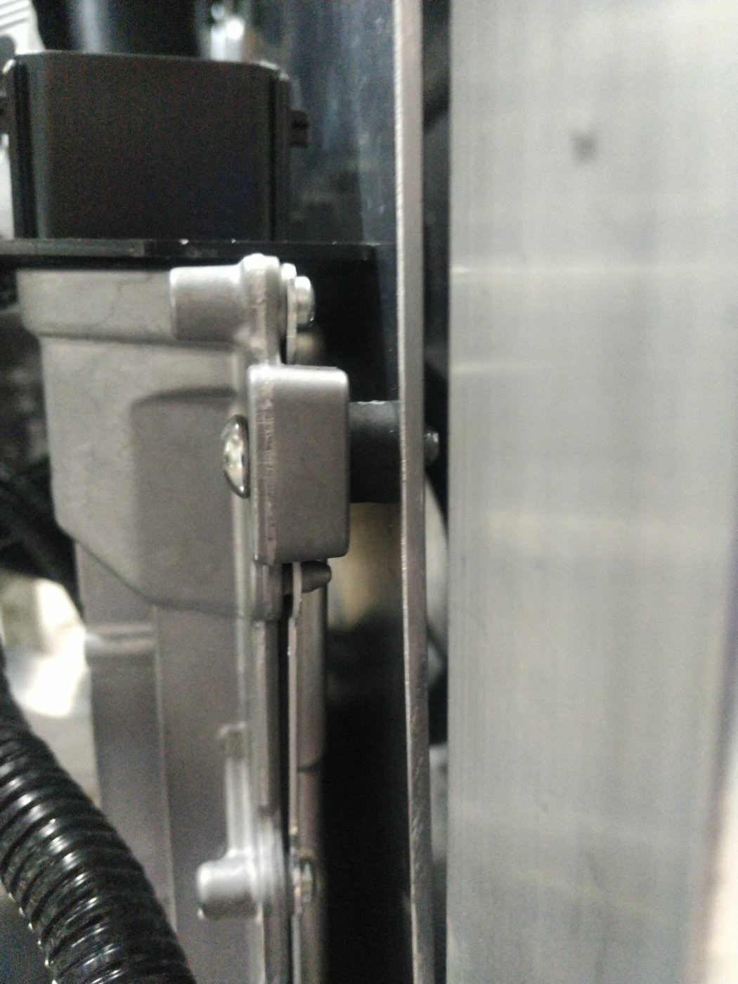

Some of the ECU placement . I figured this was about the best place for it to go as there's not really any images available to review , I'm not sure how many SL-C are out there with the coyote? I'm gonna guess less than five, maybe five? not sure.
Will be working out how all of the harness will be routed at some point , I'm trying not to have to cut into it just yet until I can optimize how it will need to go. The battery will be placed as close to the starter as I can but I believe it will get mounted to the floor plate by the ECU..

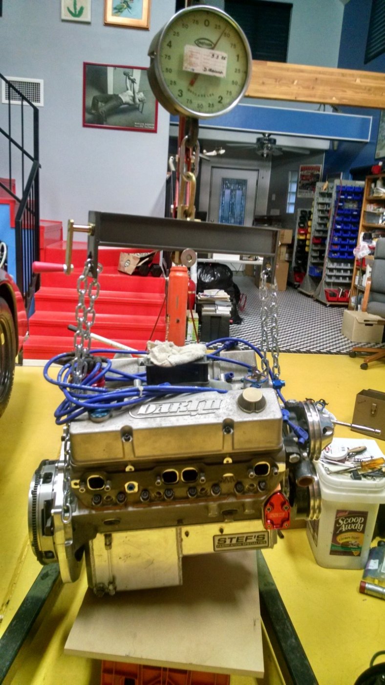

An aluminum block & heads can save a lot of weight over cast iron. My complete engine weighs only 395 lbs including flywheel. This even has a heavy forged crank. A stock iron block Chevy weighs 575 lbs.
