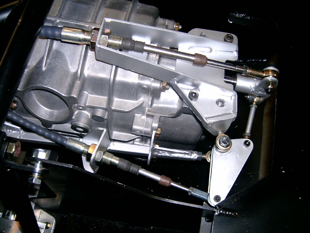

While waiting for the Axels to come I have made the shift linkage. Some very nice milspec control cables and 7075 aluminum parts that I made up seem to work great. Get the axels in next week and I think it time for a test drive.

nicely done and it will work great when everything is mounted not elastic. The lever for the side movement is fixed to the frame not to the gearbox. so if the engine turns within its mounts (with elastic or semi elastic mounts) there will be some movement implicated to the shift mechanism as well and possibly cause a missshift between 1st 3rd and 5th or 2nd and 4th.

Tom, Yes the motor and trans is solid mounted. There are some who say not to solid mount the motor but I see many who do. There is someone who makes a linkage mount that is attached to the trans itself and the rotation cable comes in and connects directly to the tail shaft at 90 degrees. I would have done this had it not been solid mounted but didnt really care for the way the cable routed.

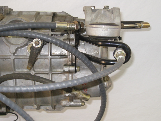

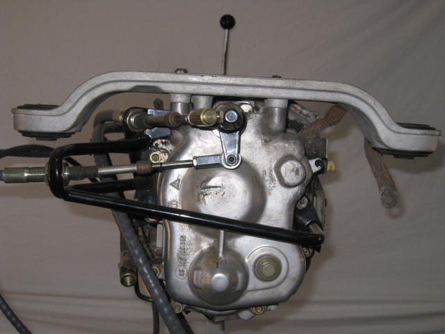

Chip, A couple of ideas for your shifter. First here is my solution for the gate cable. You can see that it is mounted to the gearbox. This ought to be pretty easy for you to make. I also have the original mount that came with the shifter. Here are pictures of both.
If you are interested in the black tubing type then let me know, I'm here in California and we can talk on the phone and work some thing out.

It is set up as a center seat mono posto and I will have to work with incorperating the porsche 911 roof line and windsheild into the C9 bodystyle. The shift linkage came out great and am very happy with it. With the solid mounted engine and trans it goes through the pattern as good as any factory 911 g50/52.
