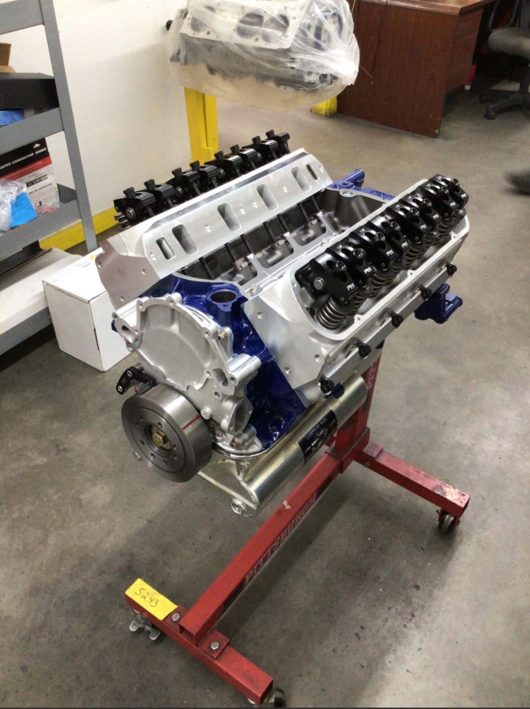

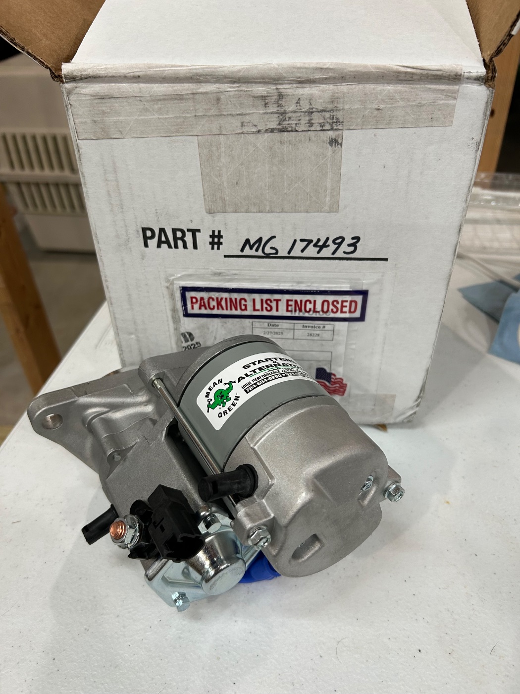

I think these are the same mini starters that are commonly used on small block Chevys. They were developed by Hitachi.This should turn the 347 over. I put the $150 Kennedy was gonna charge for an OEM 4-cylinder starter towards this. View attachment 145778

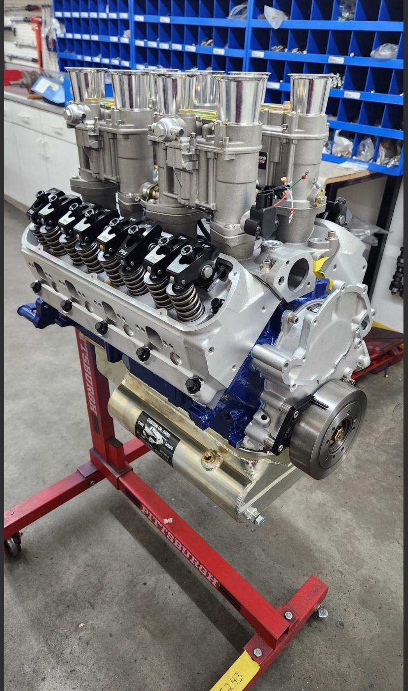

I’ve got an almost identical setup with my 347 & KEP starter. I’m curious how this works for you and how their stock Hilux starter compares once we both get to that point. Good work at sourcing it!This should turn the 347 over. I put the $150 Kennedy was gonna charge for an OEM 4-cylinder starter towards this. View attachment 145778
Amini starter is a DC motor running at high speed but with a gear train to reduce speed and increase torque, It draws far less current, too.It was mentioned in Buttinz thread when he was trouble with his OEM starter. I have a hard time believing a Toyota 4 cylinder starter will last long turning over a built 8 cylinder.
