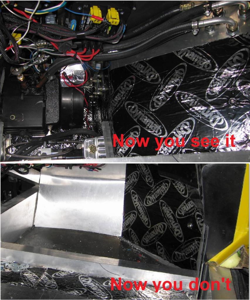

Personally, I'd minimize routing the lines where they will be exposed in the front wheel well. I routed my heater and AC lines from the engine up thru the top of the passenger foot well and I installed some additional bulkhead fittings to seal the opening and tuck the line up high so you don't see them.
I did a mock-up jig before drilling the bulkhead fitting holes in the footwell.
Note: I used a different HVAC air handler.
