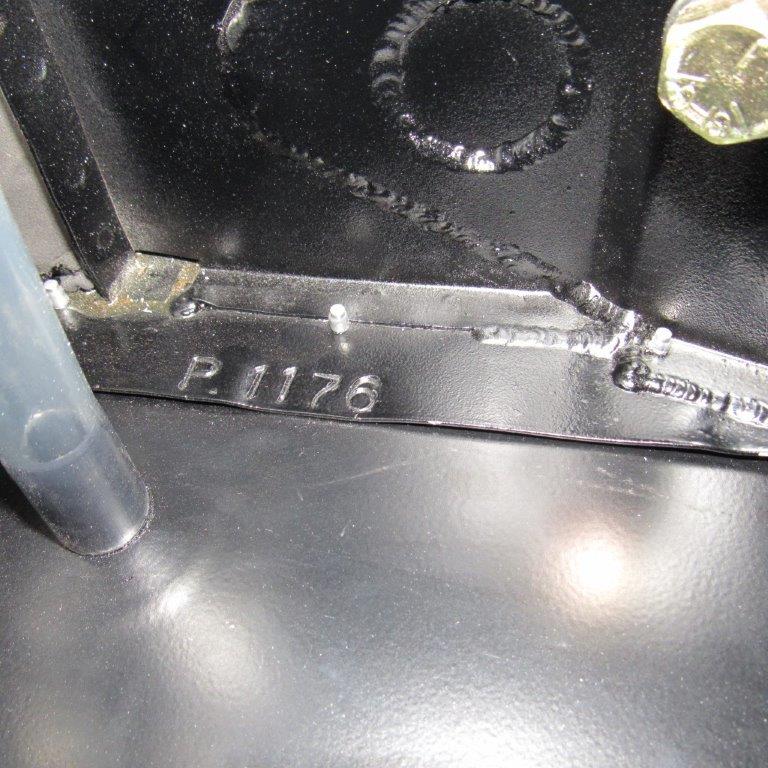

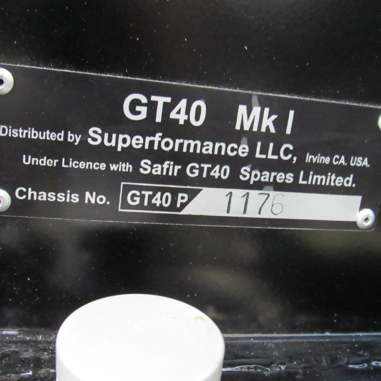

James, the riveted tag is on left back side of cockpit above fuel swirlpot location.Then stamped ones are on both sides under bonnet.

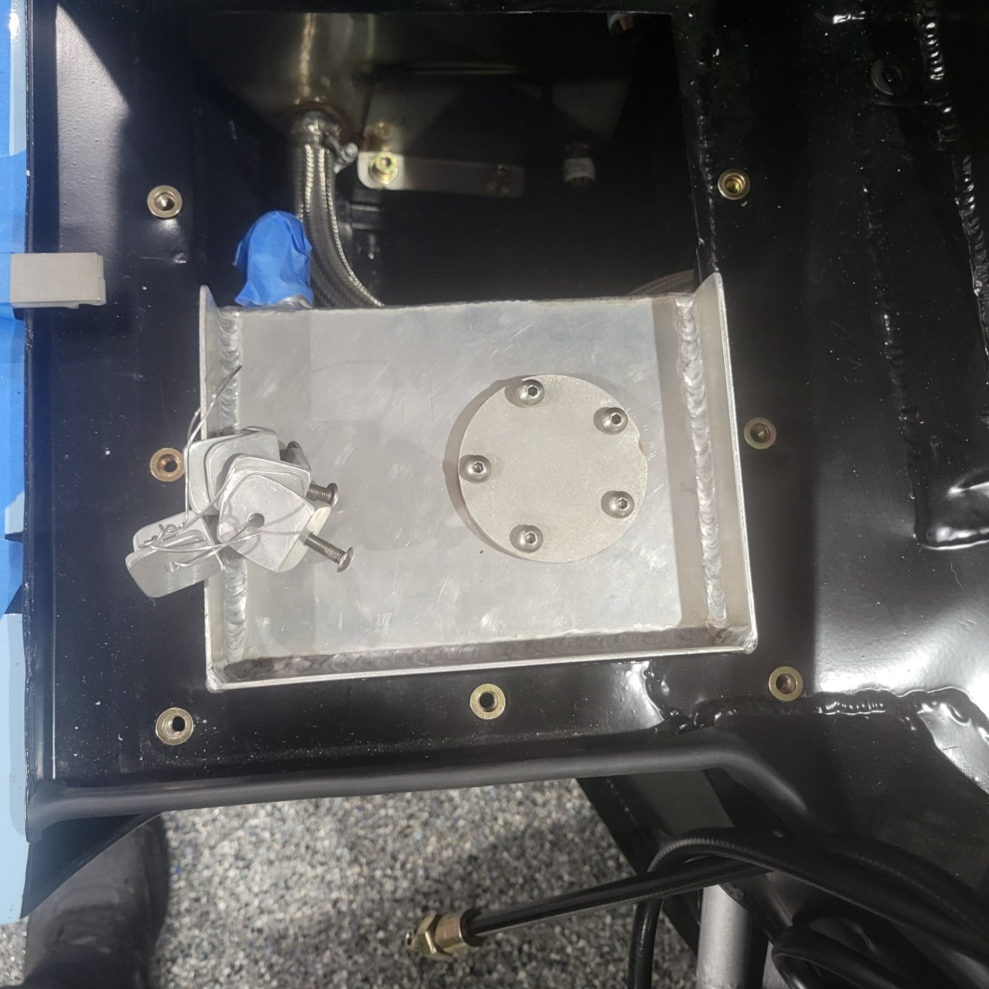

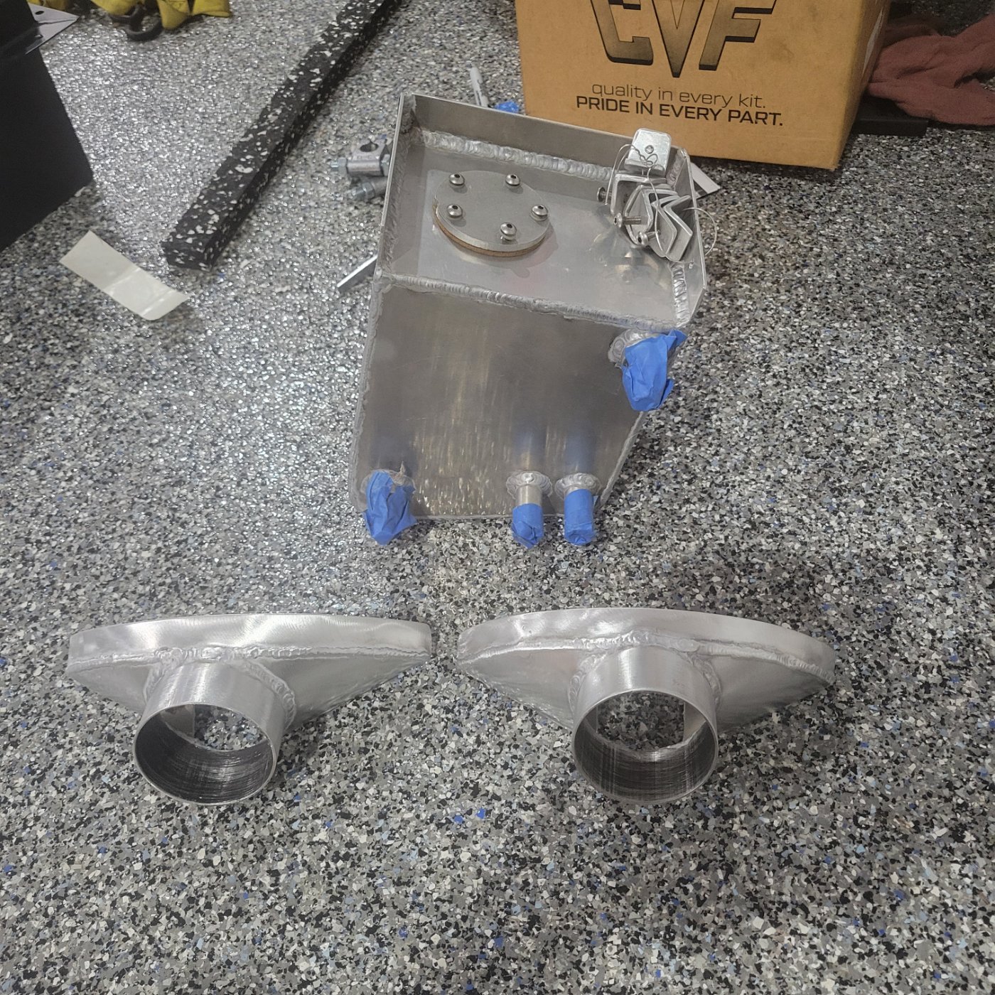

James, check out my build thread. Tool room minus Gurling brakes and AC added. Gurney Westlake engine with Webbers. Slide door handles. Wide body right hand drive. Gelscoe sand bent bundle of snakes. Here's a picture of swirl tank.
Mine is an as built tool room chassis. No A/C, cooling fans, speedometer, etc. Mine does not have a swirlpot.

Swirl pot is hand made and not part of the order. It is a must when tracking the car because the fuel slosh forward on hard braking and pumps will loose prime.

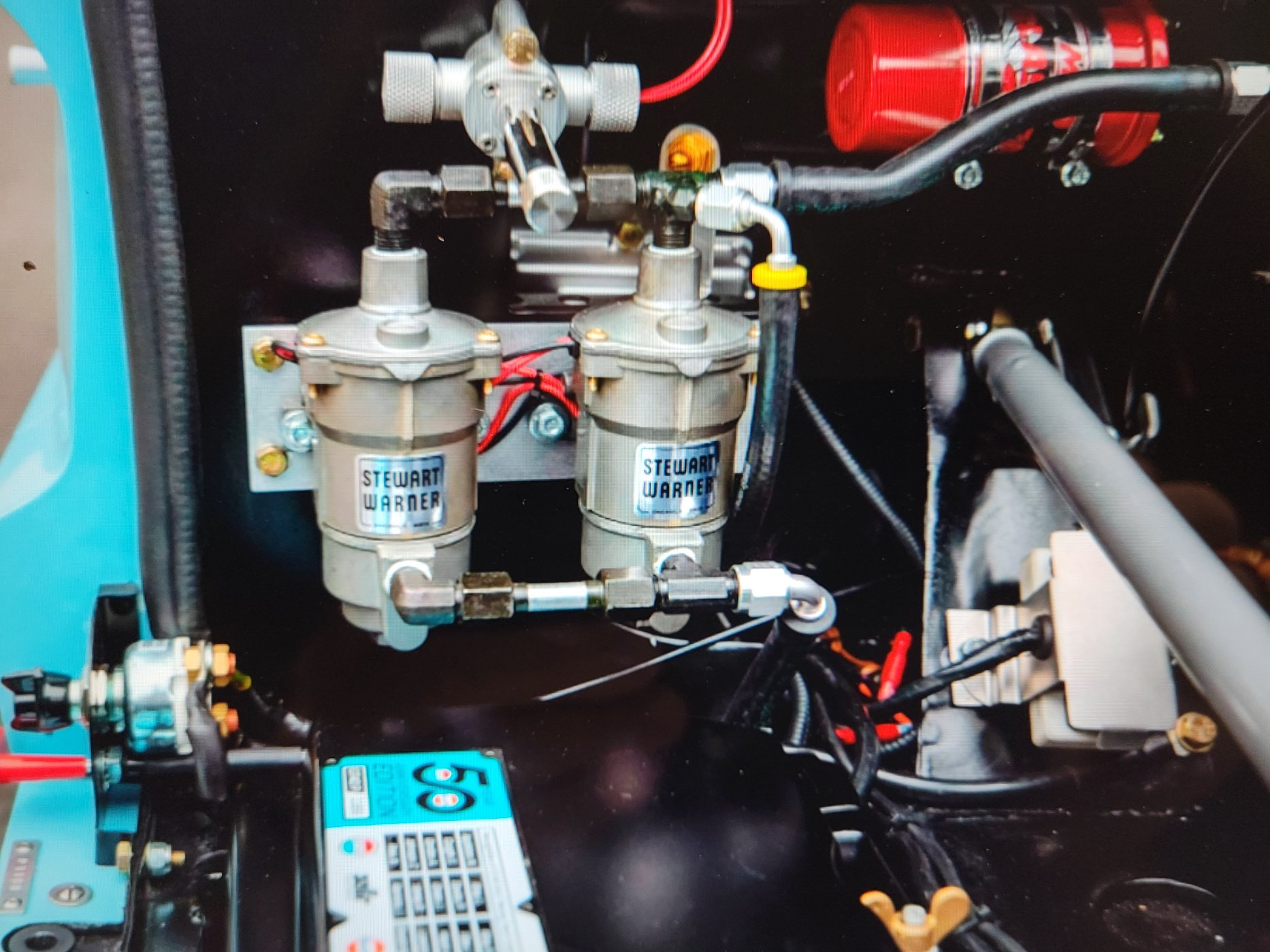

James everything I see on the toolroom has the large 50th plate riveted to the left side on the cover for fuel tank access. They did not give up any pictures of chassis number. You should have received it in the mail after your car arrived. Have you started a build thread? I have a picture showing the plate location on my phone I will add. I would technically call mine a 50th Anniversary car as I added AC as I live in Florida and plan on driving the car. Also the fuel pumps in this picture of their Toolroom car are not correct.

James in the picture with the wrong pumps you can see the small riveted tag on the outer edge of the top of the rocker sill. It looks like the large flat plate they used to mount the pumps would cover the plate and you don't see the Superformance plate on the left side as mine has. I also received the larger Toolroom plate with my car and also say 50th edition . I think Superformance will call it what ever you want to call it for the right price..

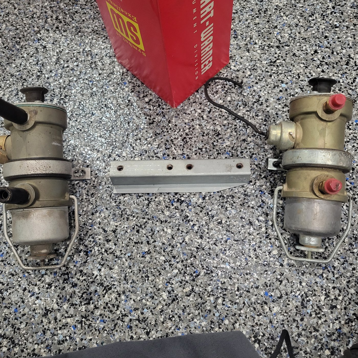

I posed this question about the chassis plate because when it’s time for me to register my chassis, I don’t want the DMV to have an issue with the chassis plate that’s riveted to the fiberglass rocker panel. Chassis/VIN plates must be part of the chassis itself. I don’t know why the 50th anniversary plates weren’t installed at the factory or a chassis plate like all the other non-tool room cars wasn’t used but attached in a different location since the original Stewart Warner pumps would be in the way.
