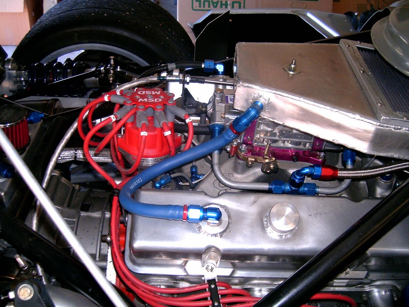

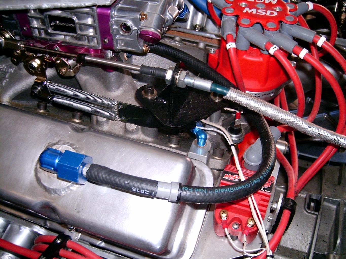

Fully in compliance with California SB100 smog requirement. Yes sir, I installed a crank case ventilation system just like you said, sir.

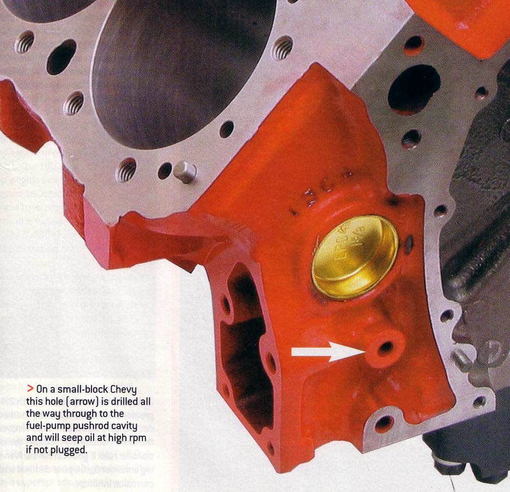

Went looking for the oil leak. Sometimes things are so simple they make you what to cry. What's funny is all three of the others are filled with hardware. The only one I didn't use was the one that leaks.
