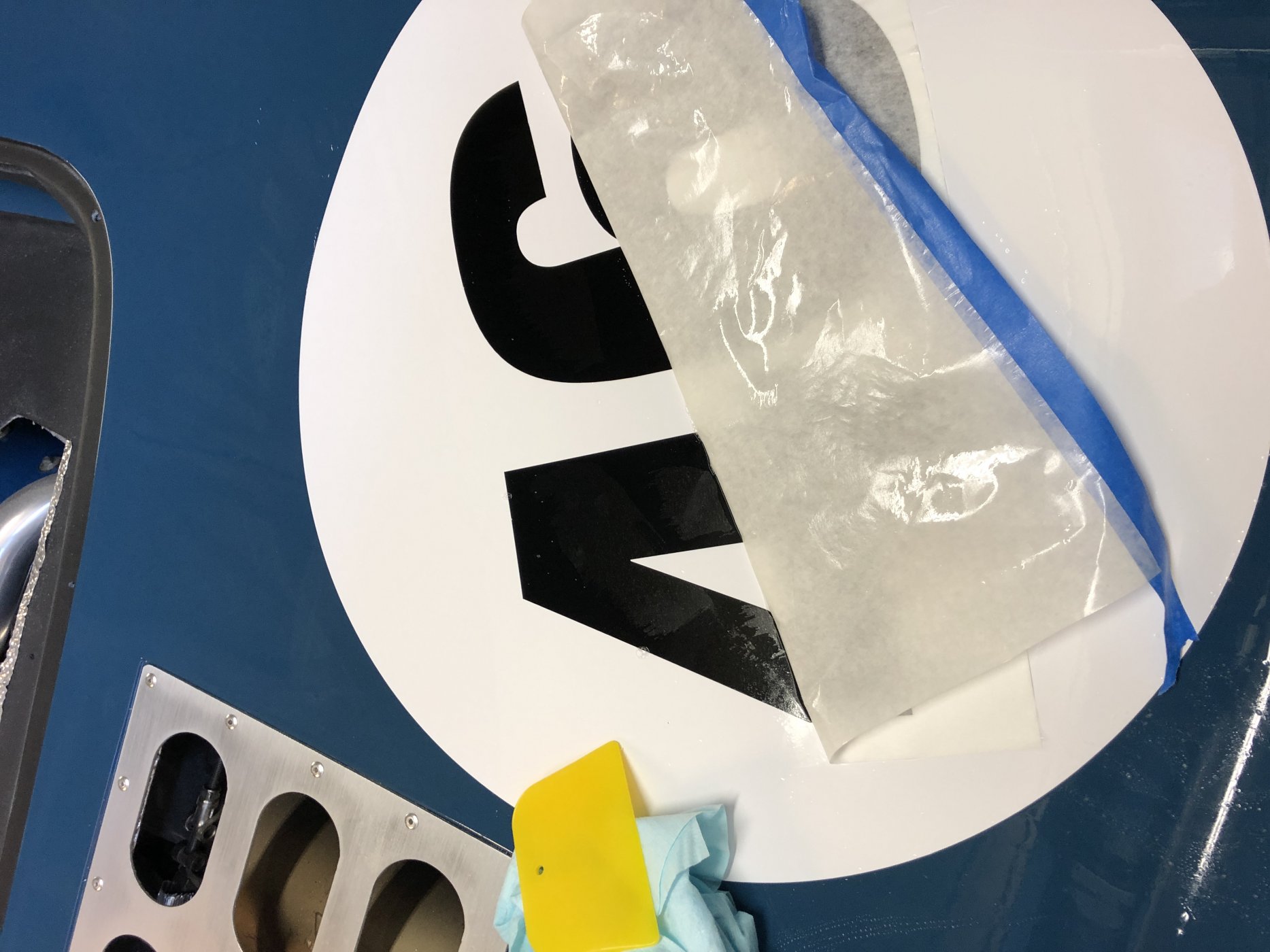

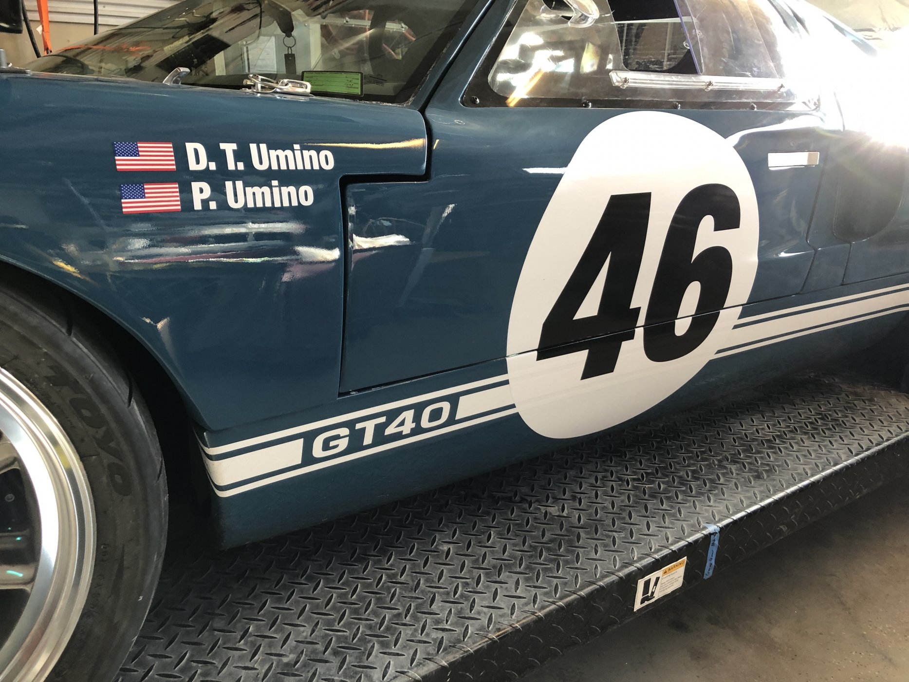

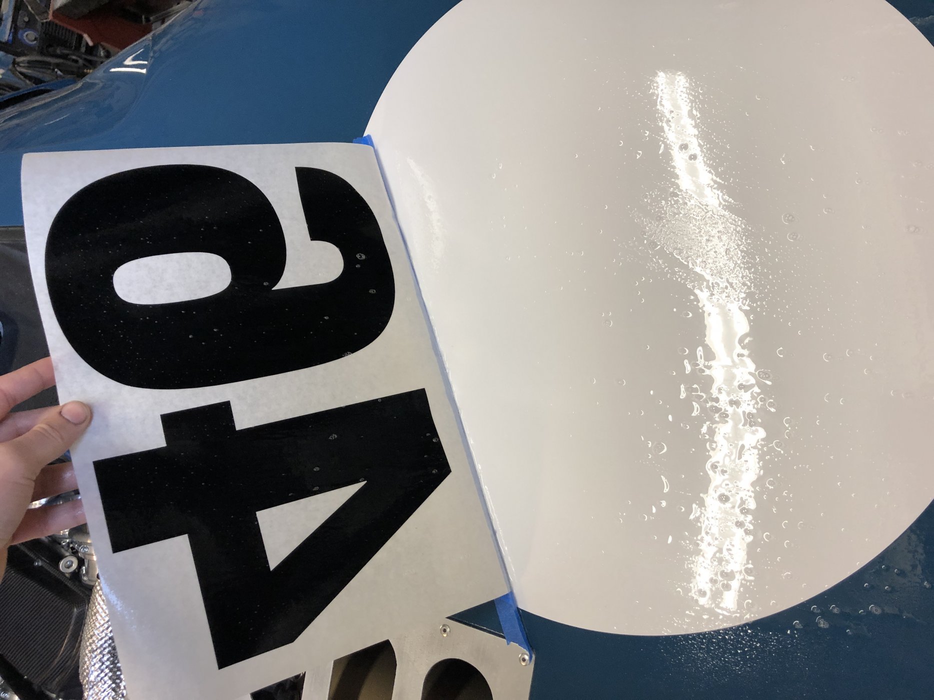

Got the #’s on!

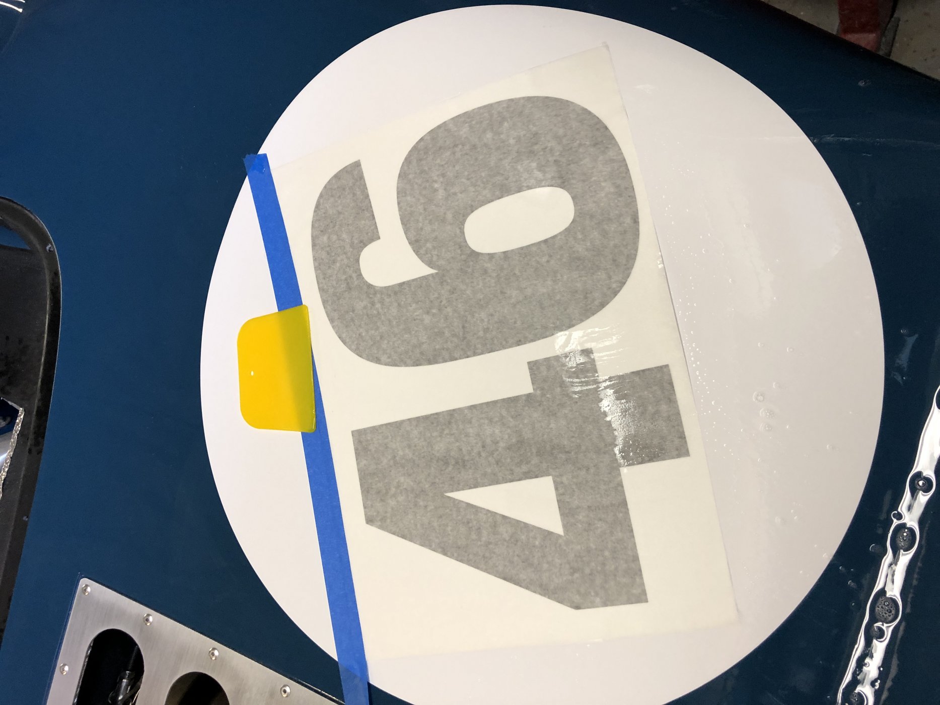

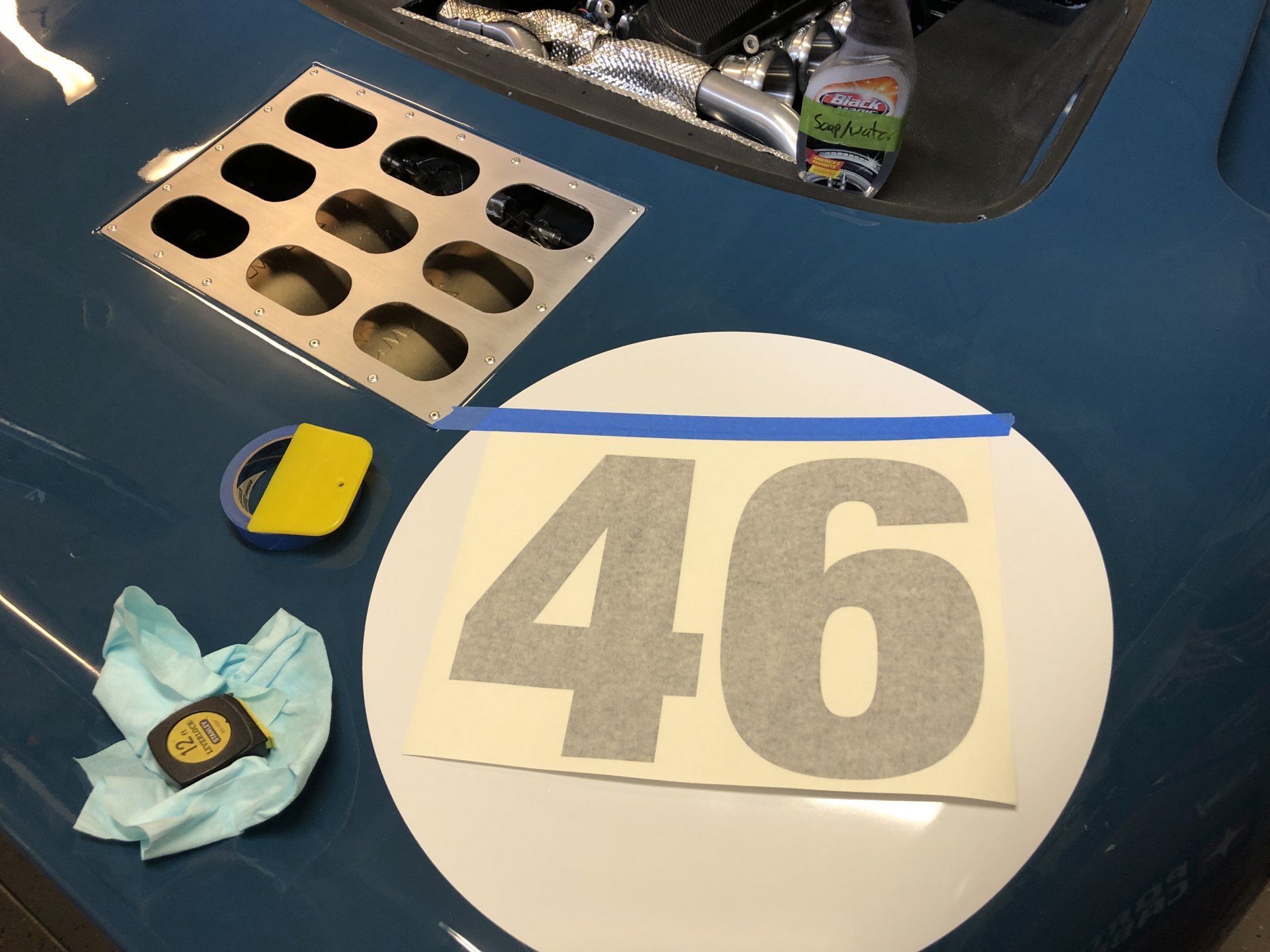

took awhile, but got a good process figured out for repeatable results.
1st: align the number as needed, then tape the top edge
2nd) peel the bottom paper off and spray a good amount of soapy water.
3rd: lay back down, use a rubber squeegee to get most of the bubbles out
4th: peel the top layer off, and continue to squeegee. I use low heat for any areas I need to wrap around an edge.
final product:

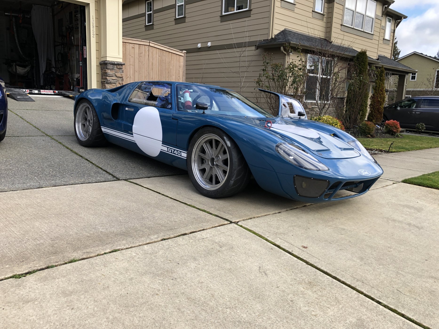

seattle got a few sunny days, couldn’t resist a brief drive!

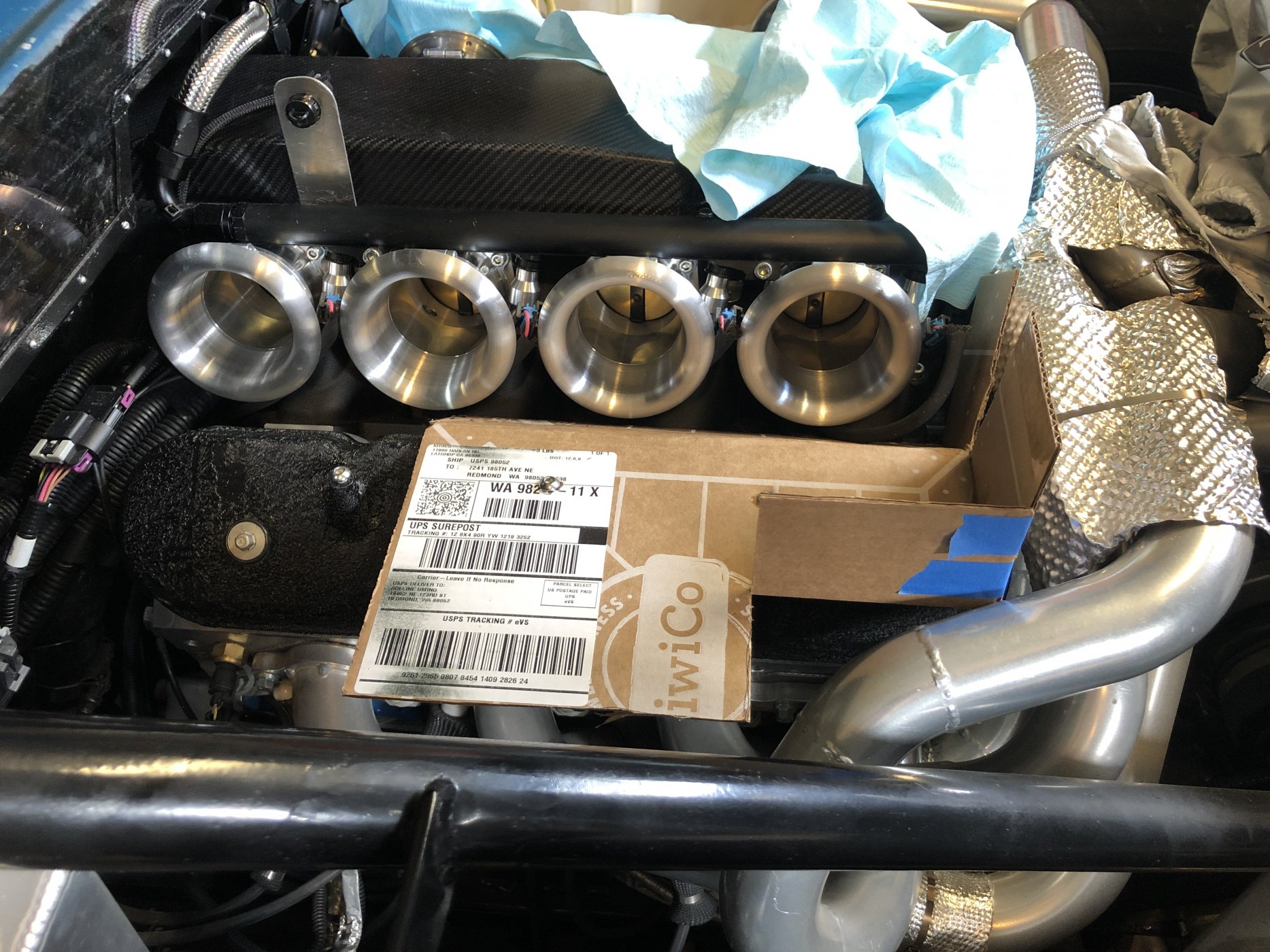

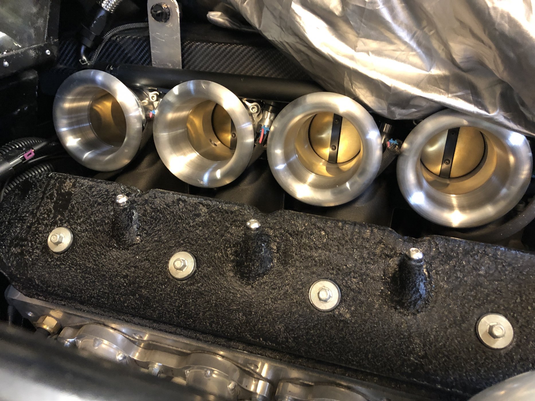

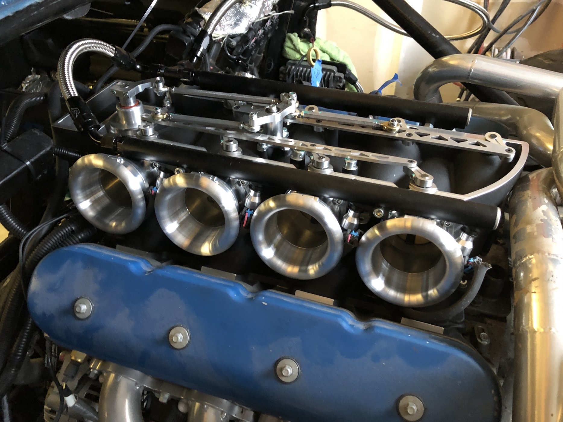

I had 2 main objectives for this winter, paint, and reinstalling the ITBs. I had initially installed these over a year ago...but was having high idle issues and lots of backfiring. with so many other things to get done, I swapped to a standard intake manifold and focused on getting it driving.

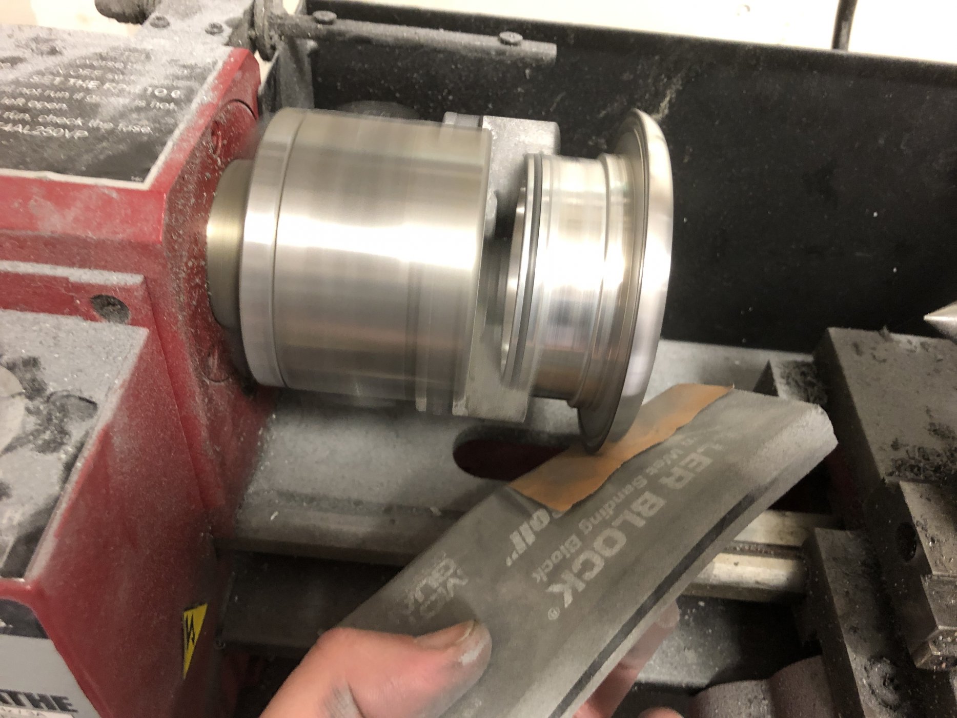

The previous set up I had tried to make an intake box around the ITBs, and then join them together so that I could use the MAF...as I continue to hear how hard it is to tune ITBs on the OEM ECU. I had scratched the inlet trumpets as I made/installed that previous manifold....I used my HF lathe to help me sand out those scratches.
This time around I've got some help to hopefully do a speed density tune and ditch the MAF...since the MAF has the IAT (Air Temp) integrated, I had to split it out and add just a temp sensor
While doing some data logging to improve the tune, I knew the local Cars & Coffee was also meeting...couldn't resist stopping by for a short while.

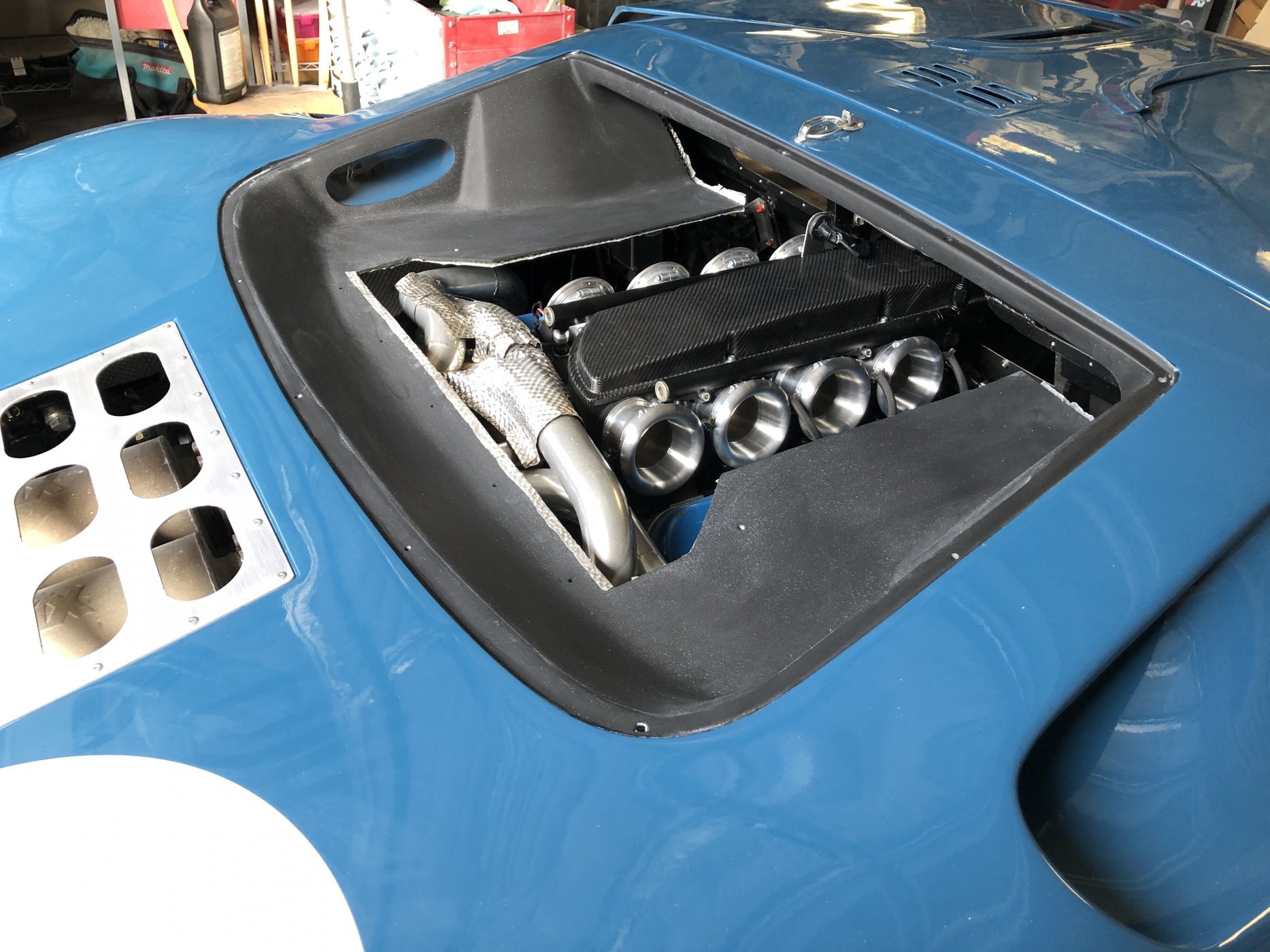

I've still got a good amount to finish up here...reinstall the exhaust heat shield that goes above the exhaust, and then add some type of metal surround around the engine that will have a simple bulb seal to the rear clamshell to help keep fresh air going into the engine.

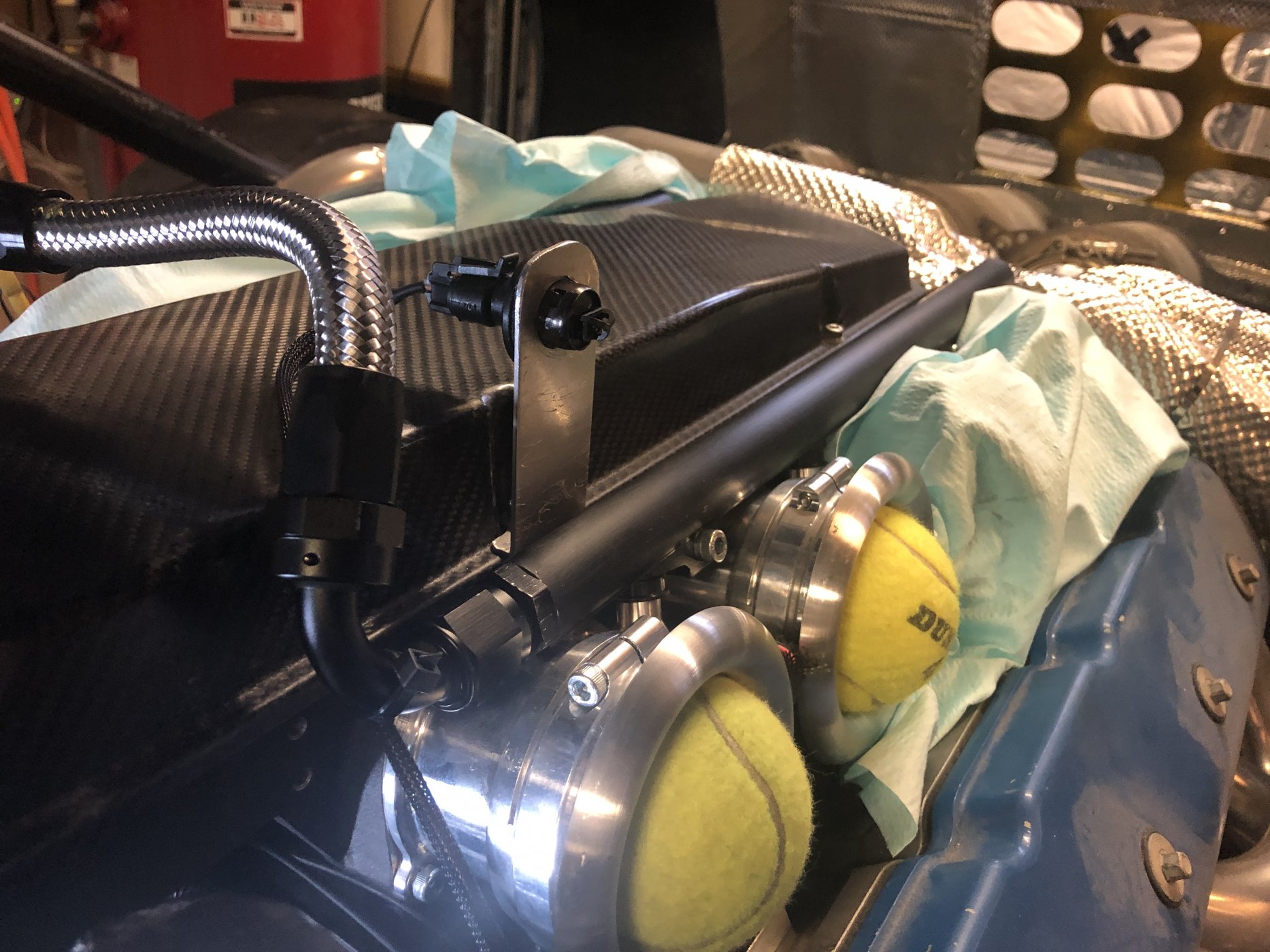

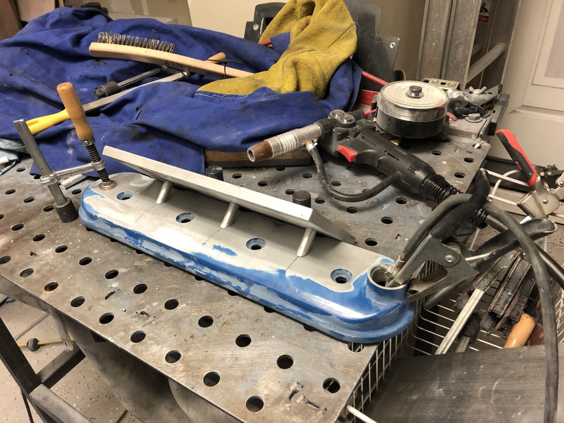

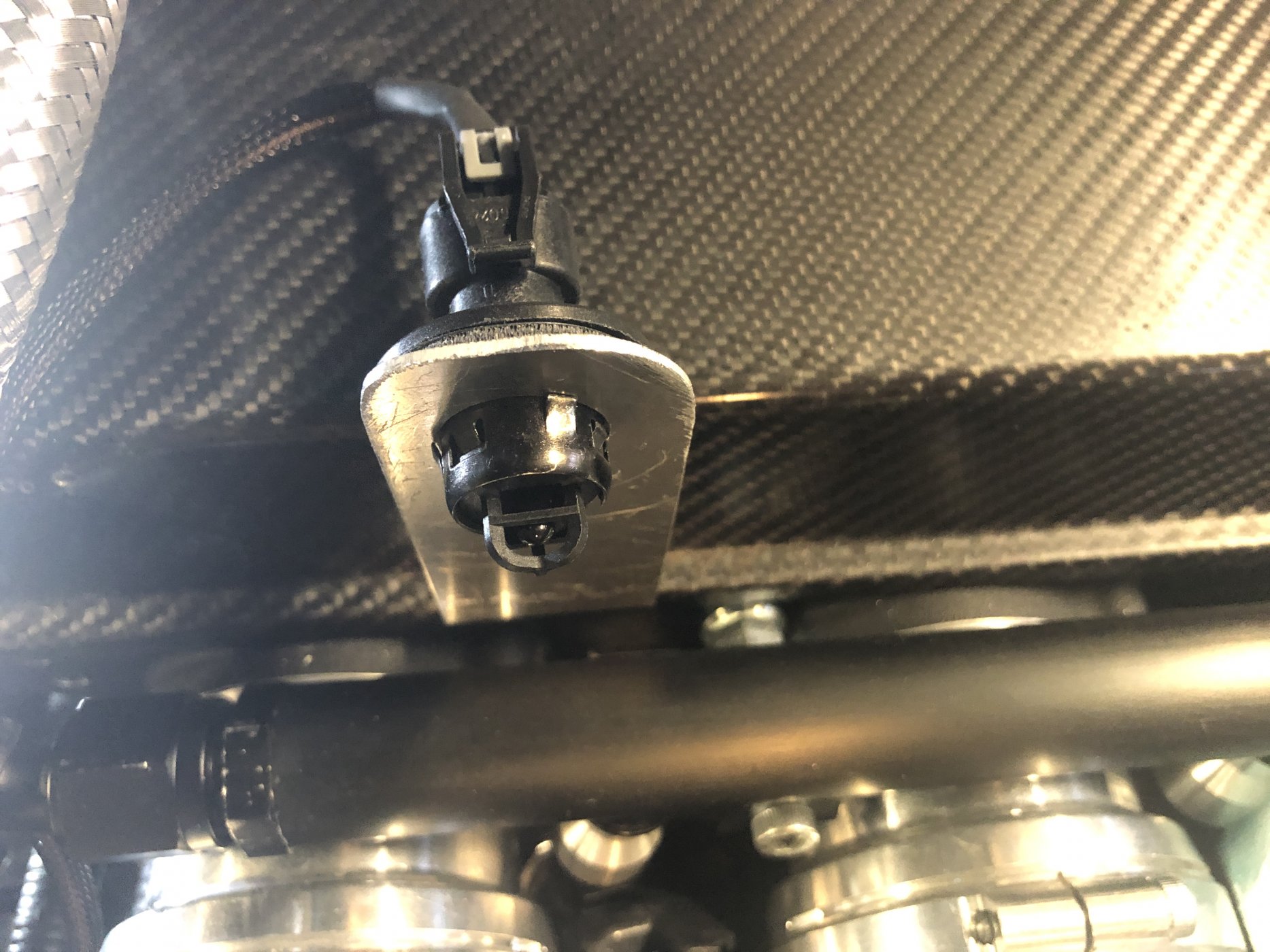

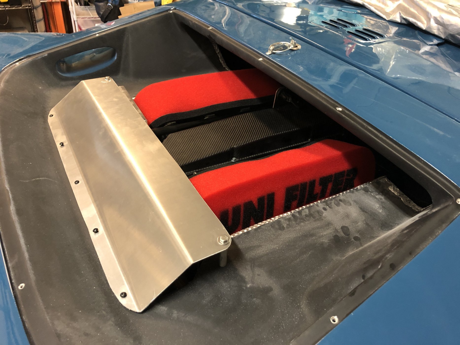

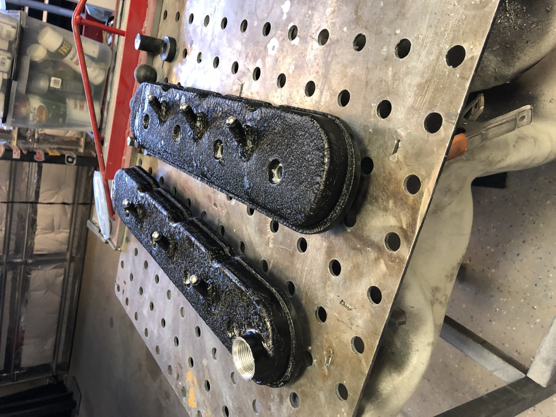

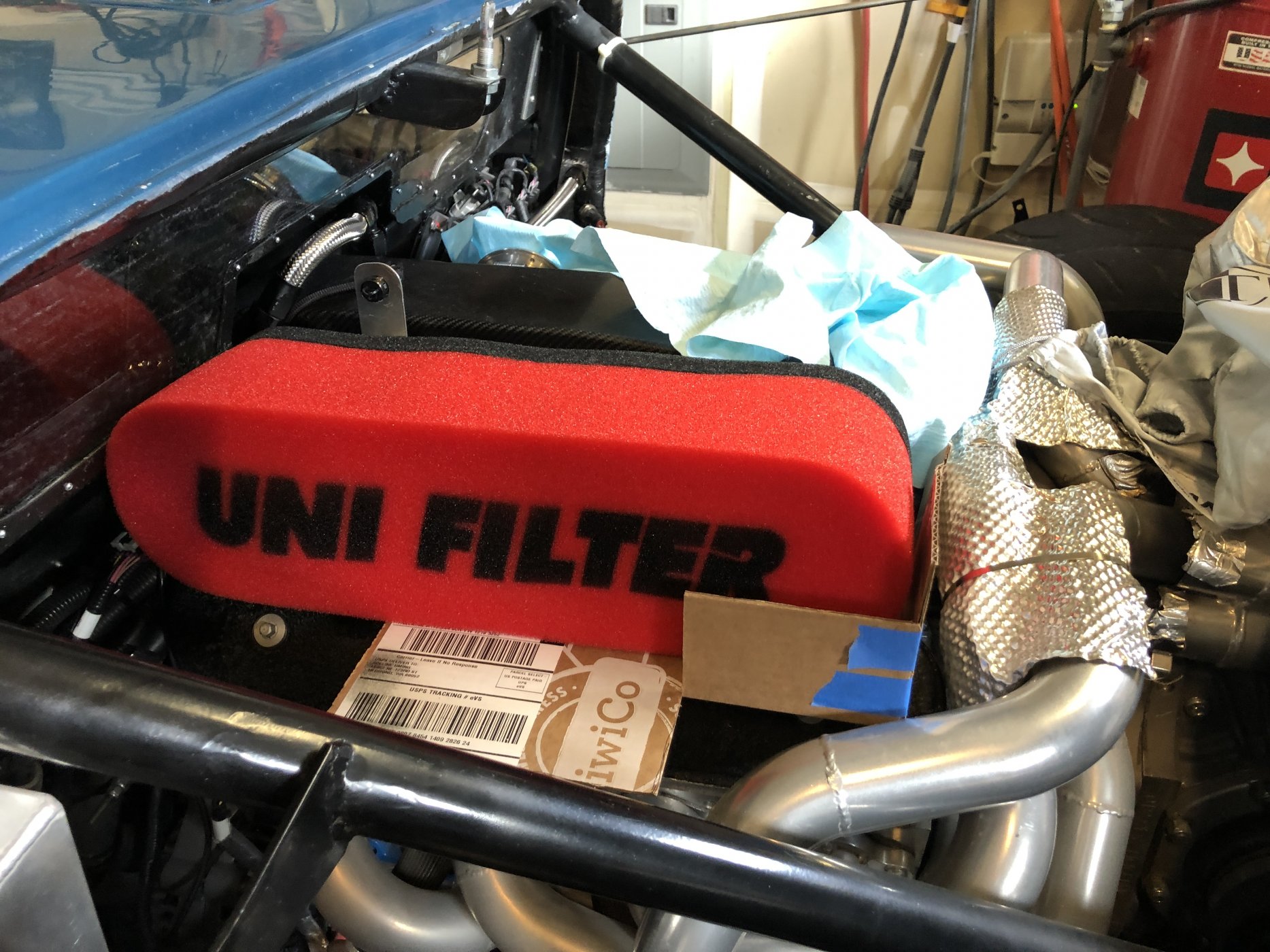

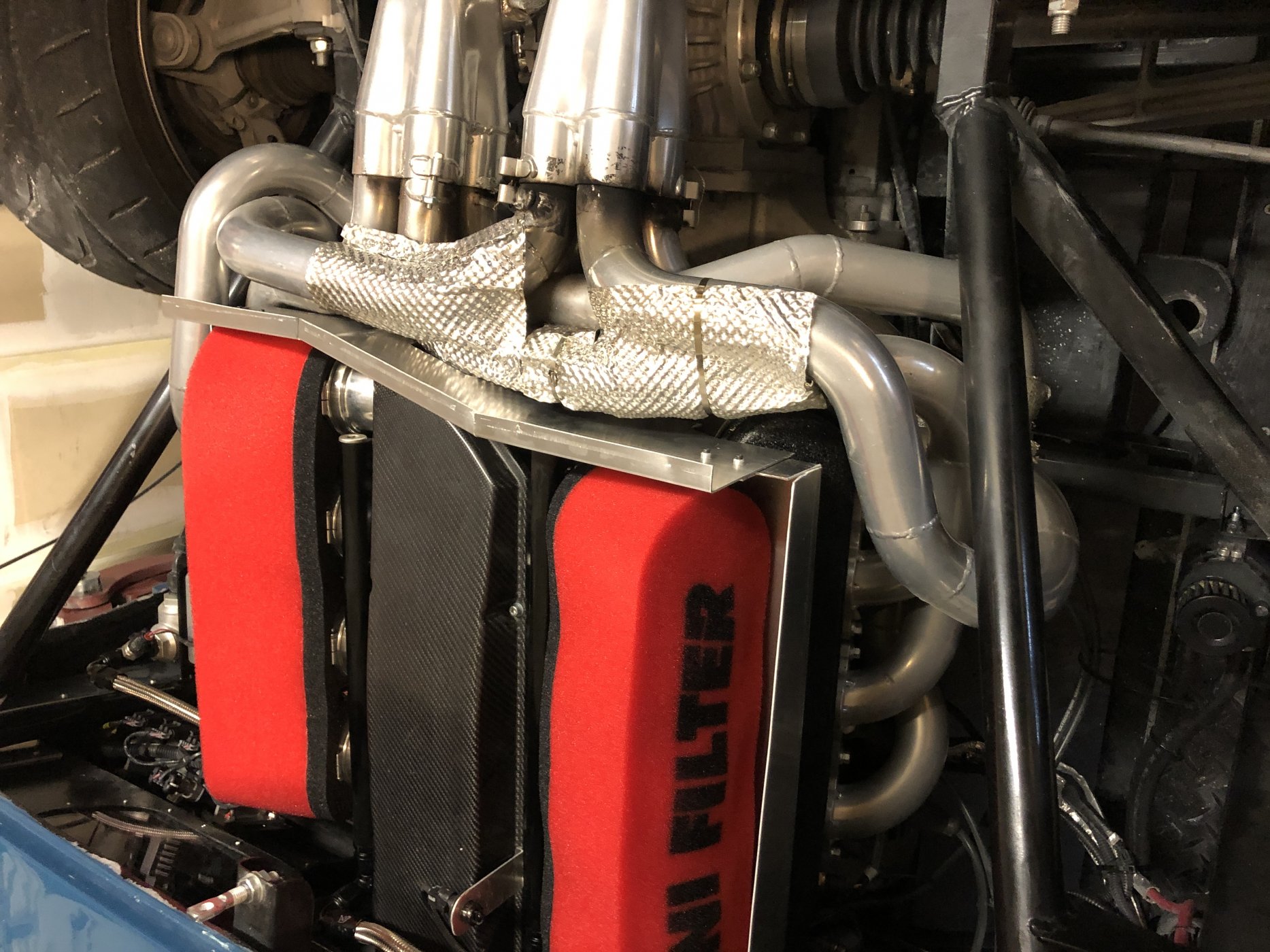

With the ITBs working perfectly, I set out to add some type of filtration...primary goals was to prevent any kind of damaging debris (I’m not trying to OEM style), and also not hurt performance.
I modified the valve covers to add 3 small posts to moutn
I really like the non-metallic blue you've chosen - do you have a colour code for it? Looks a bit like RAL5001 green-blue, but regular computer screens don't really display colours correctly.
I like the function, too bad it reduces the "cool" factor for the stacks!
Nice execution though for sure!
John
Yeah...I was really torn, cause I too loved the exposed bell-mouths; but I'm always working on something in the garage, so the idea of a small metal shard flying off and landing in there seemed too high of a risk not to add some type of protection.
