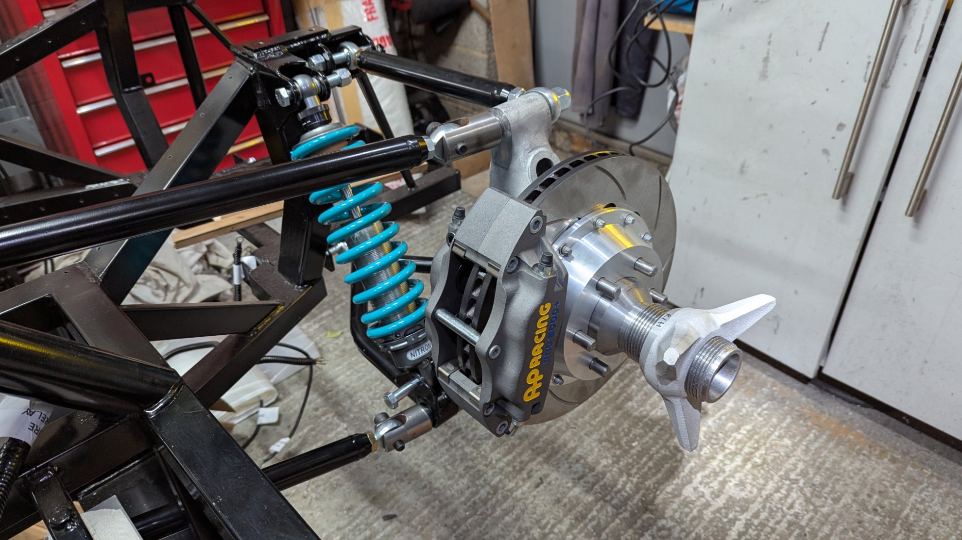

Yes, I contacted Jon about the issue. I believe he has recently changed supplier for the hubs.

I also had contacted AK about them being stiff, was told it was normal and would free up with use. I had asked about known torques for preload because I was going to open them up and reset them.

I guess you mean the rotational stiffness of hub bearing ?

Finally, I test fitted everything on the chassis.
The hubs have provision for knock on wheels. The threads are handed; right hand thread on the nearside, left hand thread on the offside of the car.
I have added the brakes too. I need a separate caliper for the handbrake - watch this space. ;)
Would you like a cad file for a bracket to for a Wilwood caliper?
I got that same BS from Mick at Southern GT about one rear hub being noticeably tighter than the other.
Disassembly revealed hubs were not machined the same, the tight one hub OD was too big so they cranked down on the bearings to get it to seat. Dam near didn’t get it apart. My machinist fixed now both torque up evenly and turn with even feel.
