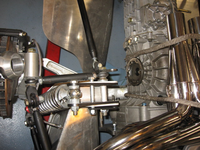

Here is an old top down picture of the alignment. It looks okay to me, but, I have never seen 930 half shafts or how they'll work around that area. I'd think they would work just fine, but I must not be understanding something about the packaging of the shafts and area there. It is tight as Jeff says, I'll ask RCR.

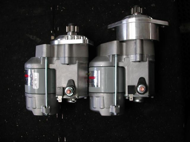

Not to bring this up again but.....some good developments!
After buying a starter from Hi Torque that I deemed would not fit I returned it. When I called about the credit, which they will gladly refund, I got a different guy on the phone that said "didn't Jack tell you about the starter we make for sand rails..."
And off we go with another starter. The problem with the original one, as discussed on this thread, was that when it clocked into the "right" position you couldn't put a bolt through it to hold it on. Well, they already had that licked with the piece shown in the picture below.
So, they are sending me one of these that I can fit. If it didn't work I'll do the spacer thing, but this might just do the trick. They'll accept a return if it doesn't or, they said they could make one that will fit. Hi Torque are some good people to do with and they are the starter suppliers for Kennedy for future reference. Thanks for the references on that company to the numerous folks that suggested them.

Re: A Starter Predicament
That will totally work if it can be rotated. The HiTorque would fit except the bolt in the way of the housing!
[edit] I have the short snout version shown in the above pic.

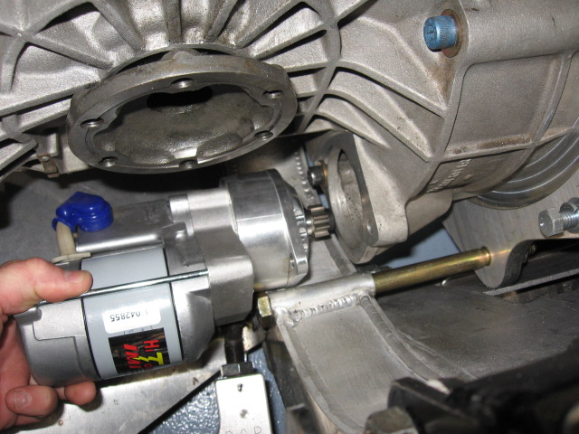

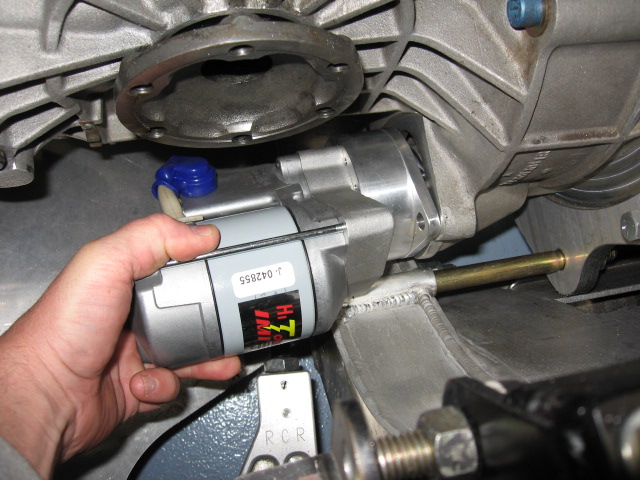

Alright, for an update on the 930 starter. I got the modified Hi Torque starter that they do with the extended nose and it appears that it will fit fine. The car still has bodywork on it so it is hard to get in there. But just holding it up looks like the nose moves everything back far enough to take care of the issue.

Wow - just clears the cradle now... Do you think there's any potential for inboard CV to come in contact under full droop?
I'd like to know your supplier on that starter. Although I'm not planning on a relocation of the engine like yours, I would like a good stout starter to spin my 10.5:1 compression engine over when it's hot..
