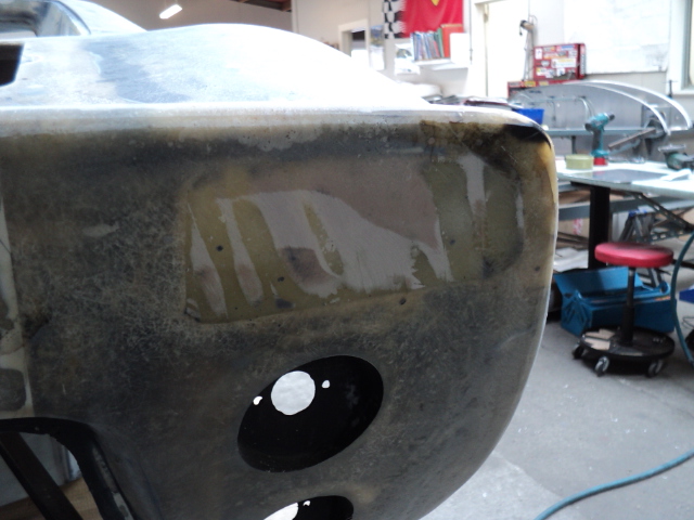

The photograph showing the rear clip being renovated illustrates the archaeology of paint layers reflecting the various race teams. It surprised me to think that paint was simply applied on top of other layers, thus entombing the history of the car until revealed in Lee Dawson’s workshop.

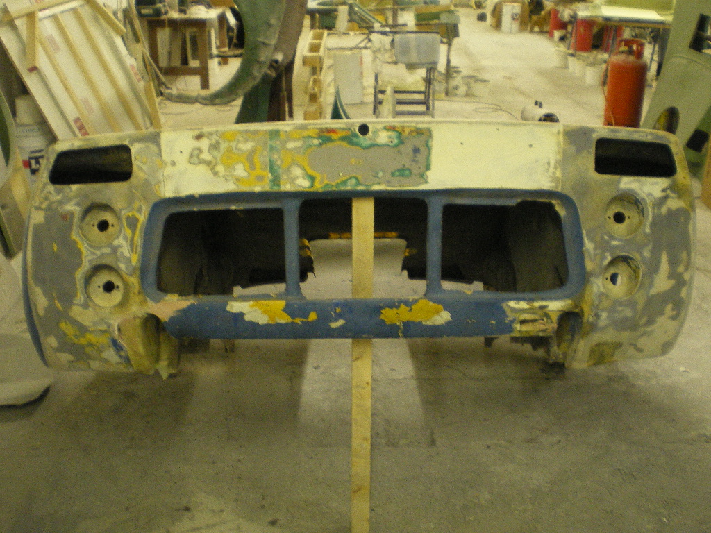

P/1042 (1001)

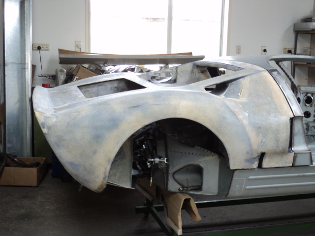

"SHAZAM"... an update from New Zealand! Pictured here is the rear bodywork off GT40P/1001 now in primer and fitted to the monocoque. All the pipework is dry fitted, suspension been on and off, steering, brakes and radiator in, then tantalisingly removed before painting. Looking back at the 1970 images, note how the rectangular slots have been filled, but are still feintly present. I'll keep the outline, as it illustrates the historical changes to the shell. Otherwise, an original-style wiring loom has been located and it looks like the car might just be completed in the New Year... Andrew

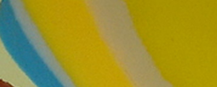

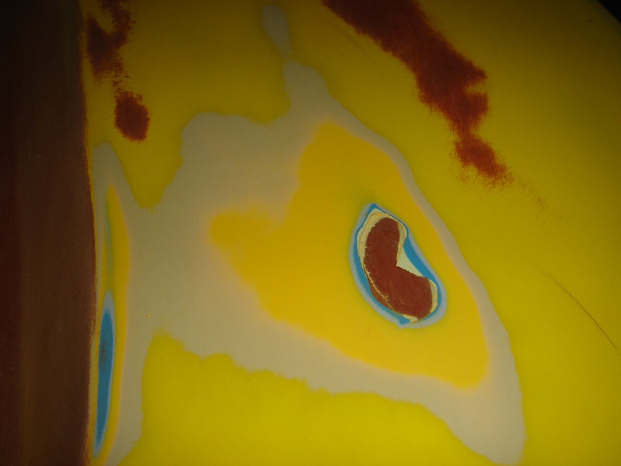

"Interestingly, “word on the street” reports that GT40 P/1042 was rebuilt following the fire which consumed it back in 1968/69 and ran through various owners being painted blue, yellow then more lately returned to the striking red & white livery of the Scudery Filipinetti team, taking part in historic races from the mid 1980s. As stated, one such owner was the said Jean Blaton, a Belgium racing driver, who, as I have stated above, owned GT40P/1042 in the early 1990s and who painted it Belgium racing yellow."
I find this very interesting as I have an original rear clip reputedly from P1041 and was a racing spare.
When I recieved the clip I investigated the history of paint and it looks like this...
Looks like, from bottom to top.....
Glass - Blue - Gulf Blue? (yea right) - Yellow (Beurly?) - white primer - yellow gelcoat - red wash
The red wash was applied by Ray Webber, it had a yellow gelcoat applied by Chris Melia who I bought it from way back when (about 2006) prior to this it follws youe description quoted but 2 shades of blue are shown.
I wonder if there is a strip under there... as my 'mancave' is finally sorted I will investigate that tonight with some soft strokes of 800 grit.
As always Andrew you car looks superb.

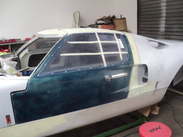

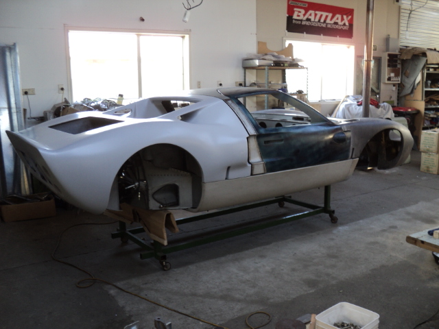

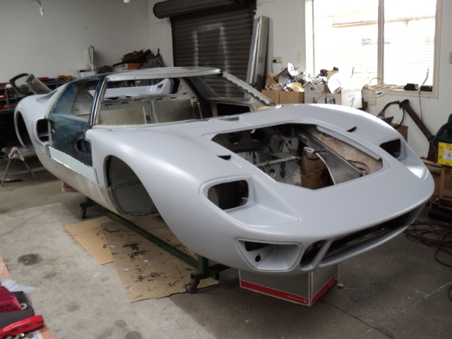

AND... here are the latest photographs of my car with the bodywork from that GT40 firmly in place. Things are hotting up and my nerves jangling!

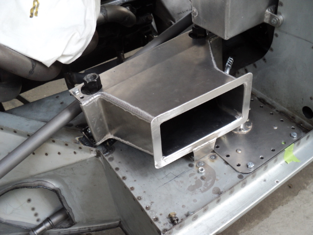

P/1042 (1001)

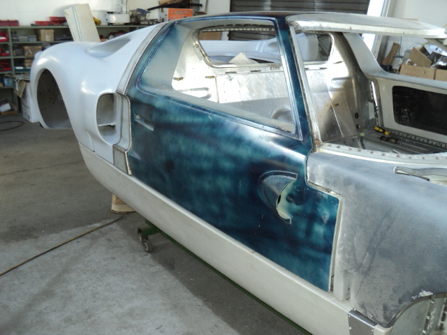

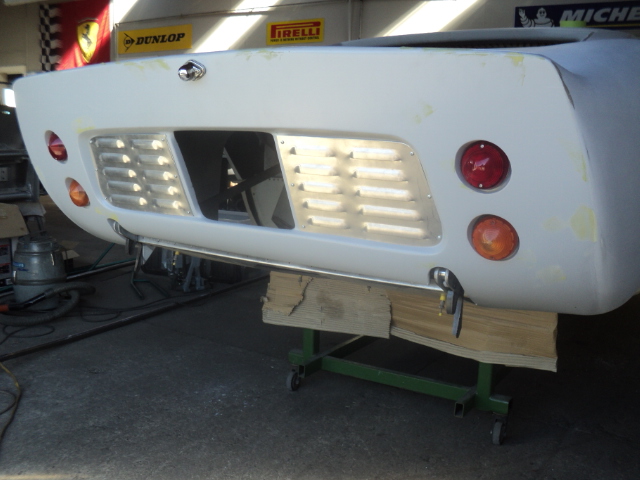

Latest from December 2013 and January 2014-

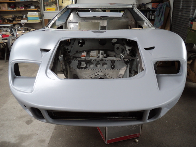

P/1042 (1001)

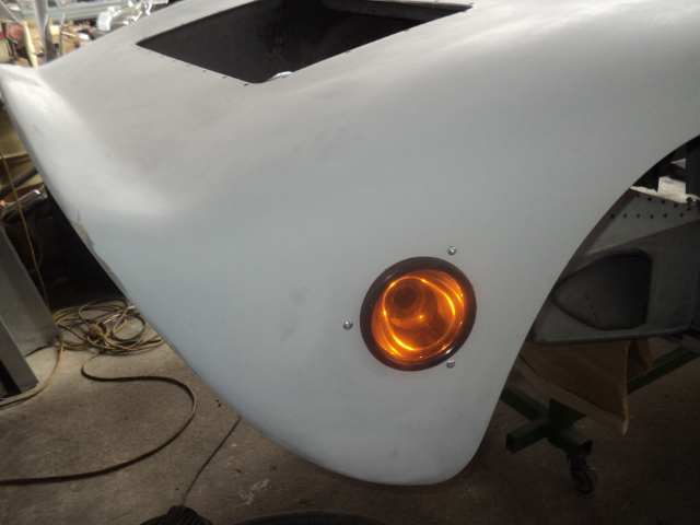

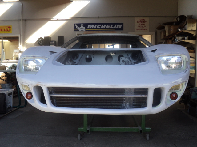

Thanks Brian. It's probably been over 40 years since this front clip had headlights etc-

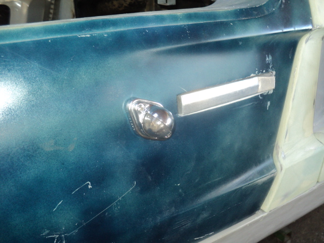

P/1042 (1001)

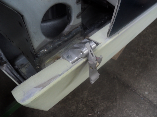

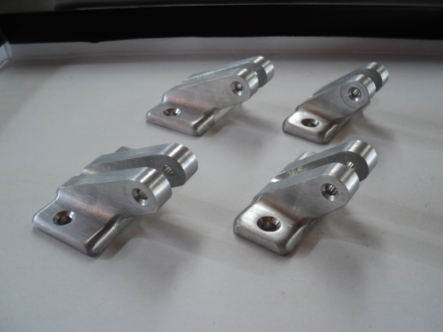

Hello... all the parts now fitted are period original e.g. the door handles were bought off EBay described as "bonnet latches", but when I got my sticky mits on them, they turned out to be off an original GT40 as witnessed by the embossed serial number on the rear of the handle. It's a part number which looks like a cast on dymo lable! Lights all original, but I added the Le Mans marker because it had in 1966/67, but lost it by 1970 when the wheel arches had been extended (see earlier monochrome photos). This is the story so far- Andrew
