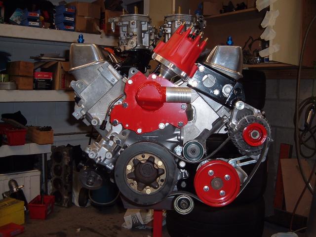

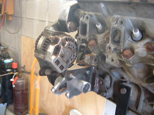

Had a we bit of a win , i had a small dilema that i had put on the back burner for the time being, and that was the inlet manifold , there was no way the body would fit over it like it was, i had started to get some material together to make my own one day when a smart rs mate of mine was around the other day and sugested , why not just turn it around? at first i thought it wouldnt work, but 10 mins later, whoopy do, all we had to do was remove most of the emmision plumbing from underneath it and remove the alternator, and now after overlaying a pic over the body line it will fit like the preverbial Glove. i have since got hold of a smaller dia alternator which will fit in the orig position with a custom mount.

Hi jac and Russ, guys you no the story, sometmes you just cant see the forrest for the trees, i must have sat looking at it a hundred times but it never occured to me. i naturualy assumed it wouldnt work:furious:

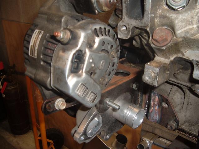

If its any help, I used a small 3 cylinder Daihatsu alternator, even found multi groove belt pulleys that went straight on. Bound to save a thousand HP and the energy of a ham sandwich.

Watch out or those tiny alts. used on the small diesel tractors,as the bearings and windings on the stators most likely handle high RPMs.The generator rebuild shop I use warned me of this and recommended that I use the slightly larger-cased alt. out of a Honda Civic.The unit will take the RPMs,has much more output,and the kits to convert to single wire are cheap and plentiful.

Thanks Dave and Russ of course , problem solved used one off a Suzuki Swift, fits nicely and will take what we intend to give it ok.

When I said small, I did not mean tiny but hey it looks like John has even ended up with the same sort of Alt. which is also a single wire etc.

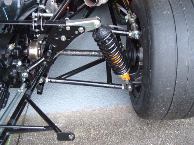

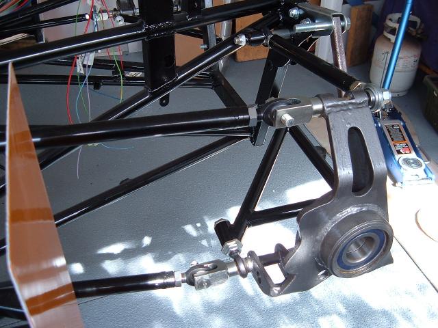

Now a challenge for the experts on wheel alignment.
Can any one give me a few pointers on the typical characteristic`s of what toe, castor and camber do to the front and rear of my mid engined car. For instance using my trusty laser, I can see that when I compress the rear susp. ie squat on take off, it toes in slightly.

Russell, I'm not an expert but toe in under bump condition, which is what you have here IMHO leads to nice handling on a bumpy track/road and also tends to combat side wind effects. It's all a matter of personal preference really, some people prefer to sacrifice stability for better turn in.... Personally I prefer stability, you can go harder in under braking and get the power on earlier.
