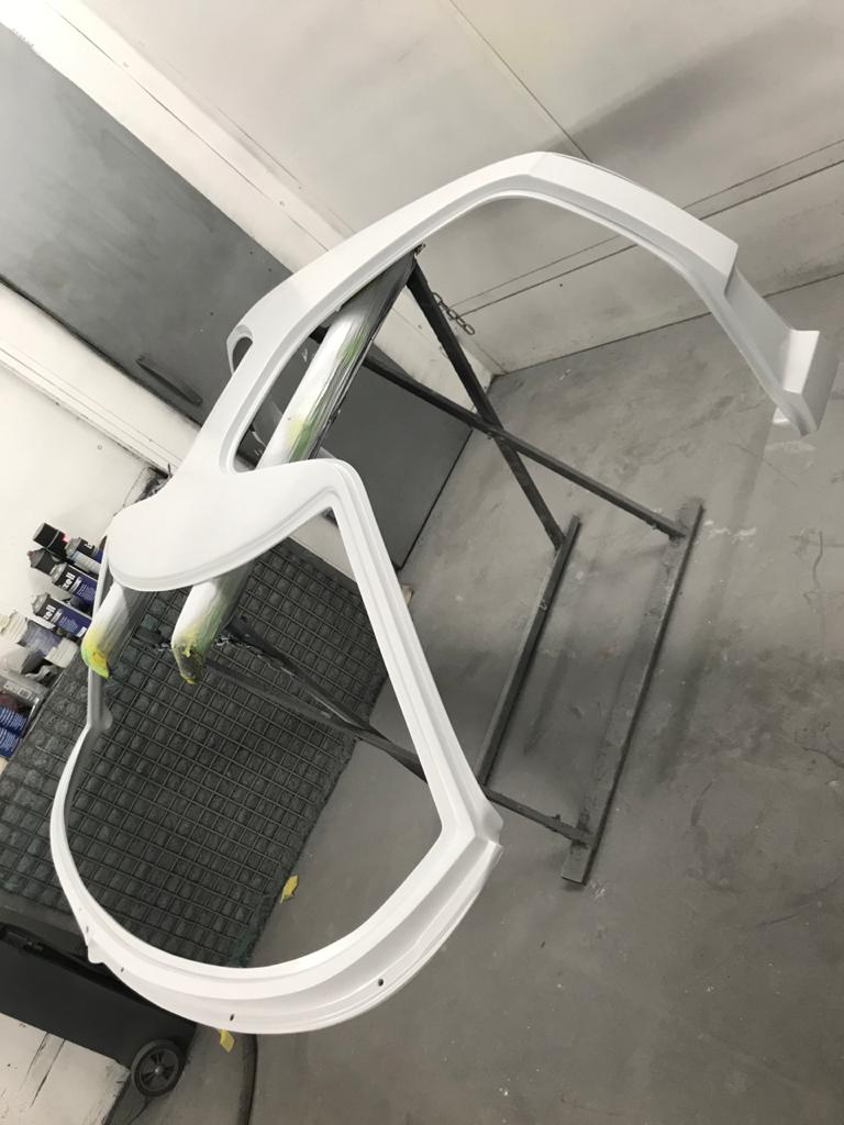

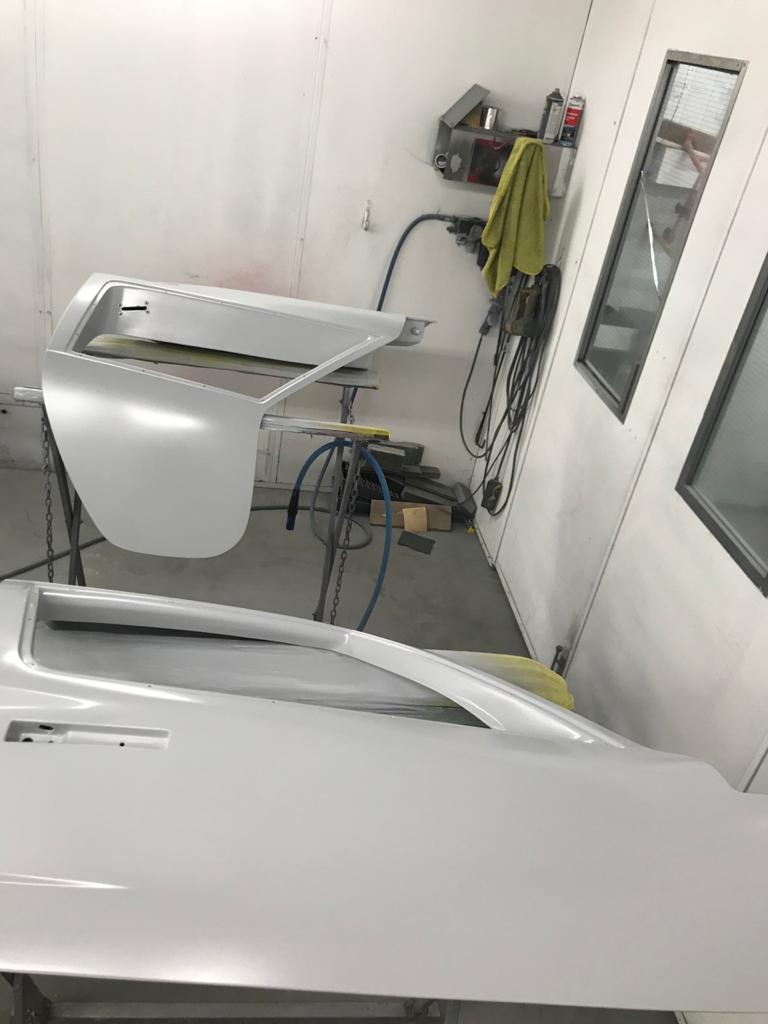

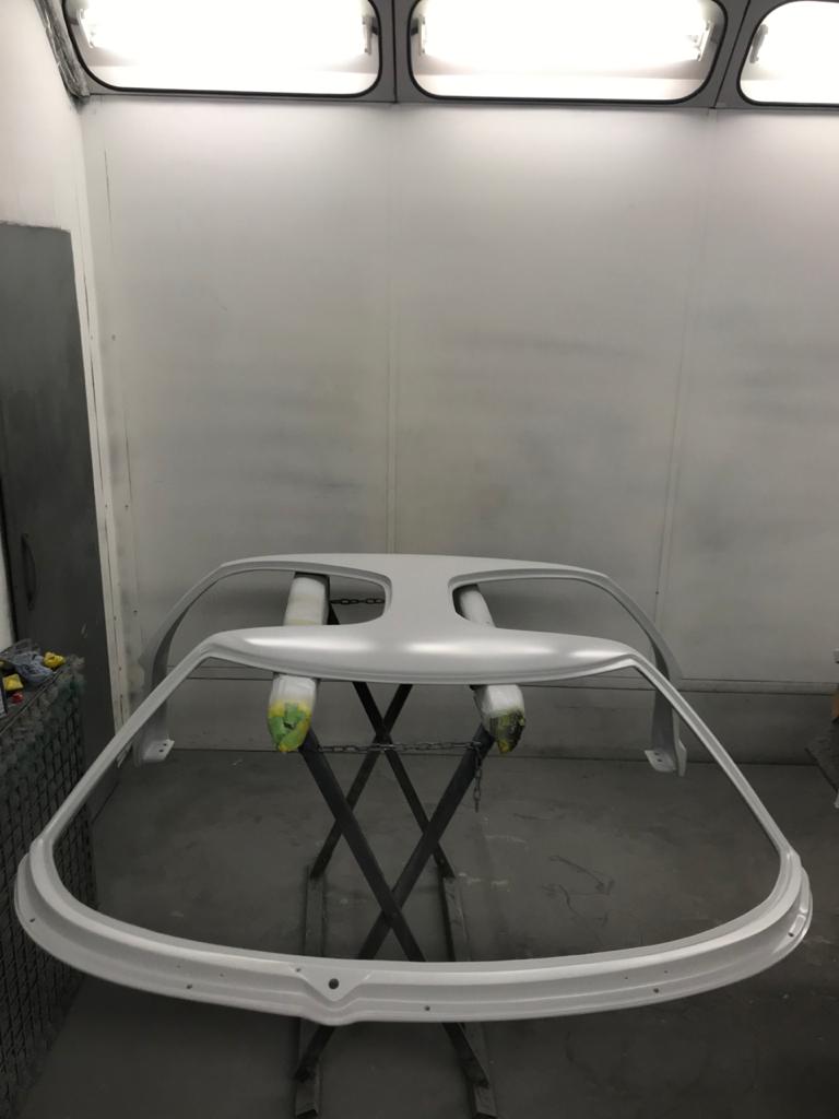

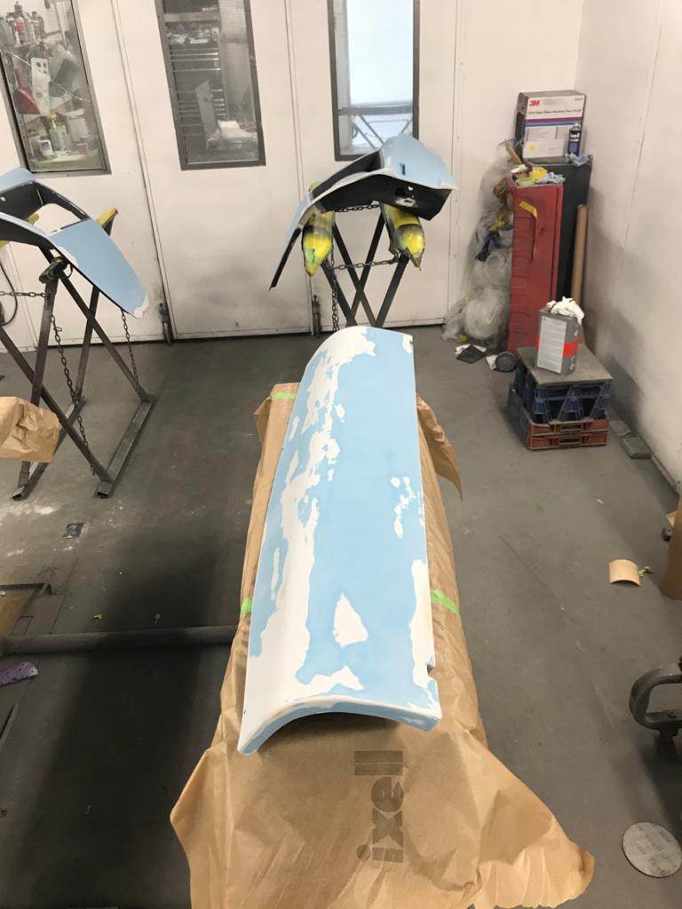

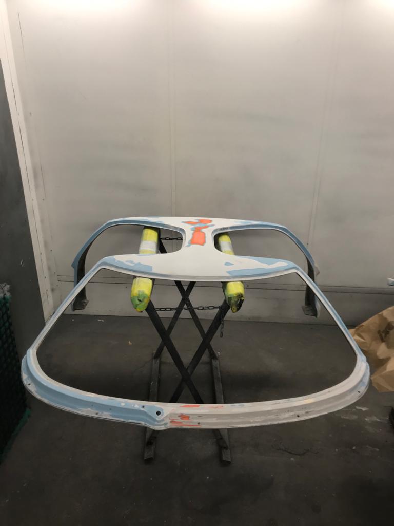

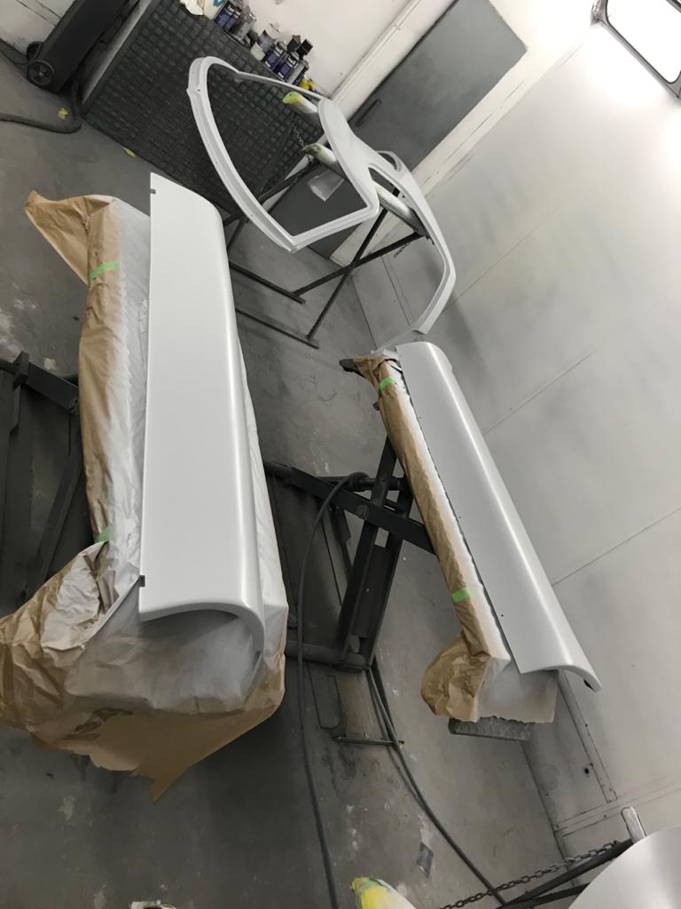

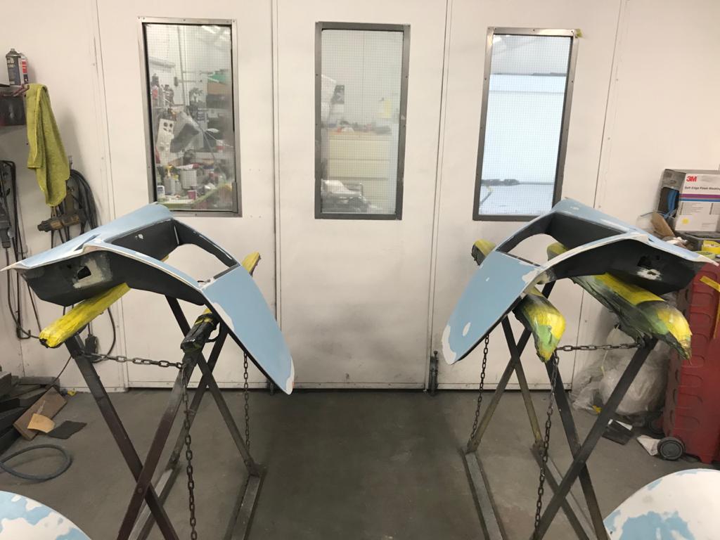

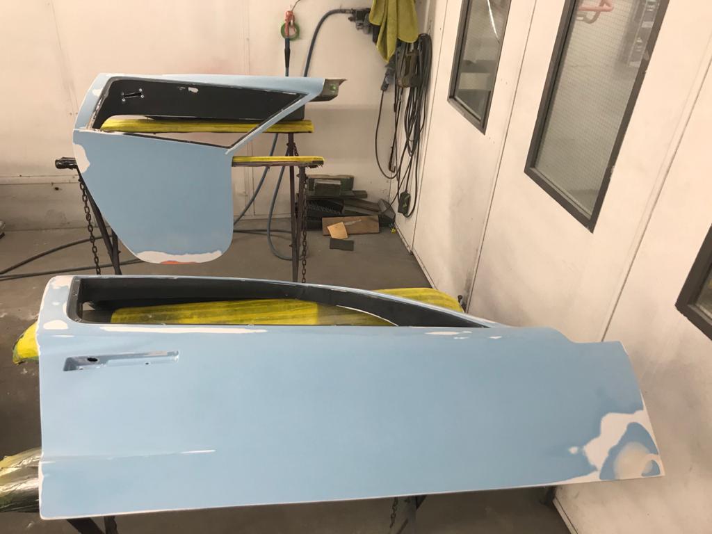

Bodywork wise, we are a little further than in the images. Had to do a bunch of glass repairs on the doors plus front and rear clam. Arches need a little filler and everything should be in primer by the weekend. Paint has arrived and we did a spray out card which looks incredible. Not sure if I show you lot or wait Oli too we lay it down on the body.

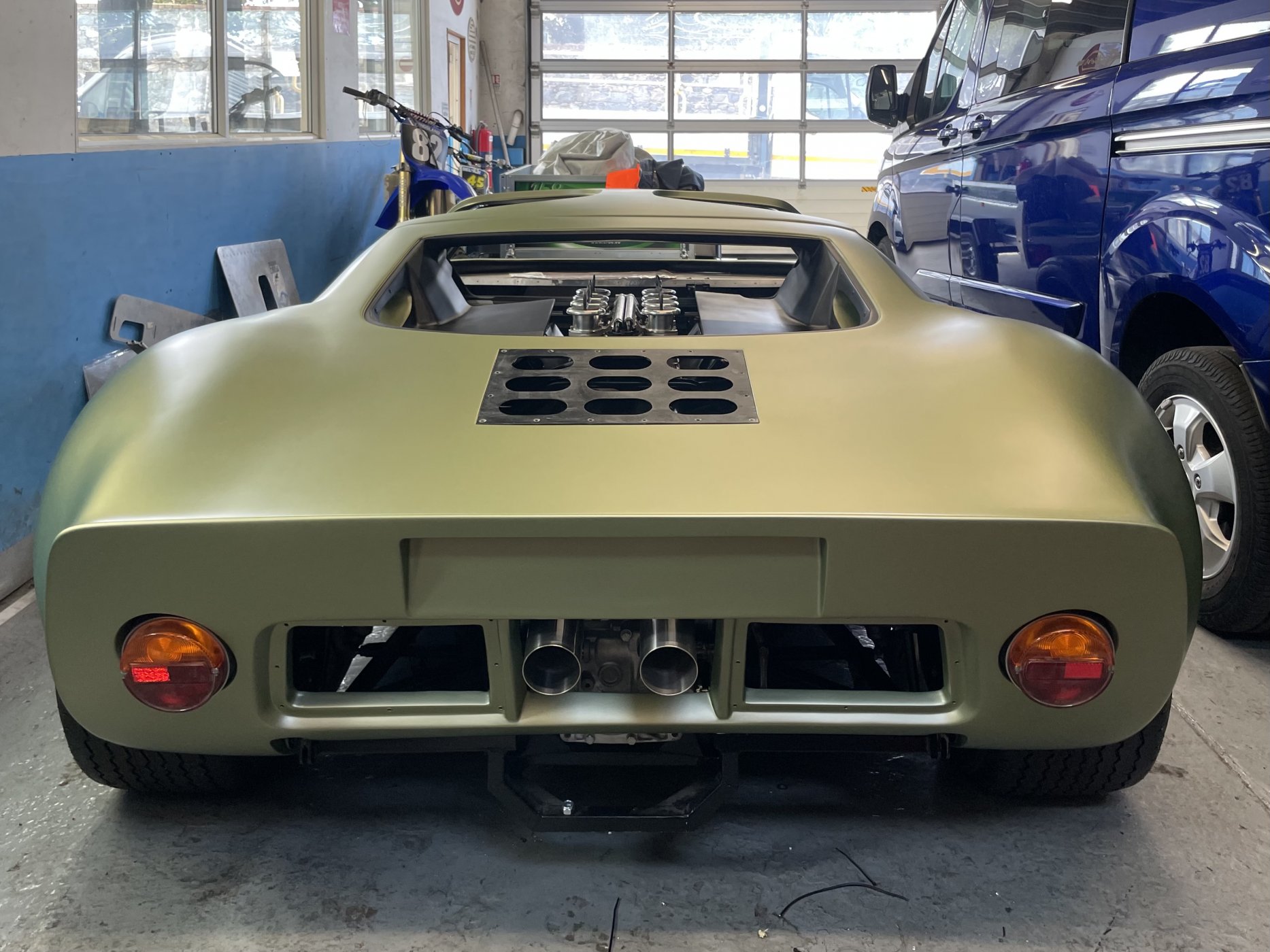

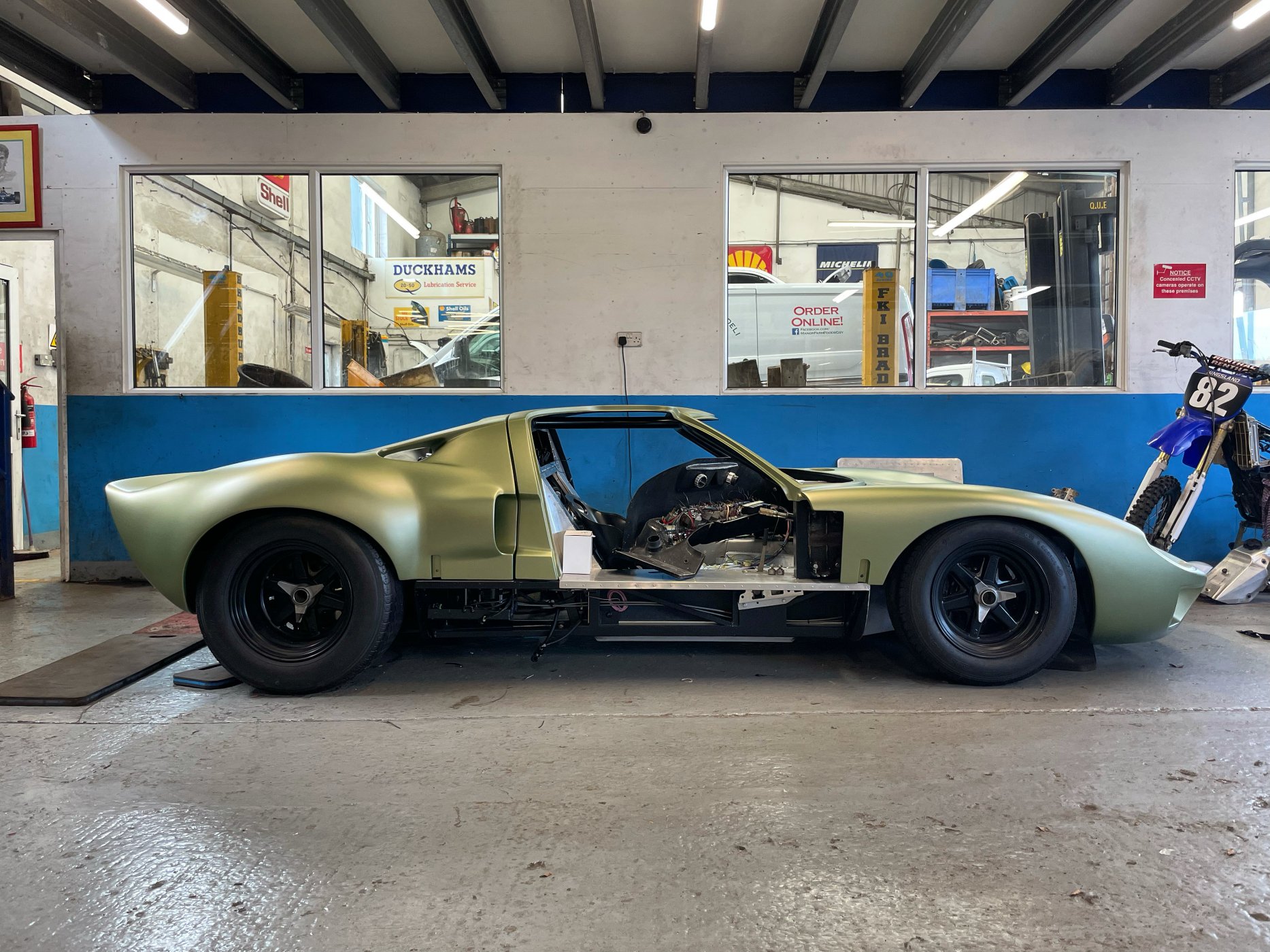

Stepping back and seeing the profile of the car in that colour with the 15” black wheels, Gulf arches and low stance I have really fallen back in love with it. Now I just need to convince the wife To allow me to make the wall glass at home between the garage and the family room. Maybe I just do it then ask

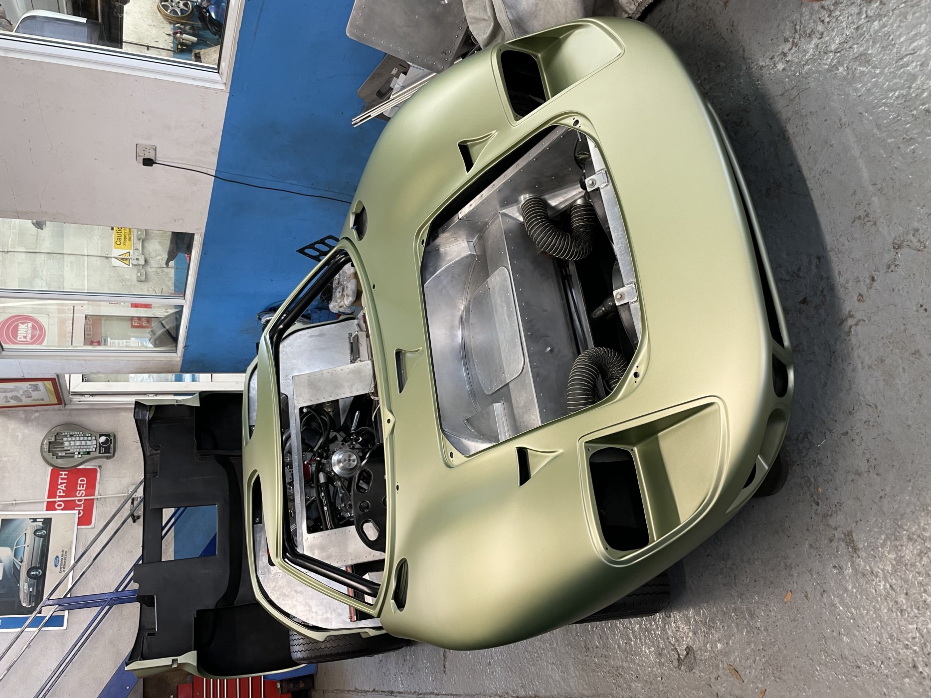

That is BEAUTIFUL.
Is it a matte Sauterne Gold?
The end is in site, can’t wait to hear it fire up.
That’s the colour combo I was looking at doing although gloss. Damn you :D
