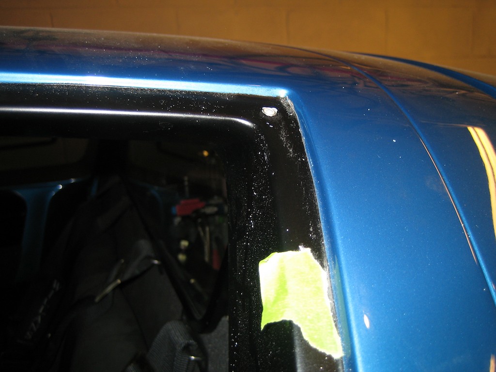

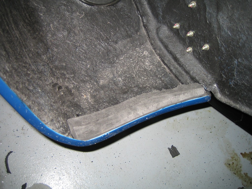

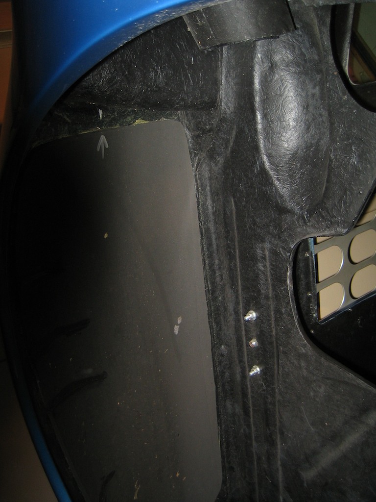

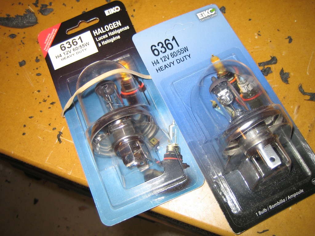

Forgot to mention it was the master that failed on the car. Replaced it a few months ago and things are working great. Now, the snow in Chicago is allowing more time to tweak the car. A couple of pictures so far:
1) Closed cell foam behind the rear wheels to reduce the rocks being caught in the rear clam shell (installed by Kevin)
2) Fender liners (installed by Olthoff back March of last year)
3) Rivet Nuts installed in windows and in headlight access covers in front wheel wells (installed by Kevin)
4) Headlight upgrade (installed by Kevin)

I should have mentioned that the closed cell foam being the rear wheels was a mess... I pulled that off. It trapped rocks and did exactly the opposite of what I wanted. I pulled it off and am reevaluating what the right option is.
