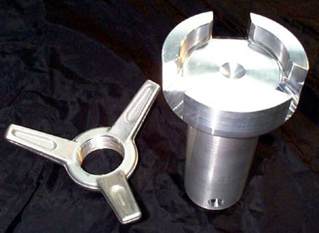

Finish Line Accessories used to do a tool. My link to their website doesn't work anymore but i kept a photo of the tool. I don't have anymore info on it as I didn't purchase one but thought it may be of interest.
Martin

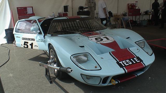

Saw this torque wrench setup being used at the LeMans Classic last year. It was being used on the cars that have what I would call the "small" knock-offs. I don't think a hammer would work well on these "small" knock-offs.

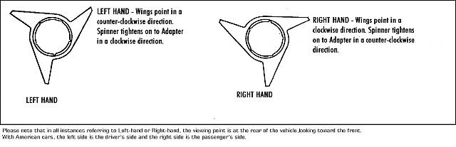

Thanks Fellas... Here's another tid-bit that I found on a site that talks about the Knock-offs on early Corvettes;
????????? Put your thinking caps on guys. Randy the corvette drawing does not make a lot of sense when you think about it, either the knock offs have been designed as easy to tighten or easy to remove , or is it a safety concern to prevent the knock off from catching anything from rotation. Read the text in the article then note the reference to GT40 and then refer to the GT40 pic at the Le Mans Classic with the large torque wrench placed at the RF wheel in such a manner that would indicate a RH Thread on the RHS.

Here's the link to the PDF file that had the image I placed above;
www.licorvette.com/pdfcatalogfiles/KOwheel.PDF
I'm not disputing anything said here by anyone. I'm just trying to gather a repository of information about this design of wheel for the GT40s community (and m'self of course) :)
So - what the Corvette article said seems to reinforce that which Russ, Dean and some others have said..
Jac - I agree with you also that it seems odd that the Left side of the car would have Right-Hand threads and the Right Side would have Left-Hand threads..
Note that the Corvette knock-off has a speciel set of pins to assist in locking the spinner to the hub.

After reading Jac Mac's post and the article he has scanned, I can see that I have got it wrong. For GT40 type centrelocks I now believe the rule is
RH thread on the RH side.
