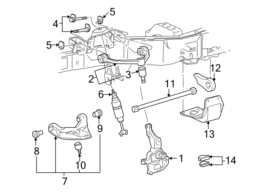

This came to mind as a Ford technician. This is a blow up of the Explorer front suspension . It uses slotted cotroler arm mounting brackets and the bolt kits have keyed bolts with cams that move balljoint forward or back for caster adjustmet. The cam bolt kits are easaly available. Hope this helps or gives guidance.

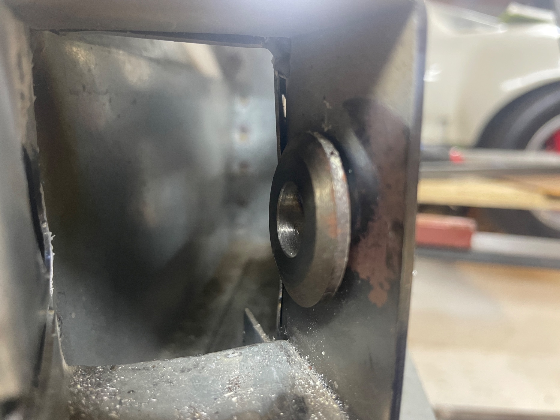

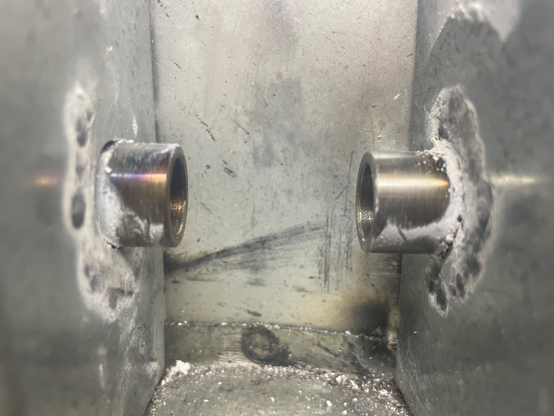

Hi, so which bearing width are you using on lower front arms. Are the 1/2in bosses thats welded into the chassis possible to skim off so you can move the arm forwards and fit a shim on the inside of the bolt / bearing thus achieving your caster?
awwe i see what your saying-but i dont have enough room - i need to move it about 7/16 inch. I think if i cut a slot and tack weld a eccentric might do the trick. If i have enough room for your idea--i think that would work best. However i would like to be able to adjust it so i can get it dead nuts on. Thanks for you insight Morten
