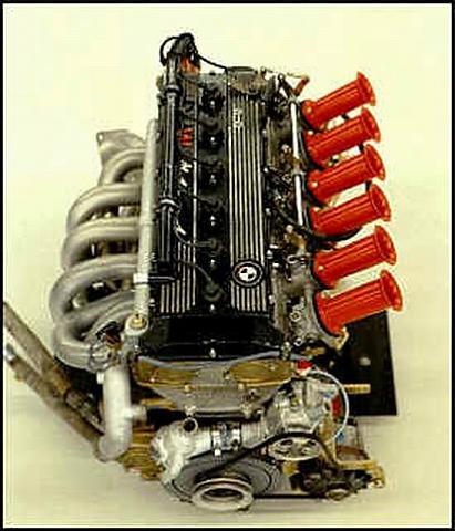

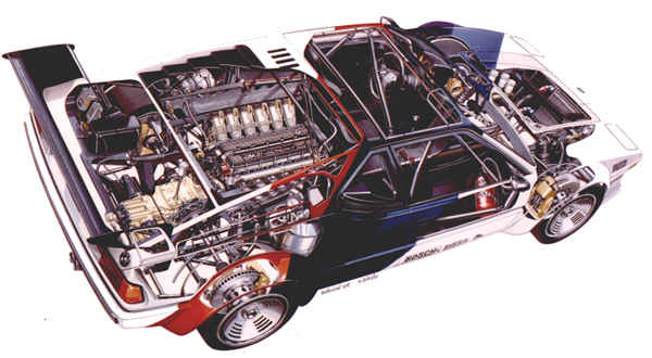

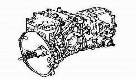

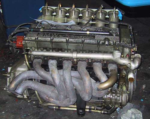

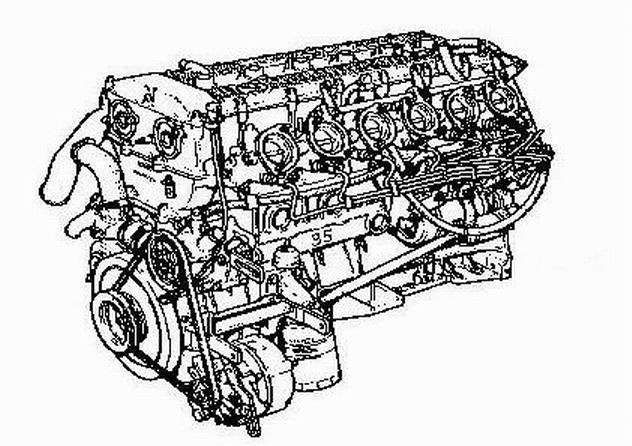

uh, the M1 had all the normal straight 6 cylinder motor, the procar had this motor tuned up, in munich i know a original motor vacum sealed, oh, years ago, and the marmorplate to made the original frame from this M1 -procar, and in my house i had the whole body for this car,.......and no time to build,....... but i think, my dream is the gt-40, and for this car i had time, i hope,........

some pics from the M1 and the technik
