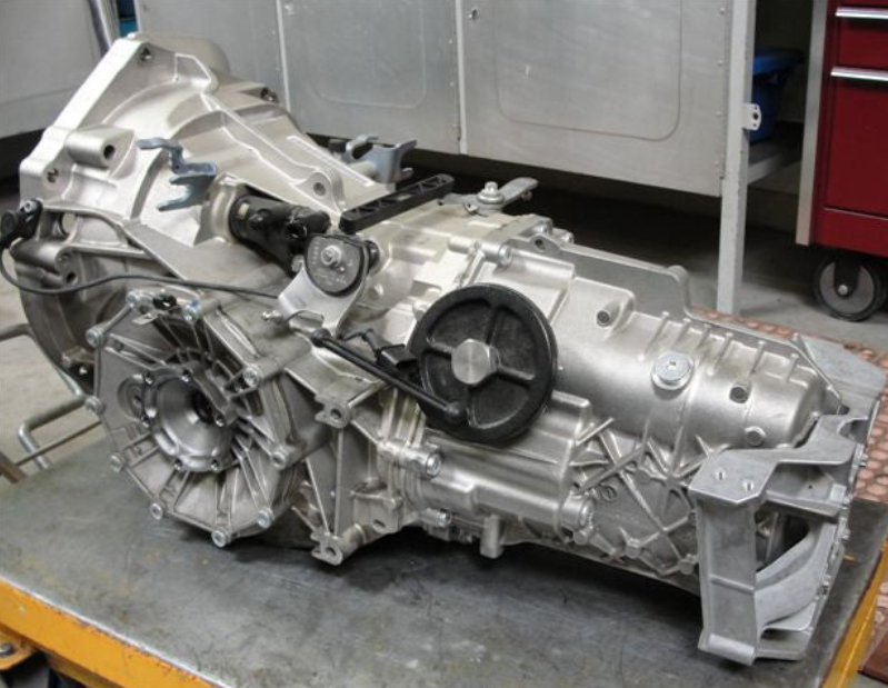

These have the cast iron center housing:

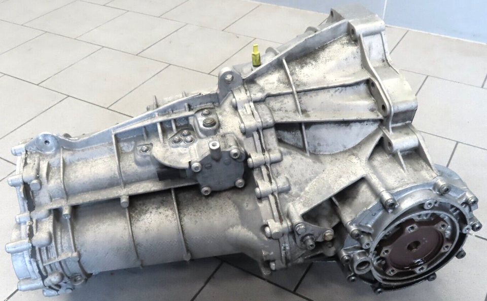

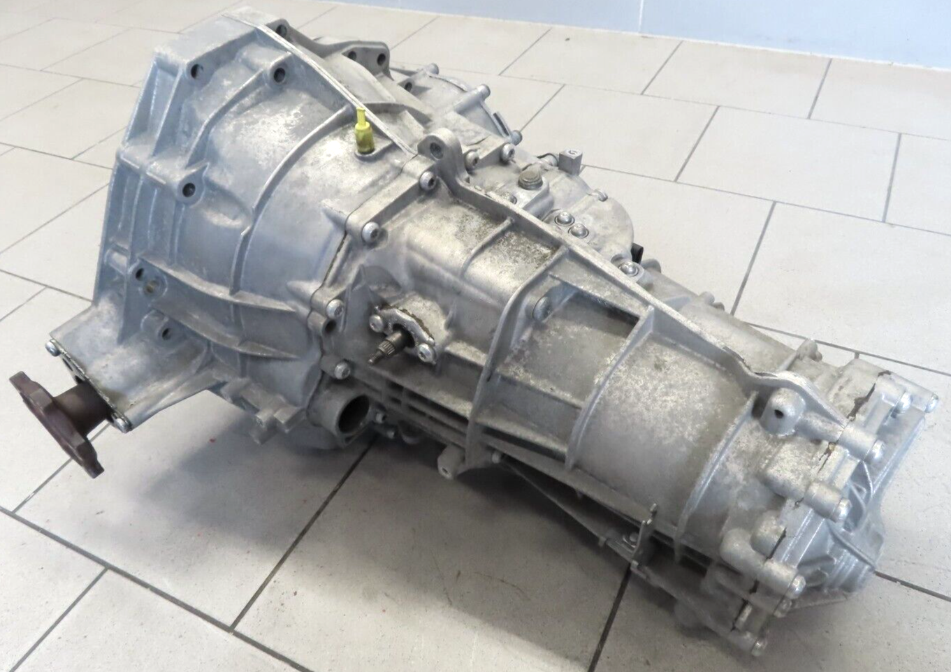

The successor to this gearbox is the
0A2. The gearbox codes for 2WD are:
0A2
FZJ (04-04)
0A2
HMC (04-05)
0A2
HSU (05-06)
0A2
HVD (04-09)
0A2
JMC (06-08)
0A2
JME (08)

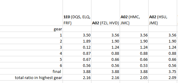

Gear ratios: roughly similar to 1E0, for some reason there were 3x versions. HMC and JMC have the tallest gear ratio (lowest cruising RPM).

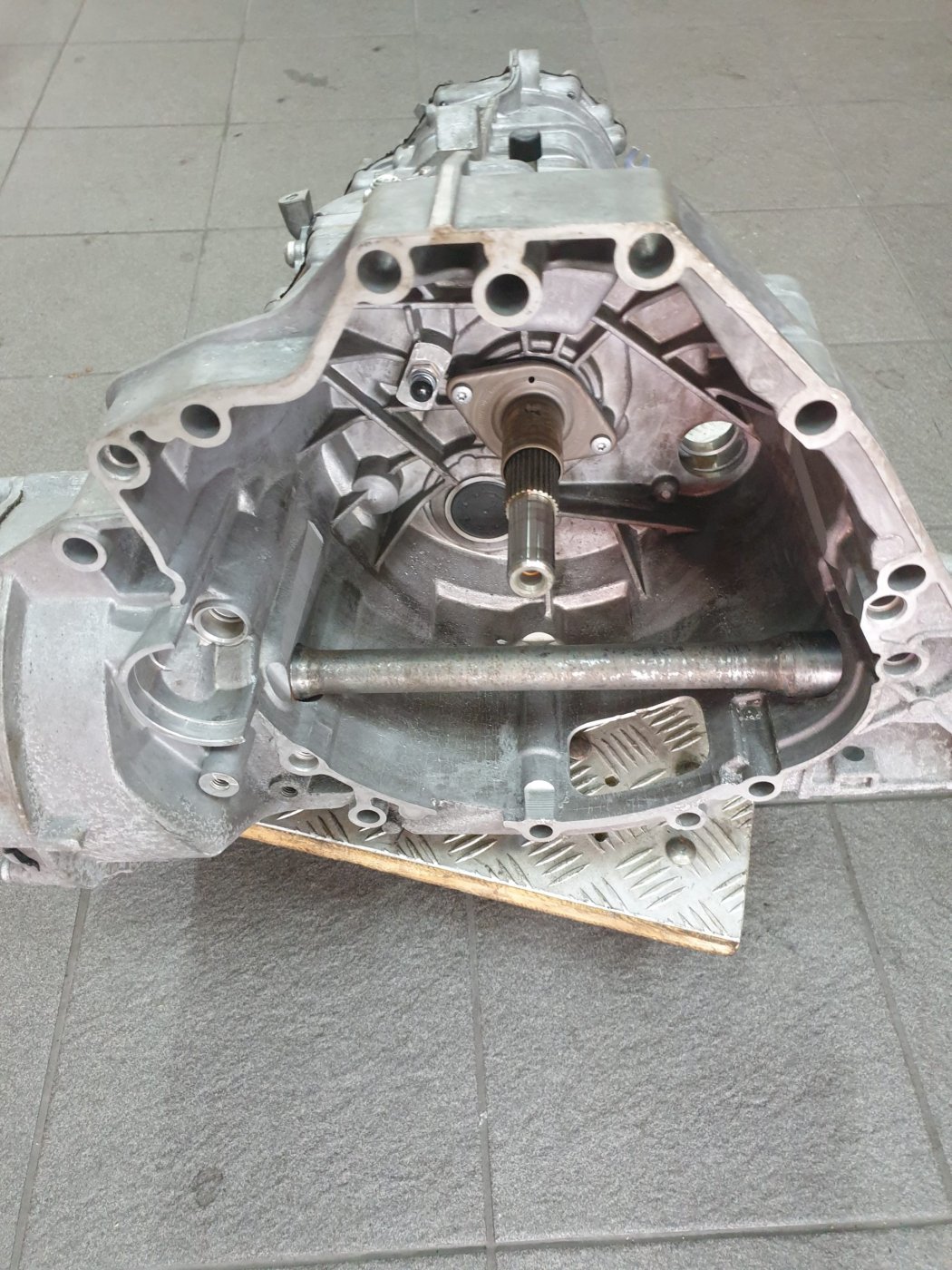

This gearbox is completely cast aluminium (no cast steel center piece). The internals are the same as the G86.20 and G87.21 but with taller ratios.

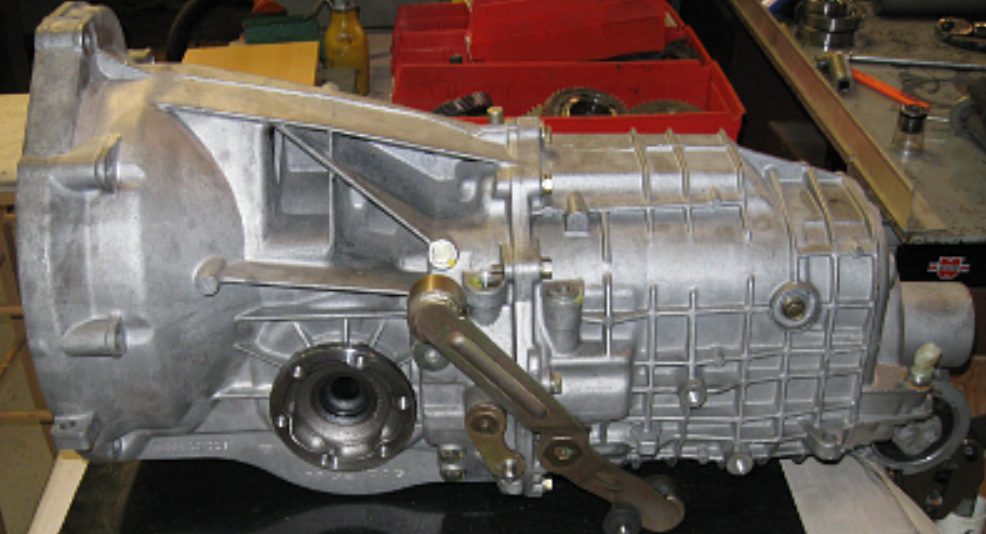

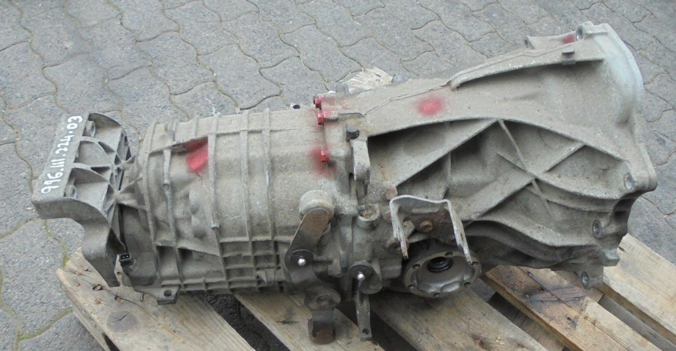

The earlier G86.20 of the Boxter S was a different gearbox, it does not seem to be related to the 01E or the 0A2 at first sight. This gearbox is similar than the G96 internally but the diff is swapped around to reverse the rotation direction.
Best seen if you compare shift levers (G86.20 upper picture, G96 lower picture).
These gearboxes are all very similar internally as far as I understand and made by Getrag and later VW.

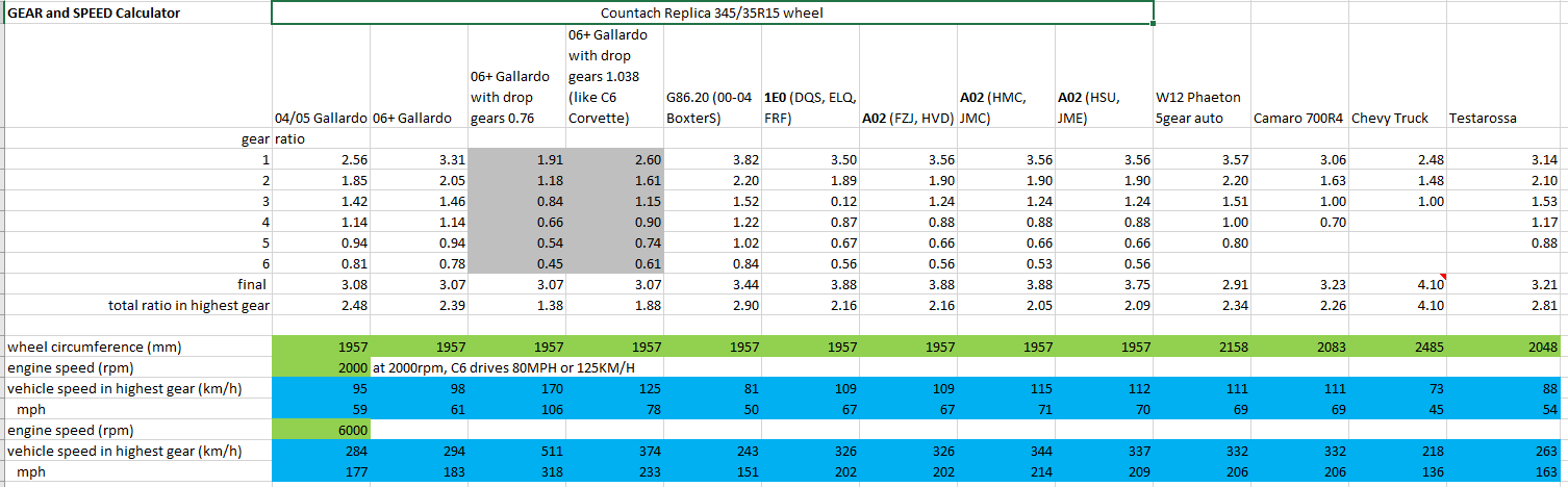

Also an overview of these gearboxes, L140, 1E0 and A02 and G86.20 and cruising speeds.
