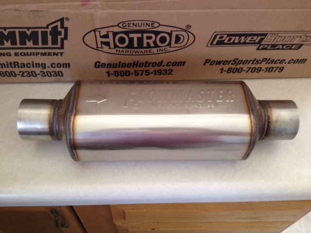

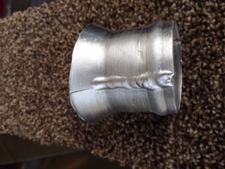

I also found this in my mailbox.. Flowmaster Hushpower II. The case is very compact, we shall see how it does on noise reduction.
I needed a muffler that would fit in the cramped passenger side with the Graziano. If you build an SL-C with a Graziano you will see how cramped it is.
I had the HP-2's on my last build (LS6 motor) they sounded good & are compact - almost like an old school sound.. for lack of a better description. They supposedly "support up to 400hp" for what that's worth.
Here's what they sound like: [ame]http://www.youtube.com/watch?v=xfnv0qTdKlU[/ame]

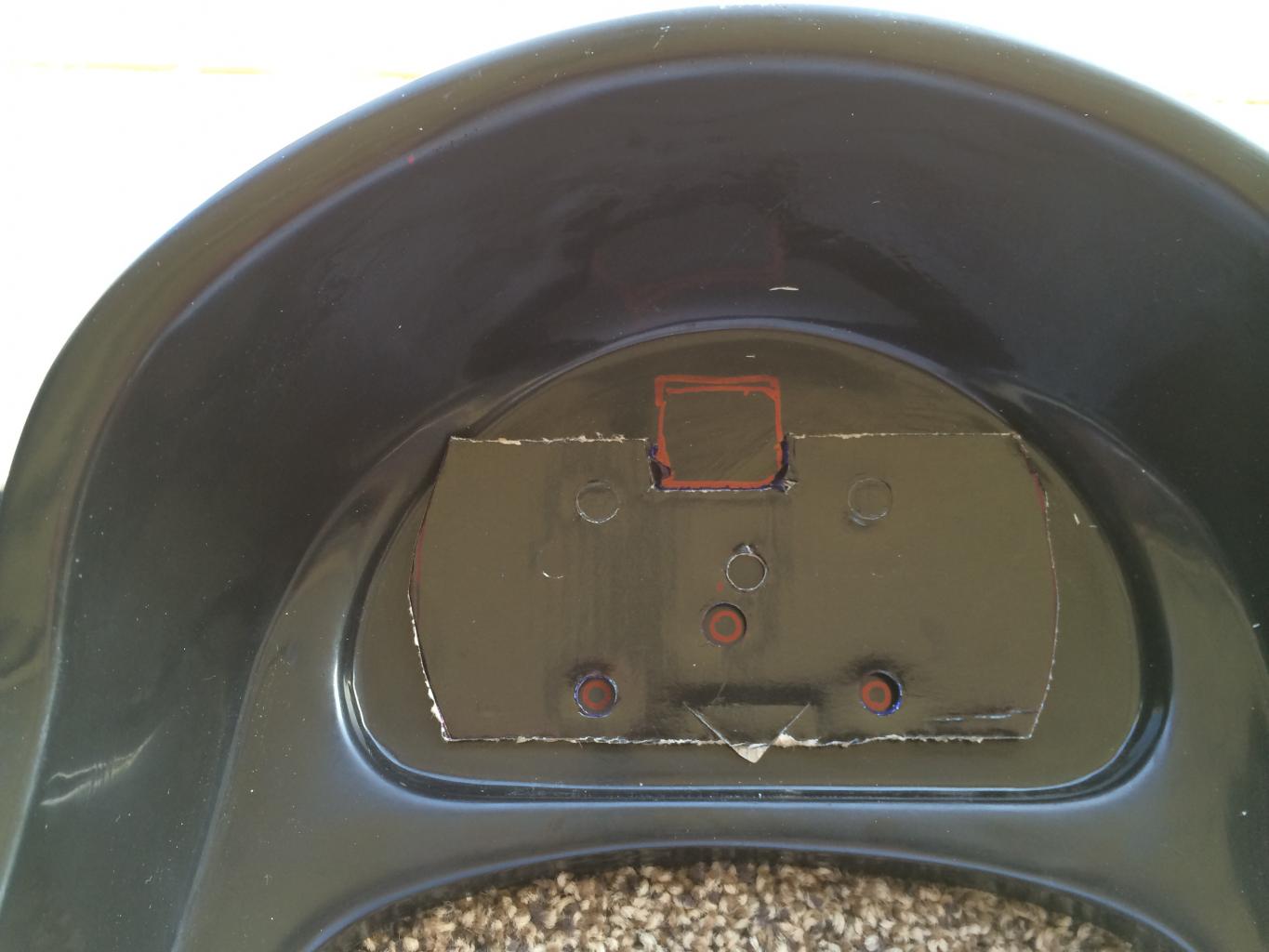

Completed the cutouts for the Koso dash.

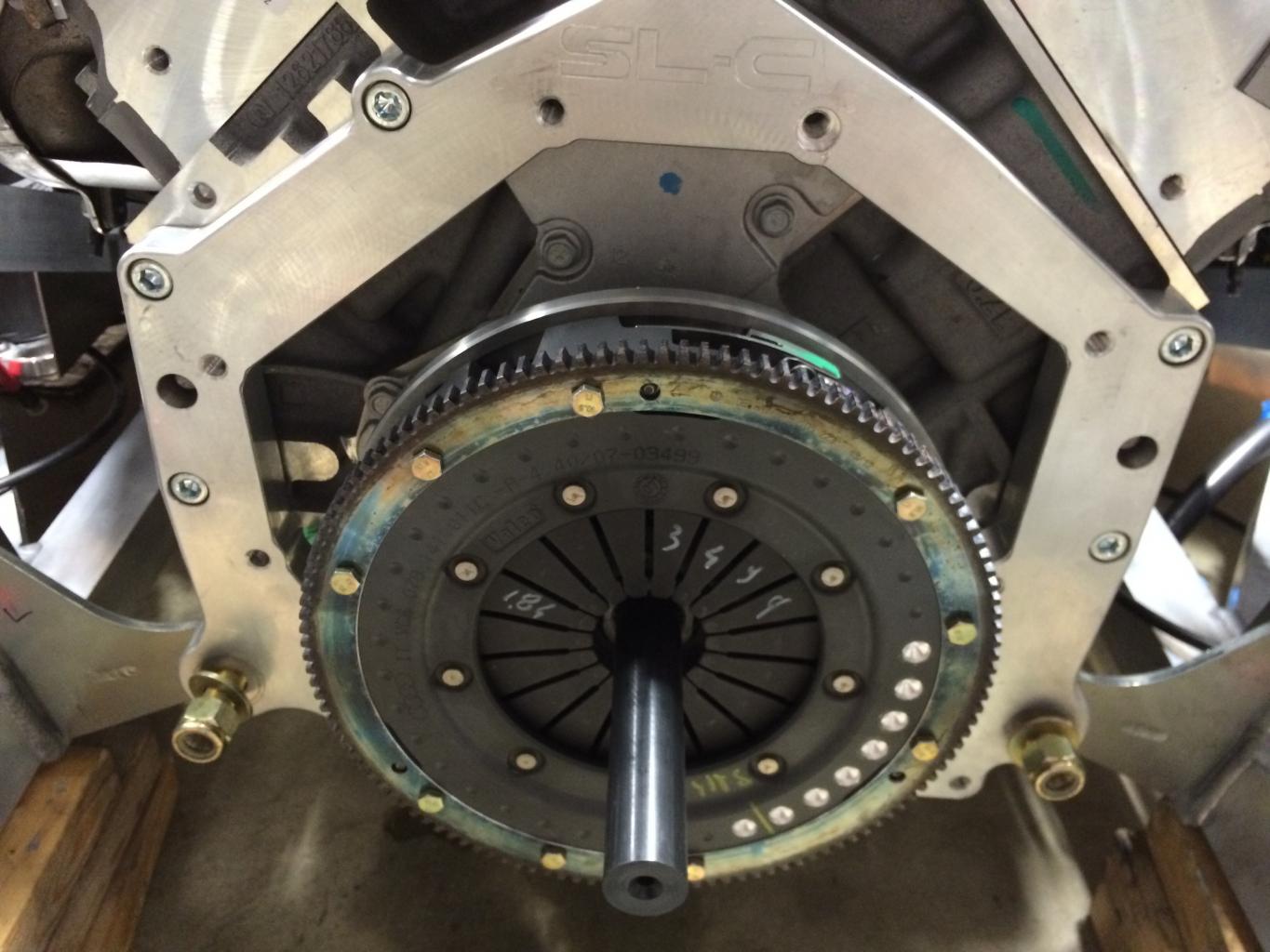

1) Installed the Graziano transmission to the engine.
2) Temporarily installed the starter to the transmission.

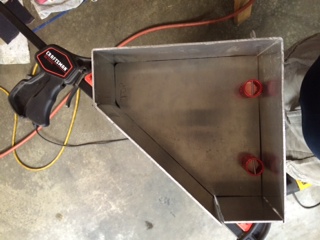

3) Fabricated the sump plate for the fuel tank with the Fuel Safe check valves.

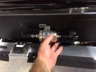

Installed the fuel tank to check for fitment and made sure that the fuel filter / regulator fits in my desired location. Confirmed AN fitting requirements for the fuel tank. Confirmed the carbon canister location next to the tank. Need to acquire a 5" diameter bracket for the carbon canister.

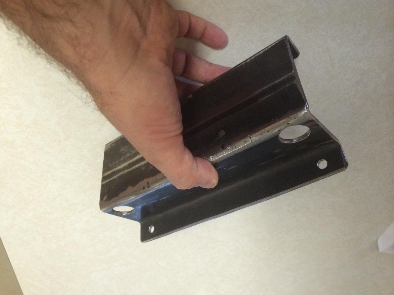

6) Modified my tow hook and cut out the hole in the body. Making a mounting bracket for the tow hook tomorrow.

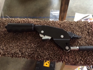

7) Modified the Frankenstein parking brake creation... :)

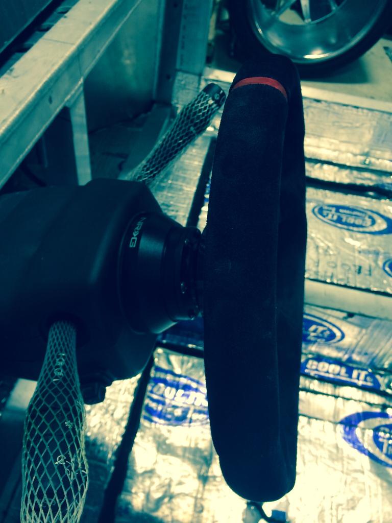

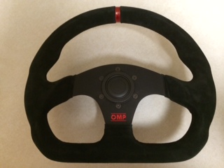

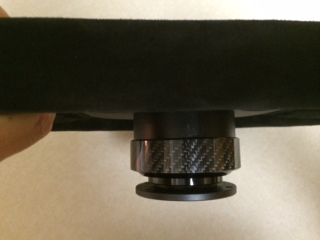

8) Modified my steering wheel and install the NRG quick release hub.

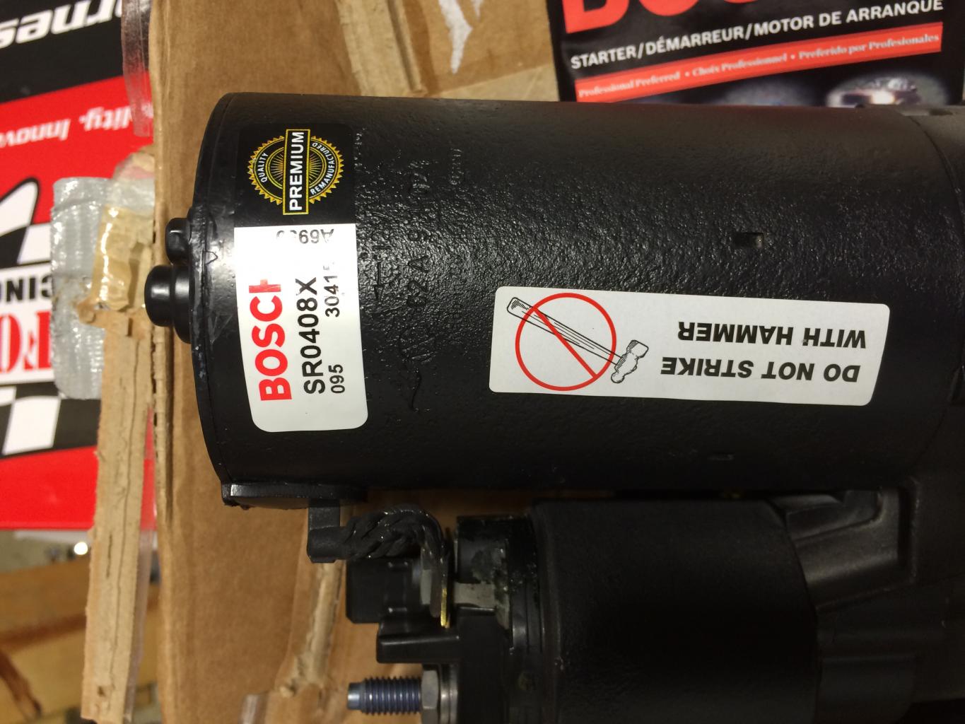

Thanks for the starter number. I removed the black insulation from the transaxle using your method. What a pain in the a_ _ but it does look better with the race tail.

Today I finally was able to install the roll bar. I completed the parking brake bracket and adjusted the parking brake cables. I installed the quick release hub and new steering wheel. I installed the shock spacers and started to install the fuel filler neck.

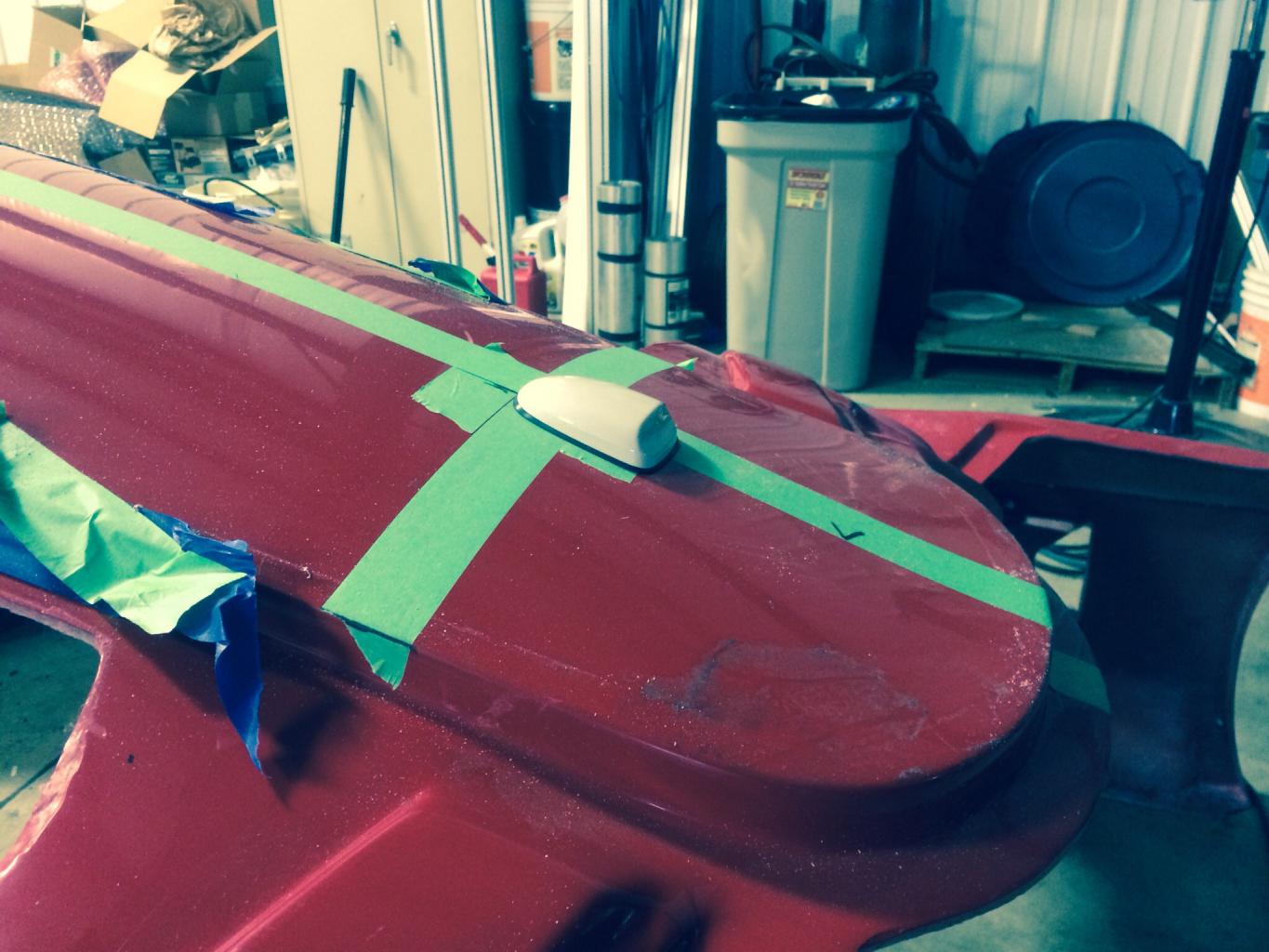

I installed the housing for the rearward camera today. I also started prep on the clamshell body section.
