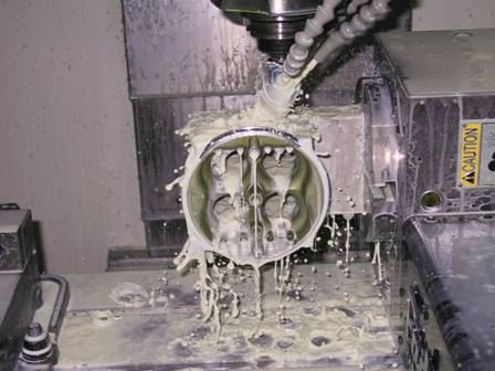

Next, the main body goes onto a fixture mounted on our 4th axis drive, which rotates to allow us to machine the sides and to drill and tap the various fuel and air passages for screw-in restrictions. These allow for easy tuning of the carburetor’s fuel response curve later. I also true the air-cleaner mounting surface, and radius the normally sharp and rough edges of the casting (carburetors should not draw blood when you touch them).
Next, the venturii are machined to the size and shape that matches the customer’s airflow/throttle response needs. This is done with a single-point tool, and the programs are quite long…the one written for your carb is 42,371 lines long. Thankfully, we have software that “reads” my 3-D drawings and writes the toolpath code for me…takes about a minute. I’ll see if I can copy some screen-shots of the actual process later.
