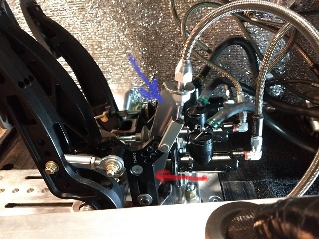

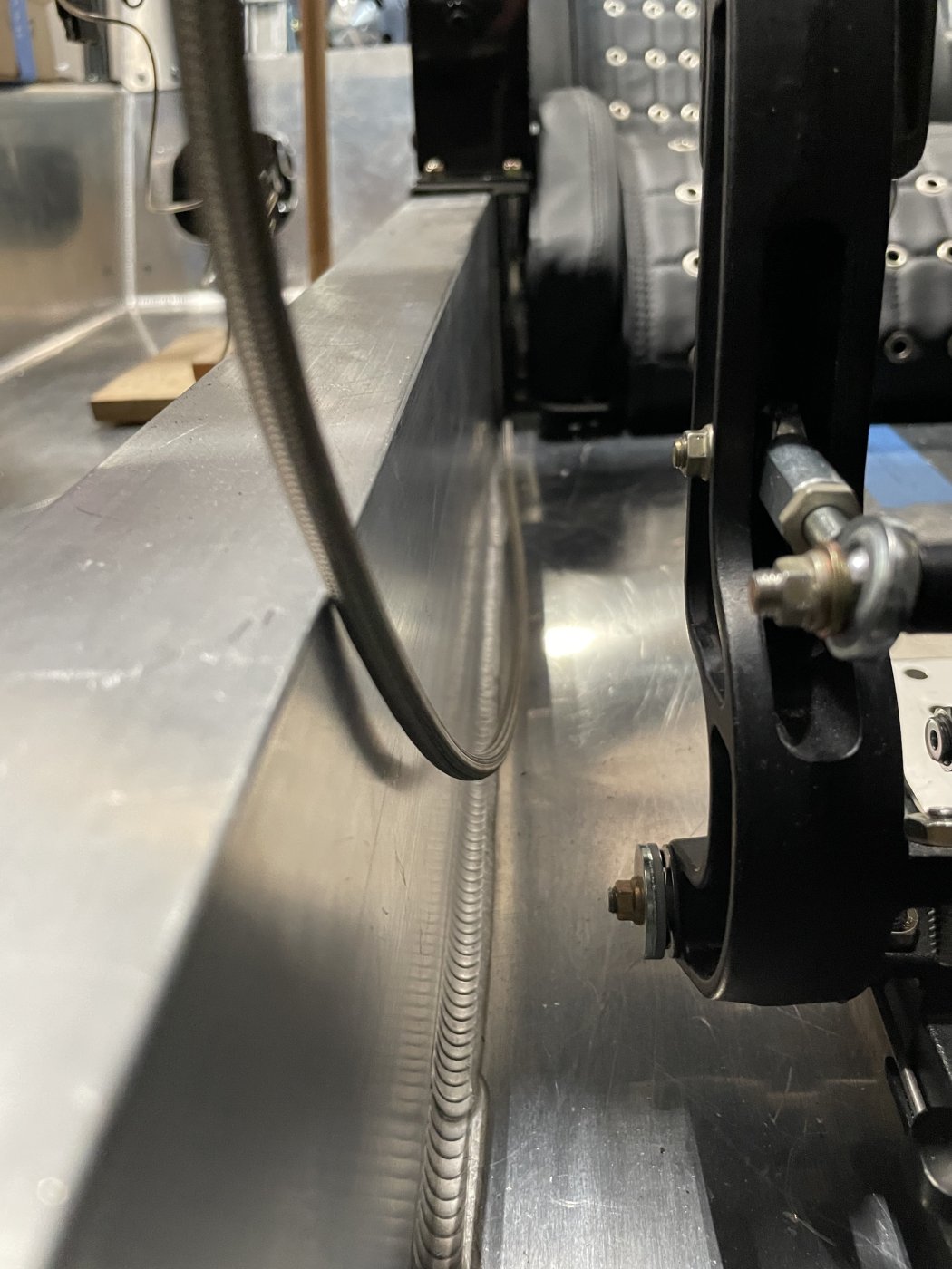

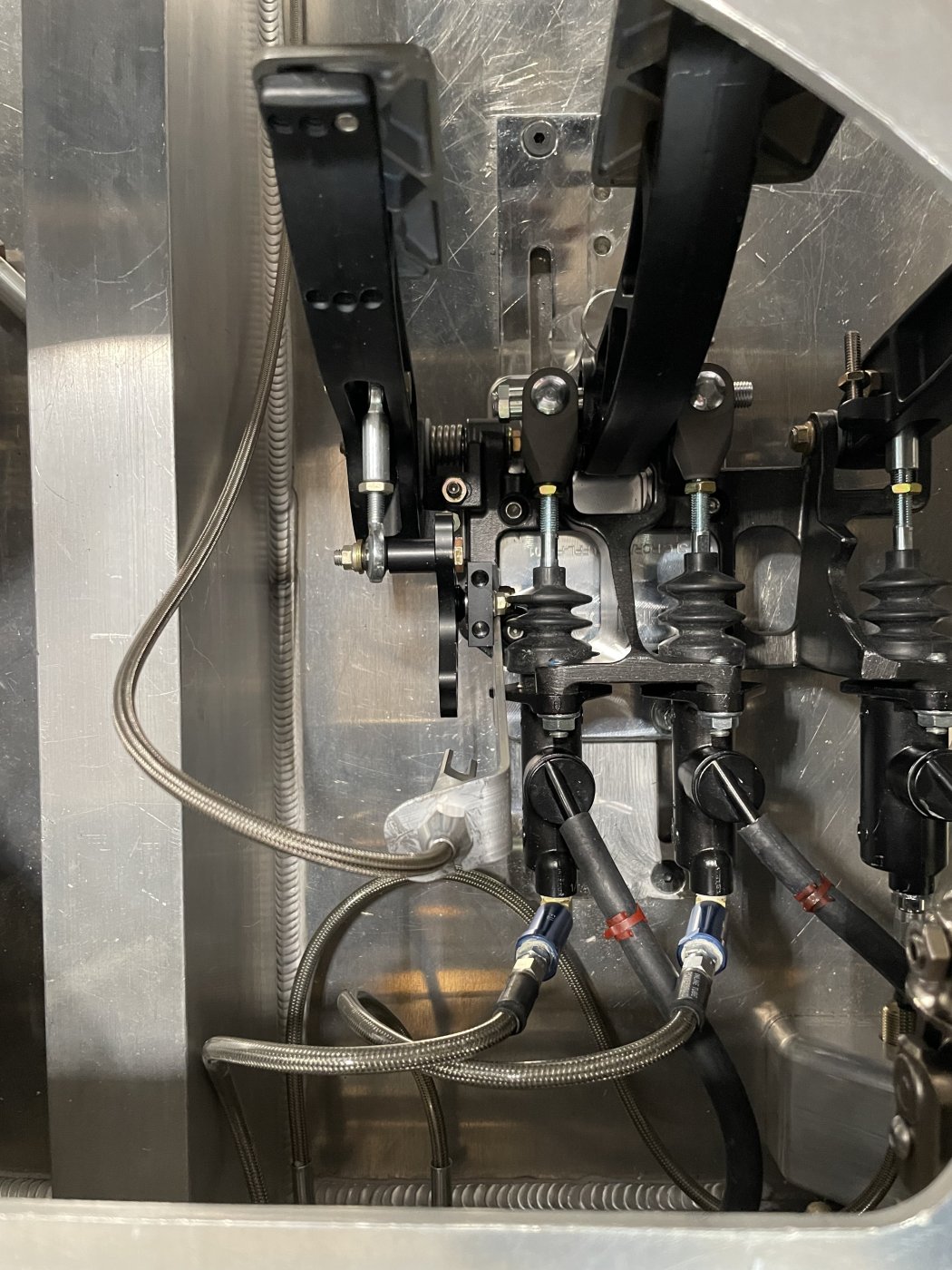

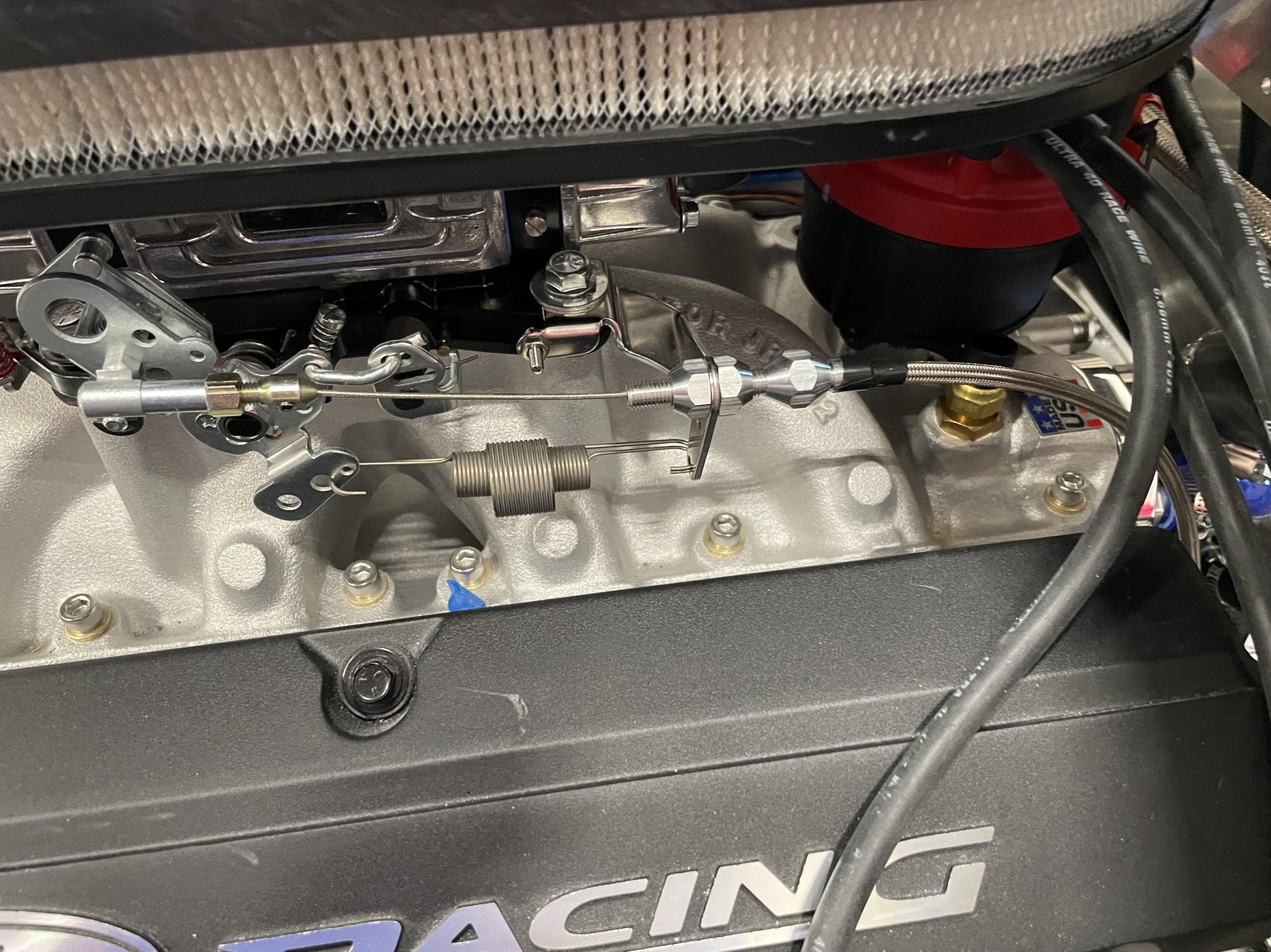

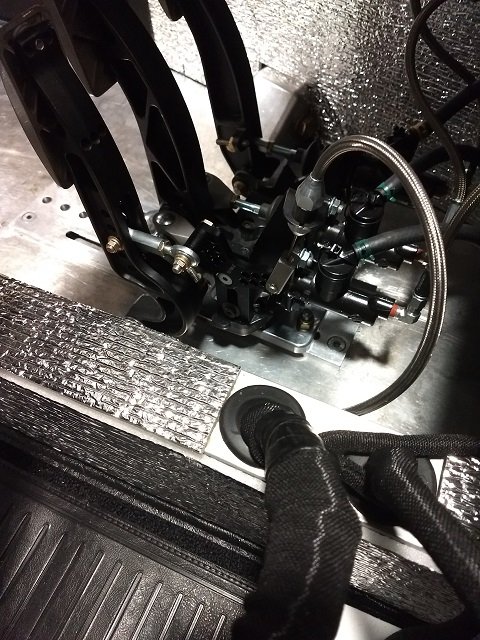

Rod Dittmar
Steve,
I don't have a Borla, but this is how I accomplished my Adjustable Pedal vs. Accel Cbl dilemma on my 363ci carbed LH drive RCR40 :
Wilwood Throttle Linkage Kit 340-12412 & Lokar Throttle Cable TC-1000HT96 (Your length might vary).
From the engine, I ran the Cable through the firewall and down along the LH side of the tunnel. From there it loops up, around, down and attaches to the Throttle Linkage kit via a fabricated Bracket. Several Bracket iterations and a lot of Cable adjustments later it works like a charm. The Bracket being attached to the pedals along with the cable loop allow the pedals to easily move back & forth.
HTH, Rod
Chet Zerlin
Rod was kind enough to share his design with me and I can attest that it works well. Only mistake I made was in using aluminum for the fabricated support because it does flex a little. I'm in the process of changing it for a steel one.

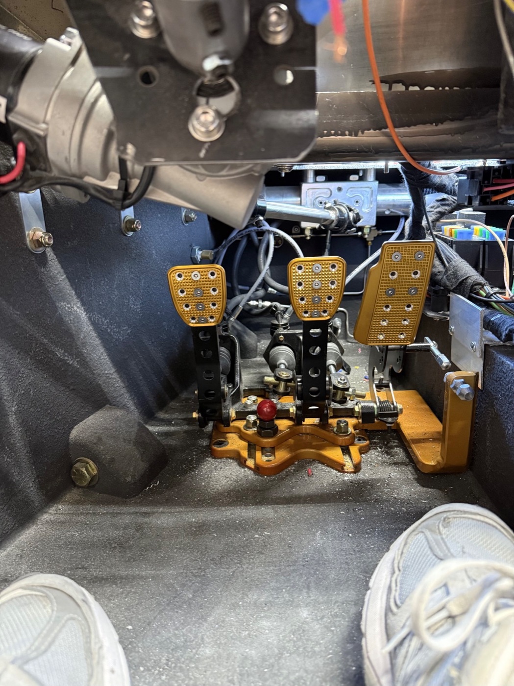

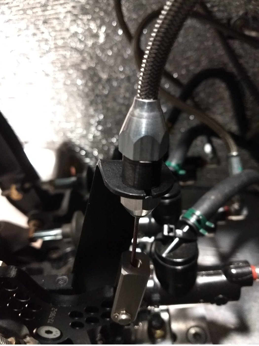

Steve R
This is what i went with in the end. Cheaper than paying for the wilwood bracket lol
nice, but do not forget to add a support on the left to put your left foot when the clutch do not need it. And the support needs to be part of the slidding device.
Steve R
No need for support my foot rests on the clutch pedal. Never had the need for a support. I have one in my cobra and never use it.
