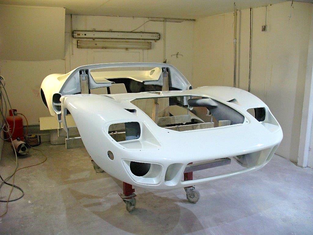

This is how we store our bodies on fitted timber forms and have no distortion issues.
