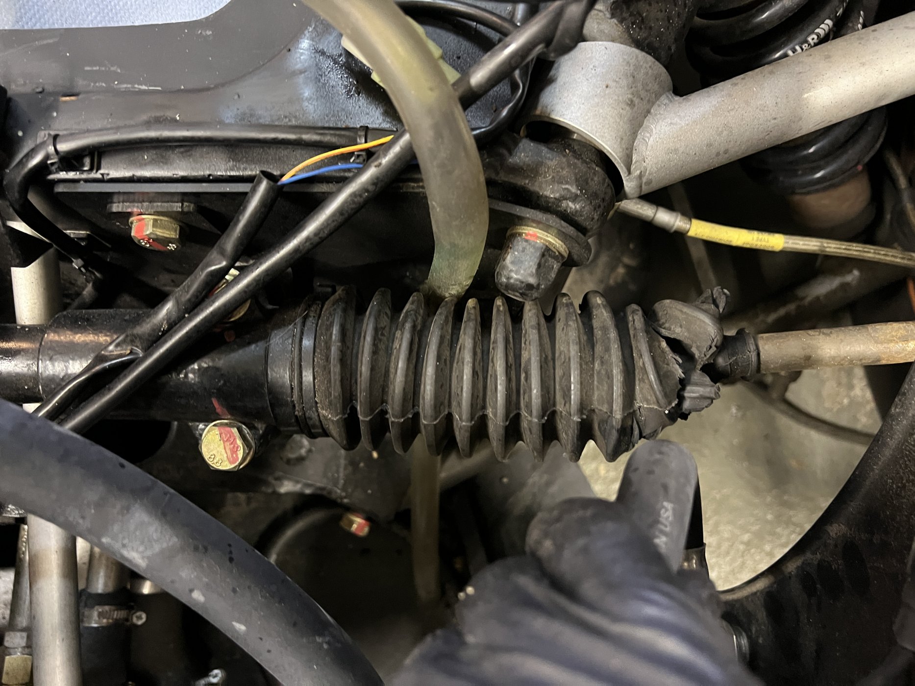

Need new boots for steering rack on my SPF
Just noticed one of the rubber boots is torn.
I seem to remember that SPF uses an MG steering rack.
There is a label on it but all I can read is « made in Argentina ». The number has worn of.
Can anyone tell me which boots will fit.
Which particular MGB rack do they use?
They are supplied by Moss Motors via the manufacturer in Argentina. The boots ("gaiters" in Britspeak) are available from Moss of many other sources including NAPA. Treating them with a good rubber protectant will extend the life. BTW, if you have a MK I while the boot is off you can remove the steering lock limiters, they are split alloy rings held on with a zip tie. On MK I cars the tires may rub at full lock without them, but your turning radius will reduced.
