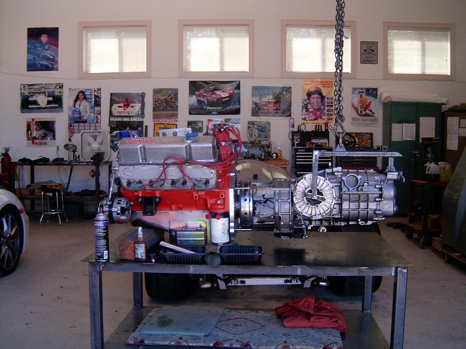

If you have room. A bench on casters that is rated to hold the engine and gearbox on it. Build it out of steel and make its height to suit working on engine. About 5-6 feet long and 3-4 feet wide is just right to install gearbox, clutches, water pumps, u name it. It will also serve as a utility bench for fiberglass layups, drilling holes in flat material, and just about everything else you come upon. Leave the edge of the top overhanging the legs and horizontal pieces a couple of inches so that you can clamp things down to it.
I made this one for about a hundred bucks. I use it all the time
