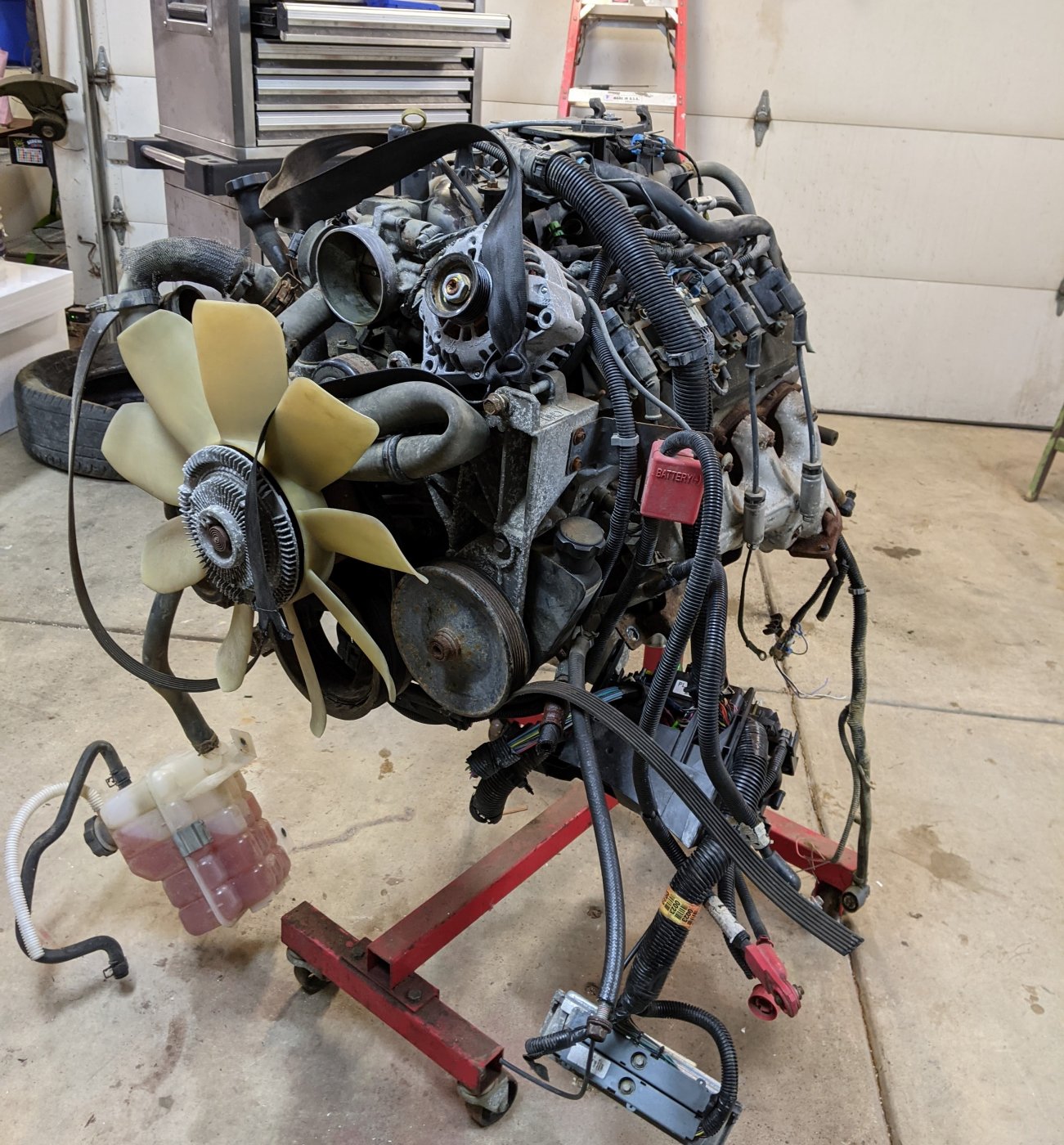

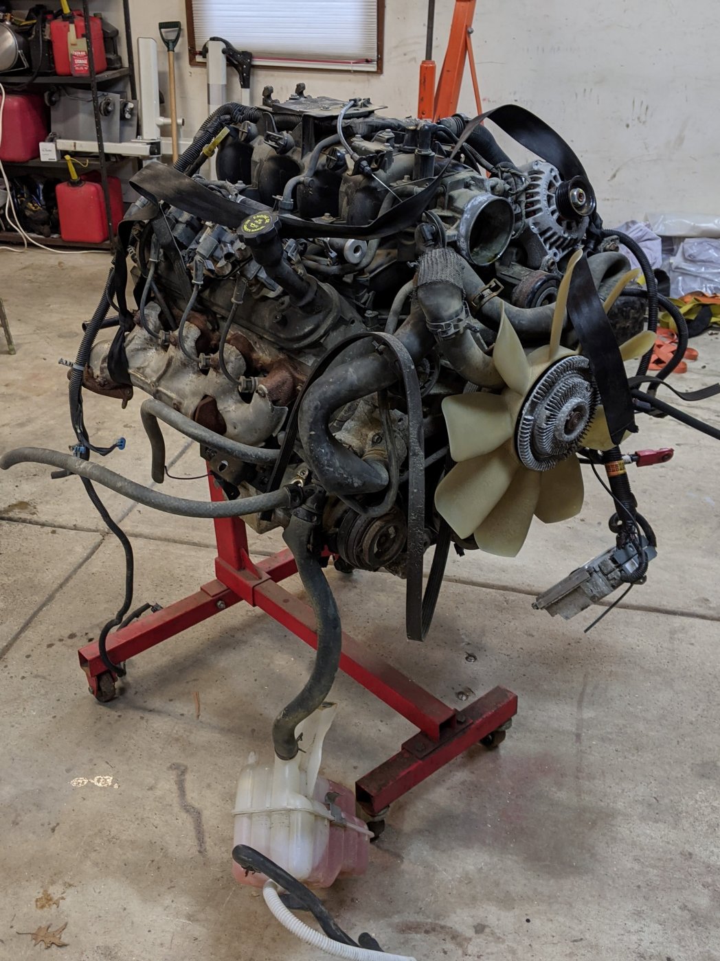

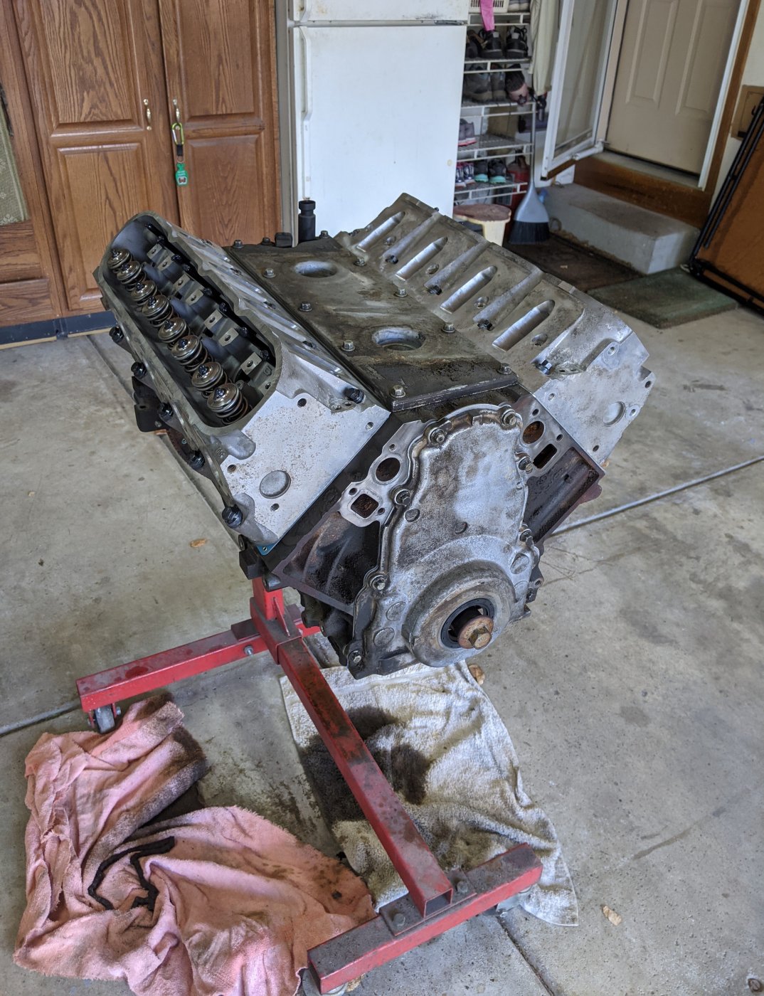

Not really an update... more of catch up on the engine going in the car:
It started out as such a sorry looking heap lol.
It came with pretty much everything needed to run the engine... even the fuse box and coolant tank.

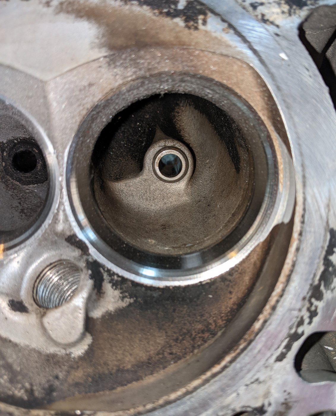

Here it is with the head off the first time:

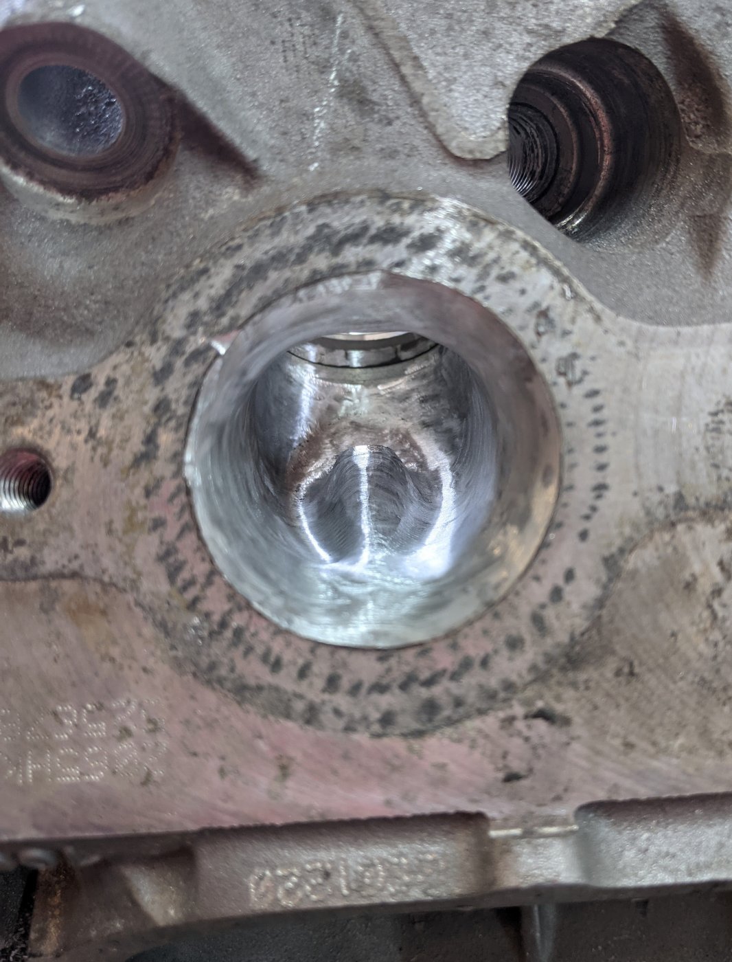

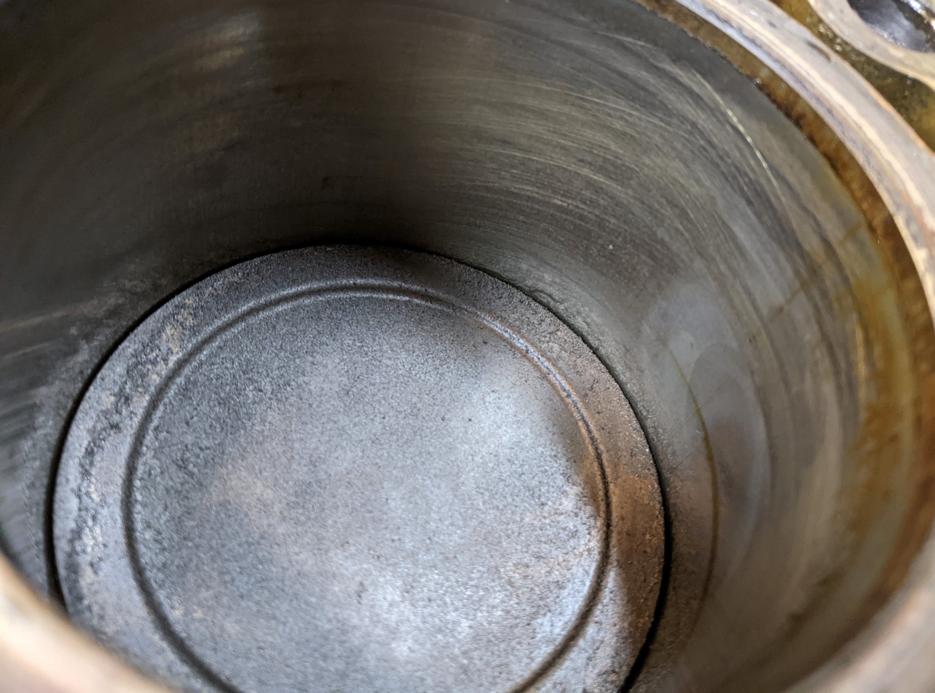

Before I bought it I ran a borescope into each cylinder after popping off the spark plugs. I knew I wasn't in for any nasty surprises, but was happy to find plenty of honing mark left and no deep scoring. The honing marks are polished smooth where the skirts of the pistons push against the bore wall the hardest, but nothing I am worried about.

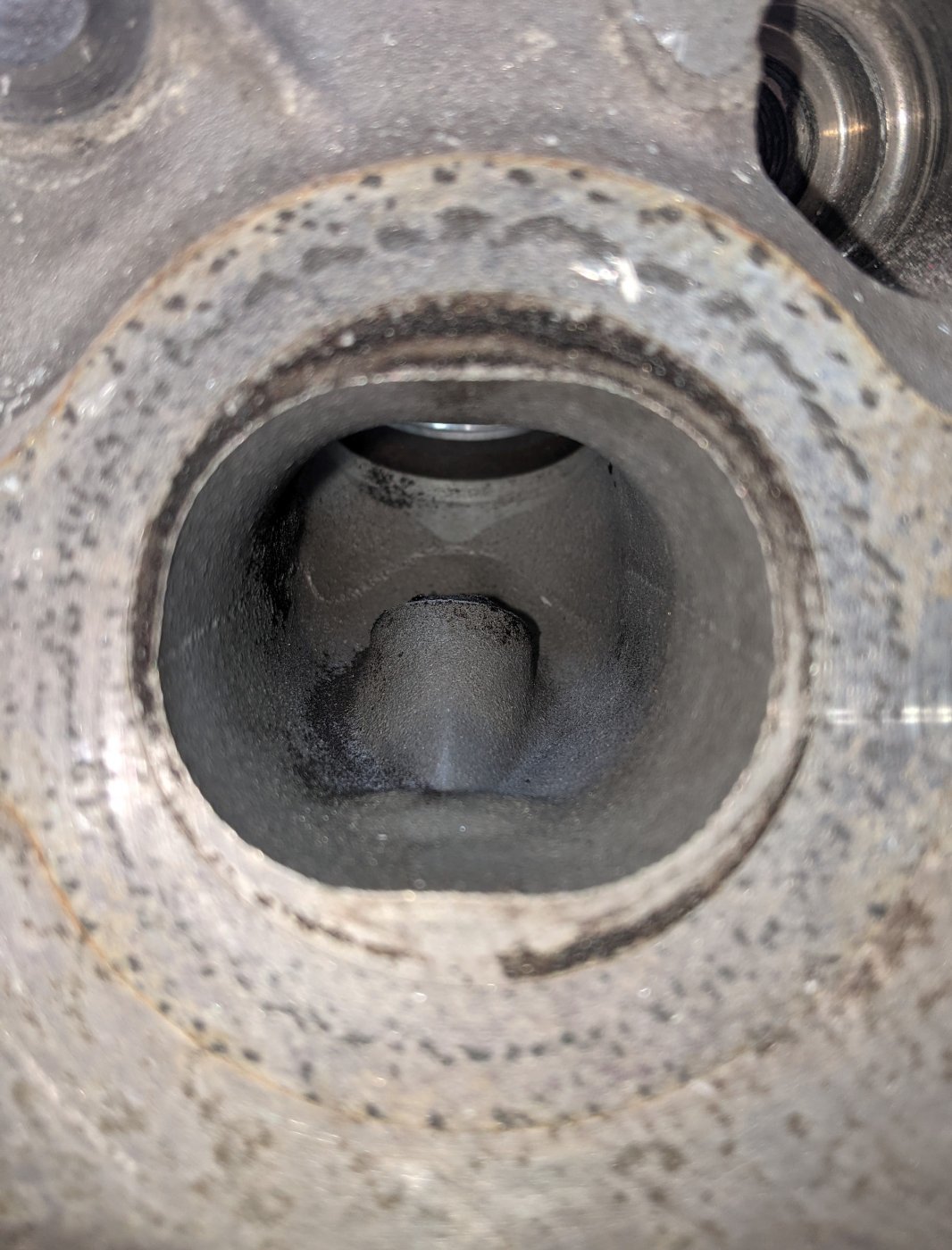

Here are some before and after photos of the DIY porting. It was quite the dramatic transformation. I was thankful my friend was around to point out where water jackets and bolt holes were so I didn't over-do it. I "gasket-matched" the exhaust ports too. When we build the headers we will try our best to keep a smooth transition. It was nice to clean out all the carbon build up as well. He was able take them in to his shop and cut new valve seats as well! I went with slightly oversized intake valves. To hopefully get even more air flowing through the newly opened ports.

Here it is almost back together. Since this photo I have put the rockers back on. For these I upgraded/replaced the roller bearings with a BTR part that adds snap ring on either side of the bearing. The OEM rockers are very strong and well documented to hold extreme horsepower and RPM, however the OEM bearings are held in with end caps simply pressed in to the side of the housing. At high rpm these are known to "float" out and then the un-sealed roller bearings are free to slide off and promptly release their 30 needle bearings into your oiling system. Not exactly ideal. ARP head bolts went in without a hitch.
I haven't re-installed an intake manifold as that is quite the challenge to figure out. I also haven't torqued down the front cover yet. I am looking into dry sump systems / electric water pumps at the moment so it will be coming back off depending on what I choose.
Obviously still lots of cosmetic work to do as well...

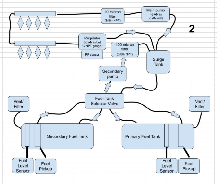

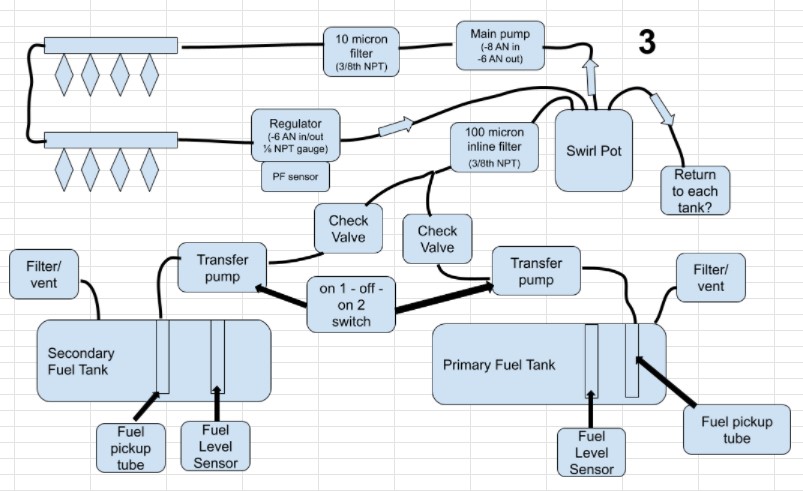

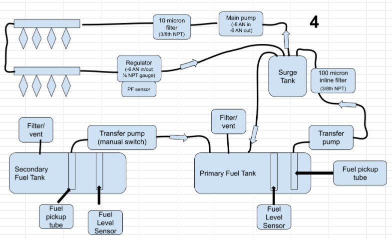

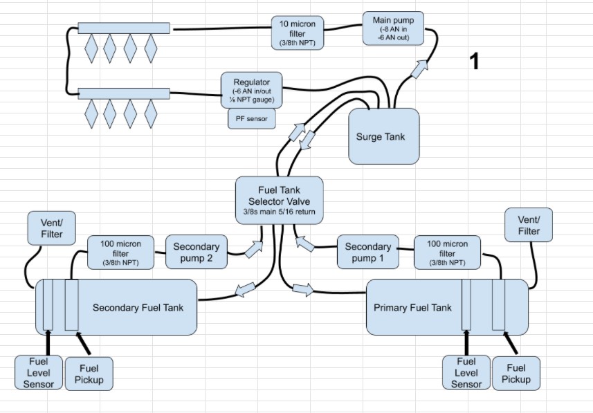

I've spent the past few weeks finishing up the plan for the fuel system. It is still not complete, but I have narrowed things down to 4 decent choices, all with their own sets of pros and cons... I just need to decide on one and move on. Currently my favorite plan is #1, but it is pretty complex. I also cannot find good data/testing on the available 6-port selector valves. I am concerned it may be too restrictive. However, if it works out I think it will be a elegant solution, especially because it will also switch over fuel level sensor data (I think). Option #4 below is nice and simple which is tempting.
Currently I plan to try and weld up a custom surge tank. (lots of TIG practice planned... I currently stink. My dad is pretty good with a spool gun). Id like to run Holley's 12-170 universal pump off the surge tank to supply the injectors. Most retail surge tanks come with pumps integrated in and seem way overkill for a stock LS. Also expensive. Also most don't have many attachment points. If I find the right one maybe I will change my mind.
Still looking for a good inexpensive pump to move fuel to the surge tank. I've picked out a Walbro GSL392BX for this. Any other suggestions welcome. They are $73. Not too bad. Curious to confirm how well they survive scavenging air momentarily to pull fuel up and out of the tank.
I was considering installing traditional fuel strainers on the ends of the pickup tubes and an initial large particle filter. Then I realized the RCR tanks don't have large holes. Instead inline filters will work. I actually think I like these better anyways. (looking at Holley 162-551)
Any suggestions or wisdom is always appreciated...
I like #3, but there is a concern.
The return will be a little unpredictable if you just Y it and unless you add a diverter valve to put it back into the tank you're pulling from, or just return to the primary and have some electronics to shut the secondary tank pump off when the primary tank is full. If not and you have 3/4 tank in both and forget and leave the secondary on, you could overfill the primary to the point it's burping out. A simple float switch and relay can handle this.
But having 2 jockey pumps, one from each tank to the swirl pot is my preference once you eliminate the overfilling issue.
I'll be welding my own swirl pot, so I'll just include a 5th port and level sender and eliminate the check valves. For that matter, I'm using Bosch 044 pumps and I'm pretty sure they have an integral check valve.
I like 1, basic 2 pump system with a Pollack valve. With any of these, what controls the level in the surge tank and what tells the surge tank to return to the main tank and what drives that?
By using a SPDT switch with a center OFF, as shown, you cannot have both pumps ON at the same time.
I ran Number 2 for 15 years. Worked well.
You can also make it a bit more compact by running an internal pump inside the swirl pot. Like these http://www.radiumauto.com/FST-Fuel-Surge-Tank-Standard-P515.aspx. Pretty scary price though.
And some fuel injection systems run a dead head line so high pressure pump to fuel pressure regulator to fuel rail, with no return!
Hint, to ensure your High Pressure pump lasts, fit a manual switch so you can turn the low pressure pump on to fI’ll the swirl, so high pressure never sees air. A few seconds or air shortens the pump life considerably!
