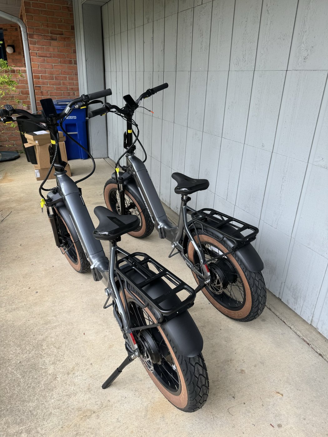

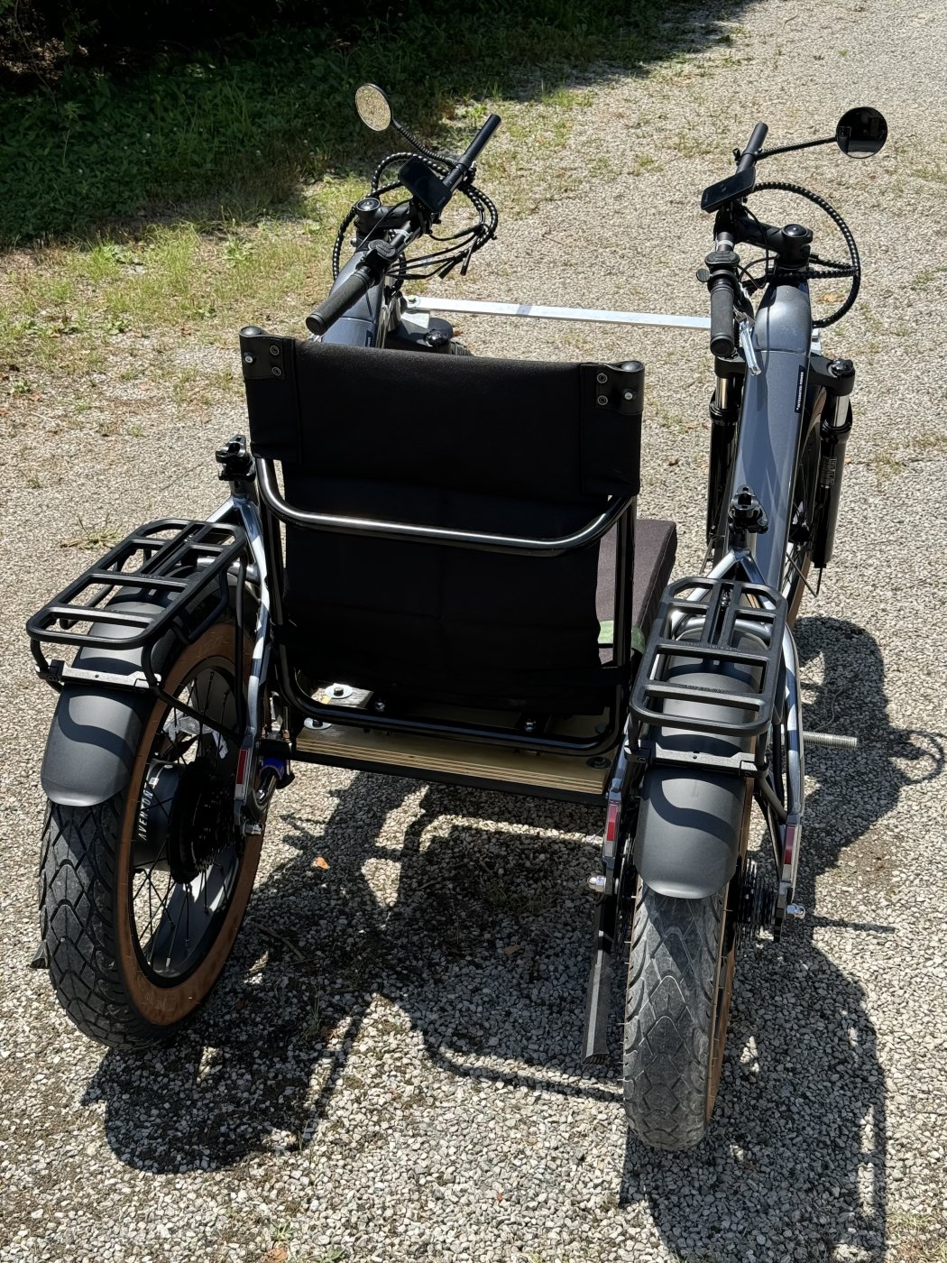

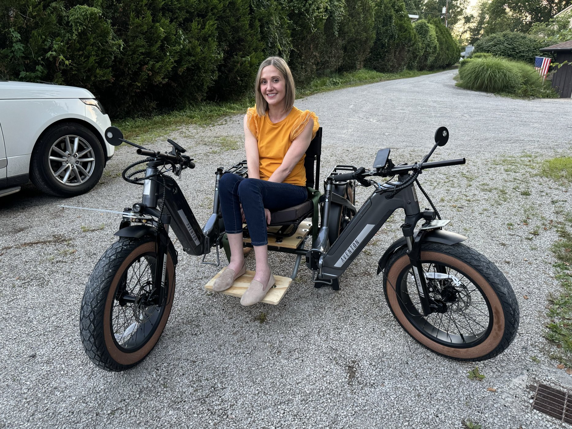

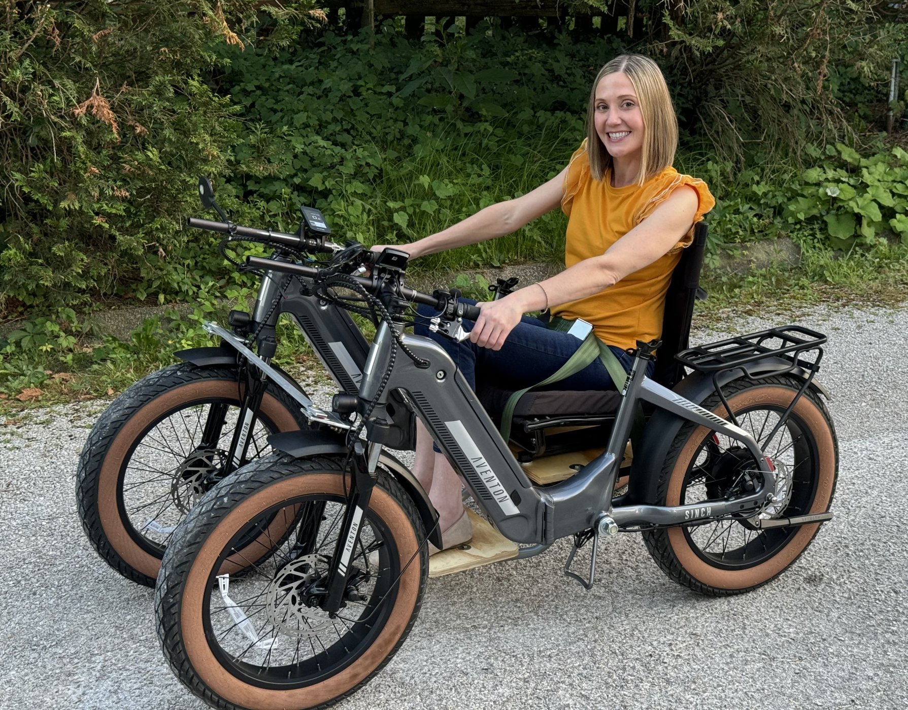

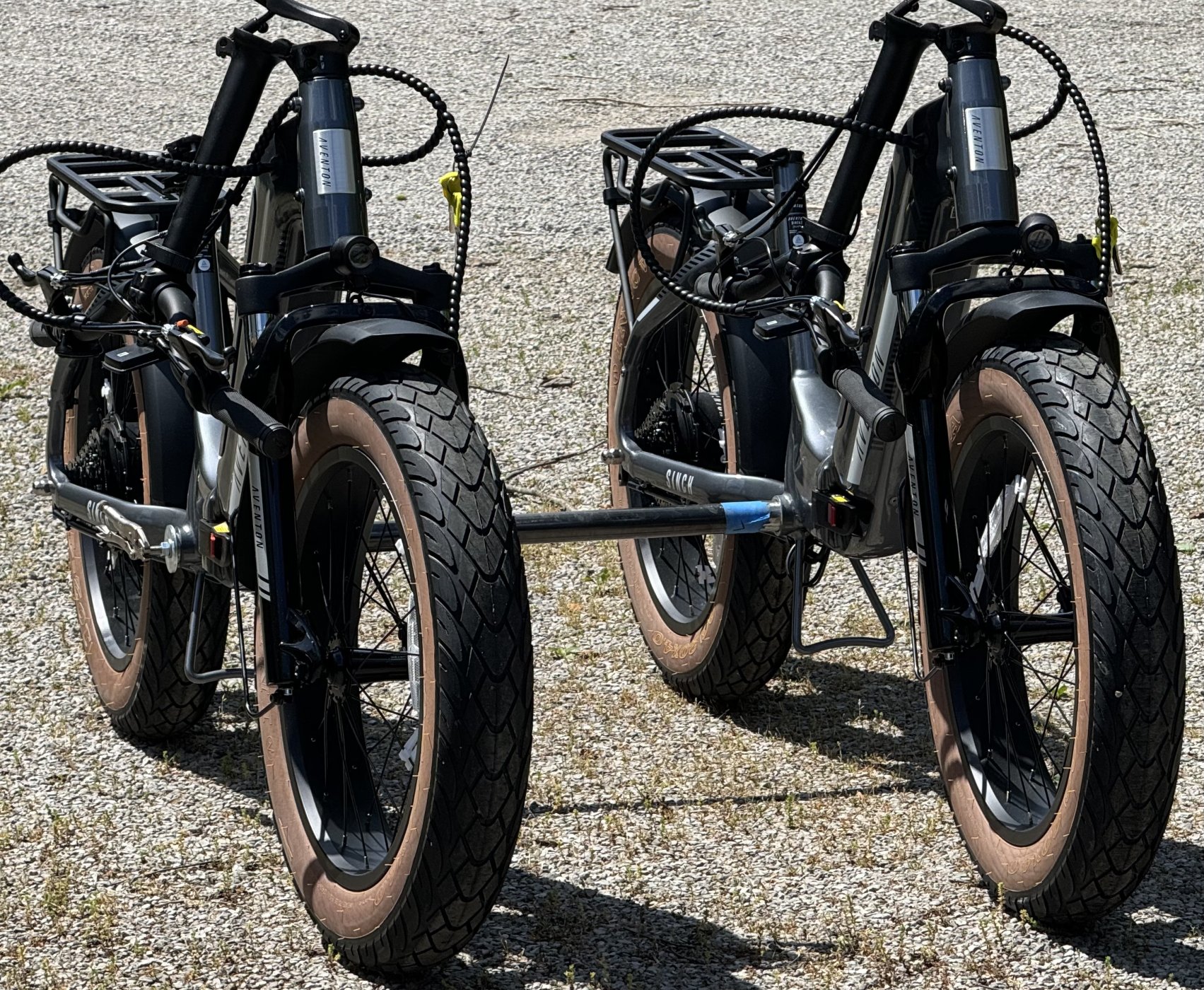

My girlfriend is in a wheelchair and hadn’t gone on a bike ride in years. I found an interesting idea on the ole internet and modified some of the components and built an electric wheelchair bike out of two electric bikes. It was a success and it works great. Both bikes are still independent with separate throttles. She can typically cruise around on the power of one bike, but if there’s a very steep hill, both bikes can be turned on for extra power.

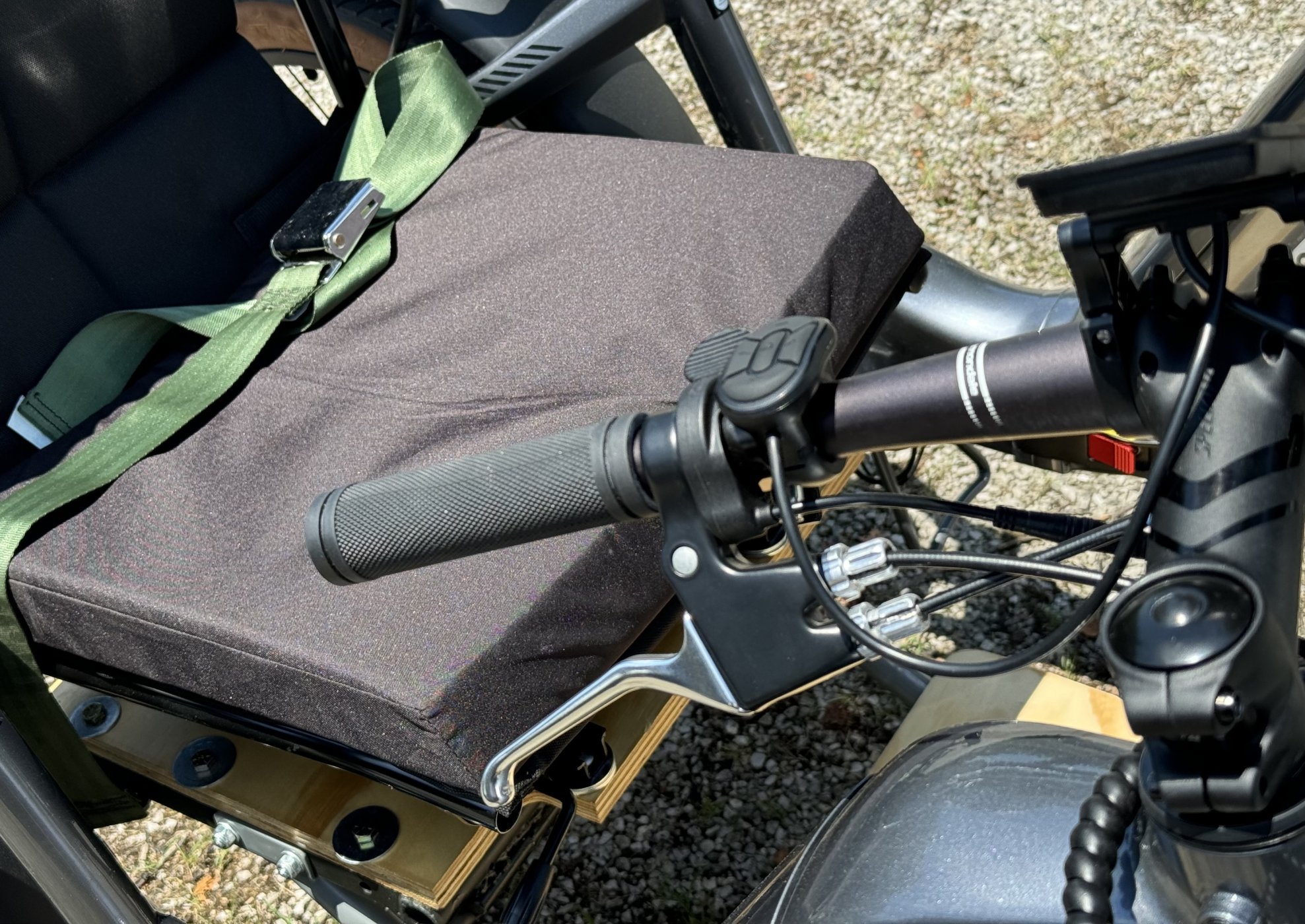

I also added dual brake levers to each side, so she has disc brakes to all four wheels for extra stopping power.

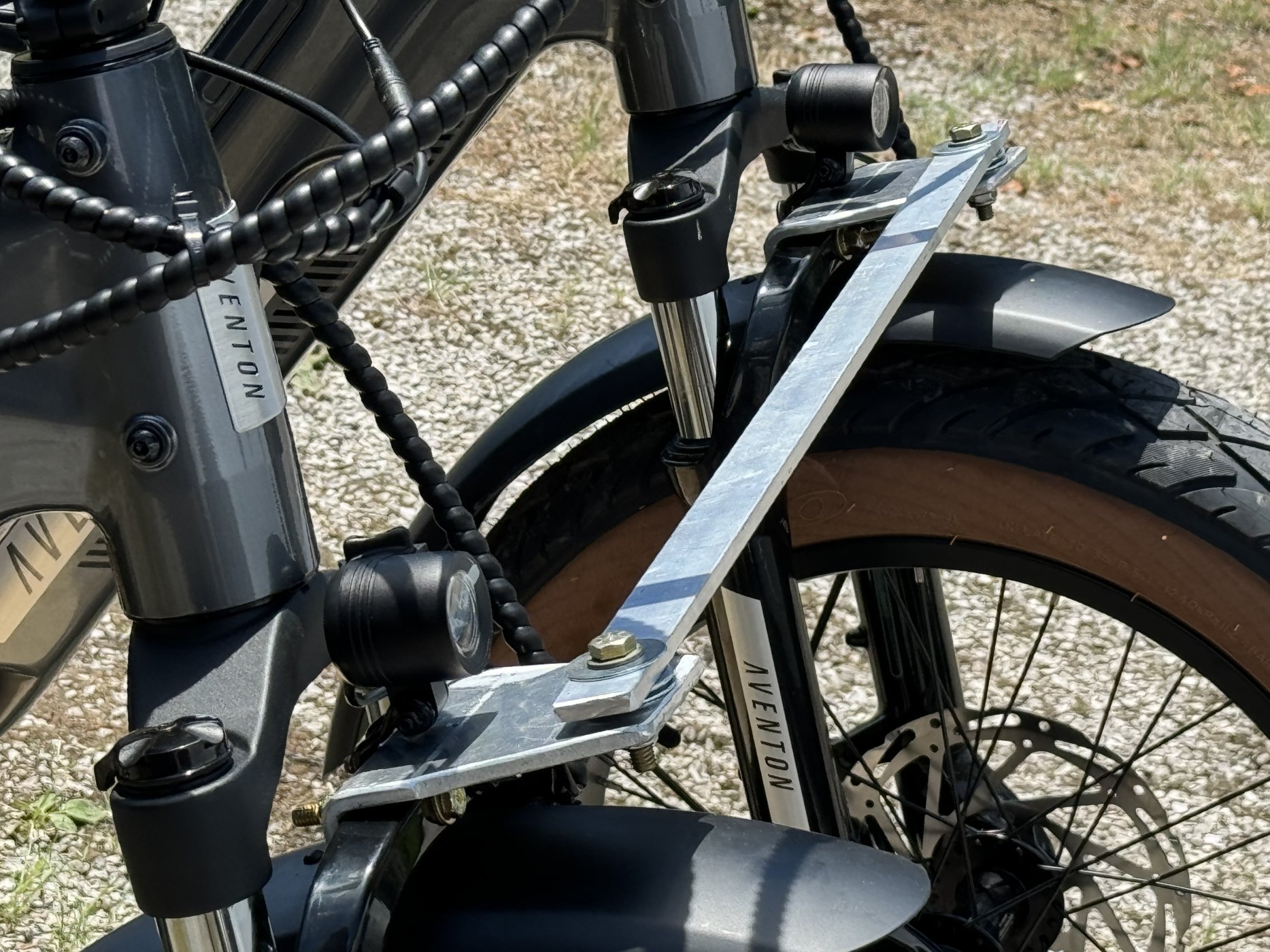

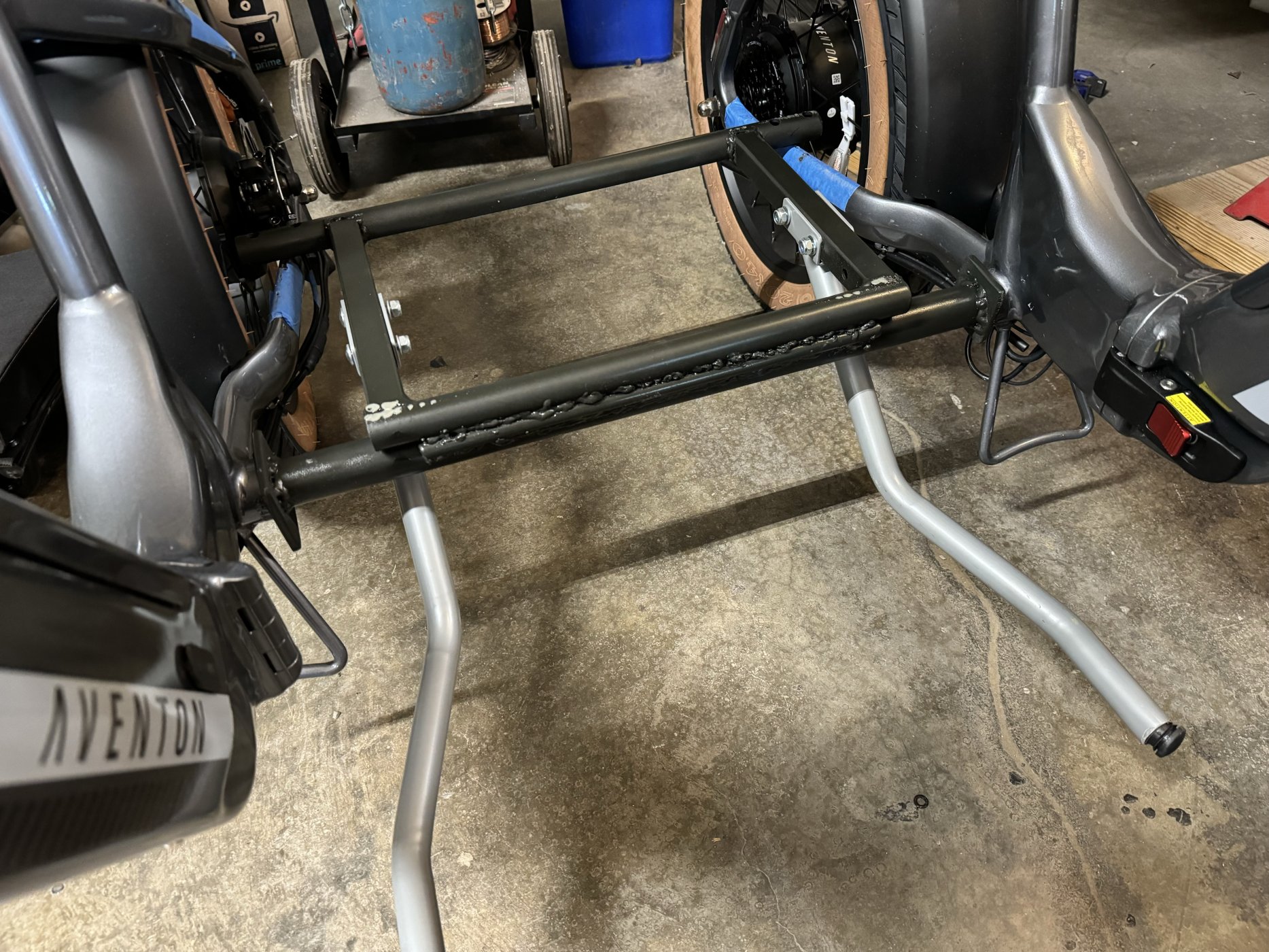

I used two Aventon Sinch 2 E bikes with 20” tires. They’re folding bikes, so with a wrench I can disconnect the steering linkage and open it up for easier transfers, but she figured out how to transfer over without needing to do that. Still, it’s an option if needed.

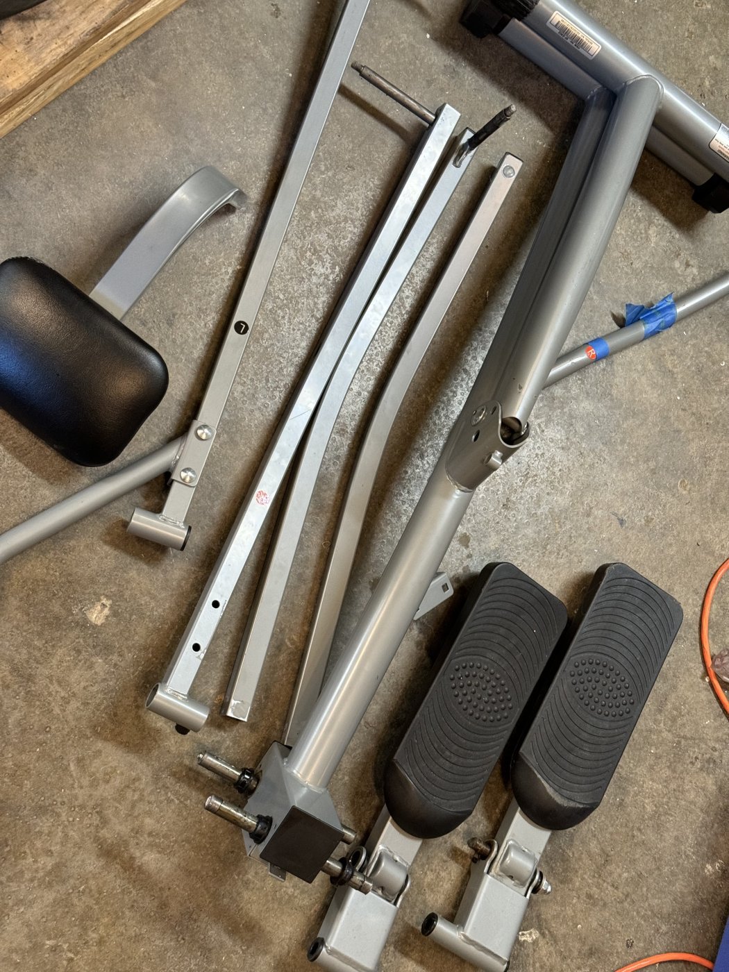

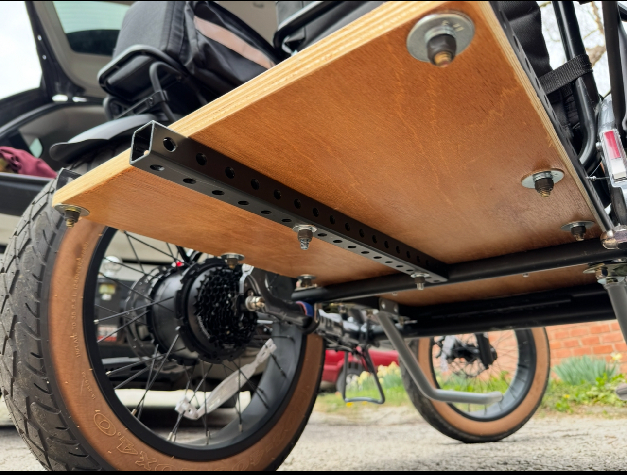

I used some scrap steel from a broken elliptical machine that my neighbor was throwing away, which presented a nice solution for the footrest.

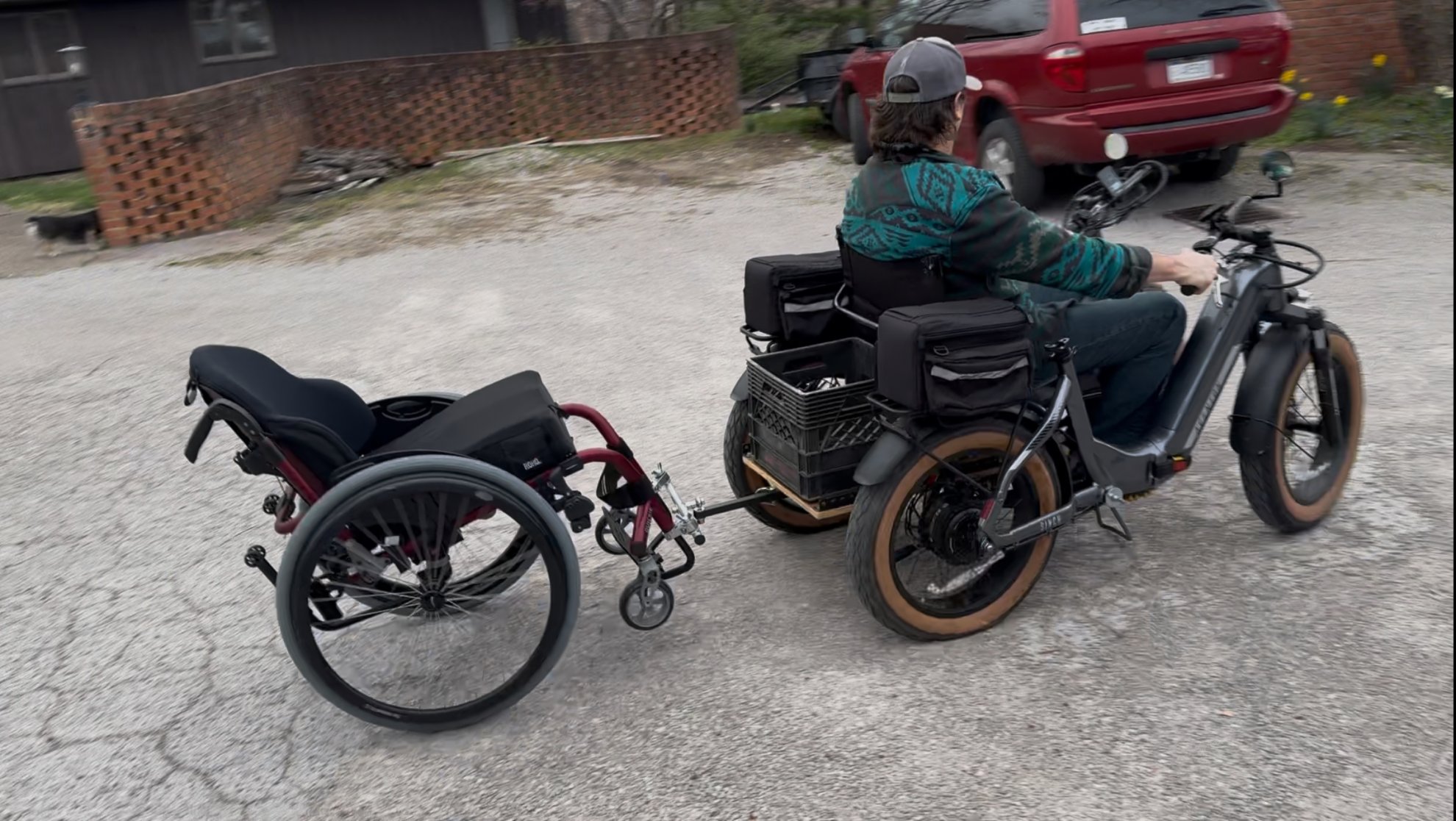

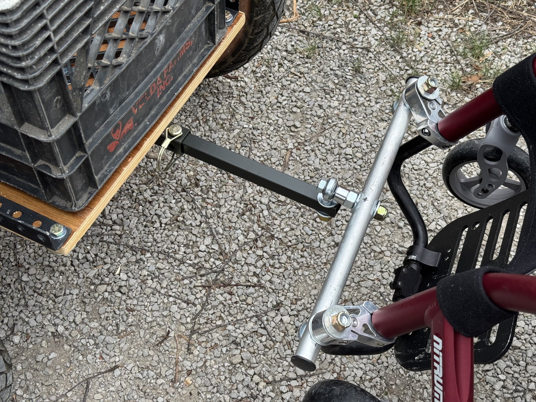

Later modifications included a longer back deck with an old milk crate for storage and a tow hitch setup so she could bring her manual wheelchair along for bathroom breaks or side excursions, etc.
So if any of you has someone in their life who’s wheelchair bound or has trouble safely operating a two wheel bike, feel free to use this idea and improve upon it.
