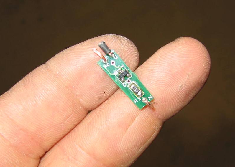

Well, since my ISIS harness was missing the inVert modules is was supposed to have, I don't know what they look like.
Here is an invert module. This tiny circuit board was spliced into my ISIS harness. The ISIS control module only understands ground signals, so the invert module converts a +12v signal to a ground signal.
For those of you building with a GM LS engine, here is what Infinity (formally ISIS, guess they were having problems with the no fly list) told me about the module. On your harness kit you will have the main harness that goes from the rear power cell to the front power cell. You will find a blue/yellow wire singled out from the main harness with a pin soldered onto its end. This wire is the fan signal wire from the GM Fuze box, to the infinity master cell. That pin IAW their instructions will be inserted into pin location 5 of the master cell connector. If you fell along that single wire sleeving, you will feel the invert module.
Infinity said that after about 2013, they included the module into all the SLC harnesses. Bottom line.......you need that inverter to keep from blowing a diode out in the master cell.
