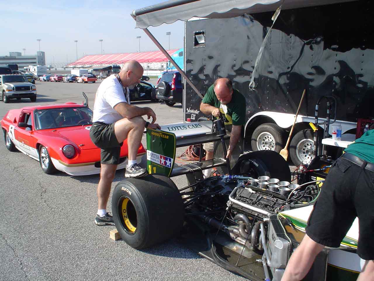

Hi John. I did a little pit crew work for Dr. Jim Roberts and his Lotus 49. Wicked quick.
I have a picture of the 49 and also the F1 Lotus 102B that I also got to crew. When we pulled the cover off the 102B I told myself I was going to put one of these in the back of the Esprit. The 102B is the inspiration behind all this.
My pictures are too large. I will have to decrease the size.
louis
Lotus 49 and the Lotus 102B driven by Mika Hakkenin(sp?)

To correct a few things in the picture I posted.
Its a Lotus 47 not a 49 and Mika Hakkinen drove the car back in 1990. In the picture is my good friend Hamies and Lee Clark (positioning the starter) of Barbour Motorsports Museum in Birmingham AL. The museum houses one of the largest collection of Lotus race cars in the world. When that Judd V8 fires up its sweet. Gives me a tingle just thinking about it.
