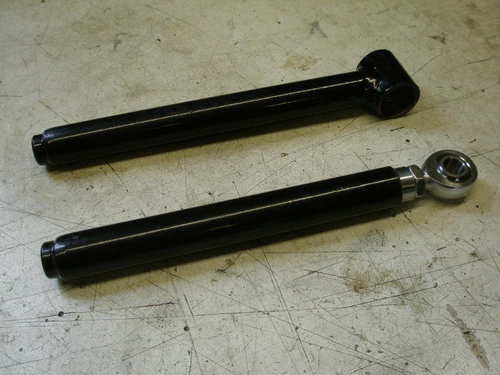

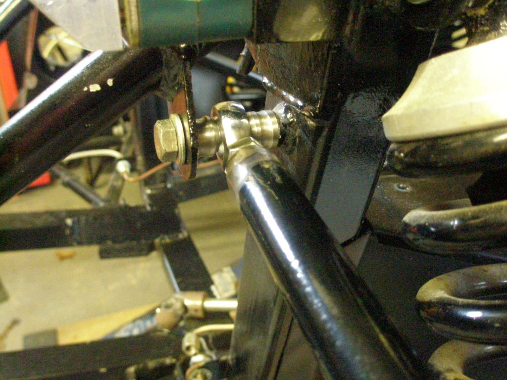

I’ve currently got Rally Design Poly-bushes fitted to my chassis and after recommending them to John Christian, an issue has arisen, specifically around the use of the bushes in the rear suspension. See previous post: http://www.gt40s.com/forum/gt40-tech-chassis-brakes-tires-wheels/35870-poly-bushes.html#post354779
<?xml:namespace prefix = o ns = "urn:schemas-microsoft-com
P><P><FONT size=3><FONT face=Calibri>The bush set (PB121), is sold as suitable for a <
<st1:City w:st="on">Westfield</st1:City>, however when used in a ’40 there seems to be excessive play after a while. As supplied the inner sleeve is a light push fit into the bush, but when I’ve fitted these before from other manufacturers, they are really tight fit. I’ve measured the Shore hardness of the bushes, which is about 80, so no issues there. <o:p></o:p>
<o:p></o:p>
On the front suspension, both the inner joints are used in pairs therefore the forces in the bush is halved. However on the rear inner the same bush is used singularly, effectively doubling the load.<o:p></o:p>
<o:p></o:p>
Also to function as designed, the Poly bushes has to be fully supported (i.e. clamped between 2 plates to prevent the bush deforming) whereas as on the rear top inner mount on a Tornado this is not the case, with the bolt tube coming through the chassis and then welded. <o:p></o:p>
<o:p></o:p>
So a few recommendations:<o:p></o:p>
  • Replace the inner bushes with a rod ends. Adding one to the top link and using a L/H thread makes changing the camber much easier<o:p></o:p>
  • Fit a stiffer bush, it may be easiest to replace the current bush with a hard nylon etc.<o:p></o:p>
  • Fit a larger inner tube, which would effectively put more pre-load on the current bush, causing it to stiffen <o:p></o:p>
  • Use the original specification metalastic bush, however I’d still be concerned about the long term durability of this.<o:p></o:p>
  • For the top inner mount on a Tornado, grind back the chassis support tube sufficient to add a larger washer too effectively prevent the bush from deforming. There is sufficient material to grind 3mm off the tube for a washer and not touch the weld.<o:p></o:p>
I’ve replaced the top inner link bush with a L/H rod end and replaced the lower inner bush with Nylatron<o:p></o:p>
<o:p></o:p>
Hope this all makes sense<o:p></o:p>
<o:p></o:p>
Regards,<o:p></o:p>
Andy<o:p></o:p>

Hi Andy,
Very intresting what you say about the bushes, and sleeves. As I have those bushes for my GT40, I looked to see how tight the sleeves were in the bushes I have
The sleeves supplied are a light push fit in the bushes, But I have had to make my own sleeves, because I need slightly longer ones. So these longer ones were made from 16mm Stainless steel bar, and they are a much tighter fit, when I measured them, the supplied ones were 0.12mm smaller, so it would appear the supplied ones are made from 5/8" (15.88mm)
So a easy way to make the sleeves a tighter fit, is just to replace the 5/8"sleeves with 16 mm sleeves.
Thanks for pointing out the problem
mick
Andy:
I can tell you that part of the problem with the rear suspension bushes is the fact that the radius rods, upper transverse link, and innner-lower wishbone mounts all work in two axes.
Your uprights don't travel straight up and down but in an arc described by the two radius rods, this puts not only rotation in the bushes, but a twist and consequently excessive wear.
The radius rods also twist as well as rotate so there is a bit of binding there also.
You would also be surprised how much bind there is in the rear.
High quality heim joints do a much better job and have zero bind if setup correctly such as the way that you did the inner pickup point on the transverse link. Give them room to work and they are very smooth.
You probably wont encounter the same condition in the front because the wishbones are a fixed structure using only rotation at the mount without twisting, so the only bind will be friction from the bushes.
Installing the bushes with silicone grease also smoothes them out a bit.
Hope some of this helps
Phil
Hi Phil,
Thanks for the comments. I must admit I’d forgotten about the rotational aspect of the bush loading and this was probably the more significant element of the failure mode that John Christian noted when he used them as supplied.<?xml:namespace prefix = o ns = "urn:schemas-microsoft-com<img src=" /><o:p></o:p>
<o:p></o:p>
Whilst my proposed solution will not give any rotational freedom on the bottom inner joint (a tight fitting nylatron bush) there should still be sufficient compliant in the outer pair of lower bushes to compensate.<o:p></o:p>
