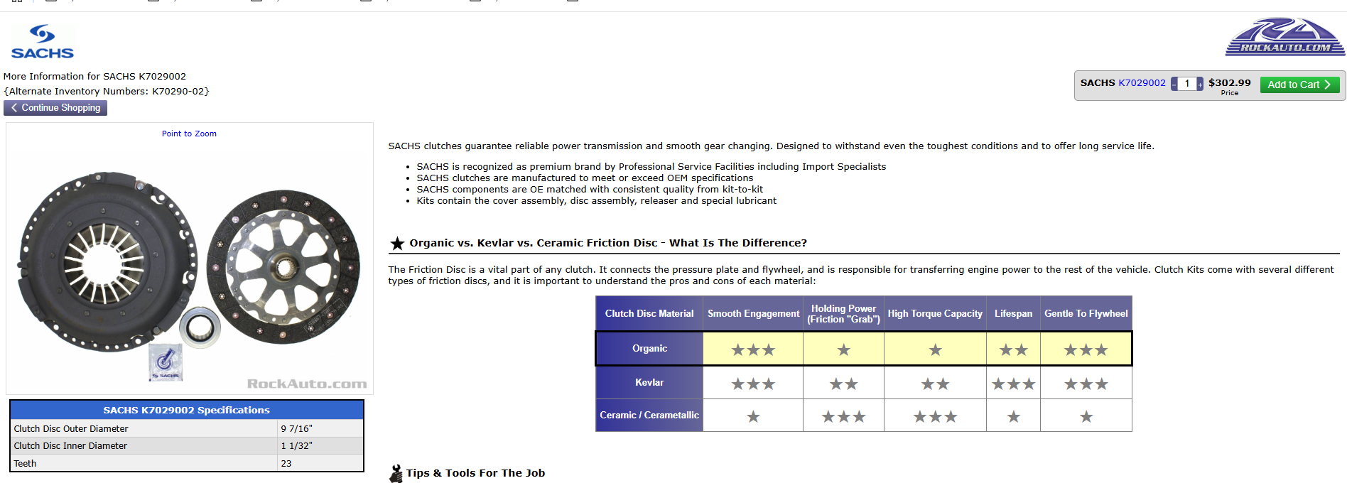

I purchased my flywheel and clutch from Fran. You will need a LS flexplate for an automatic transmission to go with it on your LS3 and a standard LS starter. The clutch I am running is also available on Rockauto. It is a basic Porsche clutch for a G96.01.

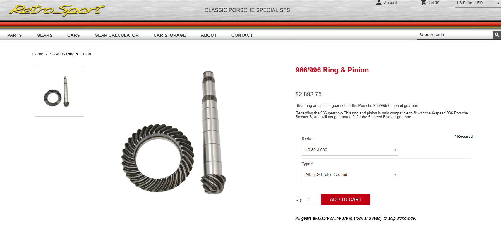

My G96.01 has 3.44 gears which equates to 200 MPH at 7,200 RPM. My valvetrain is built for that in my motor but I would not want to hold it there indefinitely. I believe that 4.00 and 3.00 gears are available for the G96.00 if the 3.44 does not work for you. I have had little seat time in my car since we have moved and are currently building a house. Everything including the SLC is in storage until the house is done later this summer (hopefully).

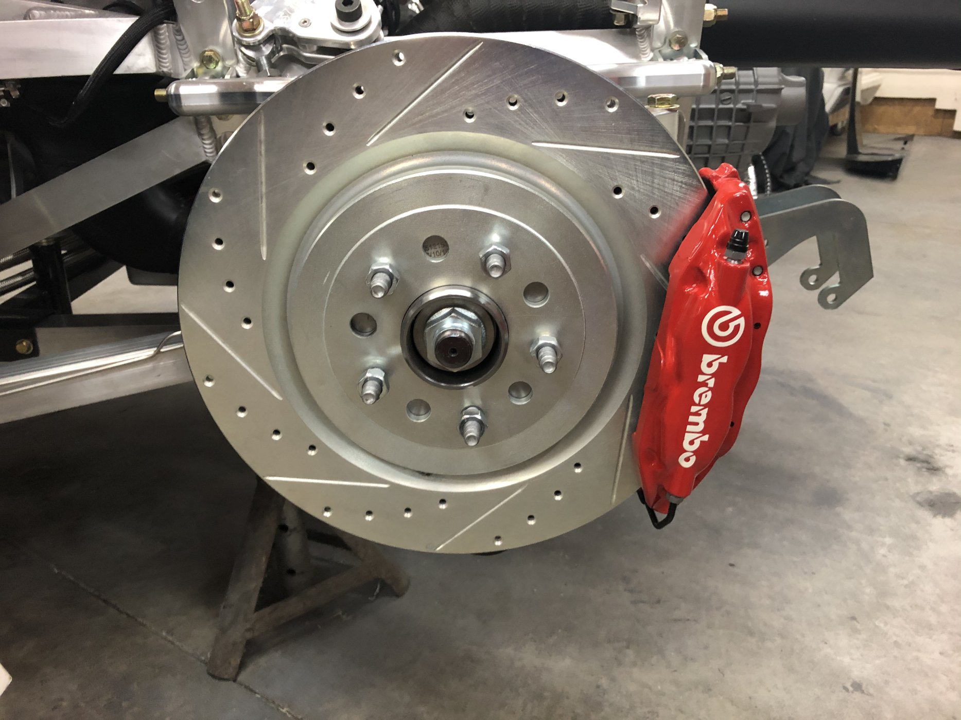

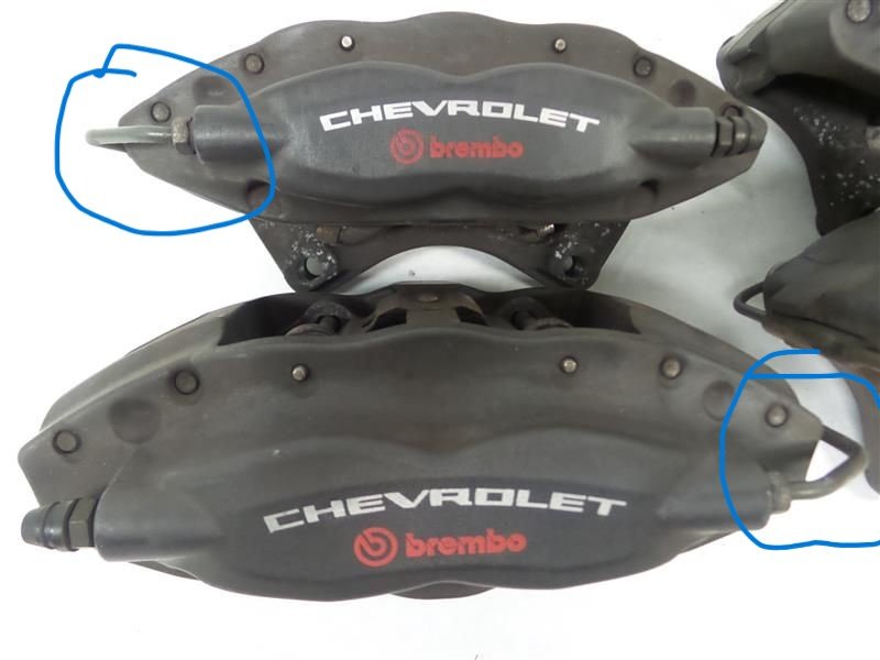

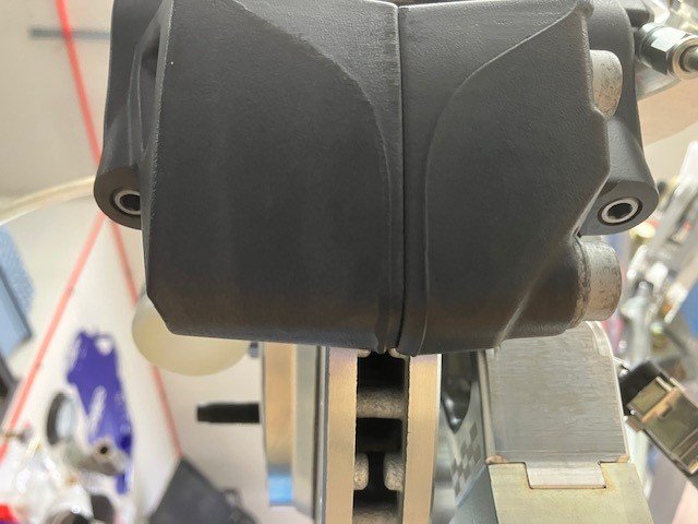

I've already got my brake and coolant lines run and pedals installed and I'm laying out the fuel system. The question I had was regarding the rear brake units. If you look at the front Brembo's there is a line that connects the inside and outside pistons giving you the correct compression from both sides of the rotor. On my rear calipers as seen in the picture the cross ports do not have the cross line to feed fluid to the outside piston as shown in a set I found to illustrate what I'm trying to figure out.
Cheers,
Scott

This is what I have seen before. Looks like it would be an easy line to create.
Ken Roberts
All four of my Brembo calipers have the jumper lines. Hopefully Fran sees this issue and makes it right. He seems to comment more on the Facebook SLC group these days.

Some calipers can be taken apart into two halves and a spacer that holds them at a set width apart.
Dependant on width of disc (non vented, vented etc) the spacer can be purchased thicker or thinner to match
After the thickness is sorted then the cross over tube needs to be made to match the desired set up

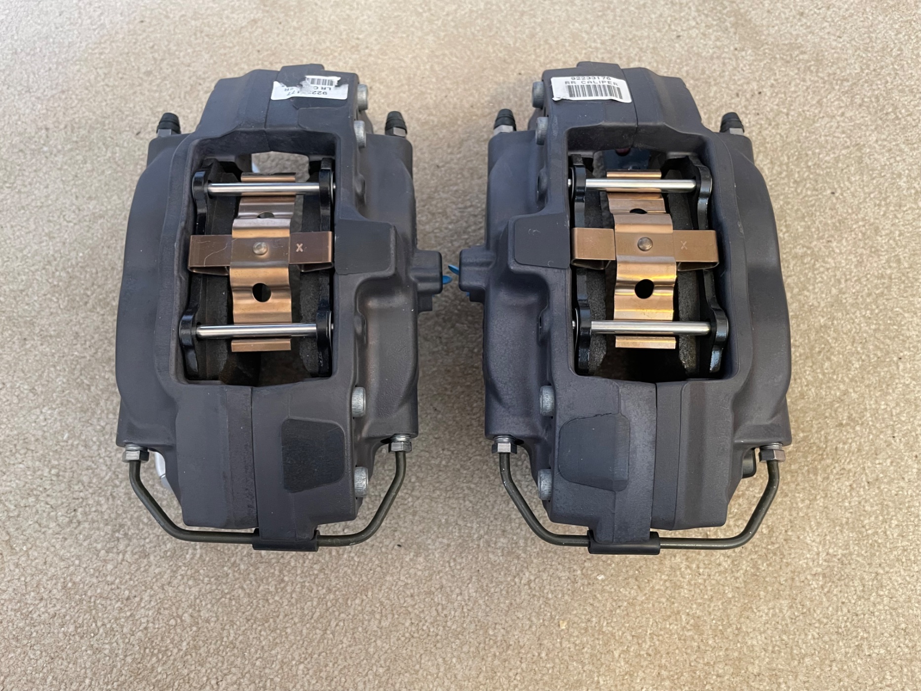

Scott, my calipers were shipped in the GM box brand new and those connecting tubes were already installed.
Worst case, should be pretty easy to fabricate as long as you find the correct fitting.

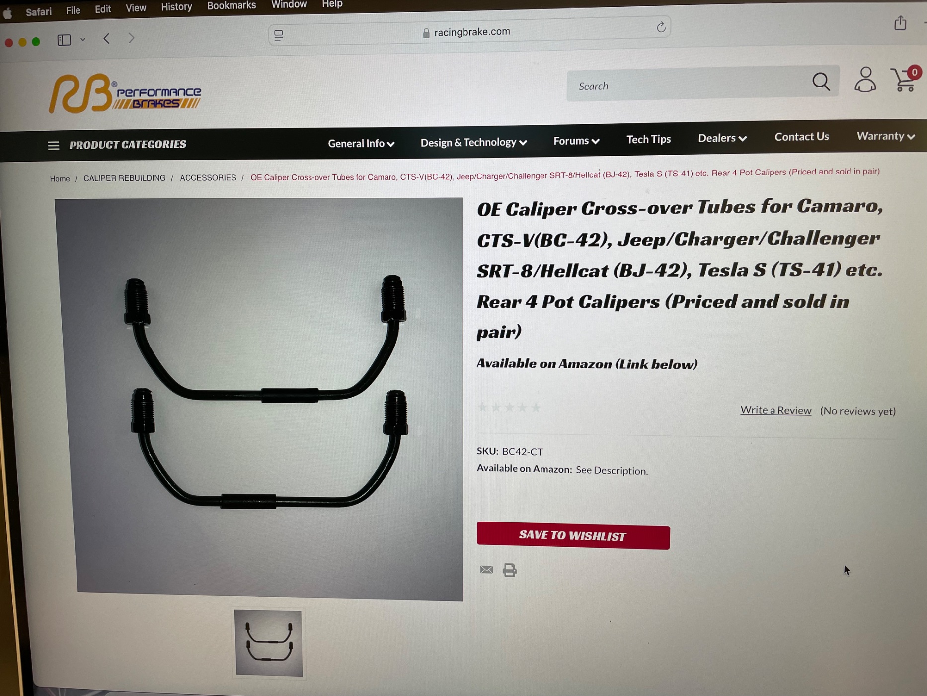

Also, here is a link to ones that fit Gen 5 Camaro SS Calipers.
Ken Roberts
Here is a picture of my spare rear calipers. Also a photo of the crossover tubes from Racing Brake for the rear position Camaro Brembo calipers.
Got this message from Bill:
The caliper people have been posting about on line is an older one that Brembo discontinued. You can see the part number on the label if you expand the photo and check the status yourself. We had a lot of uprights already produced and on the shelf and this discontinuation cost a bunch of money.
The calipers on your car is a newer spec and is correct. No crossover tube.
Looking at the Brembo site, looks like they are moving away from the external crossover tube on all their calipers. Curious why they still retained the ports in the castings of the housing.
I guess they would be the bleed nipple location. ports at each end means they can be fitted which ever way up is required ?
