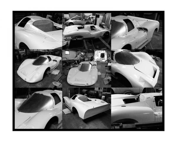

UK 908 /910 / 917 bodies
Jim Rosenthal
Stunning, Chris, are you going to do a 904? not that I should take on any more projects, I need to finish my GT40 and then take a long trip in it..

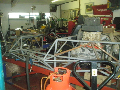

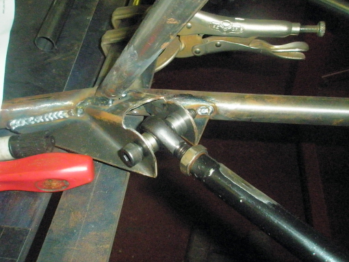

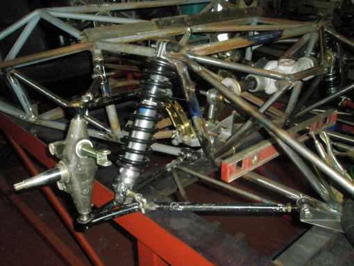

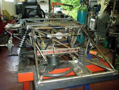

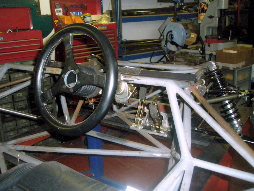

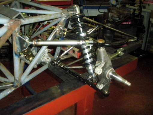

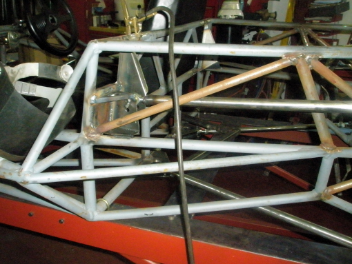

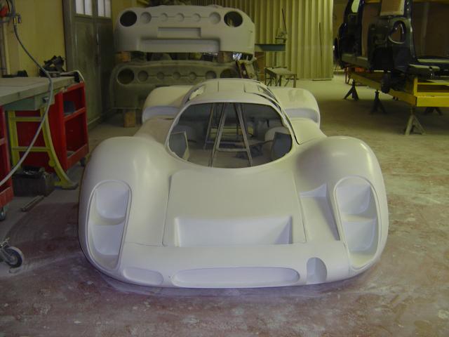

Some progress on the prototype 910/906 chassis. We are just positioning and checking as we go.
We are using the 911 steering rack, and column with Momo wheel. Porsche uprights ect.
The suspension is fully adjustable.
Once we are happy with the setup we will blast and powdercoat.
regards
Chris.

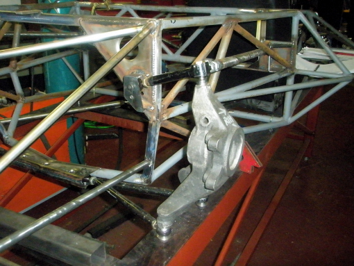

Thanks mate, we are close to getting the hubs assembled ready for knock on's with huge Porsche styled wheel nuts.
Regards
Chris.
