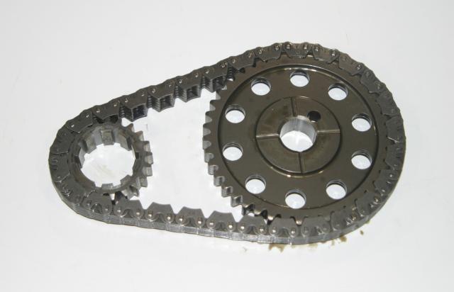

Use a chain, specifically Ford Racing's Morse-type Hy-Vo chain. Another one to consider is Jesel's HTD belt drive.
