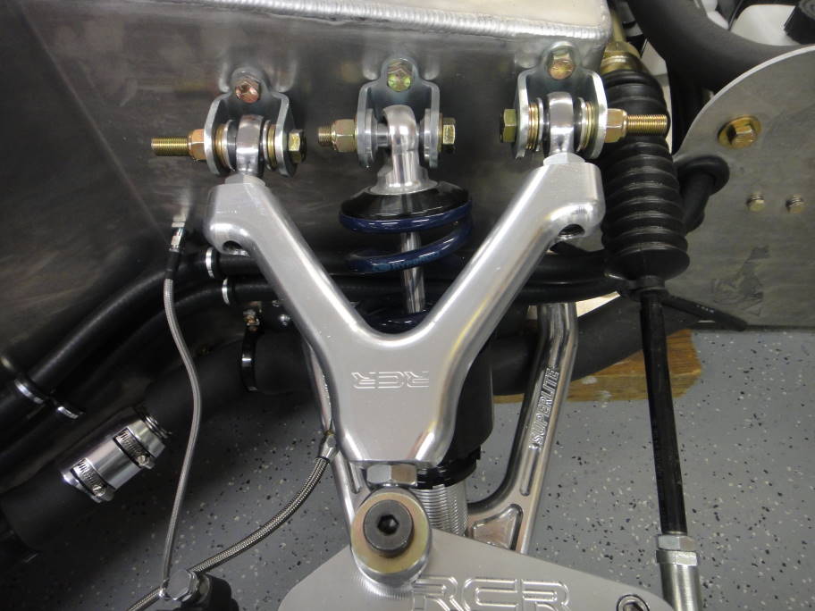

There are a number of bolts on my car that appear to be longer than optimal. For example, in the attached picture, I am thinking of replacing the two wishbone bolts with ones which are shorter and installed in the opposite direction - as it is, removing the bolts requires removing the shock bracket from the body. If they were reversed then the bolts could be removed without disturbing the shock bracket.
Am I missing anything here? Is there any reason I shouldn't use shorter bolts (as long as 1.5-3 threads are still showing past the nut) or installed in the other direction?

Dave ,
the bolts are the correct length to make sure that all the suspension loads are on the shank of the bolt and that no threaded area of the bolt is carrying any critical load.
Feel free to shorten the threaded area that seems longer than you would but DO NOT install a bolt that carries load on the thread.
You may also notice that with the orientation of the bolts, that should, by some miracle the nyloc nut fall off ,the bolts cannot actually fall out as they are somewhat captive by their orientation and the proximity of the other brackets and bolts.
Dave Forster
Makes perfect sense to me!
Assuming these are already the shortest bolt that keeps the shank under the loaded areas, the only option to go shorter would be to cut them down, which would mean the cut ends would be unplated and exposed to corrosion . . . think I'll just leave well enough alone.
