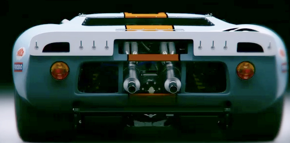

You mentioned a few posts back about cutting out the upper corners of the rear clip to release more hot air. On both of my cars, this would only let air out of the wheel-wells. (there is a splash-guard that seperates the engine area on both sides) I don't remember looking under the rear clip on the gulf cars to see if it has been cut-away or not......... Anyway, something to think about, Scott
Robert S.
Venting hot air from engine/exhaust area on MKI
Robert,
Scott, Thanks for taking the time to pass along a worthy suggestion. I will look into the circumstances you described later today.
I'm uncertain we are both thinking about the same circumstances - maybe we are, but I'm not sure. So, I’ve attached a pict below that shows a rear view of another GT40 MKI tail.
This particular MKI is more like some of the original race versions whereby many of those owners or teams cutout the center section to vent the power train area below, and they also cut out vents on the left and right sides of the car's original rear body spoiler area. For MY lack of better names, those two left and right side cutouts I just mentioned are the two cutouts I may make in my car, and it is that contiguous hollow area which leads downward unimpeded to the power train and exhaust area. I believe it likely that both types of openings promote the expulsion of hot air. Do you still have concerns? I would appreciate you letting me know. Thank you very much, Robert See photo below.
Robert S.

scroll down the site to figure 22 and 23 and you can see exactly what this "rear top side"cutouts are meant for. Their purpose is to vent the wheelwells and relieve the hot air from braking. Also they will have some aerodynamic effect. on this original car #1076 there is no connection to the engine compartment ( as Scott pointed out correctly).
The center vent above the gearbox is modeled in a recess on most original cars. Most of us are using this recess for mounting the nump
berplate. On my car i do this as well, but i have opened it up behind and mounted the numberplate on spacers to vent hot air from the engine compartment. Never understood why SPF´s dont feature this original style recess.

Thanks Tom for the link and info. I'll view it with great interest. I appreciated your helpful, well intended comments. All good things, Robert
