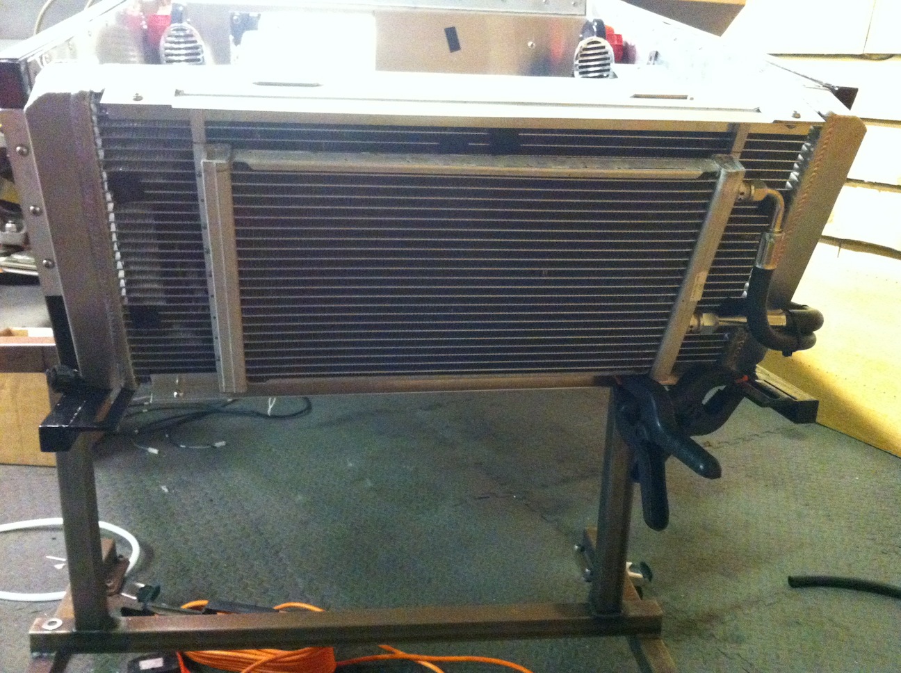

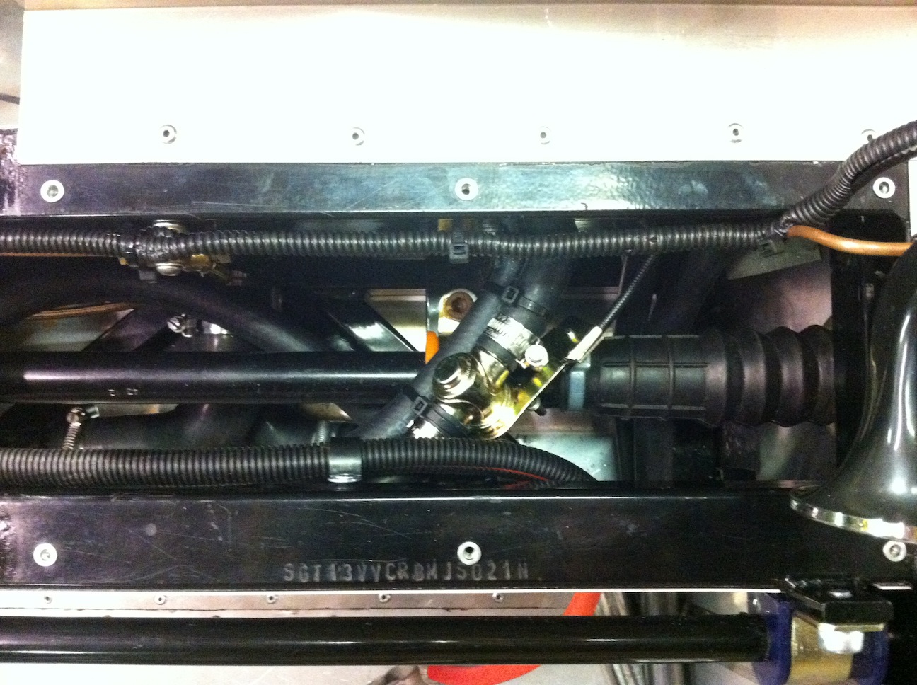

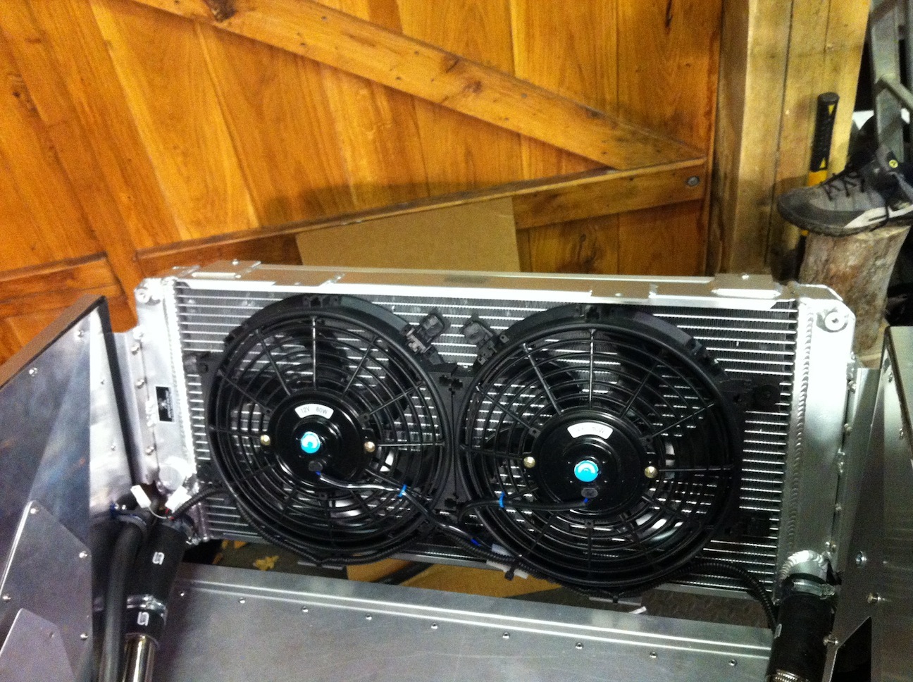

Love the SGT stainless pipework but need some mods 1-the linear pipes that run through the central duct need to be a little longer if you are using Silicon 90degree bends. you need to get the jubilee clips on each pipe end. I also shared a shipment of radiators with Paul and the stainless pipework in the nose area needed to be splayed out a little as the radiator is slightly wider.

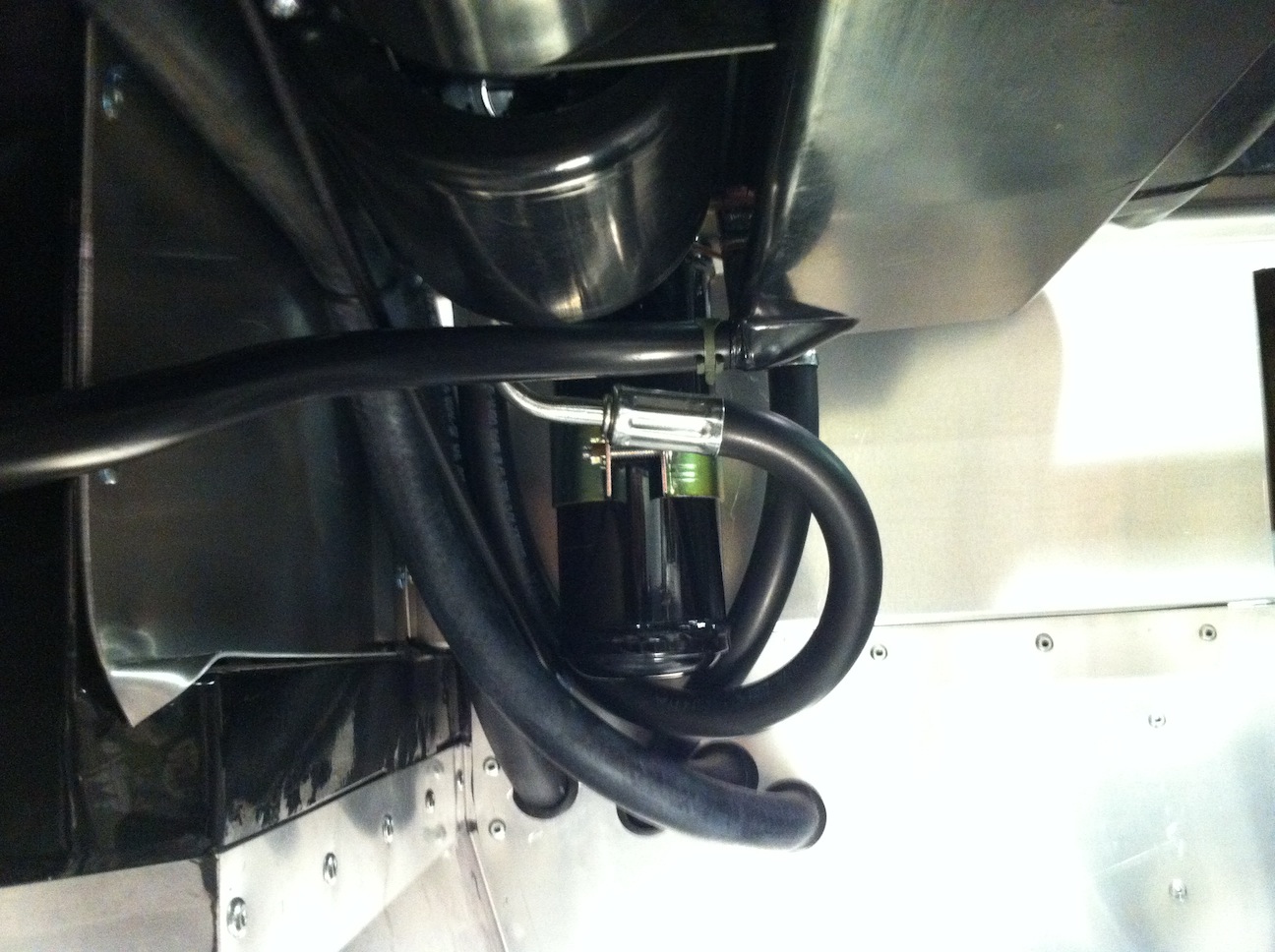

Aircon went in well and managed to get the drier in in between the zircon unit and the front bulk head. I think this will make for a cleaner nose area. BIG mistake though! on the SGT chassis there is an area for fuel pipes etc to be cased in (IVA). Now that these are fitted realised that some of the pipes ran across where this cover is placed. TIP - buy the cover up front! also there is a lot of room so no need to worry about trying to cram all in. Again I did not realise just how much room until I got these covers.
Hydraulics
The SGT kit all went in very well. I ran the front nearside pipe under the plate with all other wet systems. You can see where I have started the wiring I am also running in this area. Again hopeful a clean finished area.
