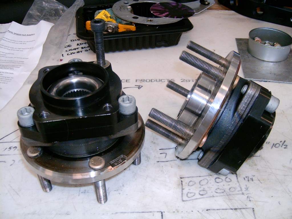

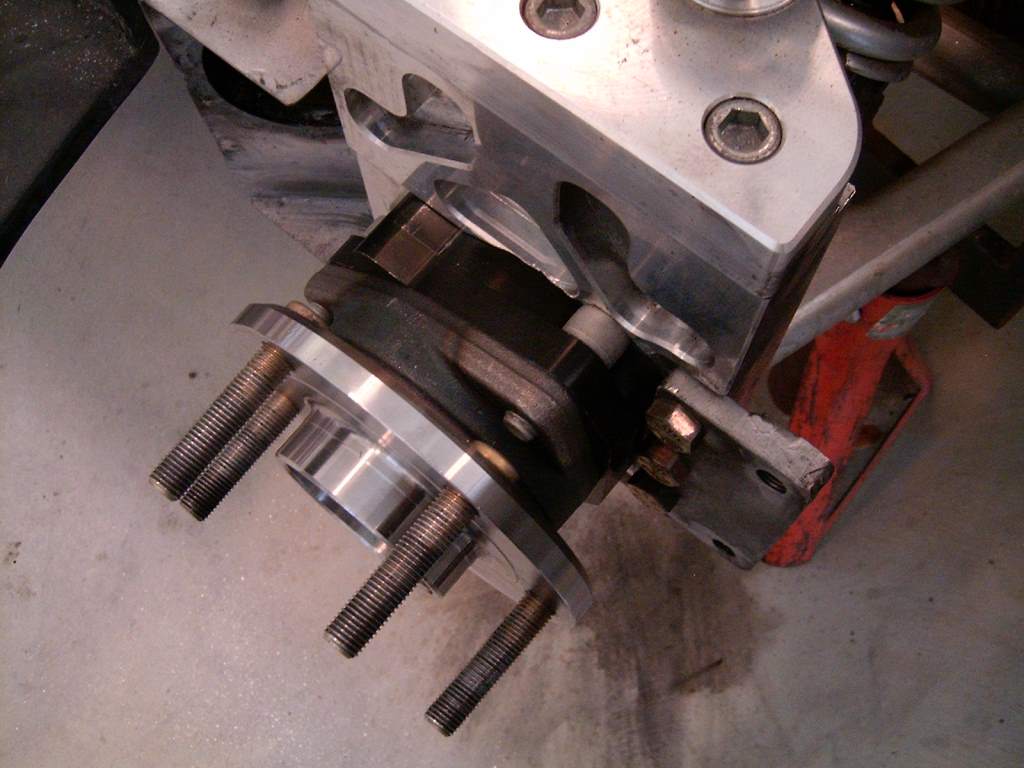

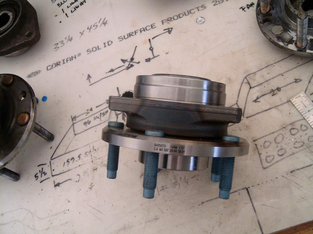

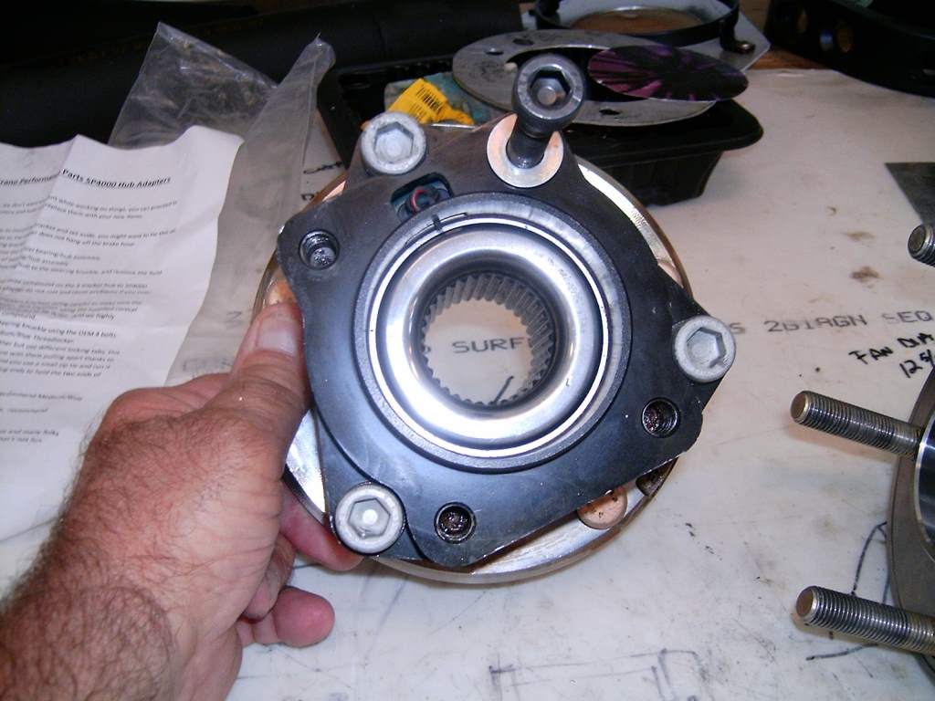

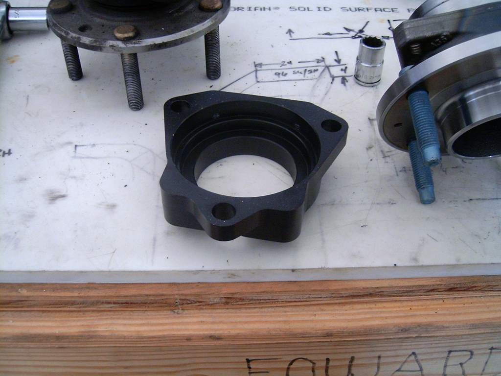

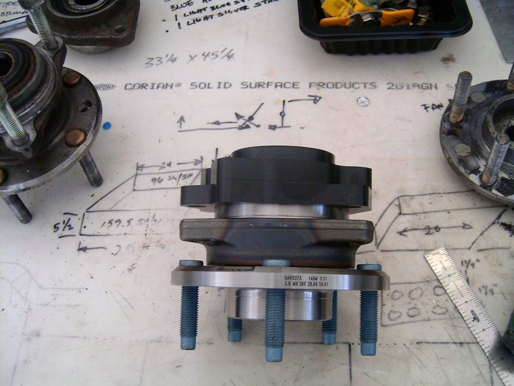

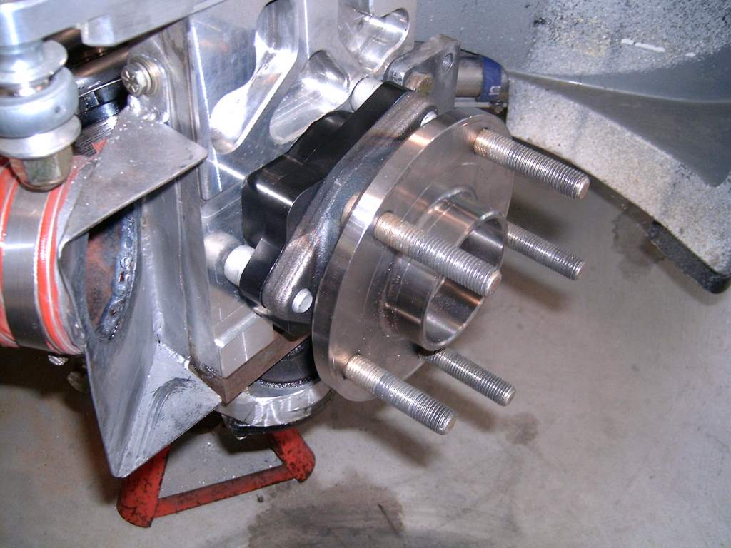

I put the fronts all togehther yesterday. It took a bit of finish fitting but in the end it all goes together with a minimum amount of modification.
So first: the first three pictures are of the C7 SKF hub bearing and the Strano adapter and why the C7 won't work. You can see that the barrel of the bearing is too big in diameter to fit down into the adapter.

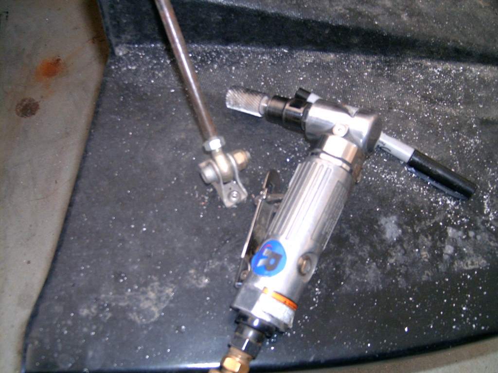

The next picture is the areas of the upright that need to be removed so that the upright does not interfere with the seating of the adapter.
Then the last ones are the completed assembly with my reused longer 2 1/2" ARP studs and the tool I used to machine the upright. Sort of a "hand" mill but if you are careful it can be done well. If you don't want to tackle this part then remove the upright and take it with all the parts to someone with a mill. You will also note that I cut off the wires/connector as I don't need them.

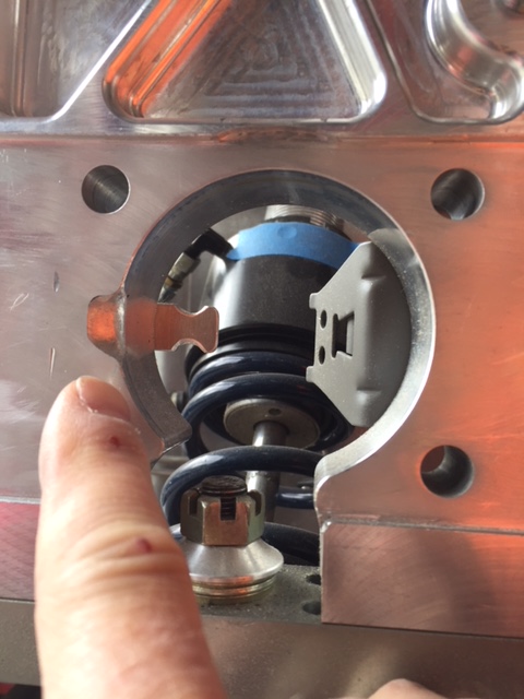

Those Strano adapters definitely look beefier than the Dulaney adapters I'm using. One of the benefits to the Dulaney adapters is the built in ears to mount a cooling plate.

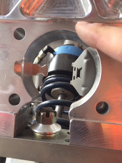

The second Gen front uprights using the Dulaney adapters require a lot less shaving (for builders interested in this mod). My finger is pointing to the only two areas that needed slight attention. The finger pointing to the 9 o clock area is just for the wheel speed sensor wires on the hub. The finger pointing to the 12 o clock position is the only relief needed in the upright for the Dulaney adapter. If you use the Strano adapter then this relief will be much larger.

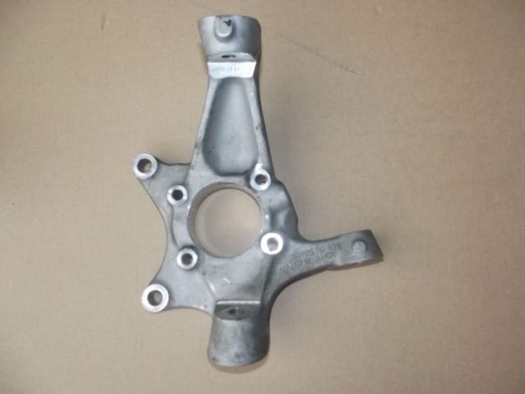

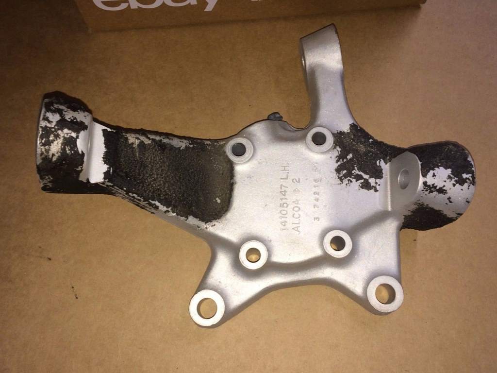

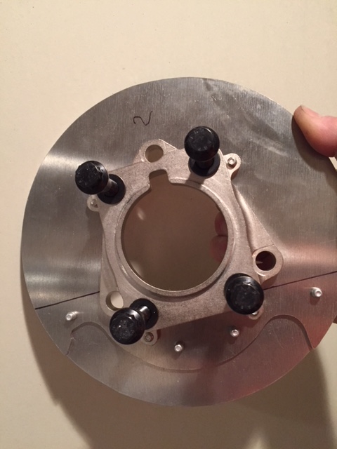

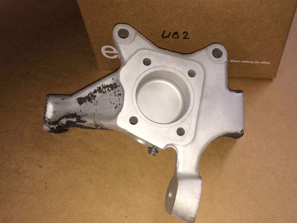

Howard, looking at the C4 stub kit, It says the hub maintains stock location, but from what I see, it appears to move the wheel flange inward (which I like) The OEM hub has an outboard push of about 2" between the wheel flange, and the mounting flange. With this stub, it would appear the wheel flange would be adjacent to the mounting flange after everything is assembled. Do you concur?
Howard Jones

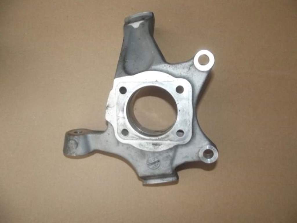

It's hard to say what the actual dimensions are without having one in hand. I have found some pictures of corvette spindles that mount the C4 hub bearing. It seams Gm changed them a bit over time but they all look like they use the large center hole to locate the bearing body.
