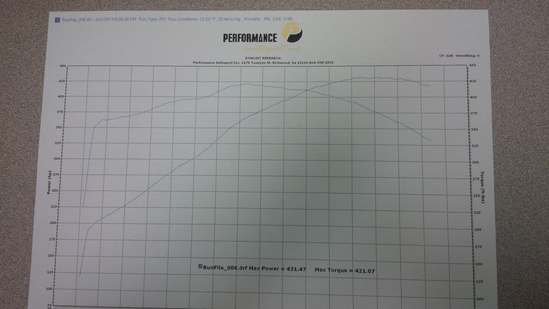

I have the GM crate LS376/480hp mated to the G96.50 box. Regarding the GMPP factory ECM tune. It's pretty good and like mentioned, maybe a little rich (thick warranty). After several pulls - chassis dyno 431hp/421Tq at the wheels on a dynojet. The GMPP supplied ecm with tune for this motor is dependent on you following their install directions precisely - meaning intake tube sized and MAF installed where they tell you to. Be aware that GMPP has certain hidden parameters in their tune that the aftermarket programmers at HPtuners/Elflive may not know about/have access to. As parameters are discovered the A/M tuners are adding these parameters to their software. IMHO -Aftermarket tuning may be helpful if your experiencing certain issues or need to change certain operating parameters, but it is not the silver bullet. If you're not worried about street drive-ability and just going racing - have at it. Reason for this caveat - good tuners are about as common as finding a real unicorn.
