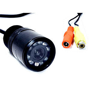

Bill have you seen a shark fin with a camera built in I have looked everywhere and haven't yet been so lucky.
I have seen shark fins and cameras, but not as a single assembly.
I know of at least one other SLC builder who found an inexpensive BMW shark fin on ebay and was planning on mounting a camera in it.

as for the camera I wonder if the night vision IR would be useless as most only work out to 8 m ?

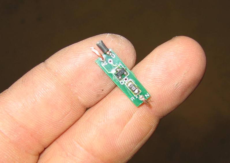

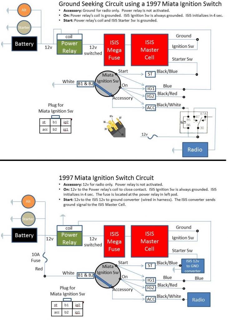

While I have my dash out, I'm cleaning up the under-dash wiring. One key area is the ignition. I'm using a 1997 Miata ignition switch that is matched to the door lock tumblers, so a single key fits all.
The ISIS system will only understands a ground signal, so I wired the ignition as a ground seeking circuit. The ground seeking ignition circuit worked fine, but it is an odd way to do it.
Later I discovered a tiny ISIS inVert circuit board hidden in the HVAC wire harness. The inVert circuit board converts a 12v signal to a ground signal. I'm using a different HVAC unit that doesn't need the inVert circuit board, so I used it to rewire the ignition circuit in a more conventional way.
You can buy the inVert circuit board on the ISIS website for $28.

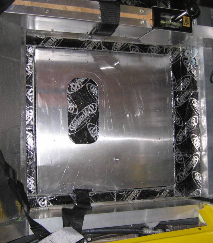

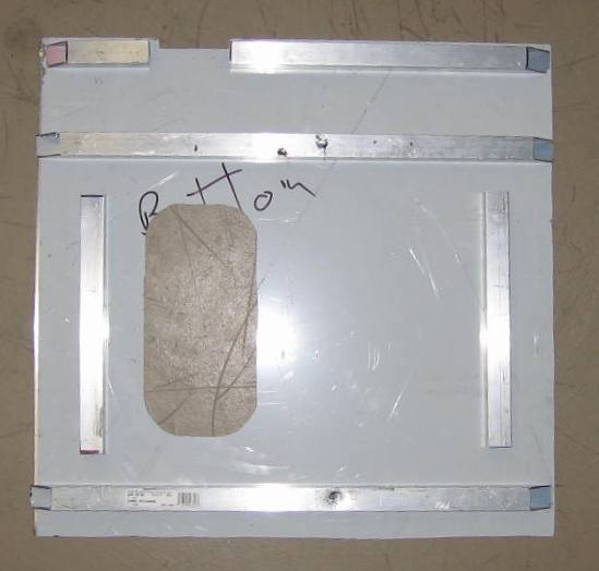

I'm working on all those little things needed to prepare for upholstery. Today I fabricated a false raised floor on the passenger side. This is to make the entire floor flat, so carpet is easy to lay.
The recess in the floor is about 1 1/8" deep, so I used 1" x 1" aluminum square tubing as a spacer and then laid 1/8" aluminum sheet on top of that. The seat is positioned so the butt end is lower than the flat floor, so a butt hole needs to be cut to accommodate...Hmmm, can I say that on this forum.

Bill,
I did as much with my 40 for almost the same reason. I have the wash board floor. Mine differs in that I stopped the raised section must under the front portion of the seat.
This allowed the seat to sit that one inch lower. It also gave me a place to hide the heavy battery cable along with some wiring harnesses, hydraulic lines, and throttle cable.

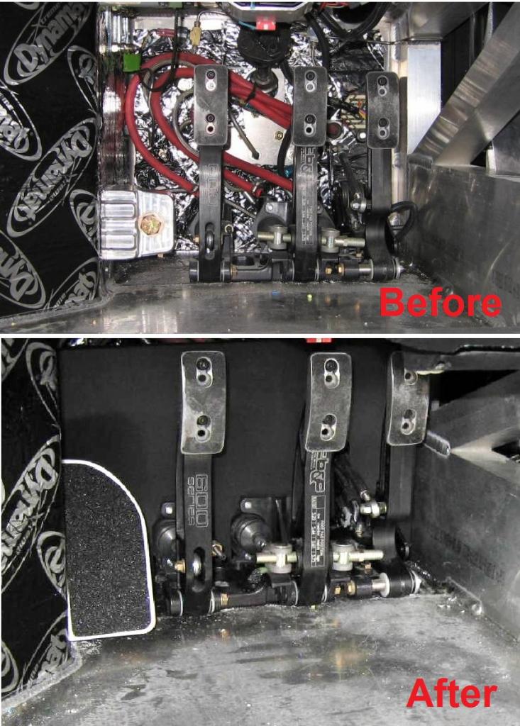

As I look at my pedal assembly, I see spaghetti of hoses and brake lines. So I built a panel to hide all that. It's clamped in place between the master cylinder mounting flanges and the pedal assy.
In addition, I built a dead pedal to hide the suspension pick-up mount.
