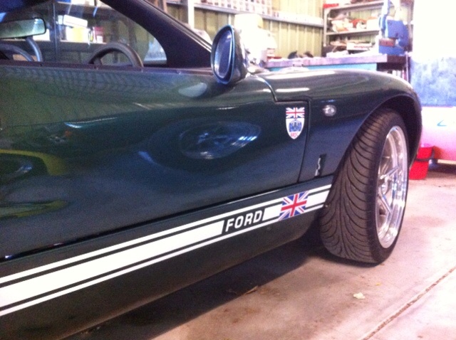

new side stripes....

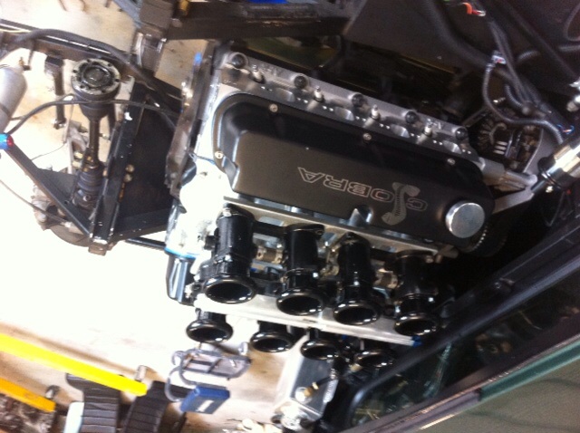

Some progress with the car, the new motor is installed, broke the cockpit rear window wrestling the motor in.
Motor is a 351 Windsor with a 408 stroker kit installed, afr 205 heads retro roller cam and TWM 8 stack.
Just need my adapter kit to turn up, make a new exhaust, new shifter, new driveshafts, fit 6spd and tune motor.....stopped working on the car to help the Missus for a minute which turned out to be a trip to the hospital for stitches and looks like a few weeks off work for me, put a knife most of the way through my thumb.....bugger.

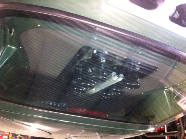

motor fits ok, need to make a new rear access panel with a hump to clear waterpump pulley...

Sorry about your accident(been there, done that). Hope you missed the nerve. On happier notes, you will really enjoy the new set up. You have almost exactly what I have on my car. The one exception that I felt was truely necessary, was the internal balance of the engine. I have my motor solid mounted to the frame and there is no vibration what so ever. You will be surprised at the power you have just upgraded to. It is the most power I have ever felt in a car. Almost overpowering. Be sure you match the ports from the intake to the heads. It is a big change in size. It will allow the air to flow much more smoothly without turbulence. If you don't like the hump in the firewall, take the pump off and go electric. It will add more HP to the engine(not that you will need it). Just one less mechanical piece and belt to worry about. What are you doing for ignition?? Electronic or mechanical? I chose FAST EFI and XIM. Went with a distributor(you can go with coils) and locked it out and used the electronics to control everything. You can use the FAST system to control almost everything you have, fans, pumps, traction control and more things than you can think about, and you have the ability to run several programs with the system. Drive to the track, and with a laptop change to a race mode for the track and then change it to street mode for the drive home. Tune ups will become a thing of the past.
Hi Bill
my motor is internally balanced as well. I was running an 8 stack on my 302 previously fitted to the car. The ECU i run is called a Microtech, i use a Mallory daul sync dissy for reference and MSD 6AL for spark . The 302 ran really well with the Microtech and i think the 408 will just need a trim in mixtures and it should be fine. I kinda planned to get the efi working well on the old motor before fitting the new motor. Looking forward to driving the car and hopefully the 408 is as good as people say.
