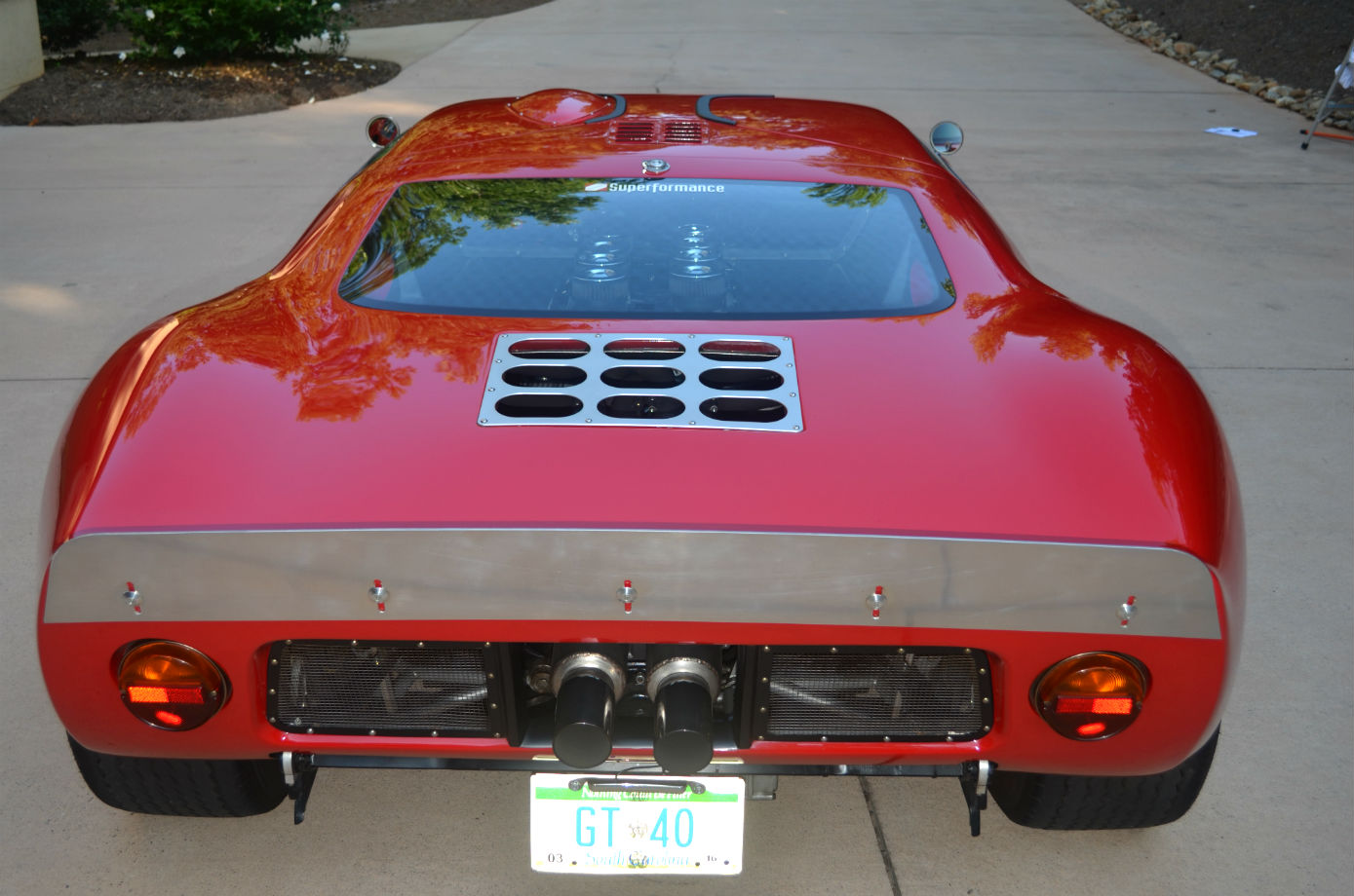

That is about what I thought it looked like on ride height. I am going to be about the same maybe a tad lower in the rear. If you start running into an issue where you want more ride height in the front, you might consider the TKO shocks and lift. I'll be posting pictures soon. It is a extremely nice setup and the guys at TKO are really great to work with. They have a black SPF GT40 in their shop. Your car looks great Jeff!
What size tires on the front?
I personally think these cars look so much better with a low ride height.
More to the point Jeffery, what is the height from the road to the top of your roof?
If it is 39" maybe it is a little low :)
Thinking about that, has anyone ever measured it? Cannot recall anyone posting about it..
A rear view camera would help with parking and just see what is behind you. It was tight parking and with the GT parked sideways and narrow space you didn't have much room. Staggered parking maybe. I'm driving a new MKI without any mirrors for now and that's scary enough. Great low light shot.
I'm actually ok with the rear view as is. When I was planning the car I was convinced I would do rear view cameras. Turns out I do not find them at all necessary. And, I'm happy not to clutter up my car with unnecessary technology.
One of the reasons for the slow parking is the turning radius :-) I look out the door to check distance from the curb as that's a bit hard to judge. I suppose part of going slow is also about not making the other owners nervous... one thing I hate is a driver trying to show off his back up skills by zipping in next to mine. It's also about extending the show a little longer. The slower I go, the longer I get to listen to the musical note.
