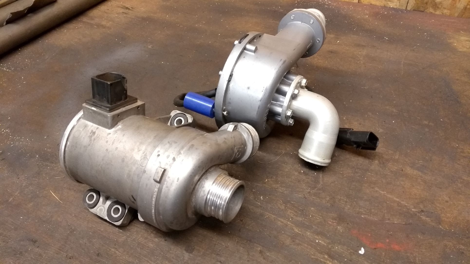

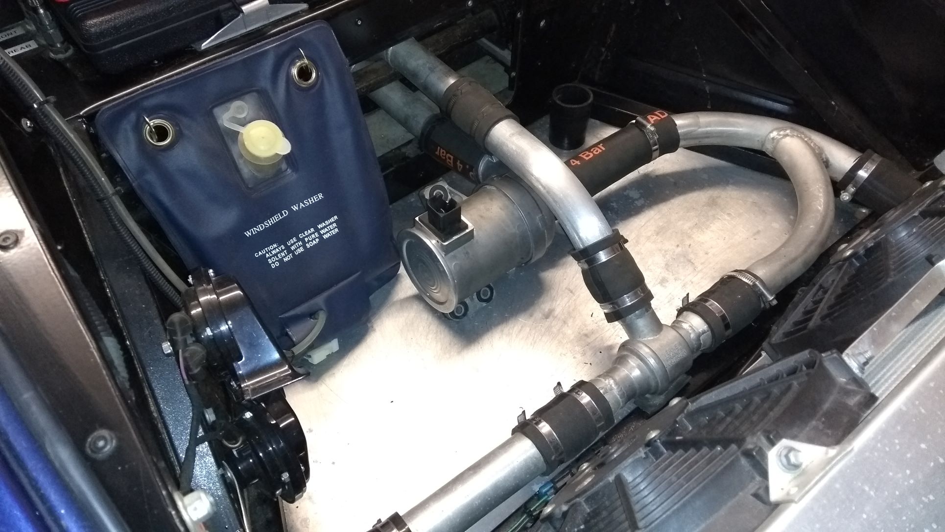

However, last year I’d had a failure of the electric water-pump, which was a Davies Craig EWP130. This is the second failure of their unit, with the first one failing on its first major trip at the Eurotunnel port on the way to LeMans, fortunately I had a spare!
I’ve now fitted a Pierburg CWA400 electric water-pump, which are now fitted to most Ford, BMW, Mercedes gasoline engines and are available for similar money to the Davies-Craig pumps
As they are basically flowing a similar amount, the size of the electric motor is an interesting comparison, which is a brushless DC motor, so service life will be much
greater (they are validated for 6,000 hours use). They are also rated at 150Ltr/min @ 0.8bar pressure, whereas the Davis Craig units are rated at zero pressure, so the actual flow will be lower under pressure. They do require a PWM signal, which can be provided by a stand-alone controller, or in my case the ECU will provide the control

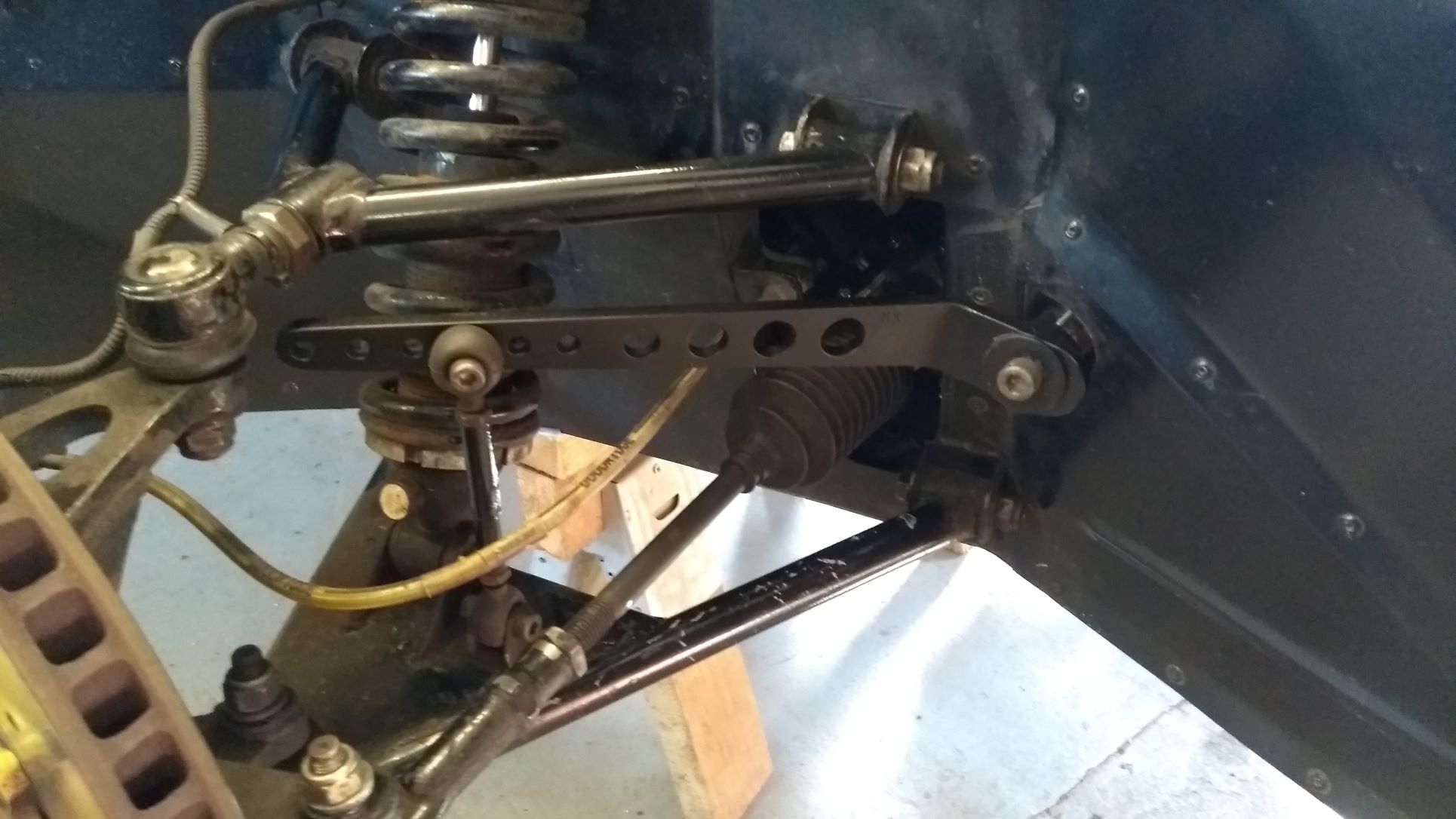

I also fitted a new steering rack, as there was a small amount of play in the N/S inner rack bush
The slight rattle I’d previously thought was linked to the above, was actually a broken anti-roll bar arm. These were off my own design and basically had one too may lightening holes! New laser cut arms were sourced with the offending hole removed!
